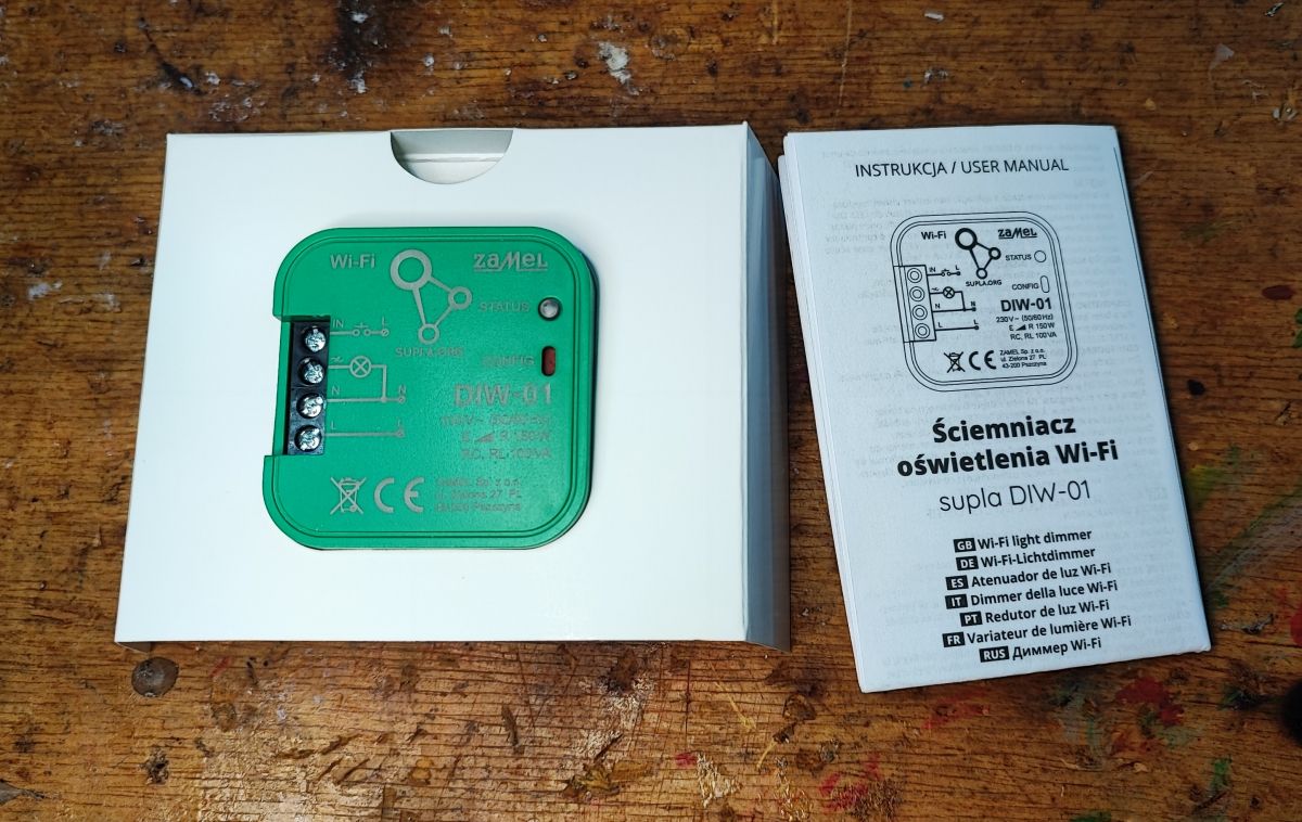

Wi-Fi light dimmer DIW-01 with manual. .
They didn't give mounting screws or even a clip like in Tuya....
Instructions:

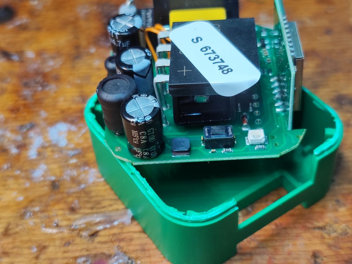

Remove the top cover:
Interior of a green electronic module with visible components and integrated circuits. .

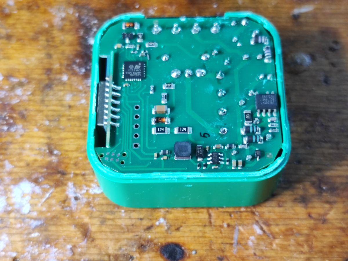

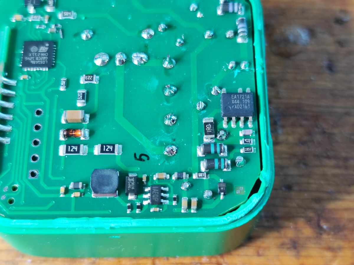

Inside you can see two circuits:
Photo of the dimmer's interior showing electronic components. .
Close-up of a PCB with electronic components. .

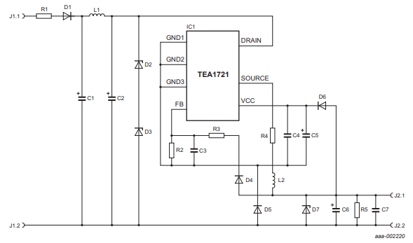

The EA1721A, or rather the TEA1721A is a power supply controller, here not a flyback but a step-down version. There is no transformer on the other side of the PCB.
Electrical schematic with TEA1721 controller and other components. .

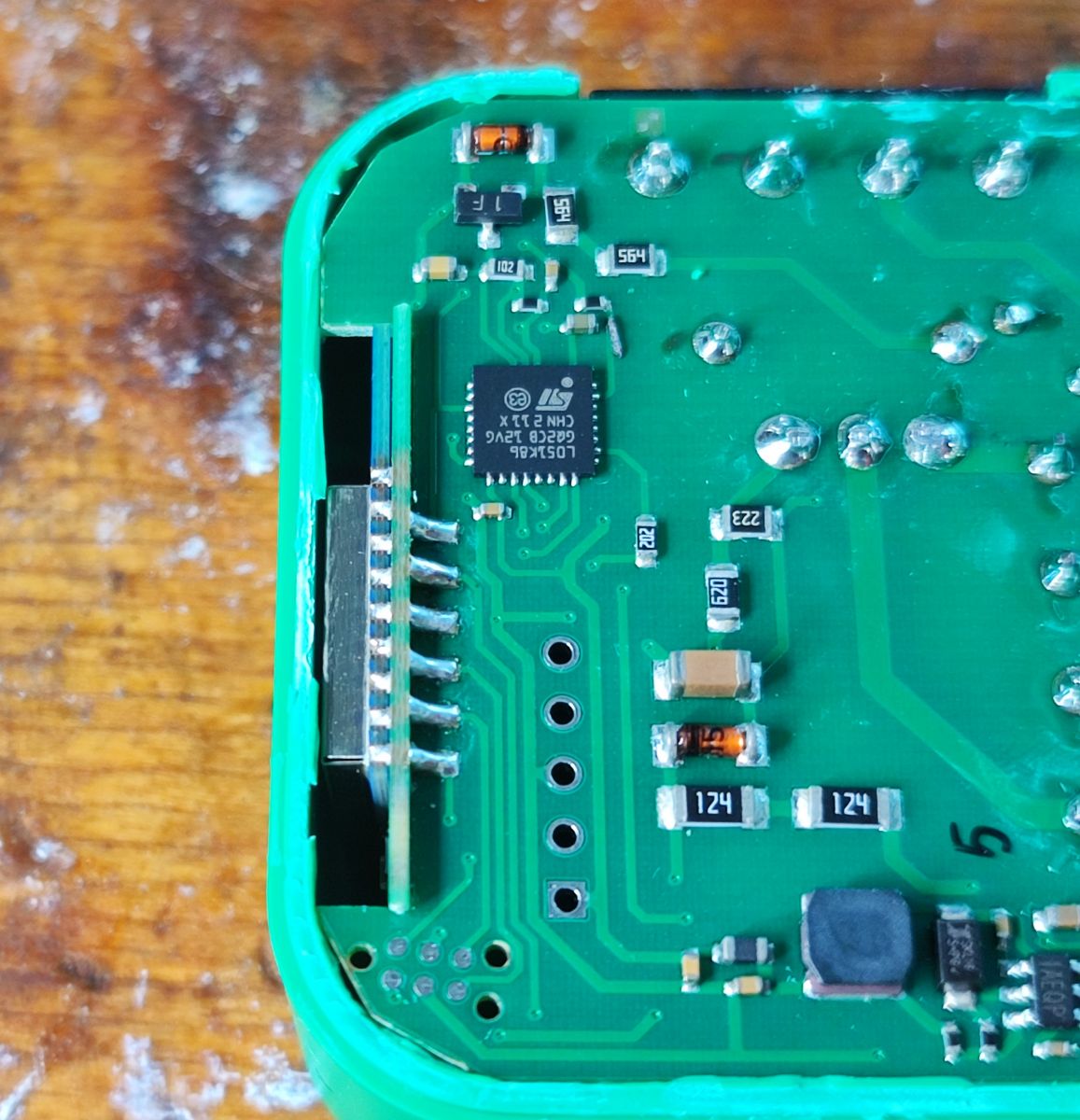

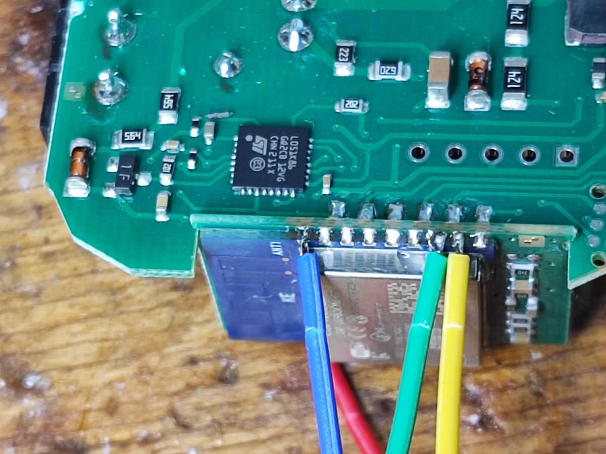

L051K86, on the other hand, is the MCU. This is not the module responsible for communication, as there is still a WiFi module inside, but this MCU I believe handles the dimmer control. Similar to the Tuya products, there is an MCU and a WiFi module separately in the dimmers. Here is an example of a Tuya product similarly working:
EU 300W EDM-01AA dimmer on BK7231 and TuyaMCU - configuration .
Since here is the MCU, where is the WiFi module?

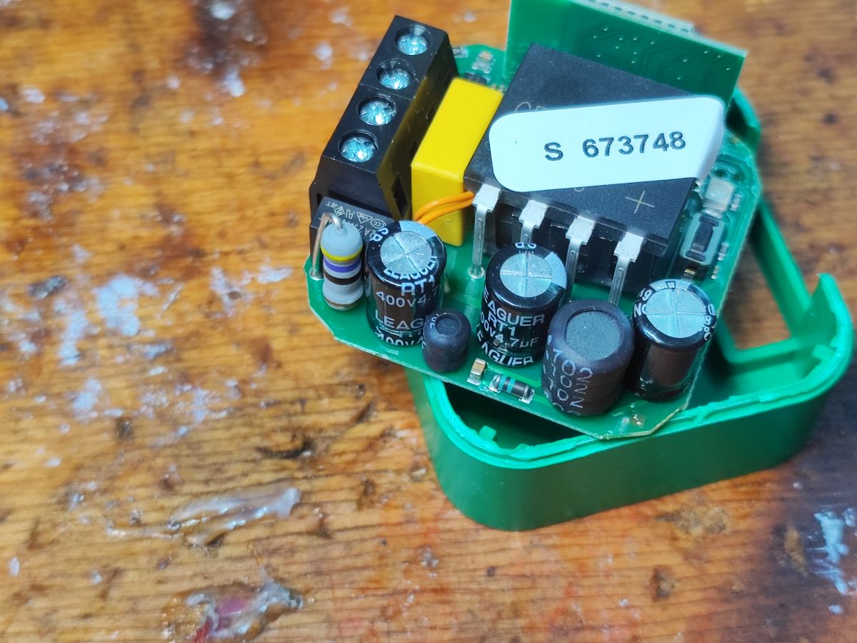

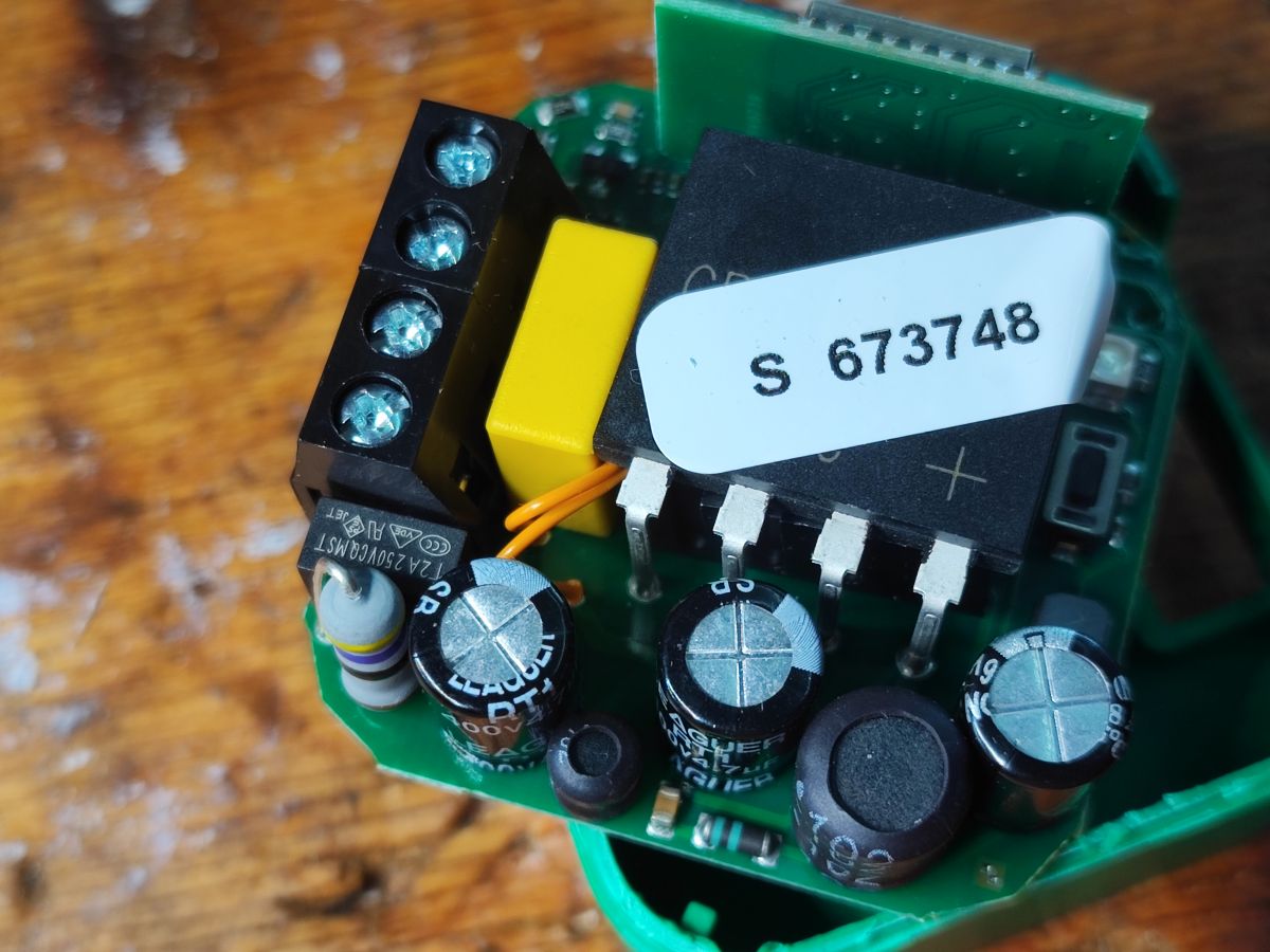

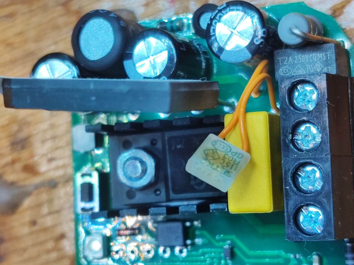

Let's look from the top. There's a fuse, a big rectifier bridge....
View of the internal electronic circuit of the DIW-01 dimmer.
Electronic components inside a green dimmer housing. .
View of the interior of a dimmer with visible electronic components on a green PCB. .

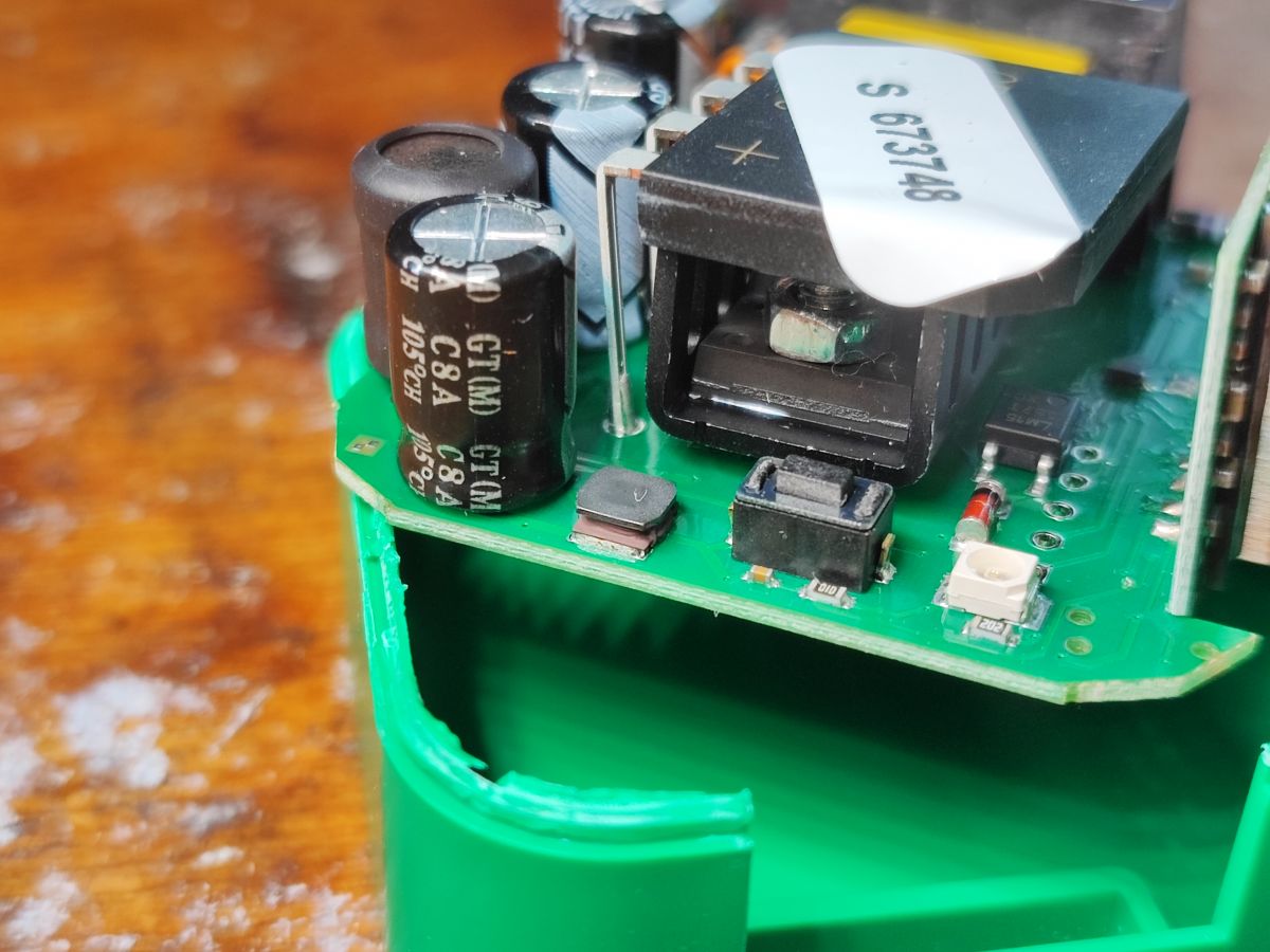

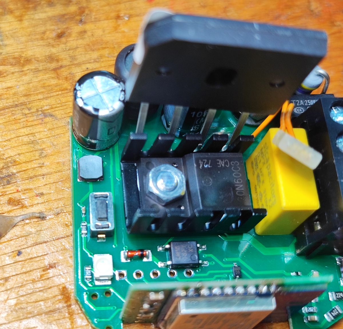

There is a transistor under the rectifier bridge, let's see which one:
Interior of the DIW-01 dimmer with electronic components on a green PCB. View of the interior of a dimmer module with electronic components. .
20N60C3. MOSFET, not thyristor. Small surprise. So they ... are releasing an already rectified voltage onto the bulb? Is that why this rectifier bridge is so big?

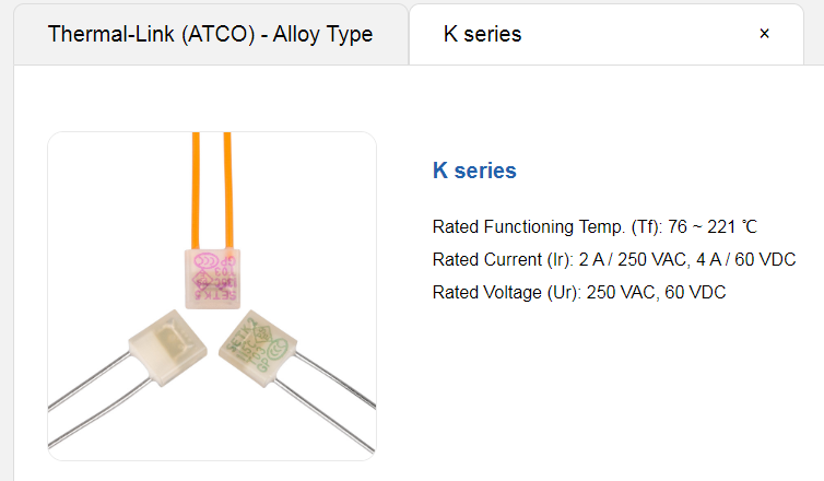

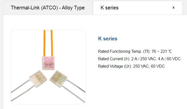

Apart from that, there is also an additional thermal fuse.
ATCO K series thermal links. .

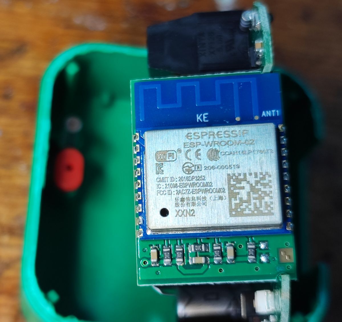

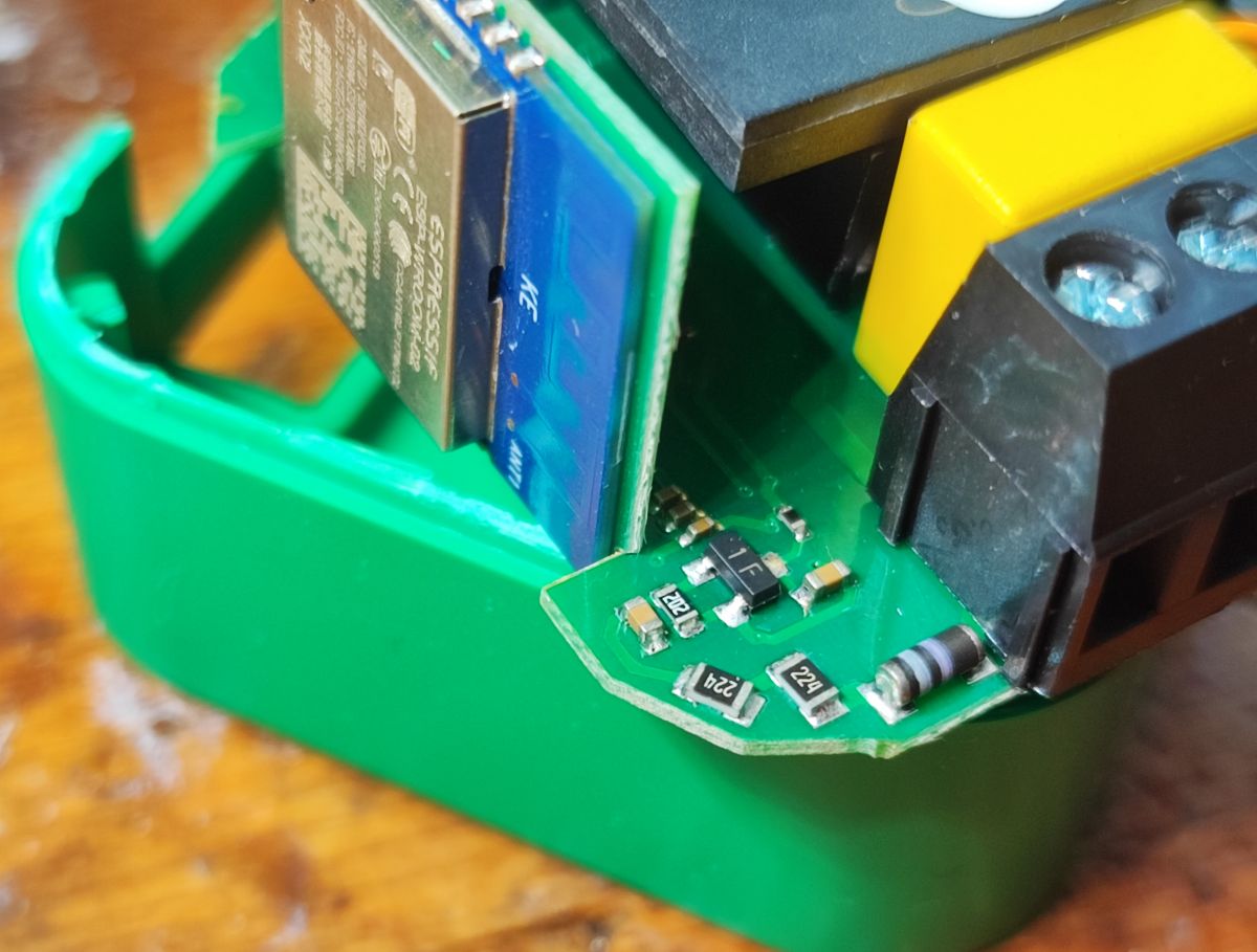

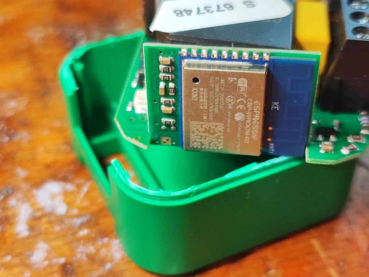

And most importantly, a WiFi module:
ESP-WROOM-02 module in DIW-01 dimmer enclosure Close-up of the ESP8266 module inside a dimmer case. ESP8266 WiFi module mounted on a green PCB inside a dimmer. .

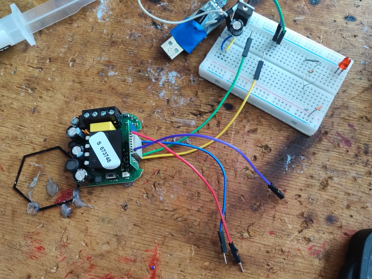

ESP-WROOM-02, or ESP8266. As a rule of thumb, I made a copy of the batch via esptool.py, but you guys don't have to do that:
Close-up of a circuit board with integrated circuits and connected wires. Dimmer's PCB board with wires connected to a breadboard. .
Pairing with Supli cloud (own or public) .
I have basically covered everything in a separate topic:
Pairing and configuring Supla devices without using a mobile phone .
I tested this thoroughly on the dimmer presented here, along with its operation in practice and its remote control.
