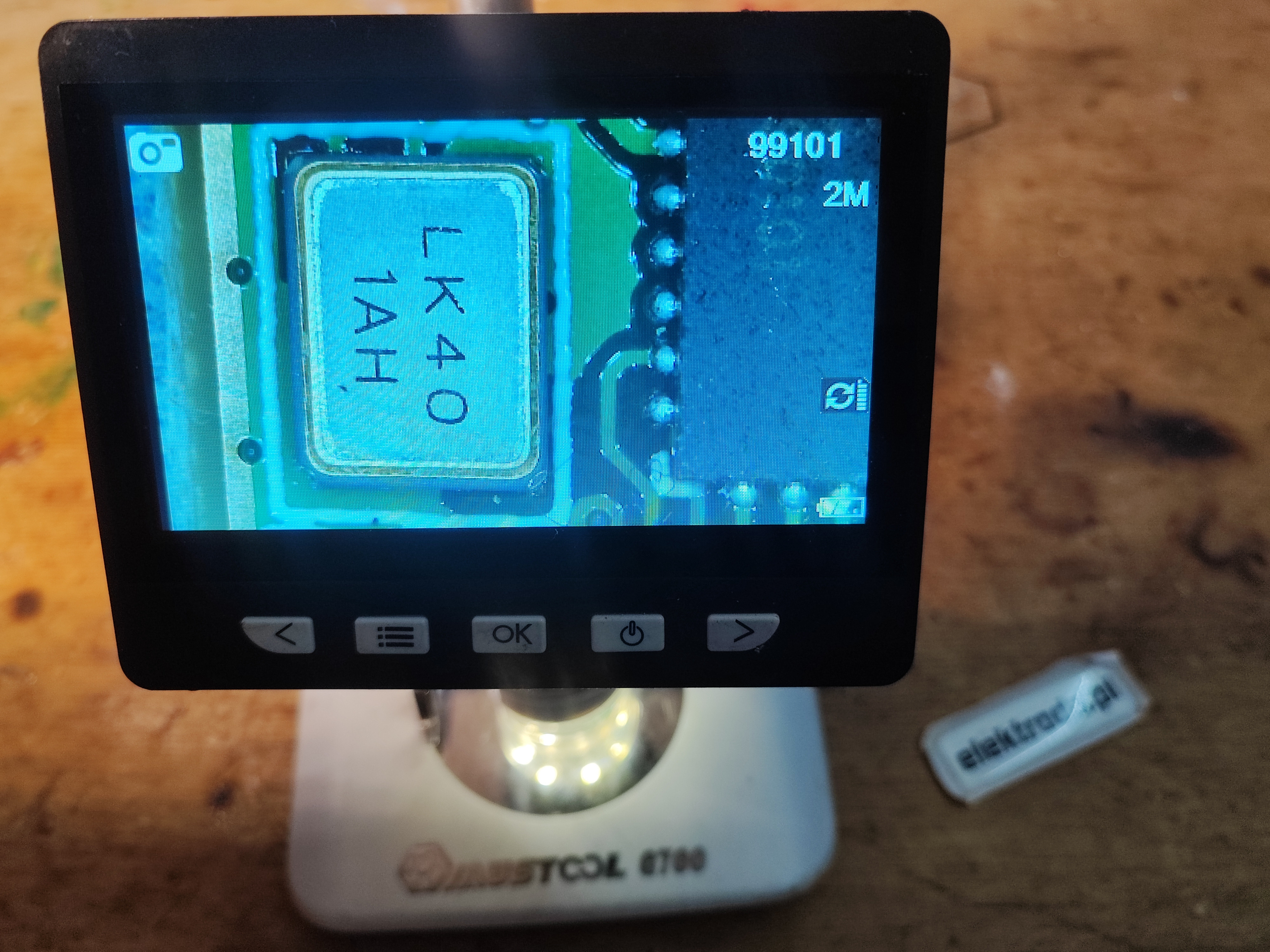

Let's turn on the microscope. First a long distance view:
It is time to zoom in a little. On the right and left we have knobs, one for blocking and the other for the first up and down movement:
Then we catch the focus here:
We also adjust the brightness to suit us:
You can zoom in even tighter. We slide the rear knob (release, slide, lock), even to the stop:
Effect:
I take photos using the OK button, you can also enter the photo gallery:
By the way, we also have digital zoom on the right-left buttons:
The SD card can of course be removed, but I was a little surprised to find that it is inserted the opposite of what is on the graphic?
Here are two more photos at the highest magnification:

To look at the circuit board this microscope may be suitable, but you are unlikely to solder anything under it. In addition, it is not stable and pressing the button to take a photo also moves it - perhaps some kind of remote control to trigger the photo would be useful.
