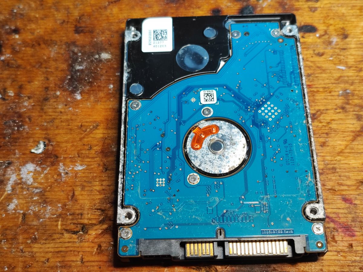

Image of a corroded circuit board on the outer side of a Seagate HDD on a wooden work surface. Exterior of a Seagate Momentus 750GB hard drive from 2011. .
Traces of moisture are immediately visible. The electronics board connects to the rest of the drive via contacts, which would also be likely to be rusted, but what does it matter if the rest of the drive is flooded....

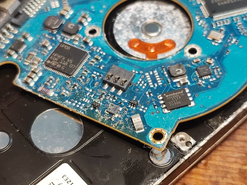

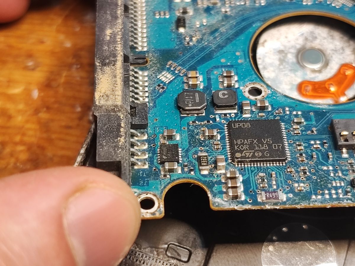

Let's look at the electronics themselves:
Close-up of a hard drive's PCB with visible integrated circuits. Close-up of a hard drive PCB with visible signs of moisture. Close-up of a hard drive circuit board with electronic components. .
On the PCB we have among others:
- main disk controller (LSI866508)
- K4H2816380 (SDRAM memory)
- 25X40BL16 (Flash memory)

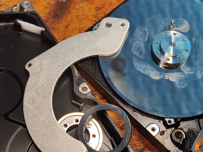

This piece is relatively dry, you can see the head nicely parked:
Interior of a Seagate Momentus 750 GB hard drive with partially dismantled casing. Interior of an opened Seagate hard drive with exposed platter and head arm on a wooden table. Image of a hard disk drive (HDD) interior with visible platter and read/write arm on wooden surface. .
In this case, there are two plates in the centre:
Inside of a hard drive with a removed platter on a wooden background .

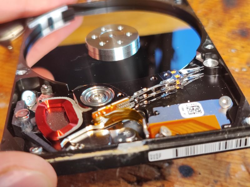

The disc arm coil is between two strong neodymium magnets (head positioning system):
Interior of a disassembled HDD with visible platters and read/write head arm. .
Another perspective:
Inside of a hard disk drive showing electronic components and signs of moisture. HDD arm and heads with visible platters. Inside of a hard drive showing the platter and head arm Hard drive heads inside a damaged HDD Interior of a hard drive showing the read/write heads' arms over the platters. Inside view of a hard drive showing platters and actuator arm. Inside view of a hard drive showing platters and actuator arm.

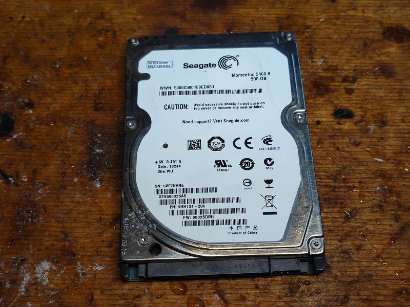

2009-12 500GB Seagate Momentus 5400.6 2.5" .
This drive has a date code of 10244, according to a calculator from the web:
https://bugaco.com/calculators/seagate_date_code.php
is 2009-12.
Exterior of Seagate Momentus 5400.6 500 GB hard drive. Photo of the back side of a Seagate Momentus hard drive showing the circuit board on a wooden surface. .

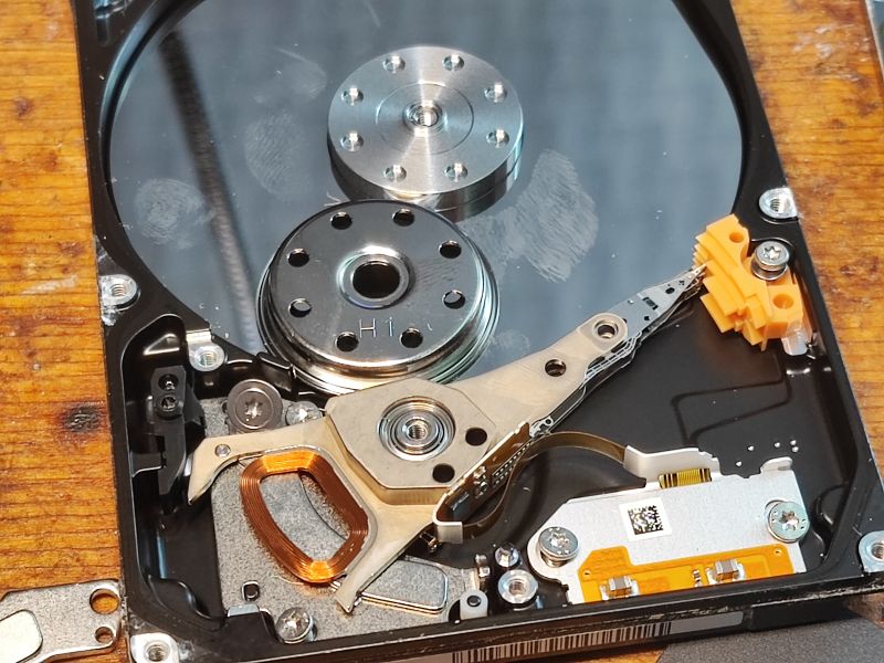

Arm and heads:
Inside of an HDD showing the head and platter Close-up of the arm and read/write head of a 2.5-inch hard drive. Close-up of a hard drive head assembly with visible moisture. .

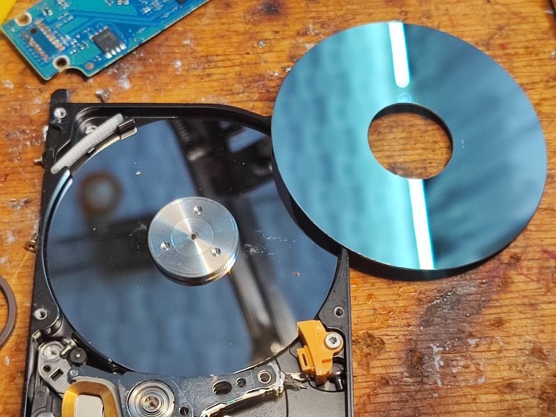

Here again there were two plates:
Opened hard drive with visible platter and electronics on a wooden background. .

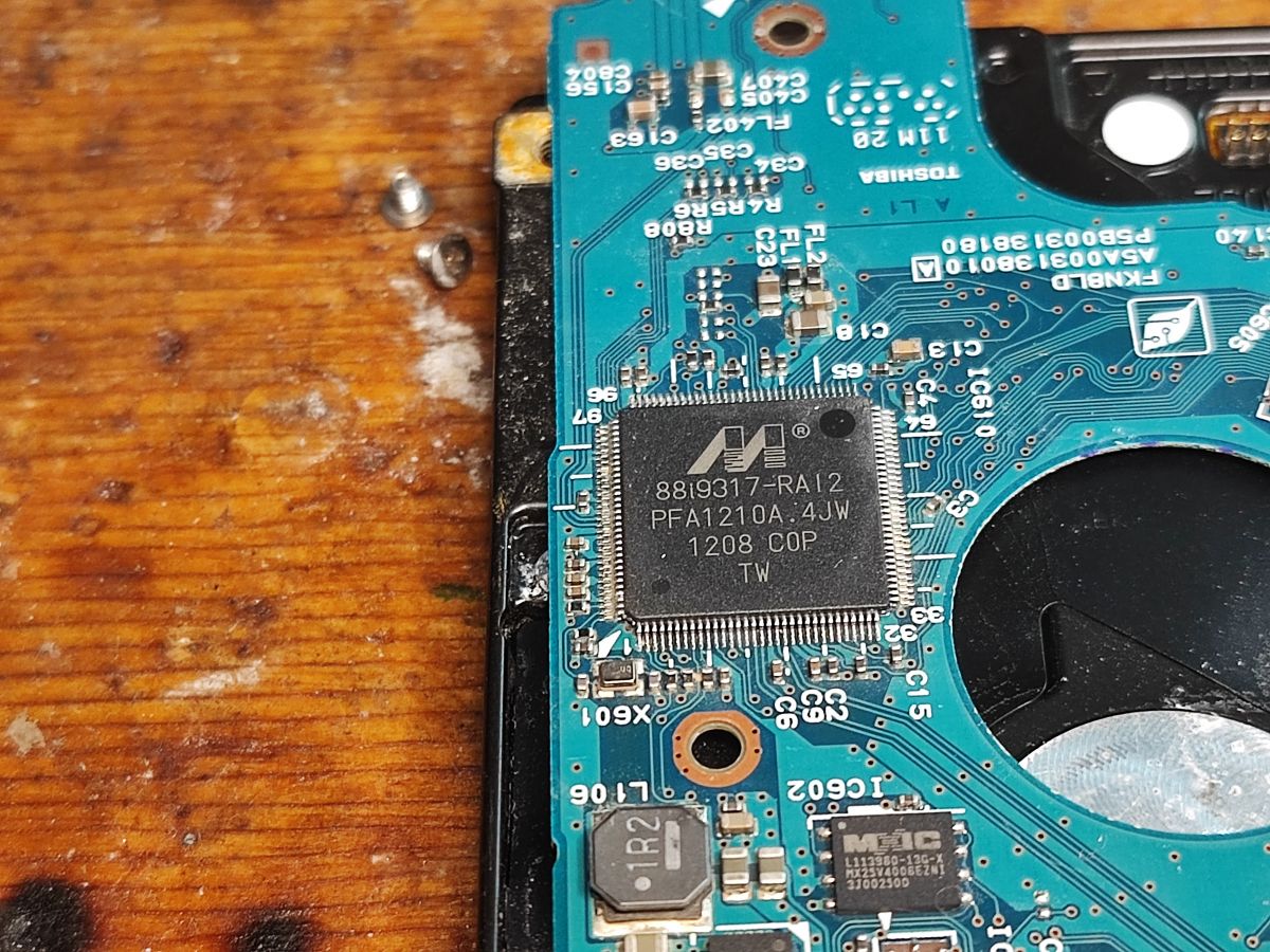

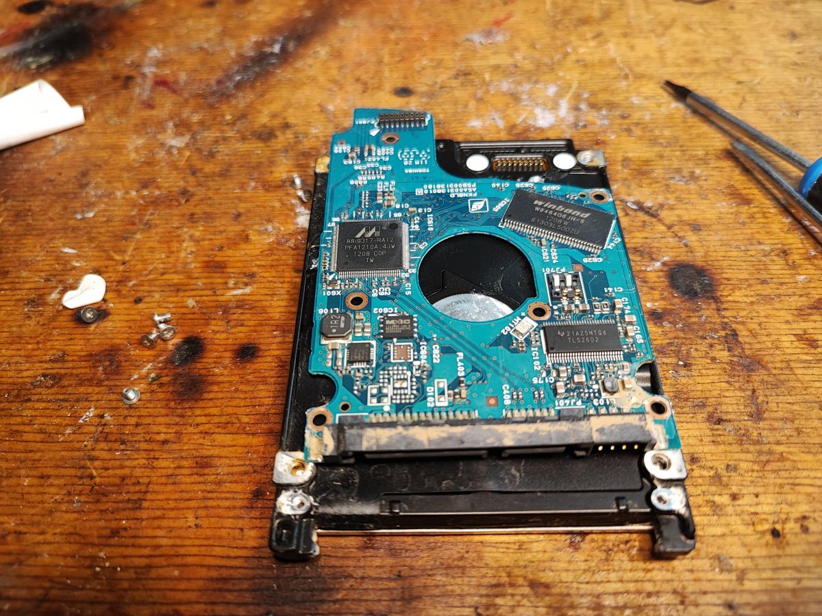

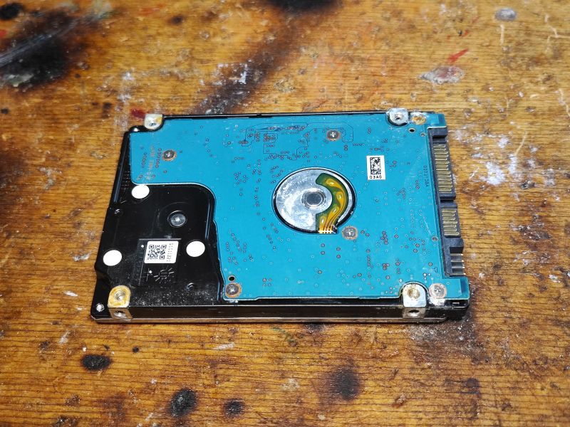

2012 - 320 GB Toshiba MQ01ABD032 .
Date later but size smaller - will there be two plates again or just one?
Toshiba MQ01ABD032 HDD with visible moisture marks Close-up of hard drive electronics board. Hard drive on a wooden table .

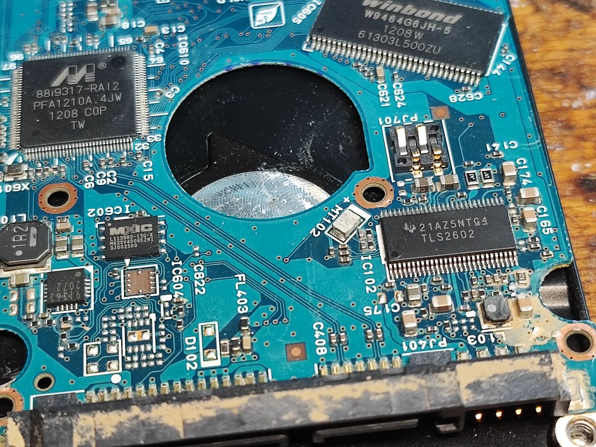

Electronics likewise, main controller, Flash memory, SDRAM:
Integrated circuit on a hard drive PCB. Image of a hard drive interior with a visible PCB on a wooden surface. Close-up of a Toshiba hard drive PCB with visible integrated circuits. Close-up of Toshiba HDD electronics showing an integrated circuit and moisture traces. Close-up of a hard drive circuit board with visible integrated circuits. .
I also searched for information on the TLS2602, but did not find specifics.

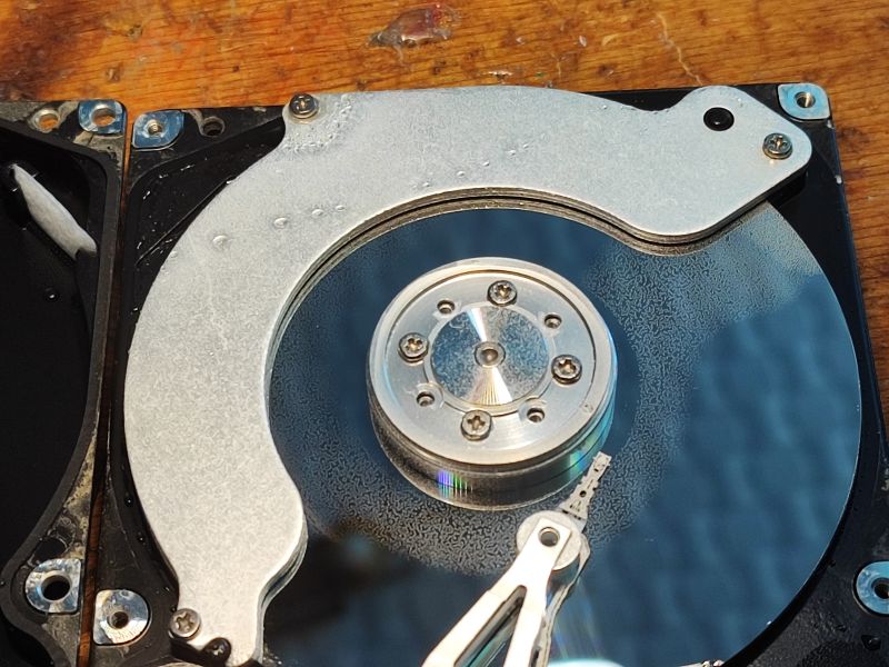

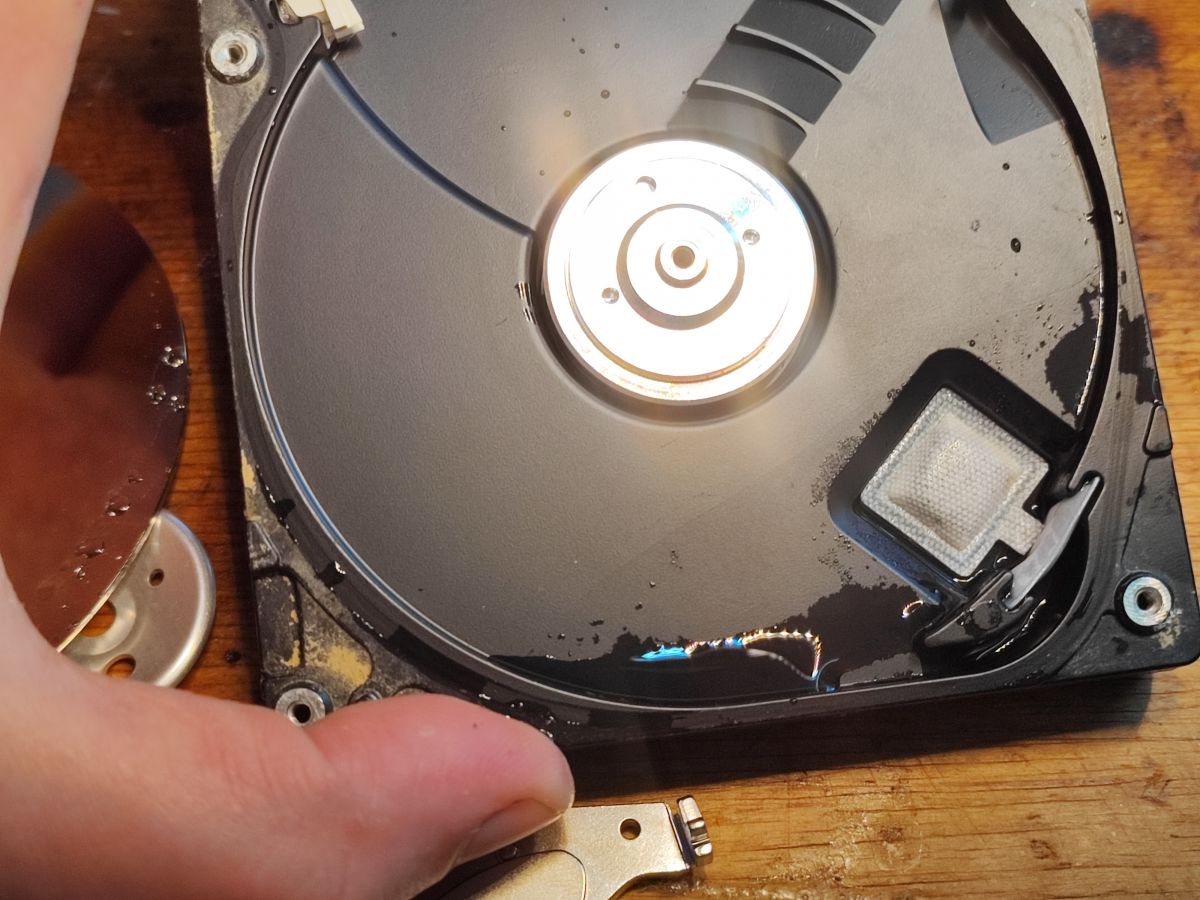

There is indeed a single platter, but if you look closely, you can see that there is room for a second platter - presumably the parts are manufactured together for the "double platter"....
Inside of an open Seagate hard drive with visible platters and read/write head.

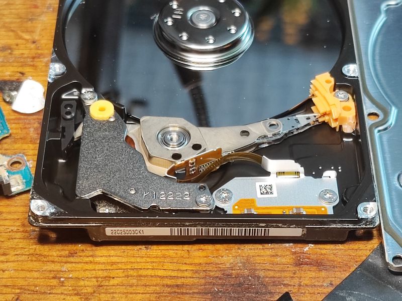

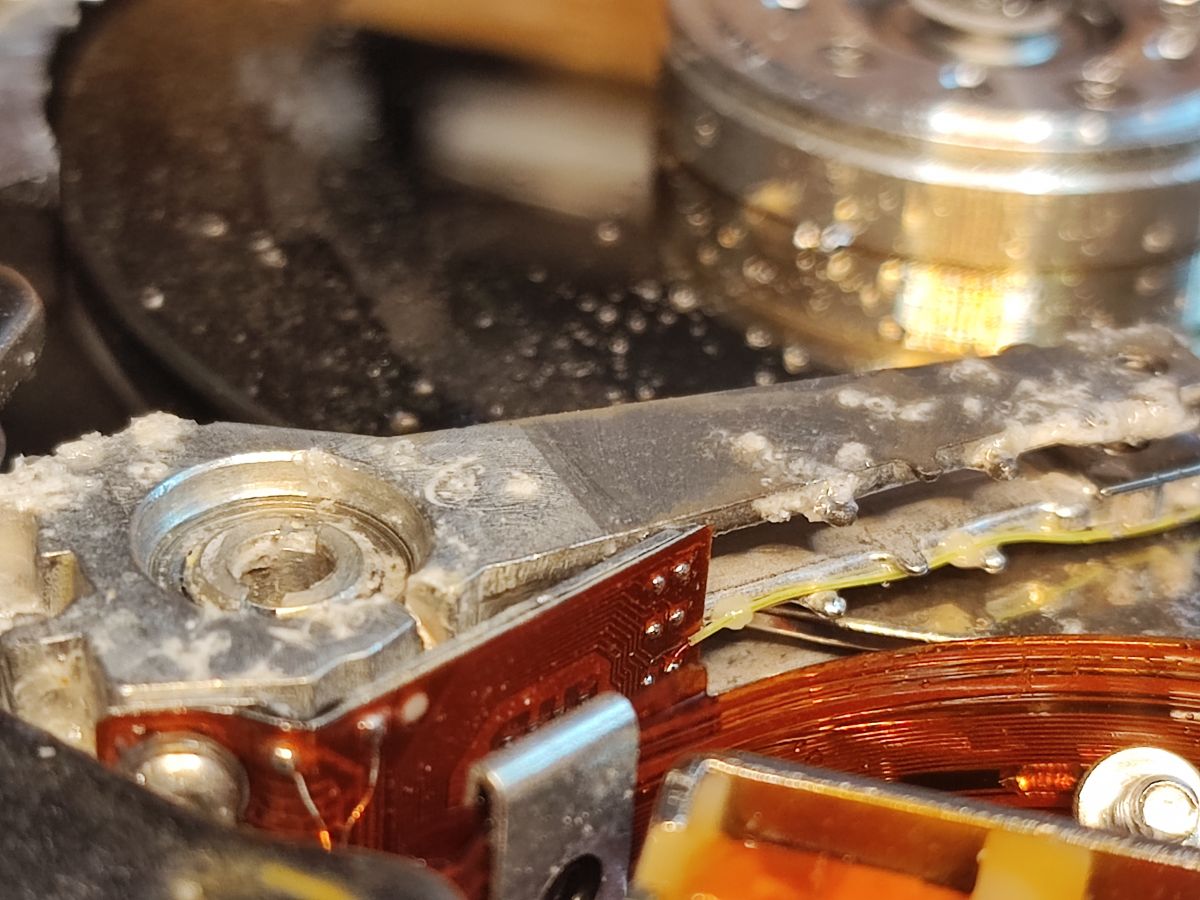

You can even see this from the arm:
Inside of a hard disk drive with visible arm and platter Interior of a hard disk drive with visible arm and platter. Image of a hard drive interior with visible platter and head. .
Additional photos of the arm/head:
Close-up of a hard drive head Close-up of HDD head arm with visible electronic components. .

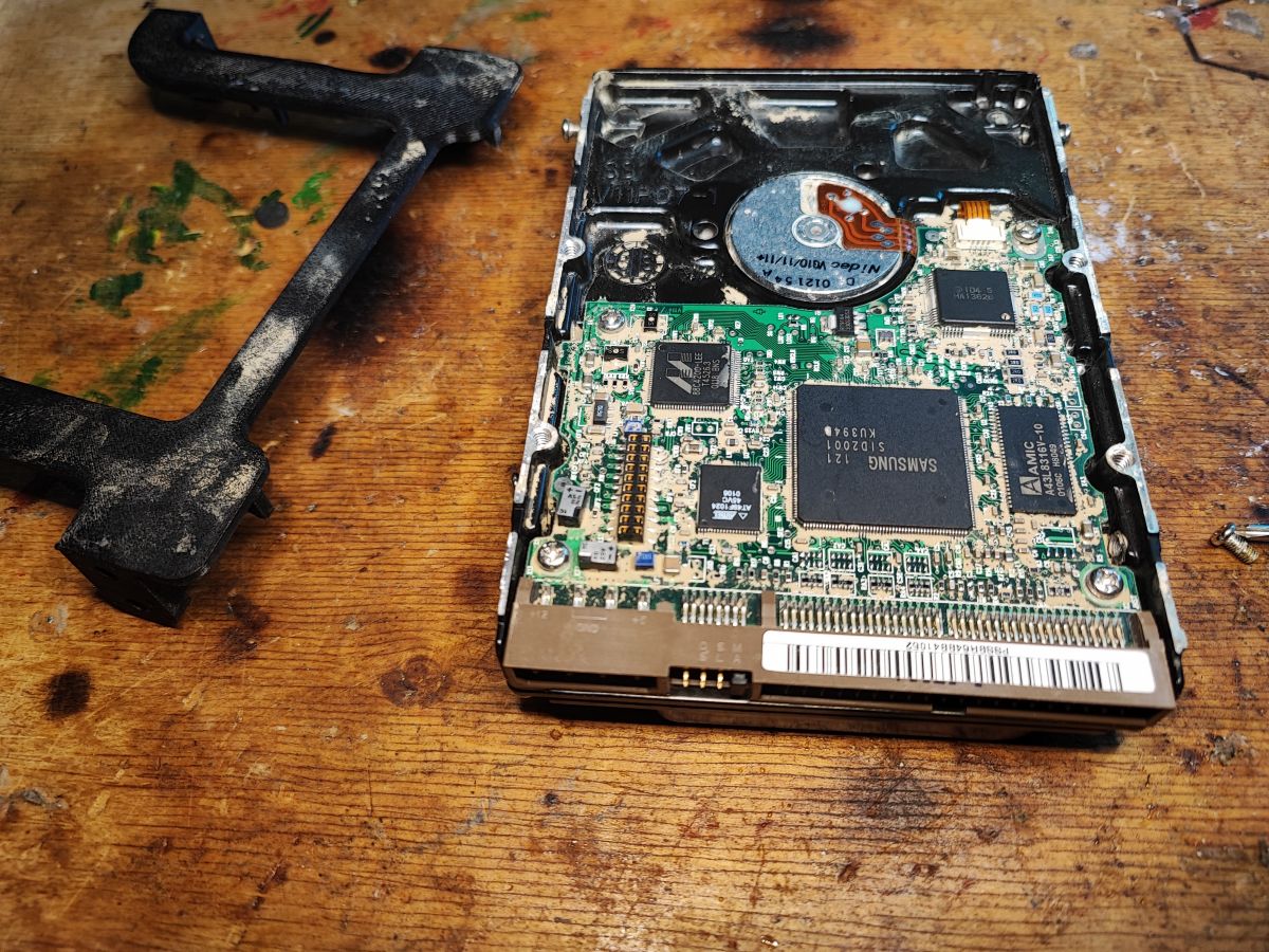

2008 - 80 GB Hitachi HDS721680PLAT80 - 3.5 .
Now it's time for the 3.5" drives. Here, too, there is already an IDE connector. What were the times like when there were "eighty" drives in computers?
Damaged Hitachi Deskstar hard drive from 2008. .
This time the drive is based on a chip from Infineon, the OA29615:
Close-up of an HDD with visible PCB and electronic components. Photo of the interior of a Hitachi hard drive with electronics on the PCB. .
93C76WP is an EEPROM:
Close-up of a hard drive PCB with visible signs of corrosion. .
0A29374 in TQFP - I don't know what this chip is, but I don't see Flash or SDRAM here:
Close-up of a hard drive PCB with integrated circuits. .

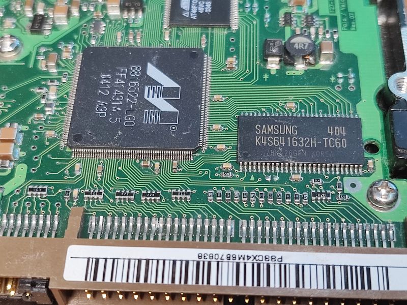

2004 05 - 80 GB Samsung SP0812N - 3.5 .
Second 80 GB, slightly older:
Samsung SP0812N hard drive on a wooden table Image of the internal electronics of an old hard drive on a wooden surface. .
The construction is similar, you can see, for example, the SRAM (K4S641632H), but here its memory amount is smaller:
Close-up of a HDD circuit board with visible integrated circuits. Internal HDD electronics with visible components and moisture traces. Close-up of a hard drive PCB with visible integrated circuits. Close-up of hard drive electronics with visible components on a green PCB. Close-up of hard drive electronics with visible components on a green PCB. .
The flash here, however, is not in an "eight-leg" case - Instead, there is an AT49F1024. There is no serial (SPI) interface here, only a parallel interface:

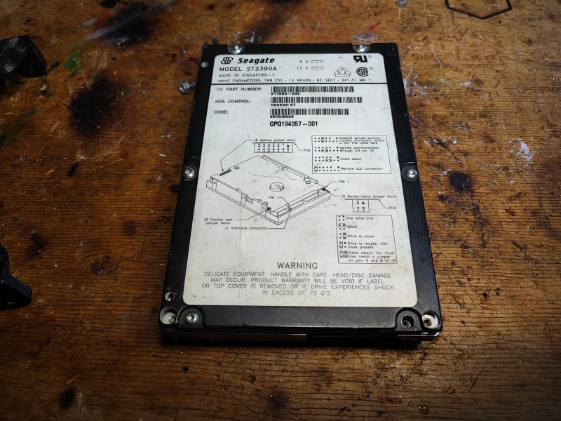

1994 - 341 MB Seagate ST3390A .
The oldest disk in my collection. I based the date on the sticker from the centre.
Front of Seagate ST3390A drive with label on a wooden table Label of Seagate ST3390A 341 MB hard drive from 1994. .
There is information on the label about the number of cylinders, sectors, etc, as well as the roles of the jumpers.

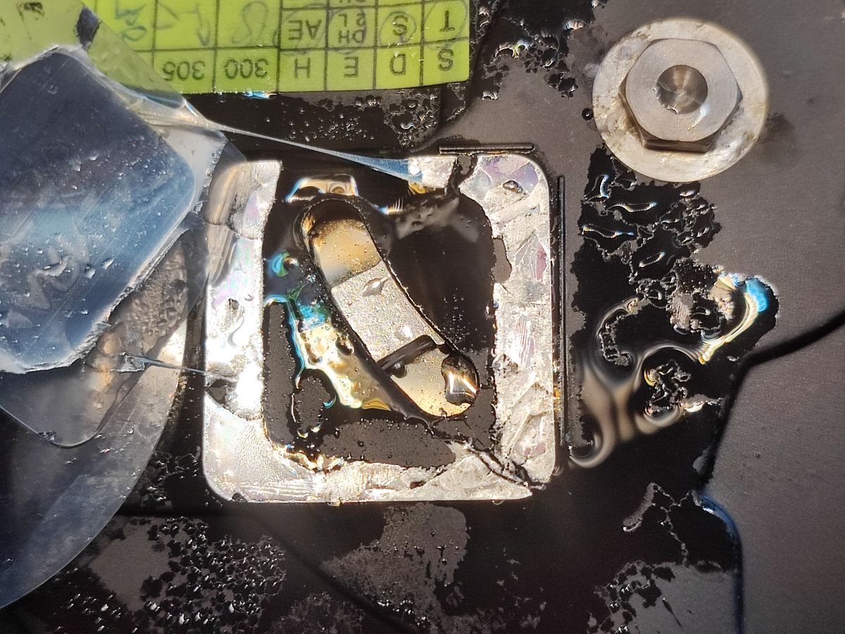

Marking sticker - anyone know what the symbols S, D, E, H, etc. there mean?
Informational label on an old Seagate ST3390A hard drive from 1994. Close-up of a warning label on a flooded Seagate hard drive from 1994.

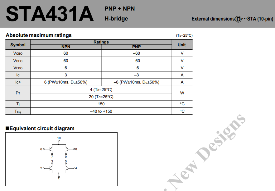

Electronics:
Basically here we have everything more divided into separate ICs. There is even a separate STA431A present - the H-bridge for motor control:
Specification of STA431A chip with maximum ratings and circuit diagram. .
In addition to the same as before, memory, etc.

What's under the sticker:
Flooded hard drive with visible droplets of water and a warning label. Flooded hard drive with visible water and corrosion traces. .

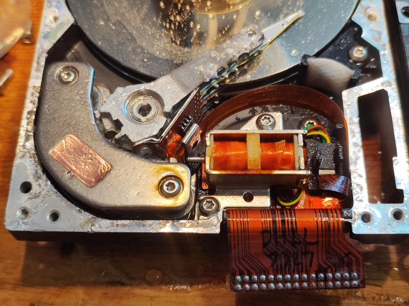

Interior, obviously one plate, all more massive:
Image of the interior of a flooded HDD. .

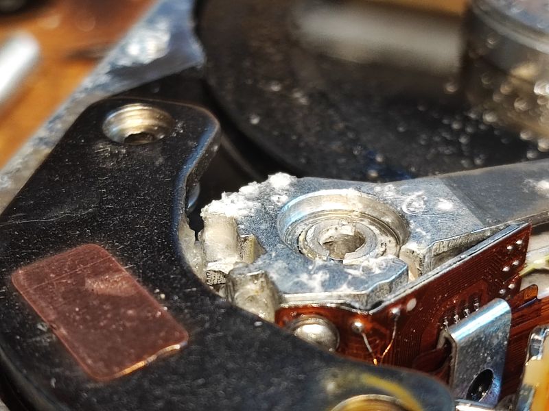

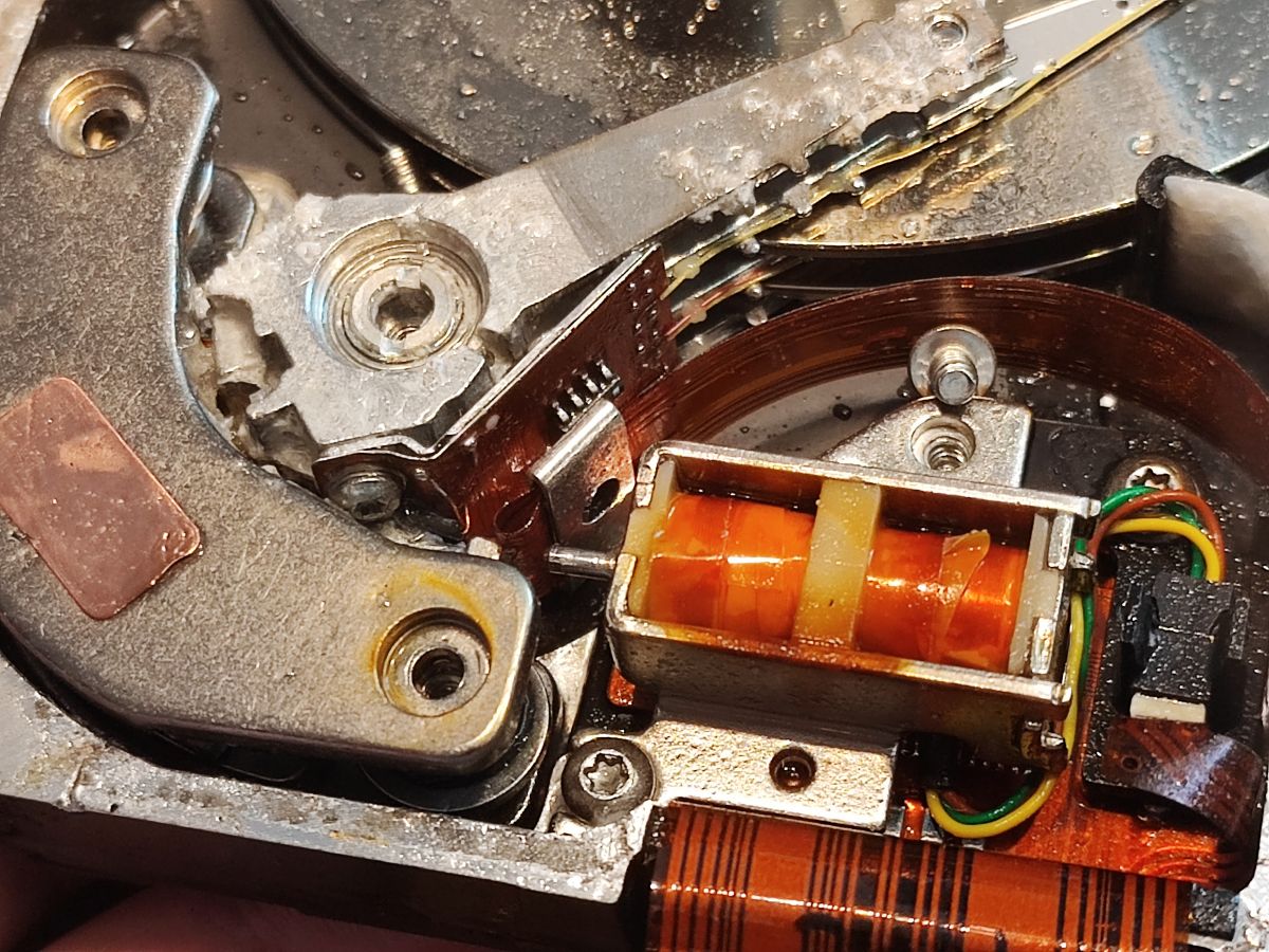

I also see a component inside that looks like an actuator, is that something for parking? I haven't seen that in the newer drives:
Interior of a hard drive showing signs of moisture Interior of a damaged hard drive with visible moisture. .
What is the raid on the arm?
Interior of a hard drive showing signs of moisture and damage. Close-up of an HDD arm with visible signs of corrosion and residue. Close-up of a hard drive arm with visible residue.
Head:
View of a hard drive interior with visible water droplets and a head arm. Image of the inside of a hard drive showing the head and platter covered in moisture.
