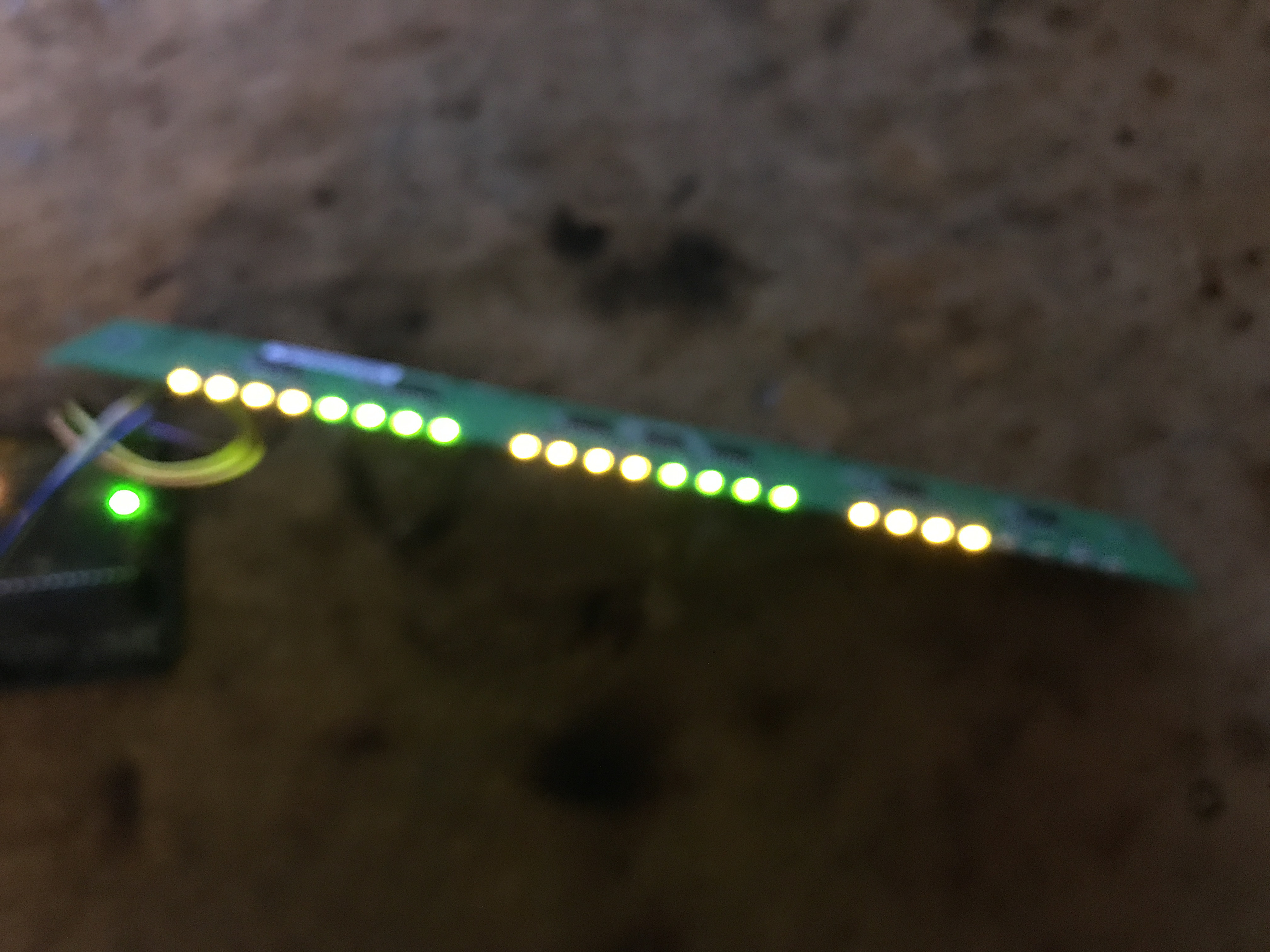

For now, I'm sending a 32-bit number, in this case -1, which in bit representation is 0xFFFFFFFFFFFF, which is the lit bits themselves, and then I'm sending the lit bits themselves. I want something to blink.
Apparently something is working, but why alternate?
And I already know, because, after all, those LEDs there are two colours.... so there's a total of 24*2 = 48 bits there, and I'm only sending 32 bits. Additionally, I don't reset anything, so basically I send bits [0,31] first, then [32, 47] and again [0, 15], and so it loops....
I was too hasty in making that first attempt, but I already know what's wrong.
This is now the second attempt. 48 bits is maybe 6 bytes, so I made an array. It was also a bit tempting to use a 64-bit type, but the array will come in handy for demonstration. Now I'm specifically sending 48 bits, so I reckon each new transaction will write a new separate queue of LED states.
Code: C / C++
Still need to test this - one LED for now:
Code: C / C++
Testing:
It works!
