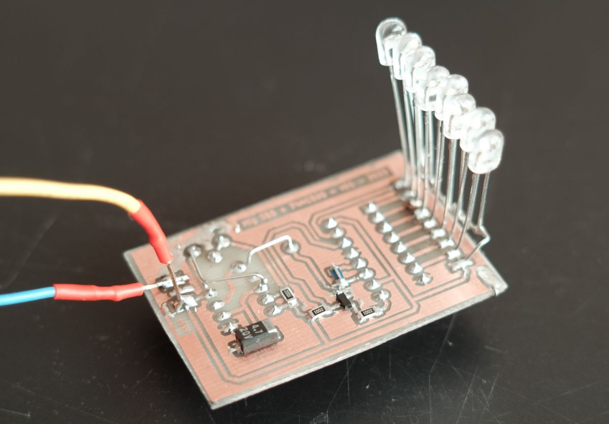

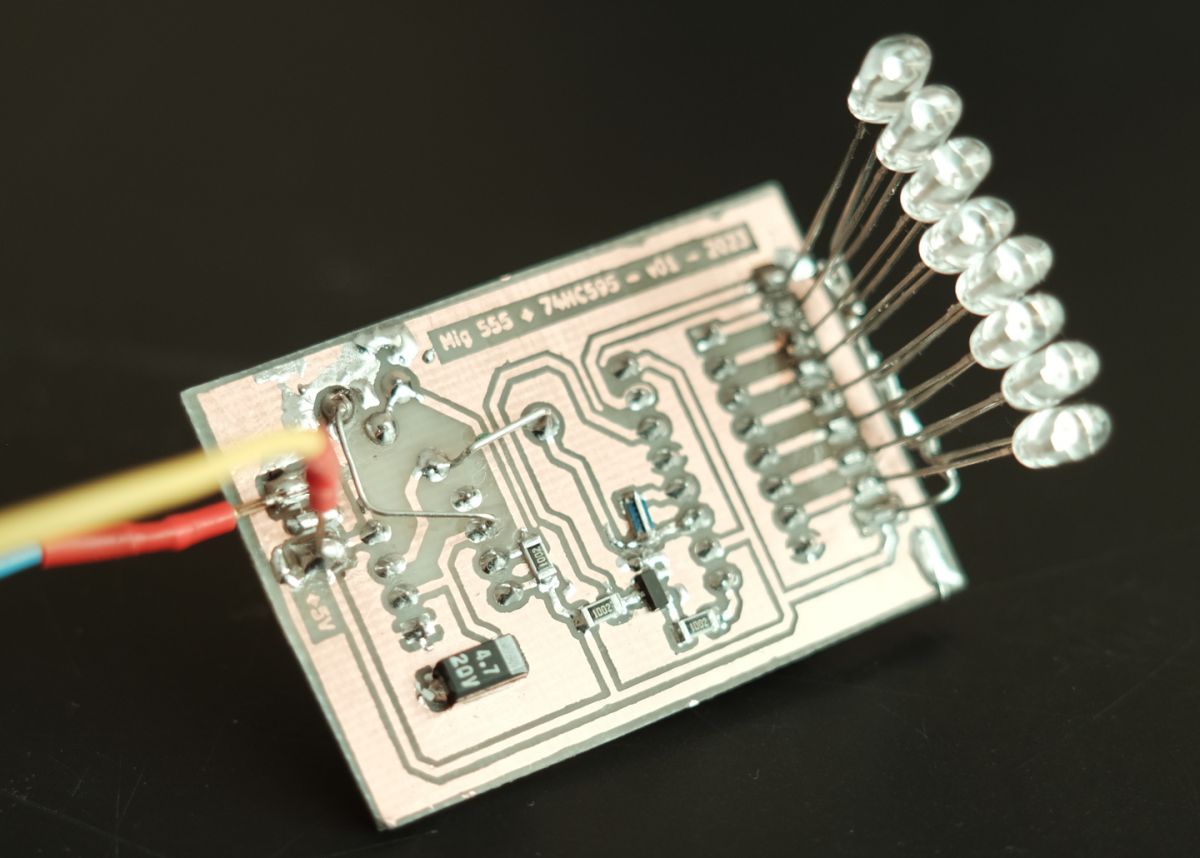

    Before Christmas, I was asked to make a simple Christmas tree decoration. Among many possibilities, I chose the floating light effect. It can be observed in "ignicle lights" on Christmas trees at Christmas fairs, in new luxury cars (floating indicators), or in the form of light floating in a circle (an interesting application is e.g. a bicycle rear light). It should be noted that this is not a shining running point, but a gradually lit line of light, which in the second phase gradually goes out, giving the effect of a wider moving light.
    Floating LED light (LED chaser) Floating LED light (LED chaser) Floating LED light (LED chaser)

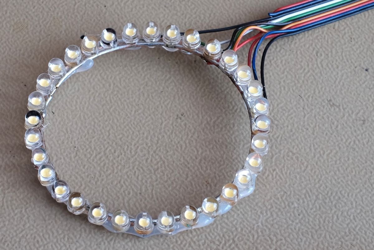

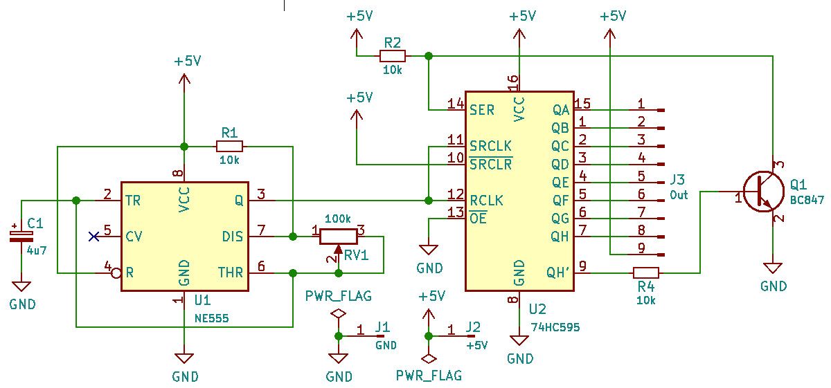

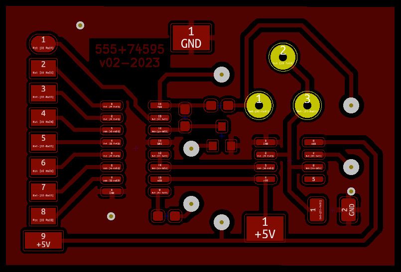

    In this mini-project, I present a scheme proven in practice (there are usually various "interesting" errors on the Internet - I have been trying to combat this thoughtless practice for years), a single-sided PCB (in SMD technology) and the arrangement of elements. In my case, I power the system with a single Li-Ion 18650 cell with an attached charge/discharge control module (of course, the diagram does not take this into account, I use a known module with a nominal value of PLN 1-2).

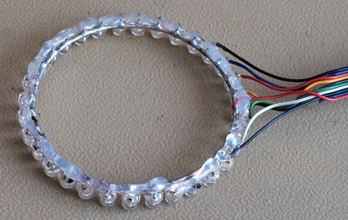

    As you can see, there are no LEDs on the PCB, I made this glowing ring (in my case) in a three-dimensional form, using an idea from YT (just enter the phrase "74HC595 LED chaser"). On the PCB we have 8 outputs for cathodes and plus power supply for a common anode (in my case it is in the form of a circle made of thicker copper wire). When powered by one Li-Ion cell, LED resistors are unnecessary. It is worth adding that we can divide such a circle into 2 or 4 parts and solder 8 LEDs in each section. The potentiometer (peer) is used to change the speed of the effect.
    By the way, here`s a tip to help you make a nice circle with LEDs. First, we draw a circle, divide it into 8, 16 or 32 parts and mark the points for drilling 5mm holes. Then we stick our sketch on a piece of board, drill for a few minutes and we have a perfect template. Such help allows you to make many copies of the system in a repeatable way.

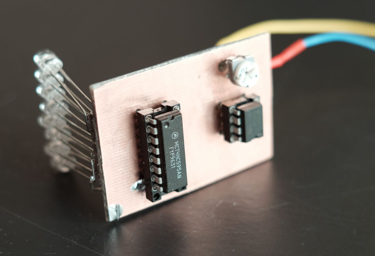

    Here you can see the first, prototype version of THT (I still had to make a few minor corrections here, as can be seen in the title photo). This is basically the finished "floating turn signal":

  • Varnished prototype instead of solder mask
    #11 20900987
    yogi009
    Posts: 14697
    Help: 848
    Rate: 2655
    Jarzabek666 wrote:
    why don`t you protect the PCB with a solder mask after milling?
    Because this is the first training prototype (made in THT), I ultimately made the second version in SMD and this one was treated with varnish for electronic boards. I don`t need Soldermask to be happy, I don`t intend to buy it wholesale and sell it. It was supposed to go to 2-3 Christmas trees and it did.
    And the basic question: what kind of milling? :-)
    Added after 3 [minutes]:
    saly wrote:
    Your home plate is the iron or exposure method. Nice quality
    It`s a classic iron, I`m not particularly proud of the result, but it`s more than enough for these purposes.
    As for the educational value... I chose this project because it works a little differently than 555 and 4017. Not every young electronics engineer has encountered 74HC595, and here he has a good opportunity to analyze how this logic system works. And I consciously promote the lack of a microcontroller, I agree with you, we need to show that before the era of processors, quite intelligent devices were built.

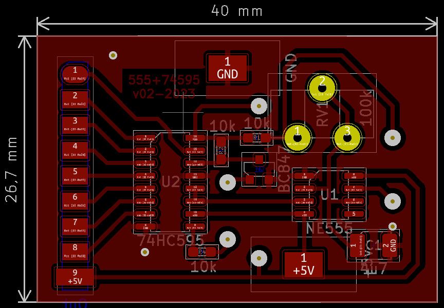

    Cool project! What program did you use to design the printed circuit board? Once upon a time, as a young boy, it was a lot :P I soldered things like that. But some time ago, as a reminder of the old times, something like this was created (and one more miracle, but I don`t have a video here, maybe there will be one someday).
    KiCad :-)

    I used to draw some simple circuits in KiCad, but I didn`t design the board itself. How do you rate the friendliness of the user interface and reducing the risk of errors? Is there any control?

    I switched to KiCad when Eagle was bought by Altium and the subscription was introduced. KiCad has a slightly different way of flowing information, there are simply further steps that need to be followed. Once you learn these simple rules, KiCad is quite decent for such small projects. Also the main thing is to change learned habits from previous applications.

  • 10 nF decoupling capacitor on NE555 pin 5
    #19 20923341
    damian1115
    Level 37  
    Posts: 3238
    Help: 393
    Rate: 904
    You did it quite nicely, I like it, I have it +.
    The system is simple and worth recommending to younger "electrode" students. Putting together a KIT is not the same as building something yourself, especially when it requires planning and etching the board from scratch.
    You could post a video of the system in operation, then perhaps it would attract the attention of beginners more.
    By the way:
    I would put a 10nF decoupling capacitor between the fifth pin of the NE555 and ground, it will prevent possible disruptions in the system.

    A decoupling capacitor is always useful, although here it is not a major issue. However, NE555 applications provide for such an element.

    The principle is very simple. We have 8 outputs that create the effect of flowing "droplets" of light. We can make 8 LED, 16 LED or 32 LED modules. Here we have the last version. 32 diodes are 4 sections with 8 outputs each. We connect LEDs no. 1, 9, 17 and 25 in parallel to the first output. Output no. 2 to the next ones and so on. You can also connect diodes in other systems, e.g. with 16 LEDs, we connect LEDs 1 and 16 to output 1, LEDs 2 and 15 to output 2, and so on. Here we are limited only by our imagination and the output current offered by the 74HC595 system.
