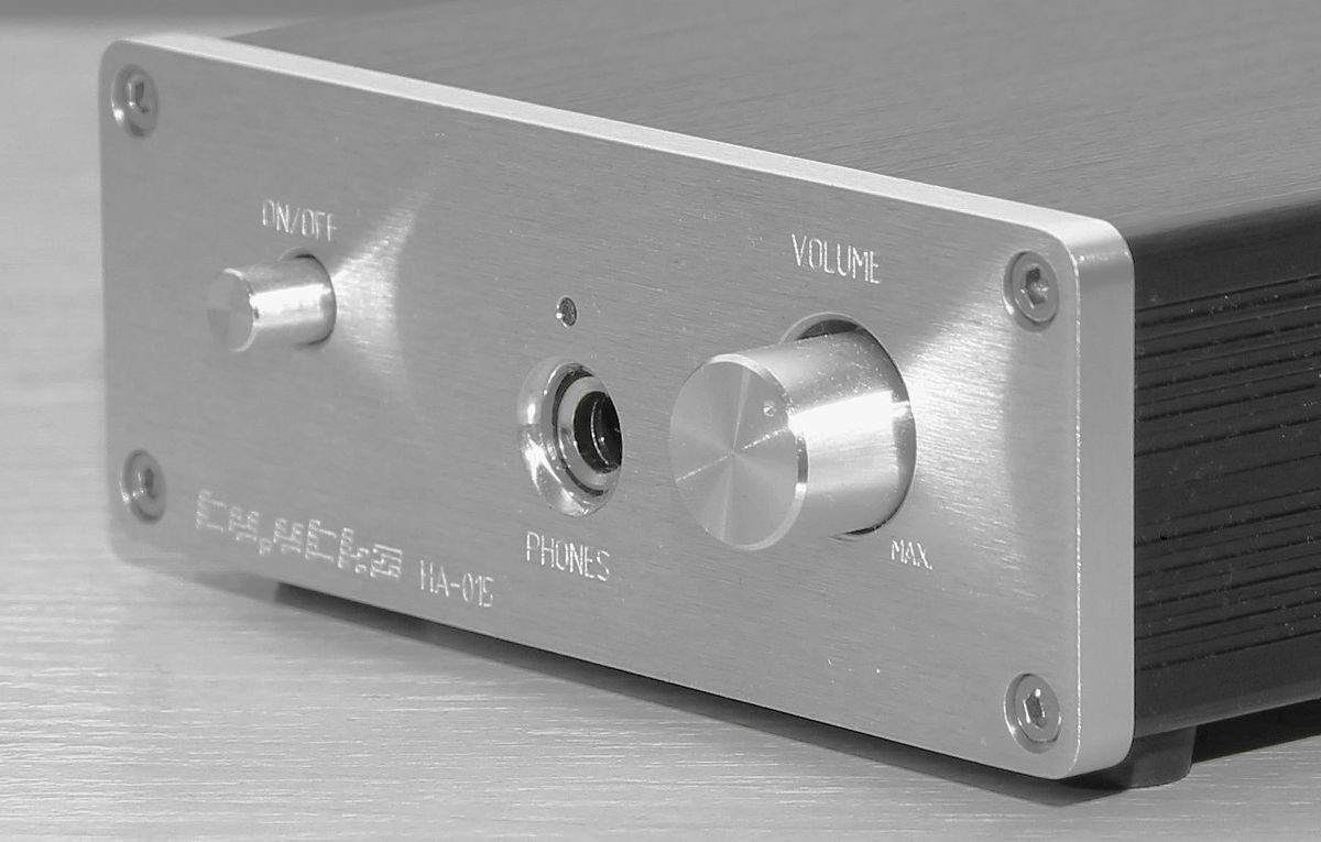

Close-up of the front panel of a headphone amplifier with on/off switch, headphone jack, and volume knob. .
The design of this headphone amplifier, is actually an update of my earlier design presented here ( Link ).
Compared to the original version, a few things have been changed. The one that is immediately apparent is the casing.
The new housing is slightly larger. Its internal dimensions are: 105 x 160 x 35mm (with external: 115 x 168 x 40mm). The dimensions of the amplifier board are: 97 x 159.5mm. So, there is now slightly more space. The board itself is now not pushed into the profile, but fixed to the underside of the case, via spacers 5mm high. From the side edge of the plate to the side wall, there is 4mm of space on each side. The area of the housing that is adjacent to the mains voltage area of the PCB has been shielded with 0.5mm thick pre-shrink. The mains cable exit from the enclosure, is sheathed in a dedicated rubber bend.
All the work involved in machining the raw case to adapt it for this project was done by myself.
The lettering was engraved, using a small, simple CNC machine.
Just to pre-empt any questions, I would like to inform you that this time the engraving was not filled with paint on purpose. The idea was for the description to be there, but relatively subtle.
