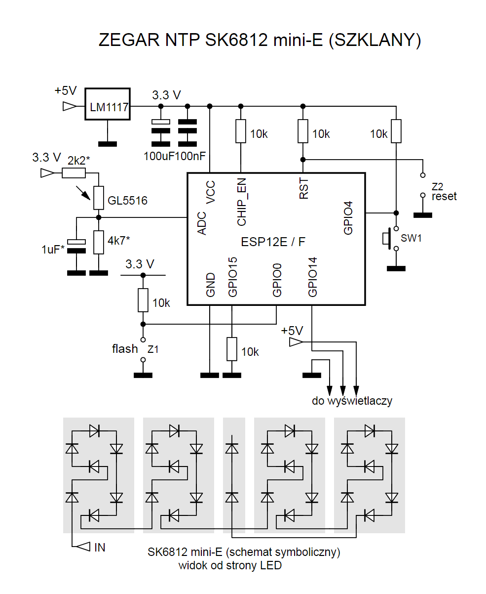

The SK6812 mini-E LEDs (2.8x 3 mm) were used in the design, due to the small size of the display. These LEDs can be addressed similarly to the WS2812. This of course limited the number of wires connecting a single display to 4.

The electronics are a handful of components. At its heart is the ESP8266. The displayed time is taken from NTP servers.

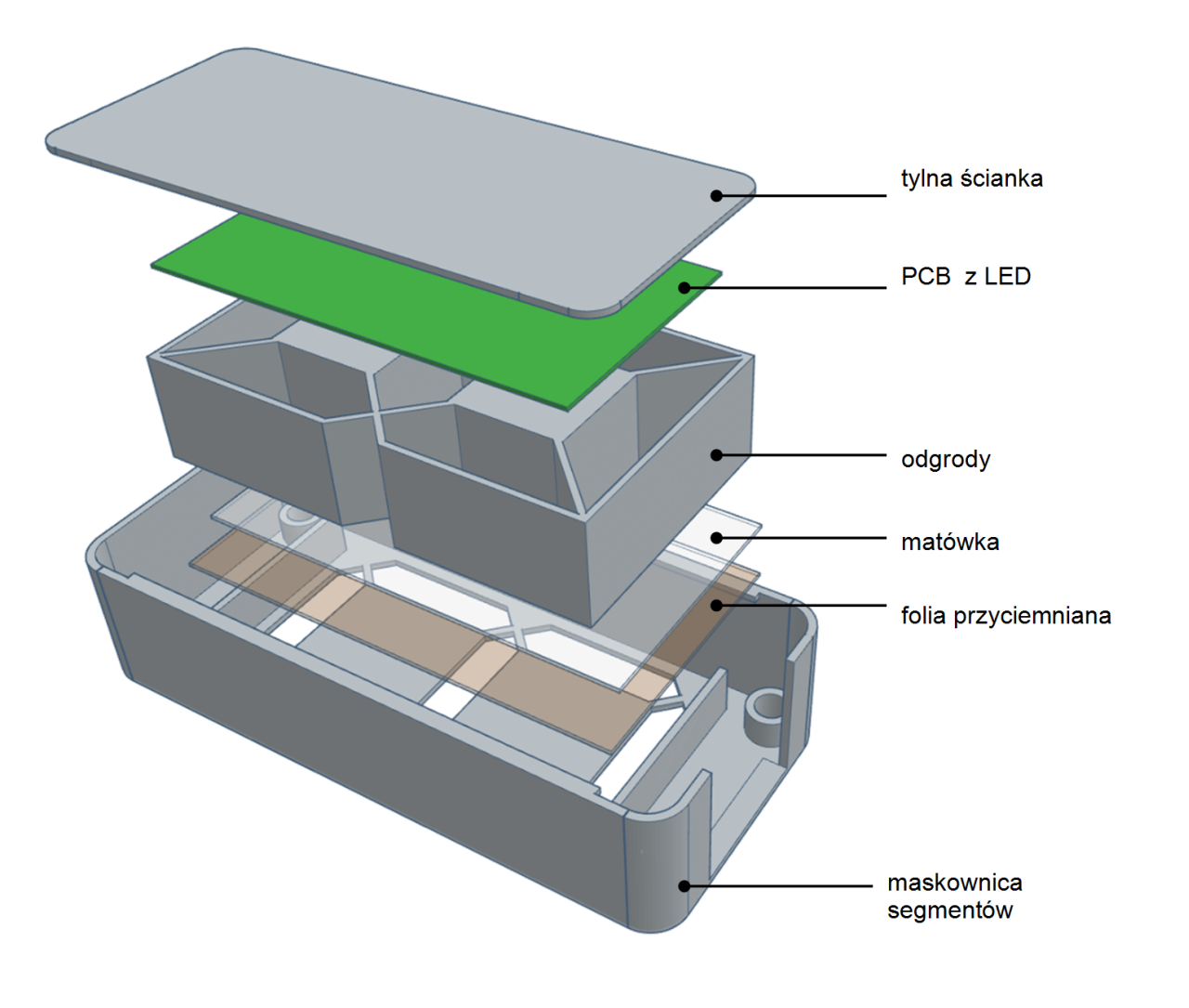

The fenders of the digits are covered with white veneer for better light diffusion. They can also be painted.
Four LED number displays on a wooden surface. .
The components of the digit housing.
Components of an LED watch display .
Order of assembly. All elements are assembled with a snap (no glue).
The back cover can be printed in white or transparent plastic. This results in a slight glow on the back of the watch.
Diagram of an LED display with layers and components. .
Assembled numerals.
Two prototype LED displays on a table. .
The cover mesh needs to be pre-matched with the display switched on before it is cut to size in order to select the optimum position of the holes in relation to the display segments.

There is no fixing here.
View of the back of the clock with visible PCB board. .
Finally, a mother board is attached to press down the display PCBs.

Scheme:
Electrical schematic of an NTP clock with SK6812 mini-E and ESP8266 module. .
