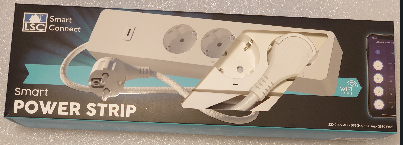

As sold in the Action stores (NL, Dec 2024). First some images:
Packaging of the LSC Smart Connect smart power strip with WiFi functionality.
Packaging of a power strip with four sockets and a button.
White power strip with four outlets and a power plug.
