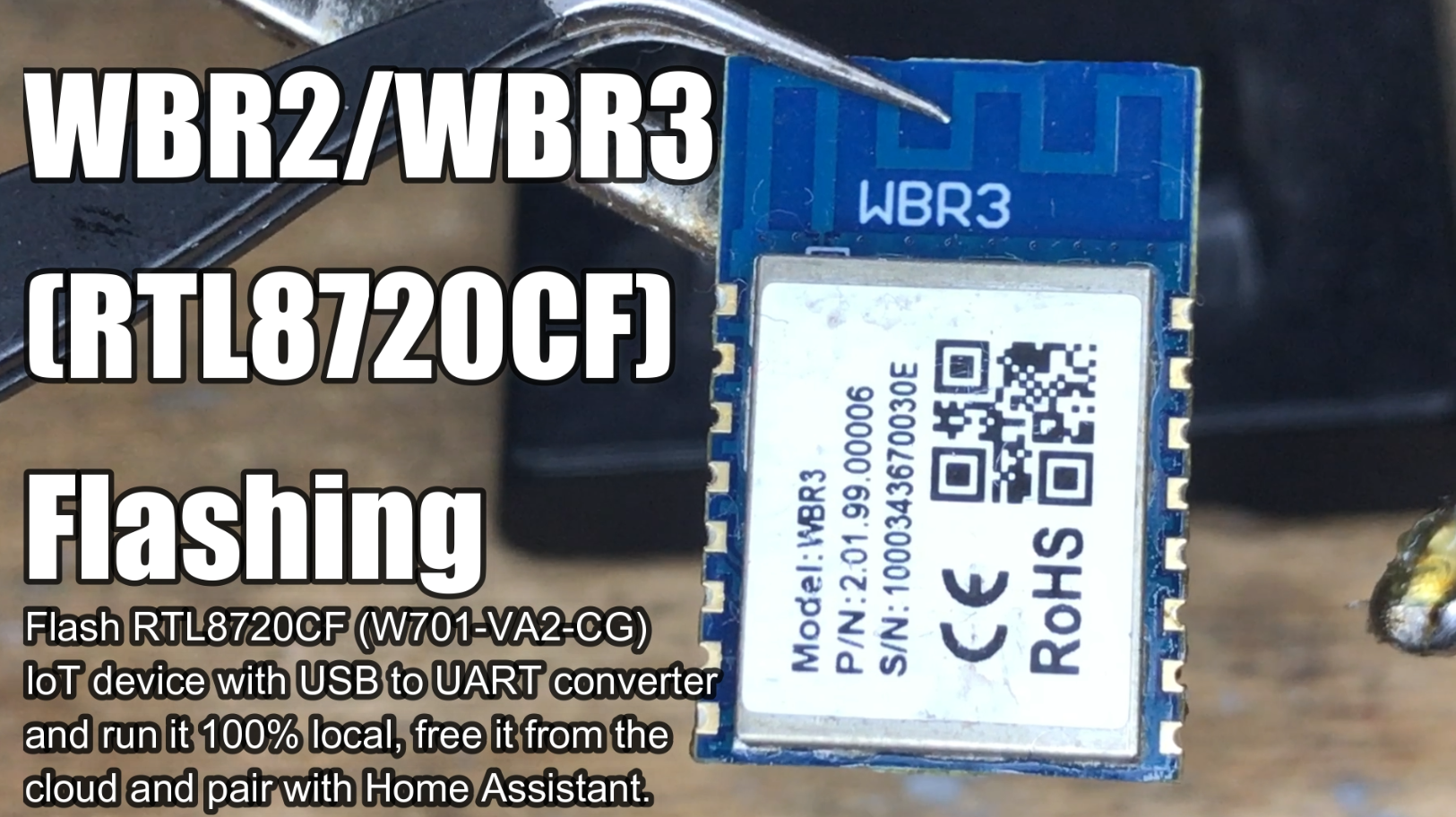

Shows how to flash WBR2 and WBR3 modules built around the RTL8720CF/W701-VA2-CG chip.
Uses a step-by-step soldering guide with a few extra wires, similar to flashing ESP modules.
Covers WBR1, WBR2, WBR3, WBR2L, WBR3L, and WBRU modules, with English and Polish text guides.
Lets you replace firmware, free devices from the cloud, and pair them with Home Assistant.

a user on this forum kindly sent me some WBR3 modules for testing. The location of those pads on the rear is a pain, as already stated.

Will you route out the pad on the module back? I did it, just to be on the safe side - it may be needed if I brick the OTA.

yes. initial idea is that all should be routed to the outside case for every eventuality [Read more]
06 Feb 2025 12:47
So you have two options:
1. do just like me, route out a wire
2. is this just a twosided board and copper ground pour is on both sides onder WBR3 place? If so, maybe you could... well, carefully cut... [Read more]
06 Feb 2025 12:53
likely this, but maybe with thin enamelled wire
hadn't thought of this, but it looks like most of both sides are covered by a ground plane so that would need careful avoidance/isolation from the... [Read more]
