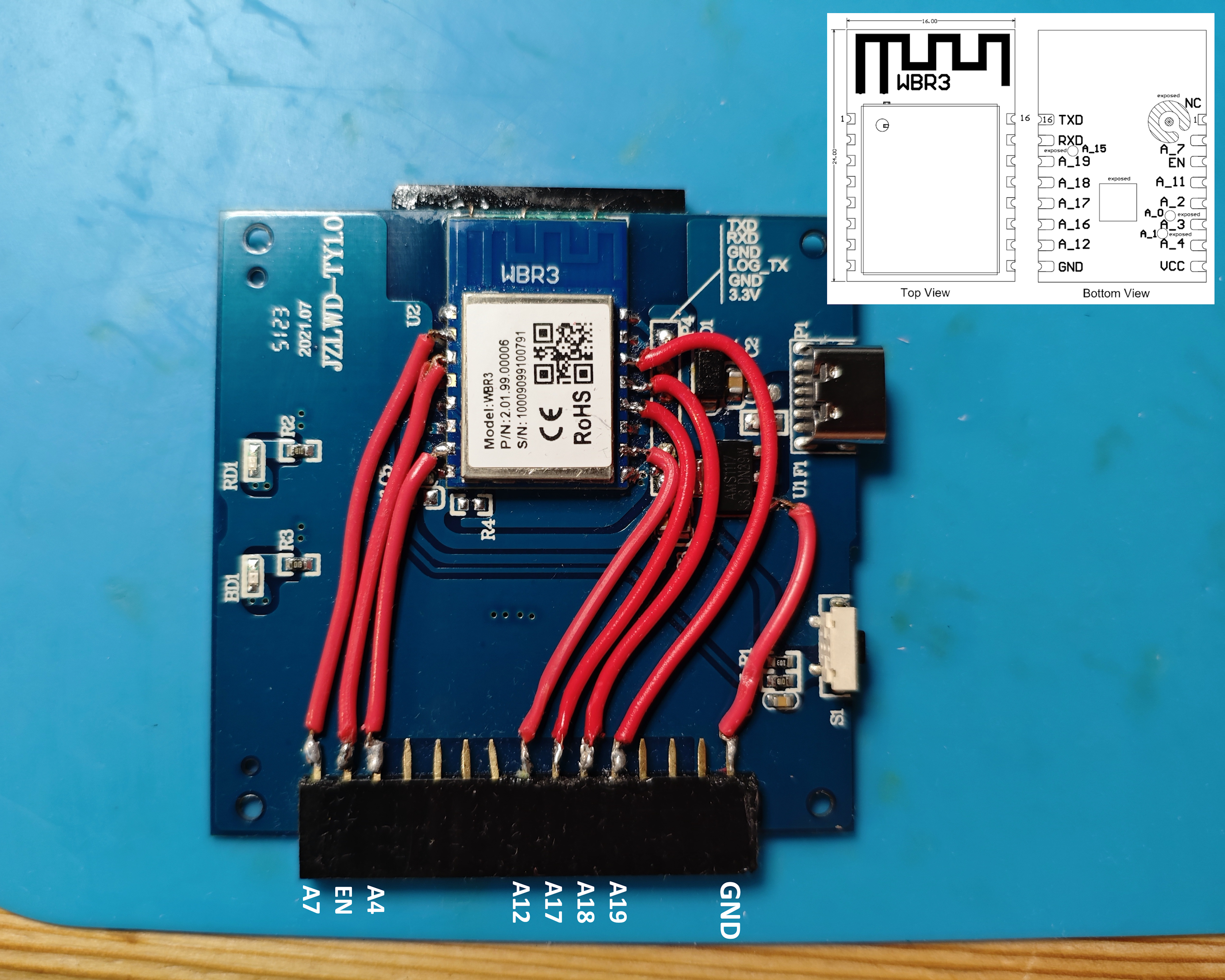

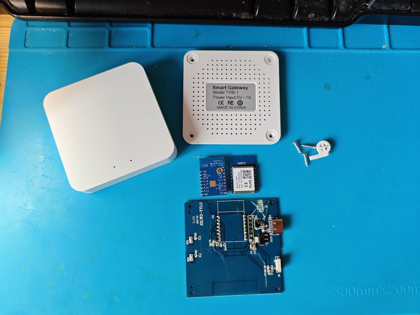

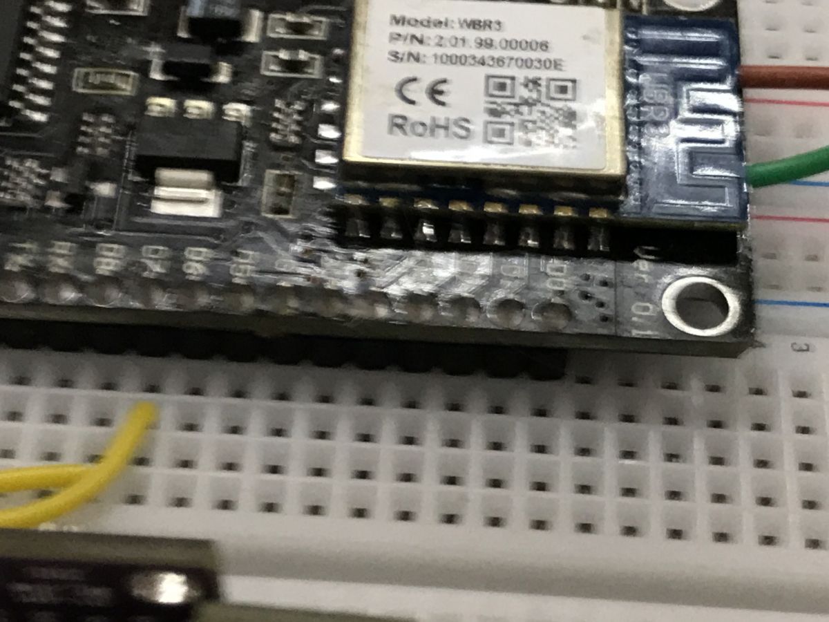

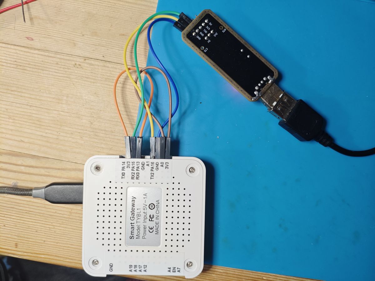

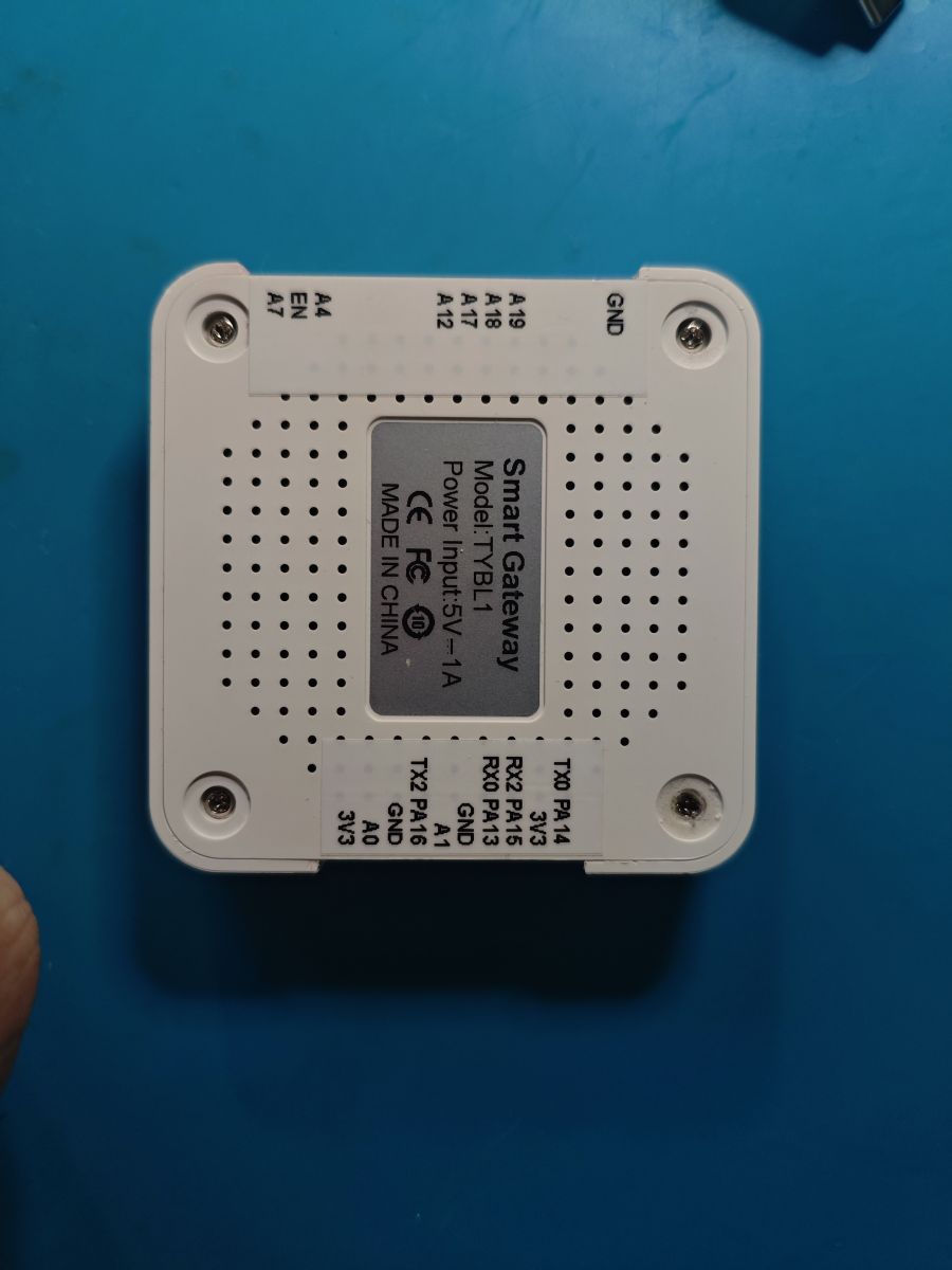

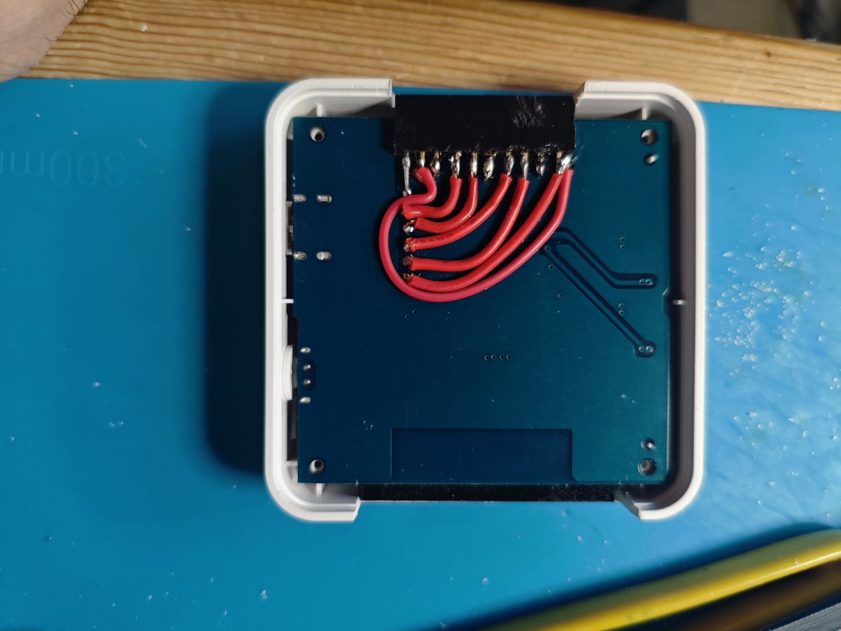

    a user on this forum kindly sent me some WBR3 modules for testing. The location of those pads on the rear is a pain, as already stated.
    I think I will turn the CR3L Bluetooth Gateway chassis into a WBR3-type dev board. Similar to your NodeMCU hack here https://www.elektroda.com/rtvforum/topic4097185.html#21375394 and other NodeMCU/NiceMCU conversions
    https://www.elektroda.com/rtvforum/topic3973321.html
    https://www.elektroda.com/rtvforum/topic4095663.html
    With the CR3L removed, and unlikely to return, for testing in other adaptors I think a series of jumper headers could easily be routed to the case for easy-access testing of all available GPIOs on this module. Any ugly routing of pads on the rear of the module will be hidden inside.
    Disassembled Smart Gateway with WBR3 modules on a blue mat.

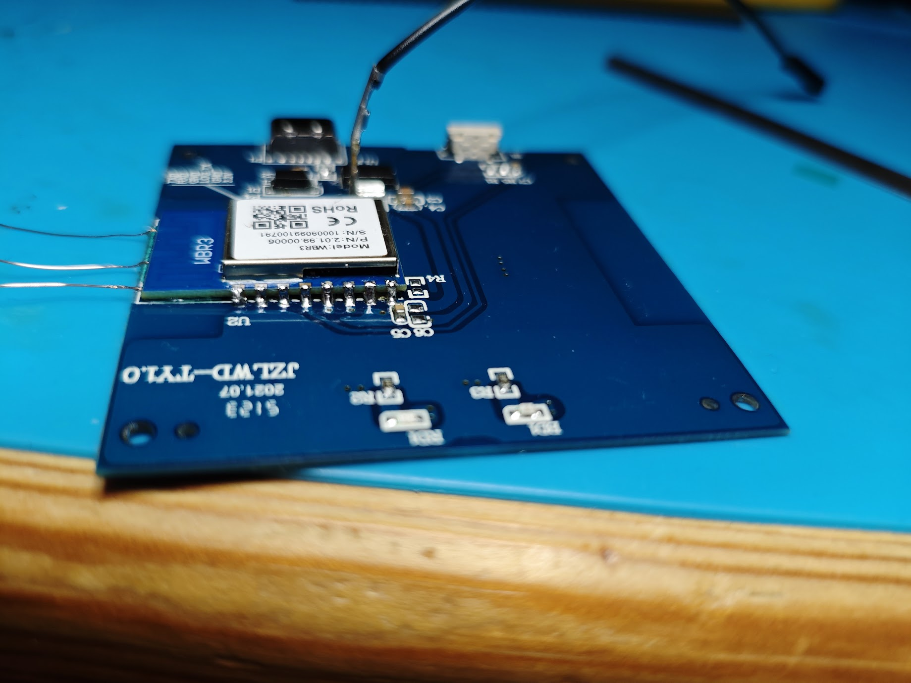

  • #3 21427247
    Posts: 14755
    Rate: 12881

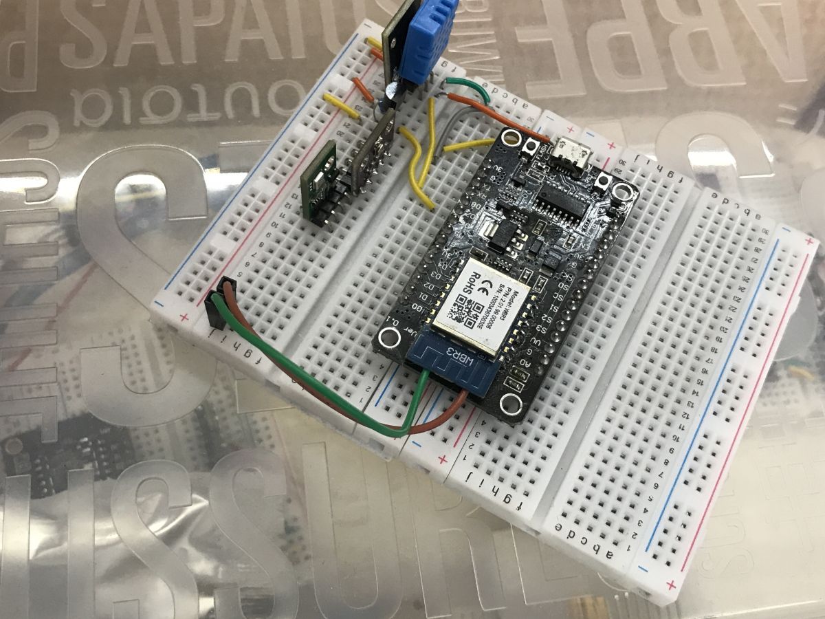

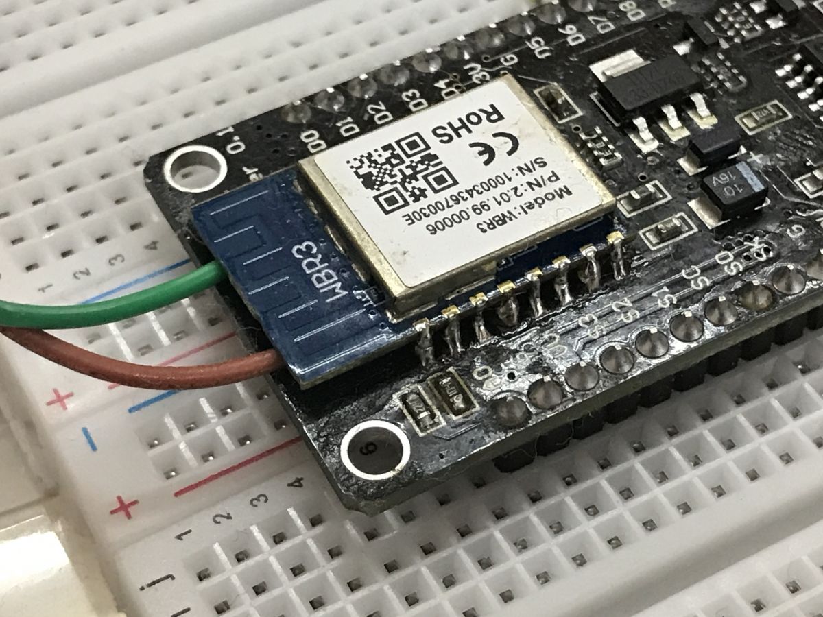

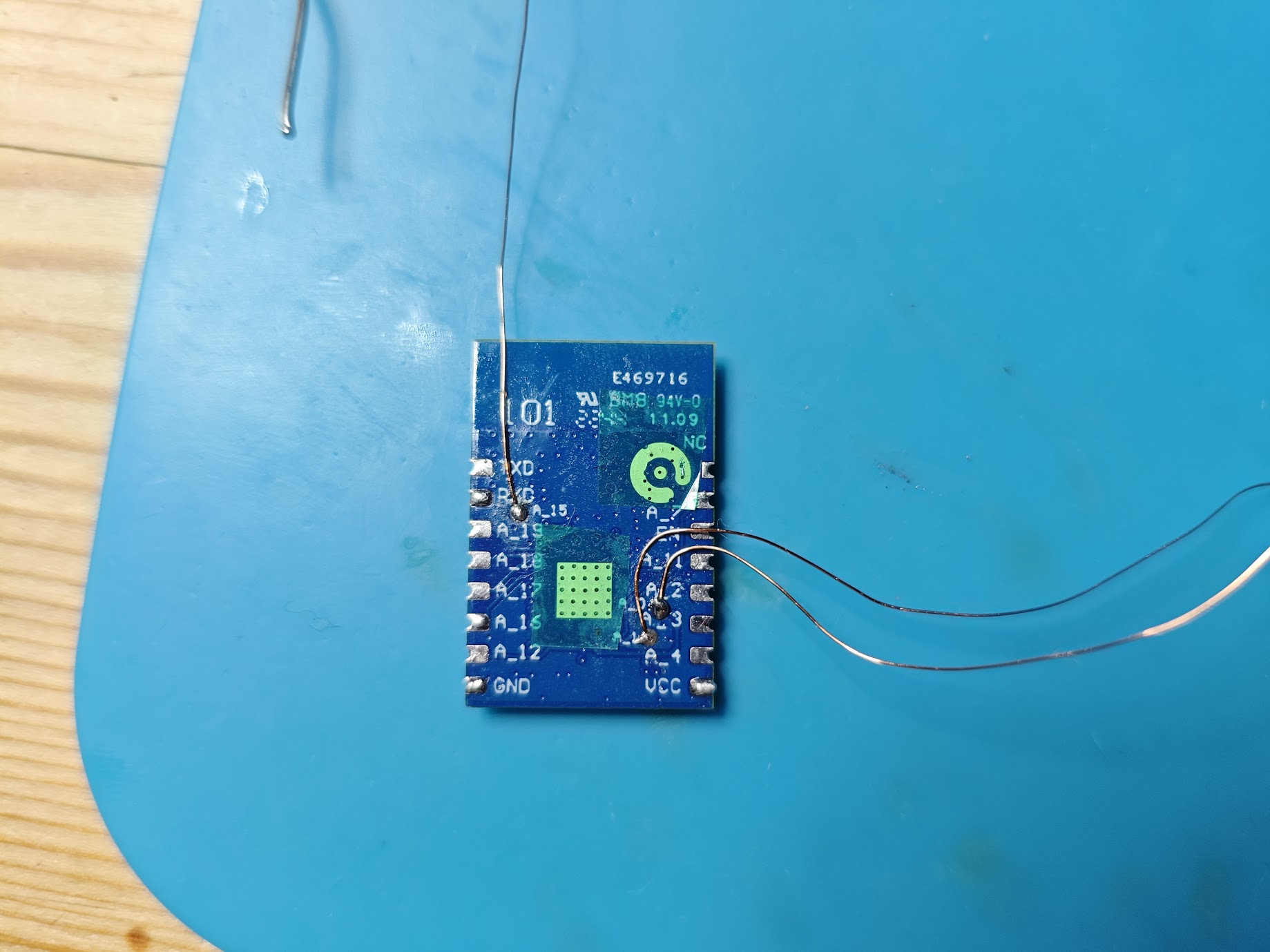

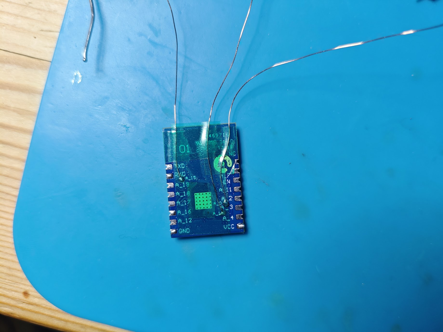

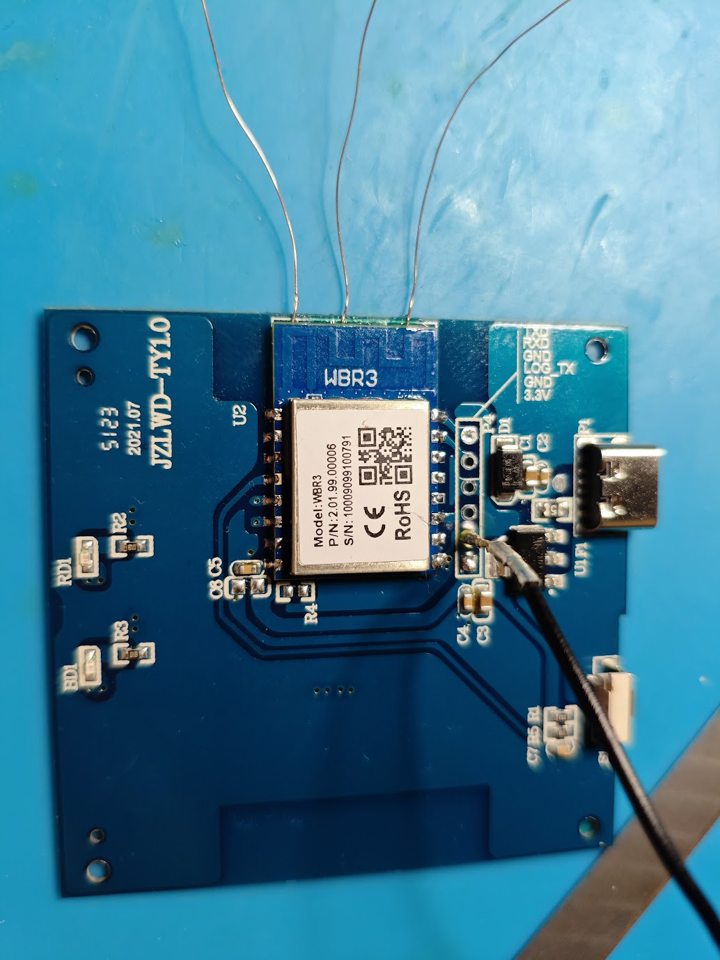

    Will you route out the pad on the module back? I did it, just to be on the safe side - it may be needed if I brick the OTA.
    Electronic module placed on a breadboard with connected wires.
    Electronic module on a breadboard with soldered wires.
    Electronic module placed on a breadboard.
  • #4 21427250
    Posts: 5212
    Help: 446
    Rate: 914
    yes. initial idea is that all should be routed to the outside case for every eventuality
  • #5 21427264
    Posts: 14755
    Rate: 12881
    So you have two options:
    1. do just like me, route out a wire
    2. is this just a twosided board and copper ground pour is on both sides onder WBR3 place? If so, maybe you could... well, carefully cut the board under it to expose the required pad? Still ,it may not be the best idea
  • Wire routing or board cutting for WBR3 flashing
    #6 21427272
    Posts: 5212
    Help: 446
    Rate: 914
    likely this, but maybe with thin enamelled wire
    hadn't thought of this, but it looks like most of both sides are covered by a ground plane so that would need careful avoidance/isolation from the soldered pads.

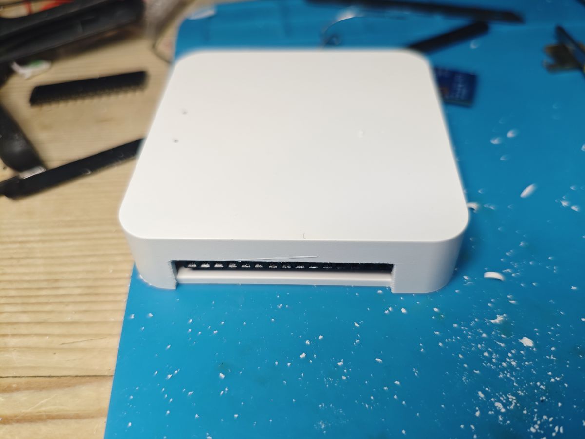

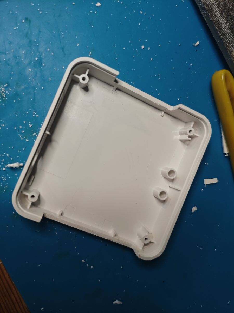

  • Need to sand PCB edges before soldering
    #7 21427346
    Posts: 14755
    Rate: 12881
    The PCB edges would be needed to be sanded with sand paper.

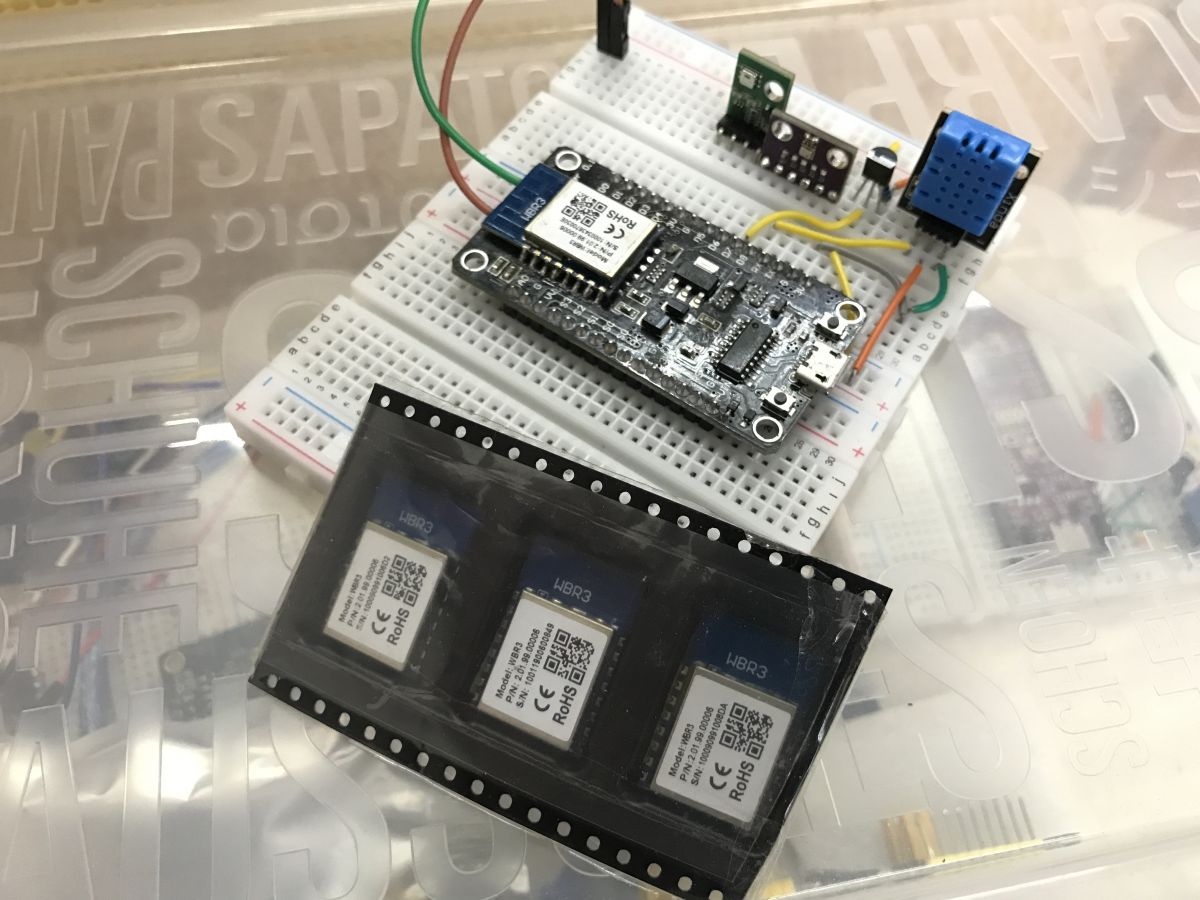

    Btw, I still have those 3 from the reader:
    Close-up of a PCB prototype with electronic components on a breadboard.
    I will probably swap them for ESP soon. One of my switches is still TYWE3S-based, but soon it will run on Realtek. We just first need to make sure that it runs stable enough for wall placement.
    Do you have HA instance running?

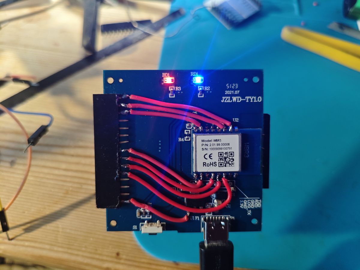

    some progress
    Blue printed circuit board with connected wires on a blue work mat. Circuit board with attached wires on a blue mat. Circuit board with WBR3 module on a blue background.Close-up of a blue PCB with an electronic module and connected wires.

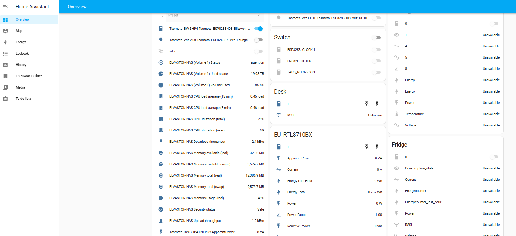

    Added after 8 [hours] 42 [minutes]:
    yes. not prod setup, just testing
    Screenshot of Home Assistant interface showing various devices and their status.
  • WBR2/WBR3 mod exposes A0, A13 and GPIOs
    #9 21430141

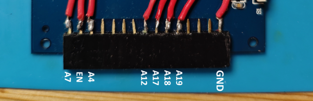

    Posts: 5212
    Help: 446
    Rate: 914

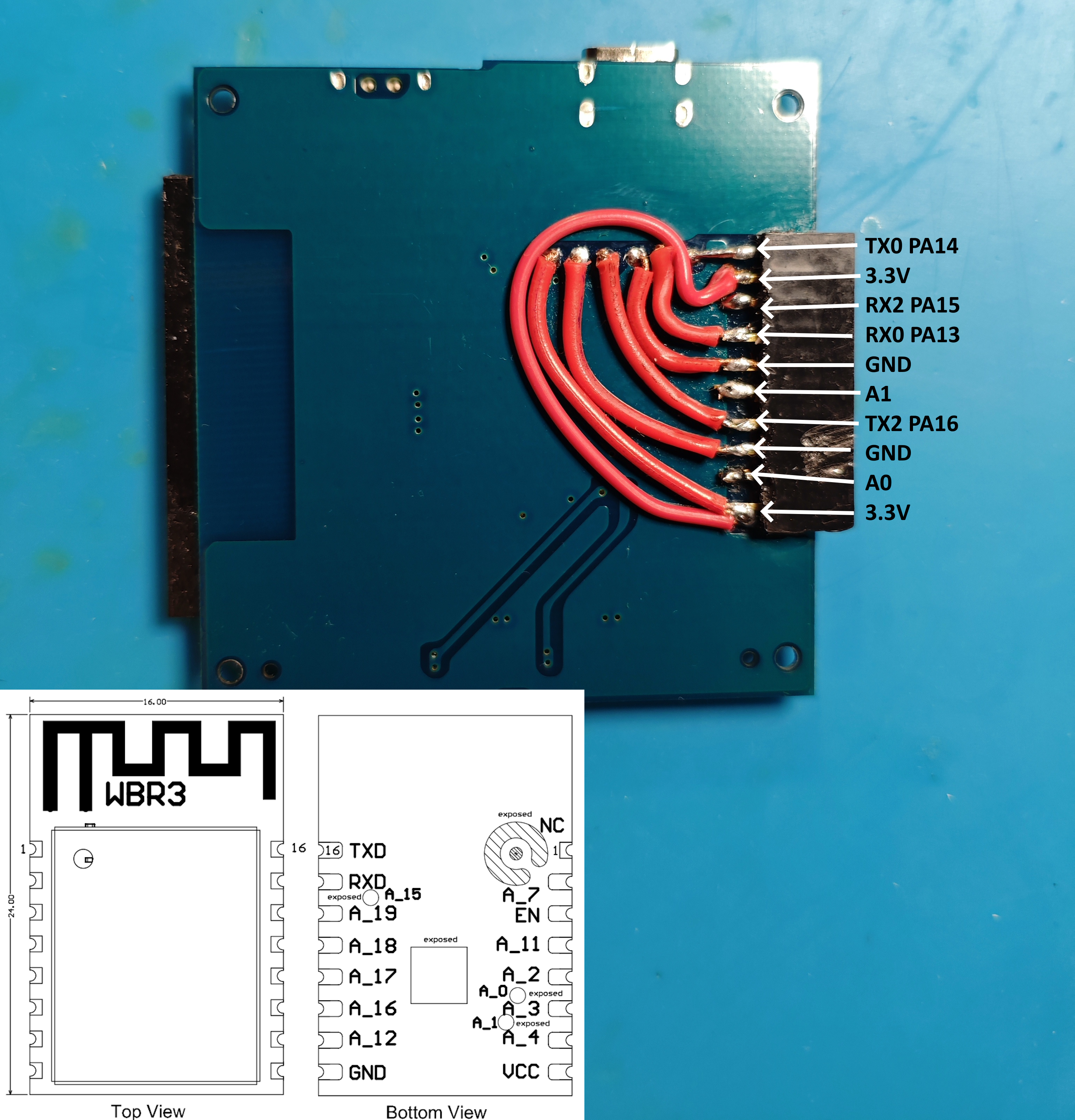

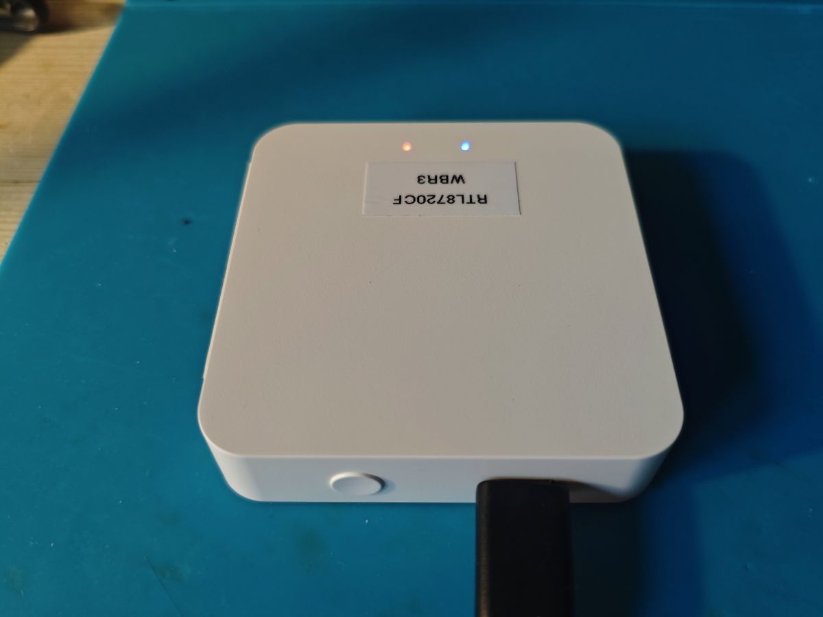

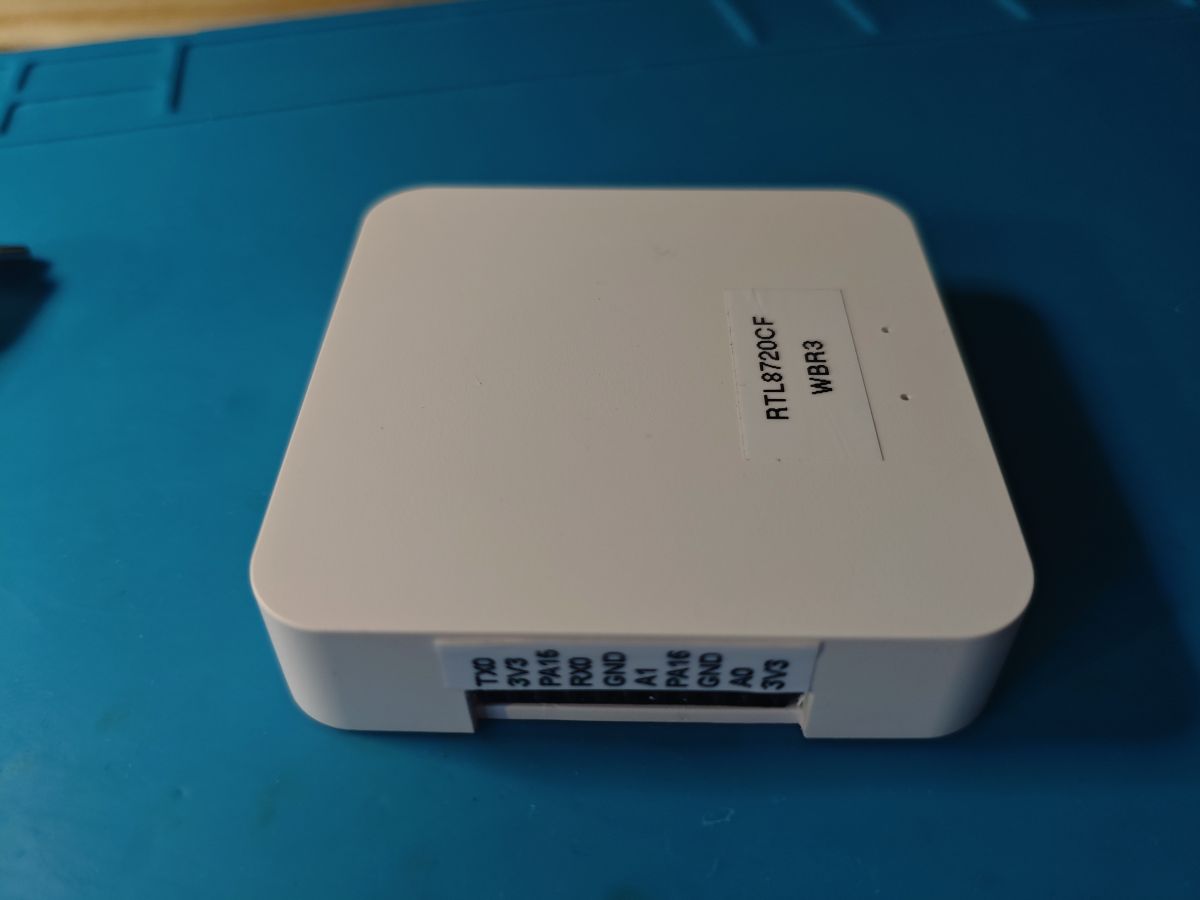

    Image of a circuit board with red wires connected to pins labeled as TX0 PA14, 3.3V, RX2 PA15, RX0 PA13, GND, A1, TX2 PA16, GND, A0, 3.3V. PCB board with WBR3 module and USB-C connector with labeled components.
    White electronic device with two LEDs on top, one red and one blue, and a button on the side. Plastic enclosure of a device with pin labels on the side. View of the Smart Gateway TYBL1 device from the bottom, with port labels and power indication. Electronic module with port and model labels on a white casing. White electronic module RTL8720CF WBR3 with connected USB-C cable on a blue background. White plastic DIY project case with visible cutouts for ports and connectors. Printed circuit board with connected red wires in a white case. Empty plastic enclosure on a blue surface with a tool on the right. Circuit board with red and blue LEDs, button, and wired connections.

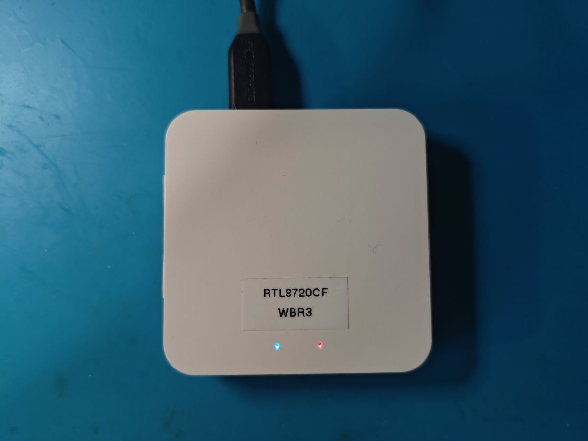

    and now A0 and A13 can be pulled high with ease

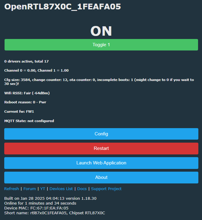

    Electronic device with wires connected to a USB adapter.
    and flashed to OpenRTL
    PA3 - red LED
    PA2 - blue LED
    PA11 - button
    OpenRTL control panel with active mode
    nice 5v USB-C, easy flashing, spare GPIOs, labelled, multiple grounds and 3v3, spare headers for expansion :)
  • #10 21430151
    Posts: 14755
    Rate: 12881

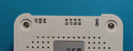

    Very nice idea. Remember to add more grounds and VDD pins in advance.
    Also, we really need to check if it 's possible to print pin names on paper, it would help a lot if we could label this connector.
  • #11 21430457
    which connector?
  • #12 21430463

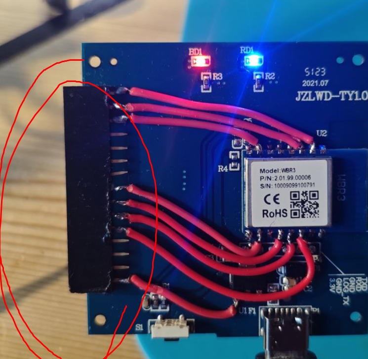

    Posts: 14755
    Rate: 12881
    This one obviously:
    Close-up of a circuit board with an electronic module and red wires.
    I need to do the same for my dev board: https://www.elektroda.com/rtvforum/topic4062695.html
  • #13 21430469

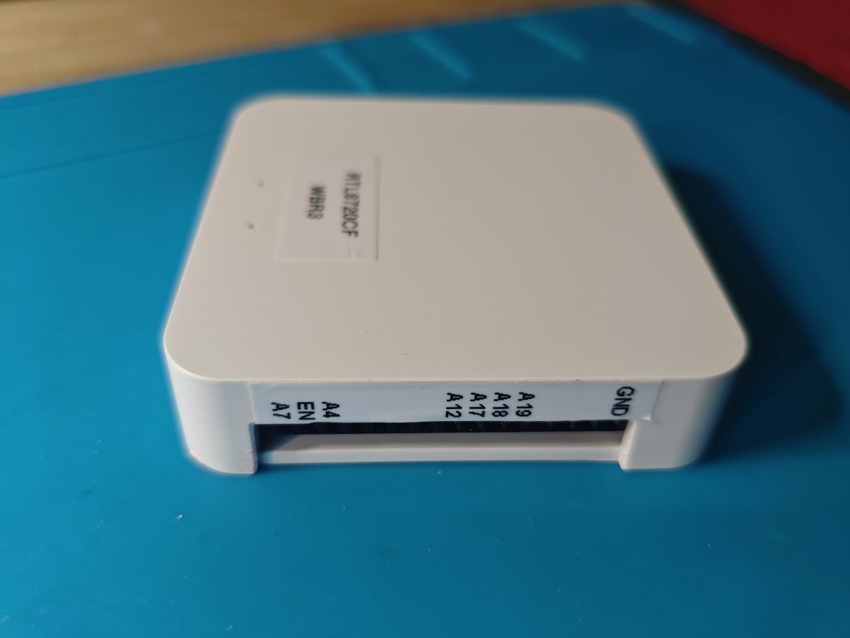

    Posts: 5212
    Help: 446
    Rate: 914
    I have labelled it!
    Close-up of an electronic connector with labeled pins.
    Close-up of a label with pin markings on a white electronic device casing.

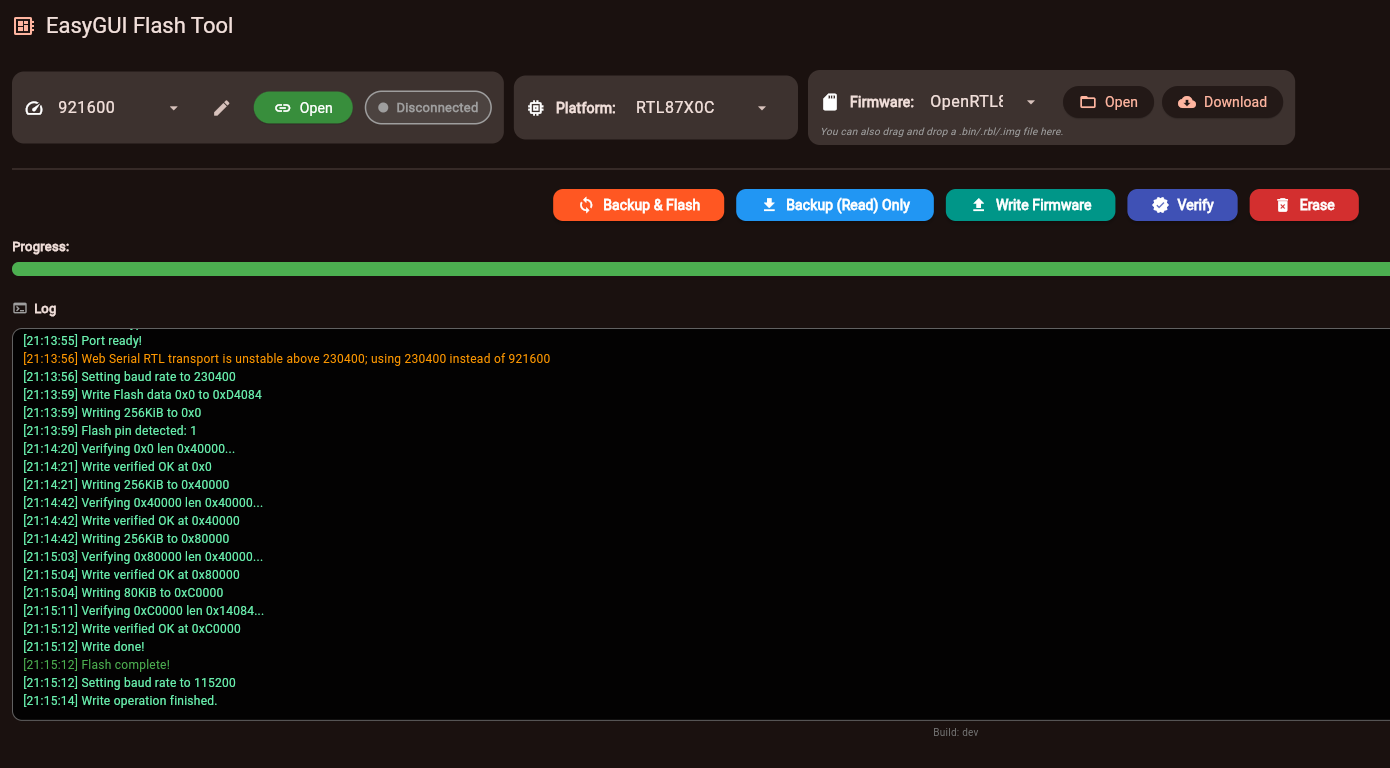

    Posts: 5212
    Help: 446
    Rate: 914
    hmm. fiddly. read is oddly flakier than write, just like EF1 is/was. write and full chip erase OKish. capped baud though.
    Screenshot of EasyGUI Flash Tool with progress bar and flashing operation log
  • #23 21866952
    Posts: 14755
    Rate: 12881
    Sure, let's have it. Can you open a PR? Do you test only in web browser or also on Windows? I noticed that serial backends are a bit different between platforms.
