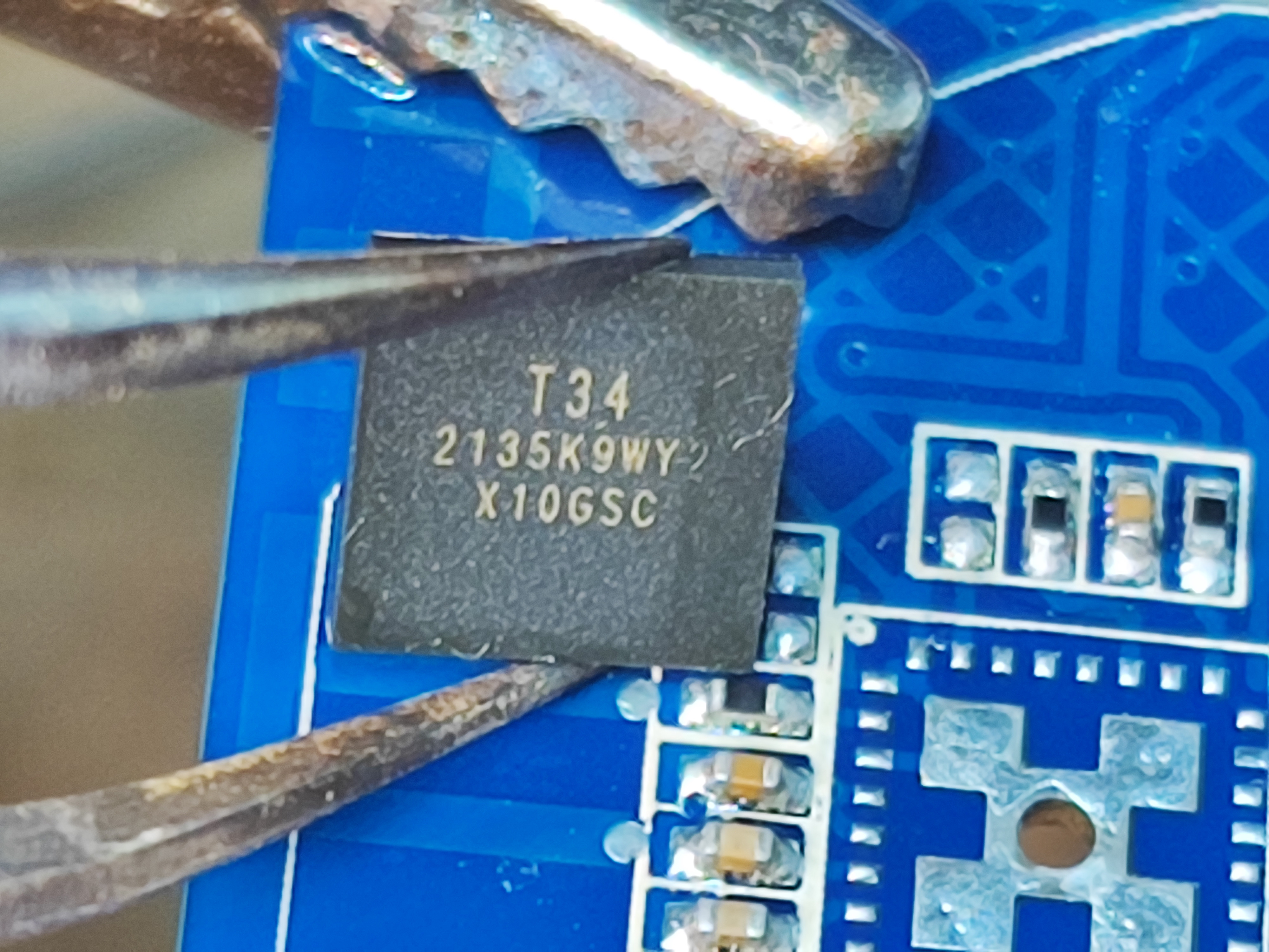

In 2021, I featured two switches in the QTouch series on the forum, both of which were based on the ESP8285. Today I'm going back and checking out the latest copies in the same series, has anything inside changed in four years? And if so, how can they now be freed from the cloud and paired with Home Assistant? Let's find out!
The 'single' version can be bought for as little as PLN43, while the 'double' version can be bought for PLN55. I'll cover both versions here, but first I recommend the older 2021 themes:

And here is the interior:
PCB in the QTouch touch switch with T34 chip. Close-up of a PCB with a T34 chip and other components. Close-up of a PCB with T34 integrated circuit and several other components. Close-up of electronic board interior with integrated circuit and connector. .
There is a T34 inside, which is essentially a BK7321. You can't upload Tasmota, but you can upload OpenBeken:
For RF we additionally have a 480RA chip here, and the third chip in the SOIC housing is the touch button controller.
The RF chip is connected to it, so after changing the RF firmware it will continue to work.

I've made attempts to change the firmware, at first I was hoping these pads were the UART port from the T34:
Close-up of a PCB with several attached wires. .
None of this, no communication. I checked the connections under the button controller:
Printed circuit board with integrated circuits, visible wires and connectors. Close-up of an electronic circuit board with integrated circuits, including one labeled T34. PCB with electronic components and colored wires .
Two of the pads lead to its feet (the other two are power and ground):
Close-up of a blue circuit board with metal components aligned on pins. PCB with a thin wire at solder pads, held by tweezers. .
I finally debugged the T34.

The UART can be seen here, to the right of the photo:
Close-up of a PCB with a T34 chip. .
I finally desoldered the component:
Close-up of a circuit board with an integrated circuit and solder pads. Close-up of T34 microchip on a blue electronic board .
Unfortunately, it looks like pin 26 (UART1_TXD) is not brought out anywhere, so changing the firmware is difficult to access .
You will need to use the method from here:

In summary , the older QTouch used the ESP series, it was relatively simple to upload Tasmota. Now QTouch have a board with T34, that is with BK7231N. OpenBeken can be uploaded, but access to programming is difficult. One of the UART pins is not routed out at all. You either have to add a fine wire to the case pad itself, or solder the chip itself off the board, as shown in the linked topic. Only then can you use our flasher and connect the switch to the Home Assistant 100% locally, without the cloud.
I'll try to show the whole process separately in a dedicated topic, especially as it's undoubtedly more difficult than what has been presented so far, i.e. soldering with cables to the pads of modules such as CB2S or CB3S....
Let's hope this is an isolated incident, as changing the firmware in such a situation is more time consuming to say the least and without hot air, not a move.
