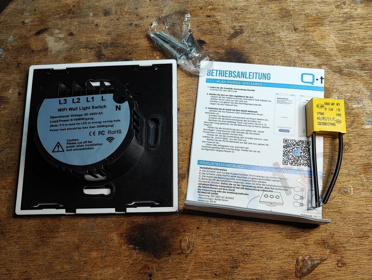

    And now it's time to unpack the purchases.... The "single" version first:
    QTouch touch switch packaging Packaging of Adelid WiFi QTouch switch. QTouch touch switch box with IP65 and LED markings QWP.W1.WIFI switch packaging. .

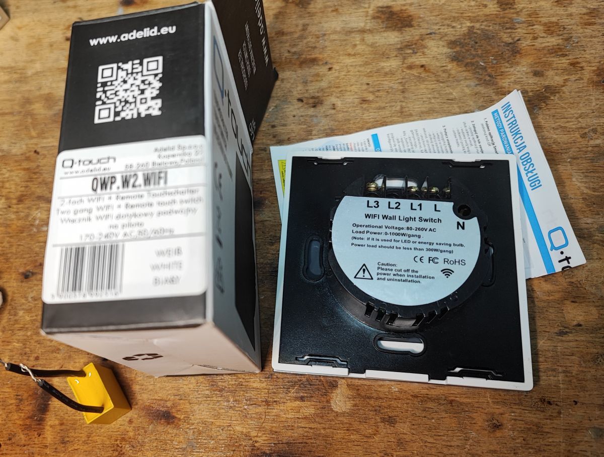

    QWP.W1.WiFi, there is a capacitor included, also referred to as an "adapter" by retailers:
    Set containing a WiFi wall switch, capacitor, and instruction manual on a wooden table. .
    Instructions:
    QTouch WiFi switch user manual in English. User manual of Q-touch Adelid touch switch.

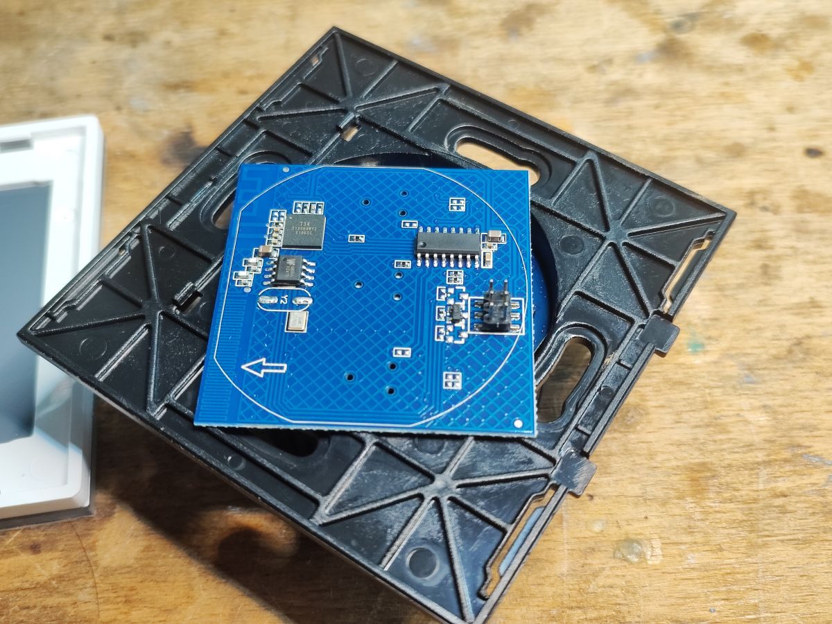

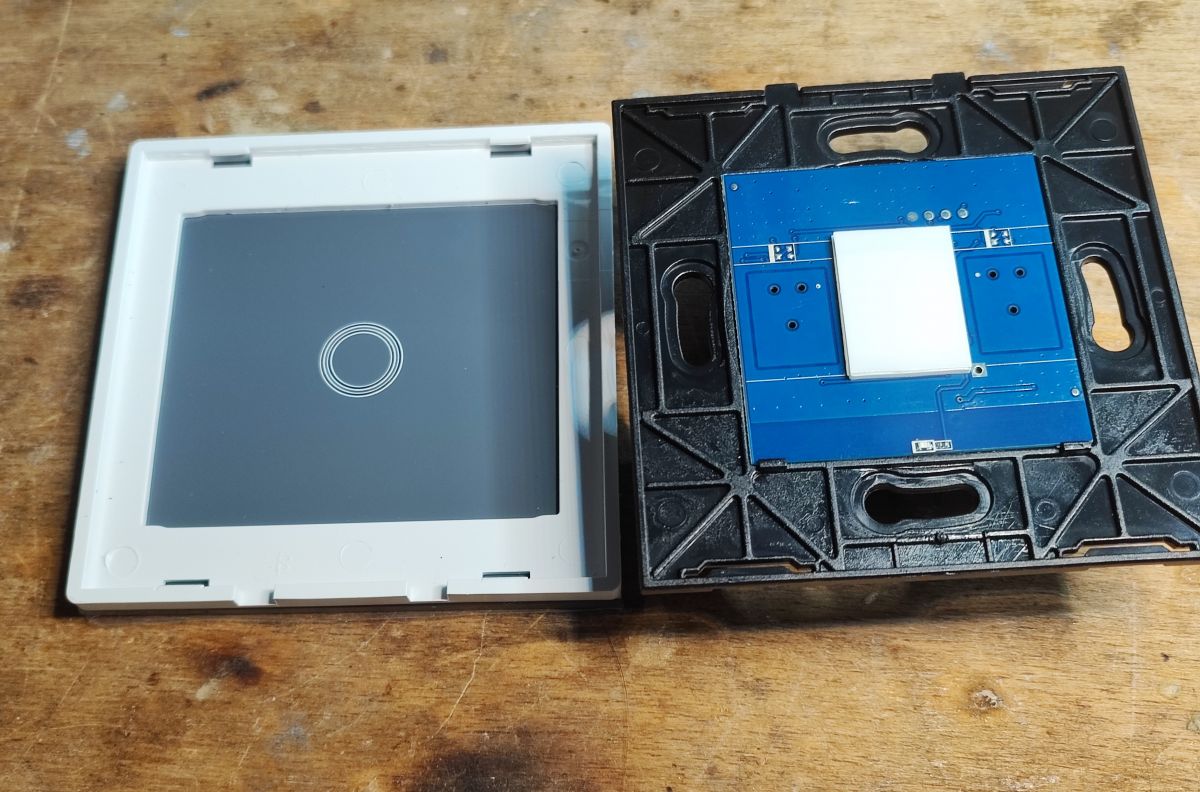

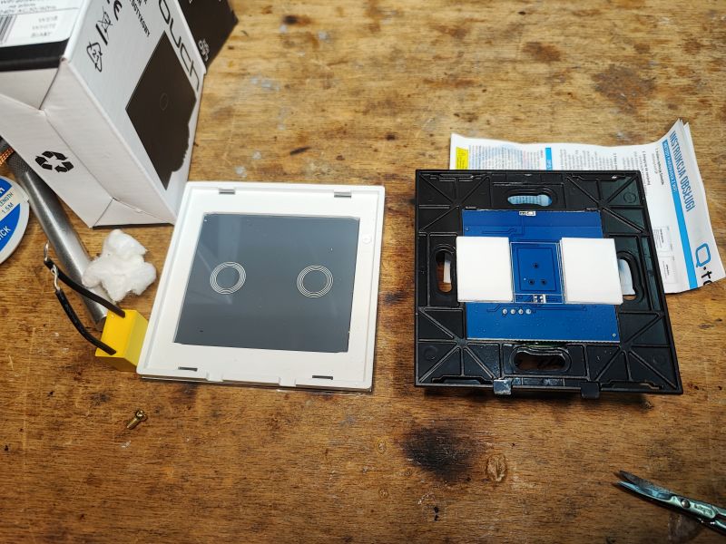

    Removed front:

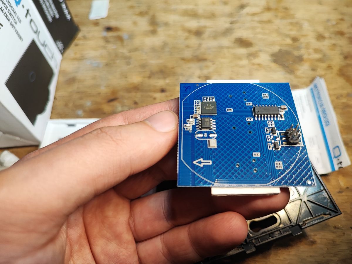

    Disassembled QTouch touch switch panel showing the circuit board and housing. .

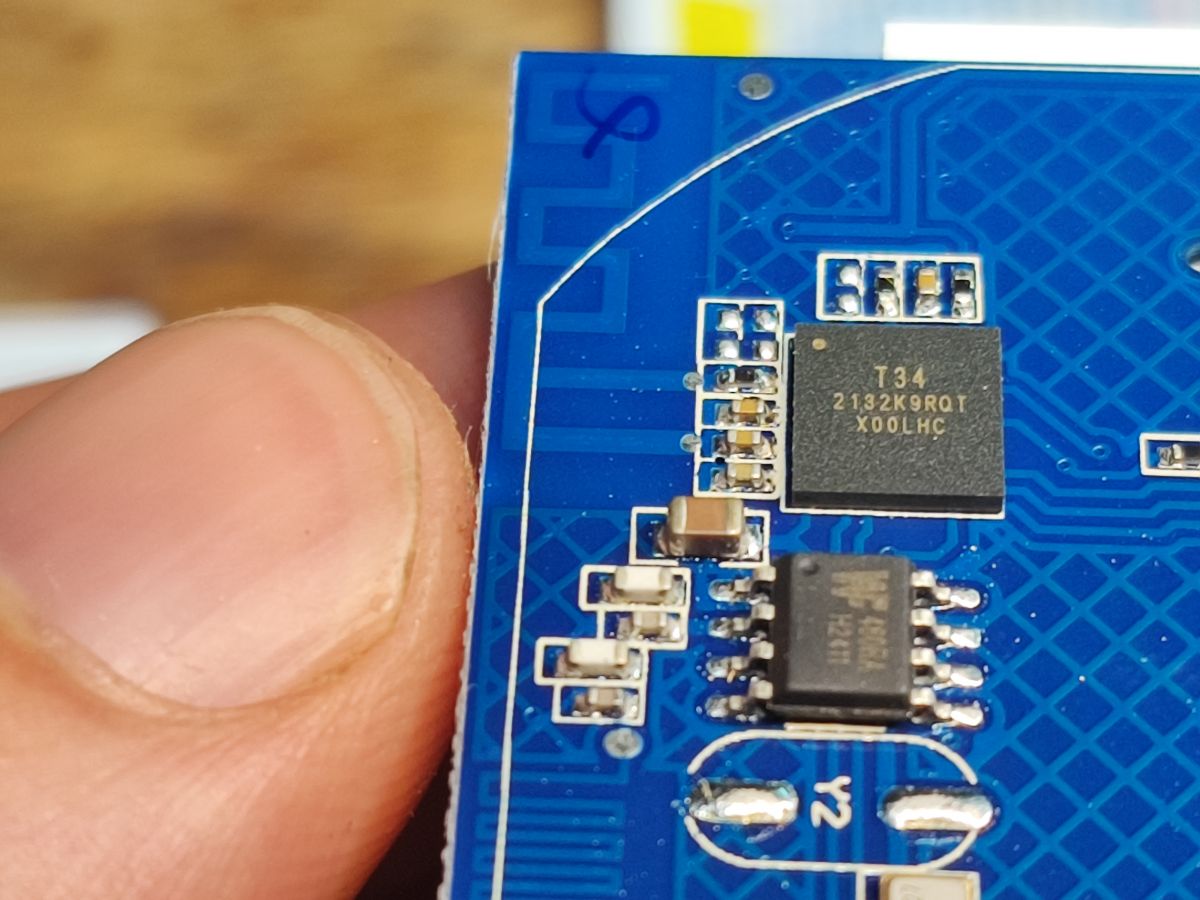

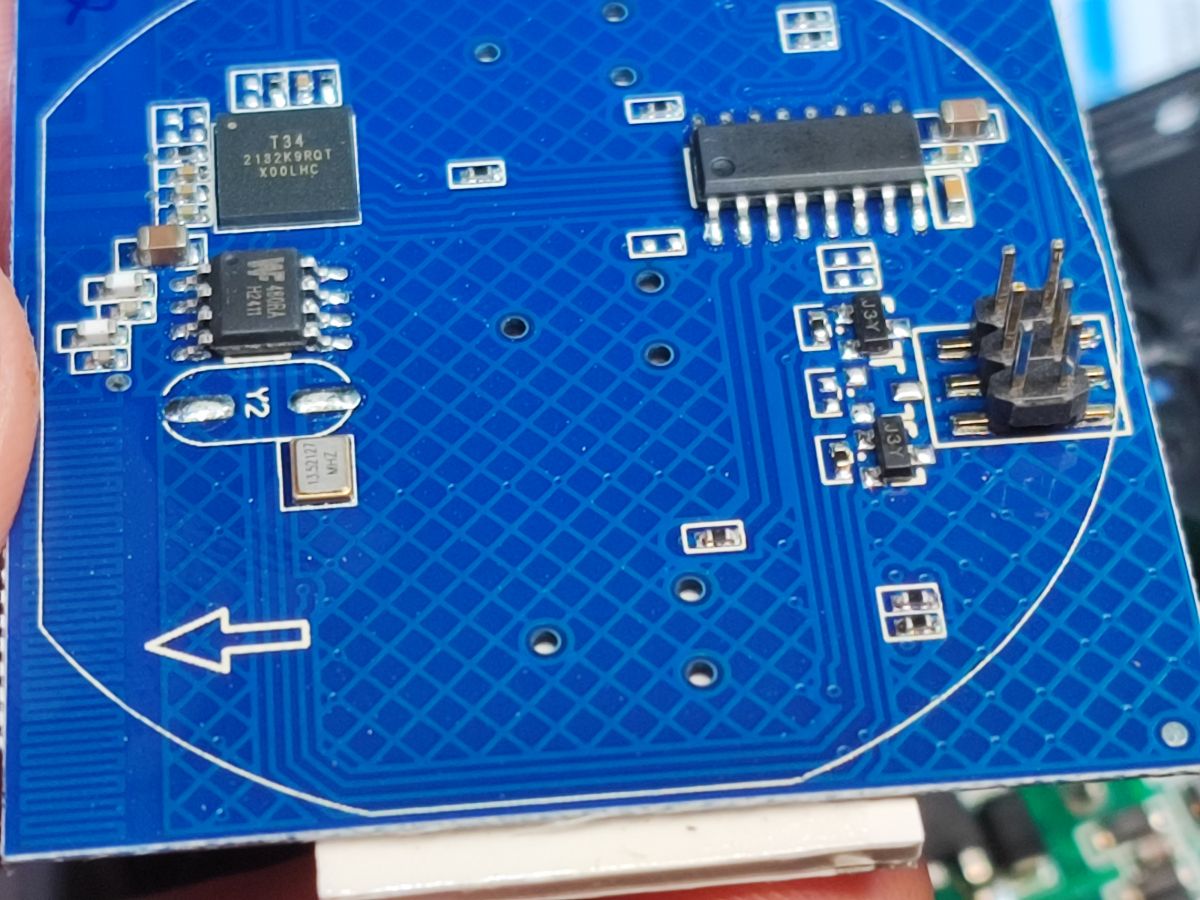

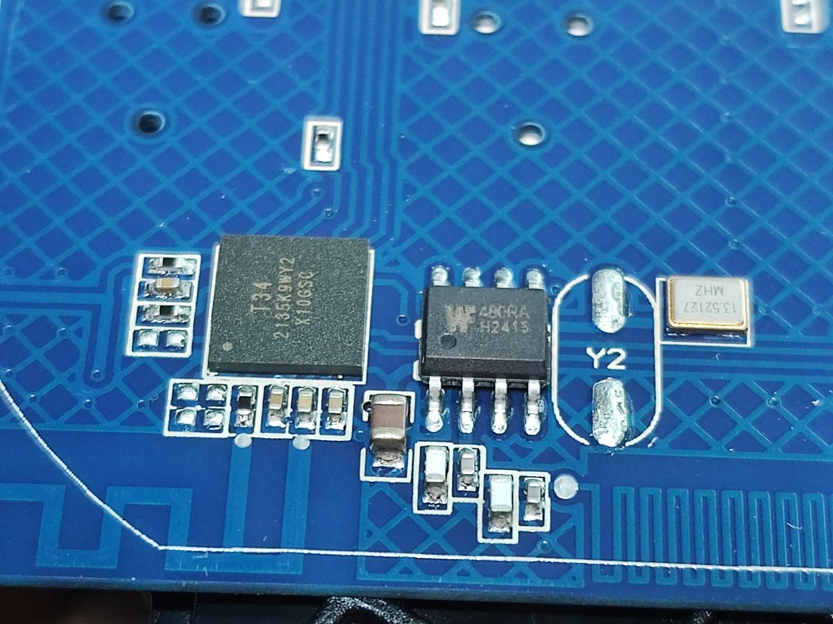

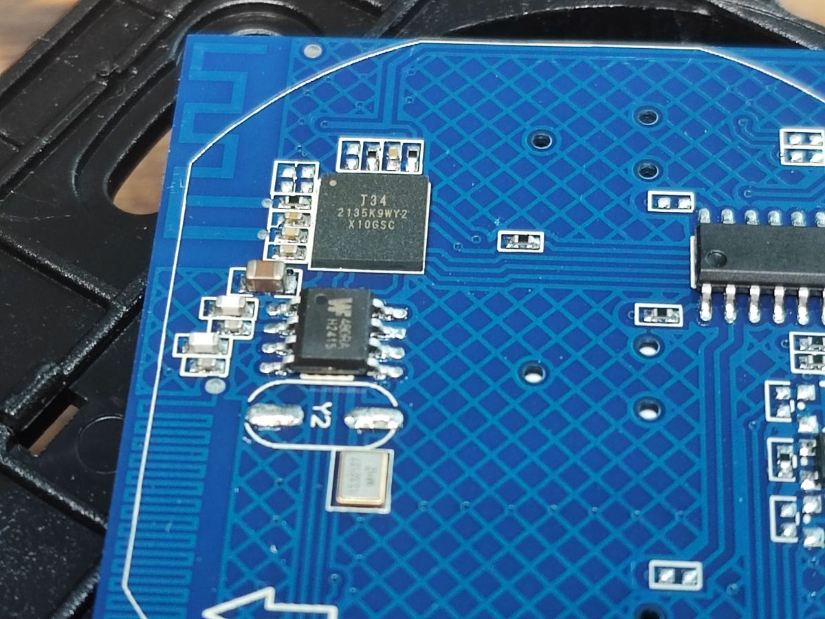

    And here is the interior:
    PCB in the QTouch touch switch with T34 chip. Close-up of a PCB with a T34 chip and other components. Close-up of a PCB with T34 integrated circuit and several other components. Close-up of electronic board interior with integrated circuit and connector. .
    There is a T34 inside, which is essentially a BK7321. You can't upload Tasmota, but you can upload OpenBeken:
    For RF we additionally have a 480RA chip here, and the third chip in the SOIC housing is the touch button controller.
    The RF chip is connected to it, so after changing the RF firmware it will continue to work.

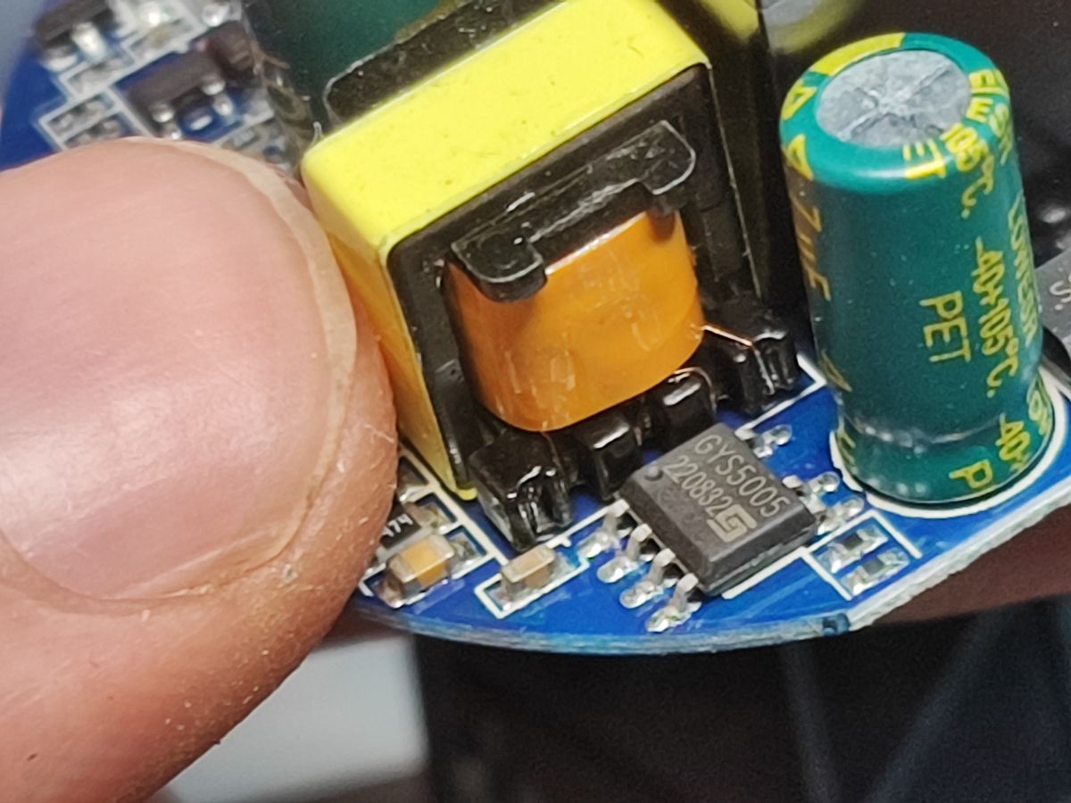

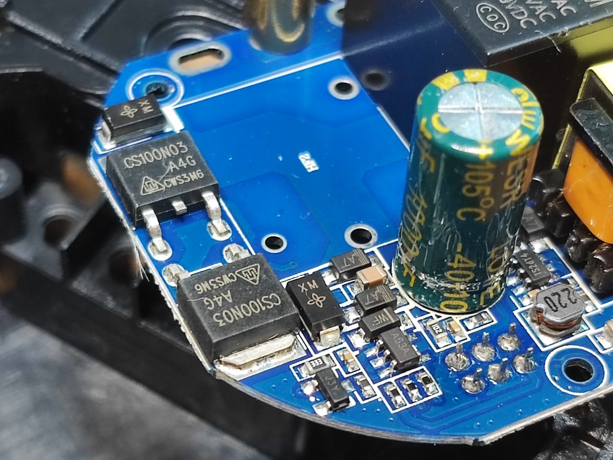

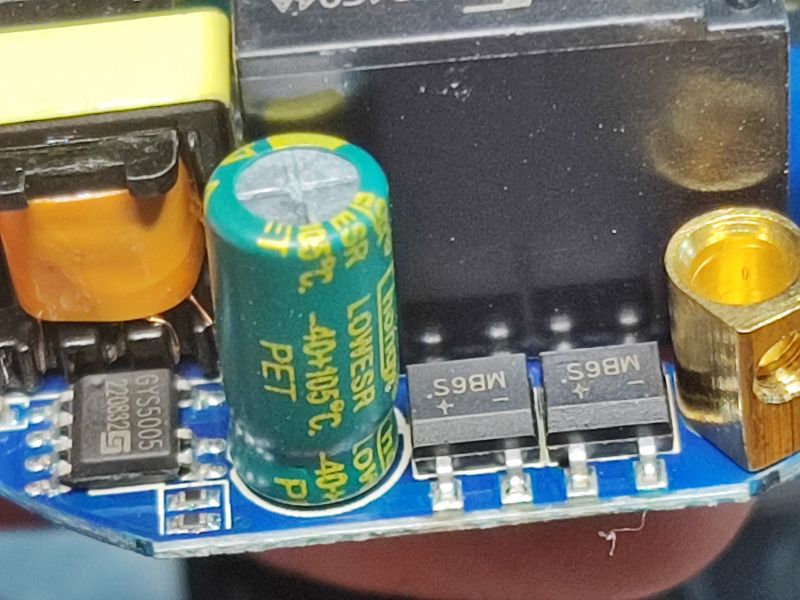

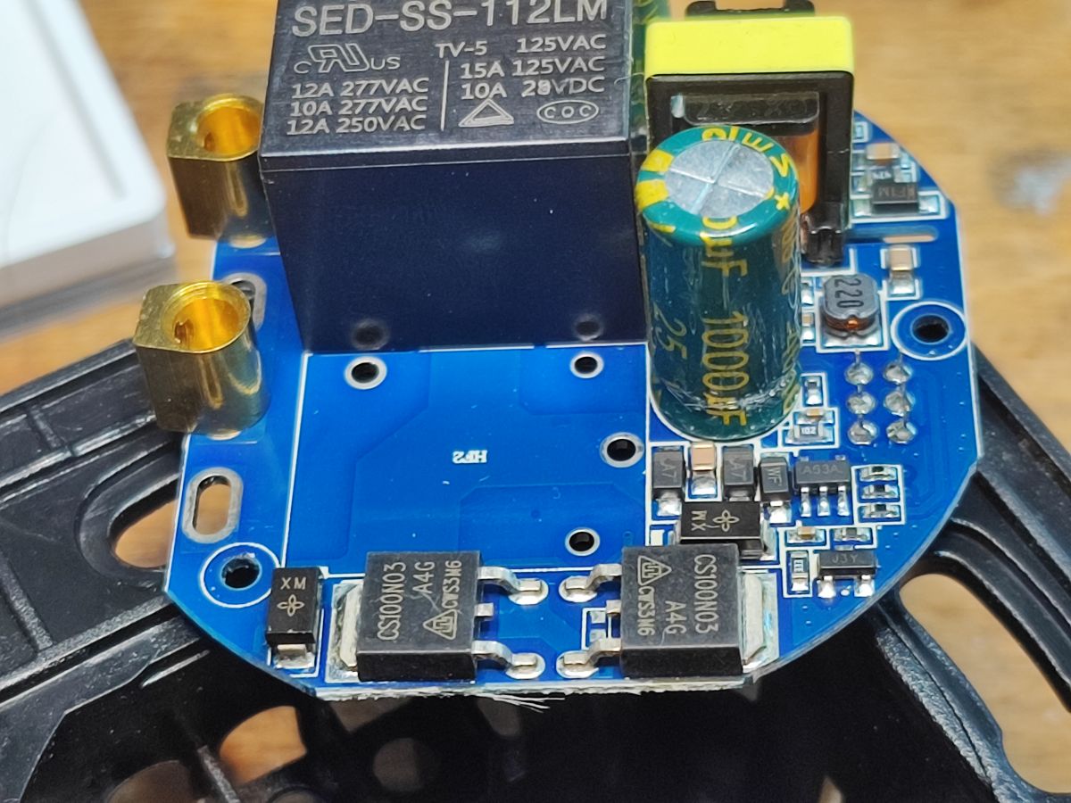

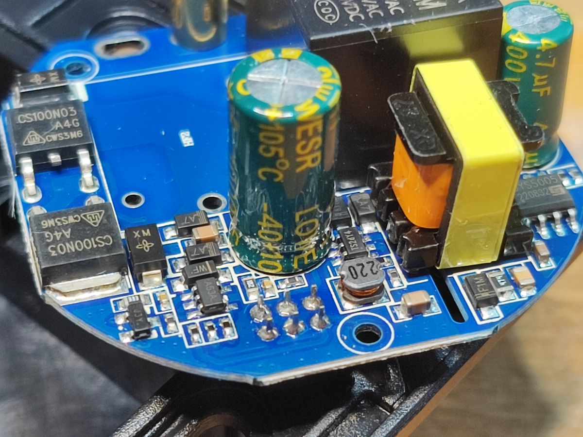

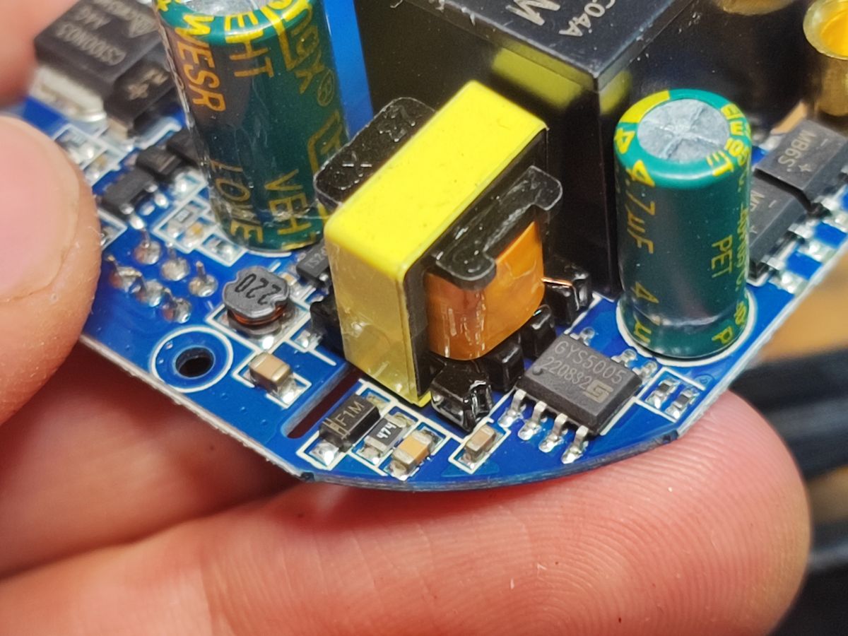

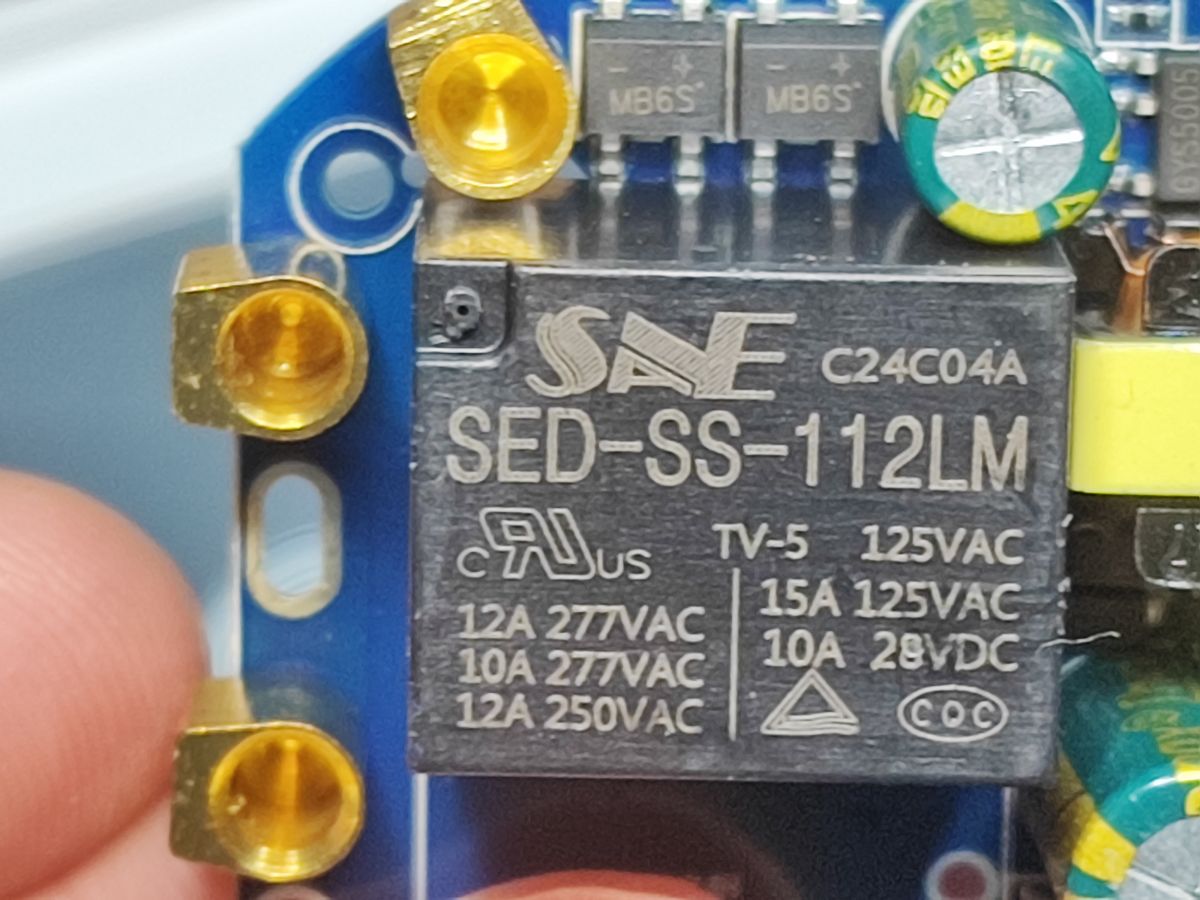

    We still have a separate 'executive' board with a rather interesting circuit that I have not analysed:
    Circuit board with electronic components, including a SED-SS-112LM relay and a capacitor. Close-up of the internal electrical circuit of a QTouch switch with a capacitor and MOSFET transistor. Circuit board with various electronic components. Close-up of a circuit board with electronic components, including capacitors and an integrated circuit. Close-up of electronic components on a circuit board. Close-up of a circuit board with a transformer and electronic components Close-up of the SED-SS-112LM relay mounted on an electronic board.
    The power supply appears to be based on a GYS5005 220832, and I can also see a small step-down converter next to it, but the 3.3V LDO is not there. However, the CS100N03 (MOSFET) seems to be there so that you can also run the switch in "no neutral" mode, this will come in handy if you don't have an N wire in the box....

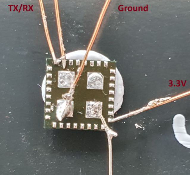

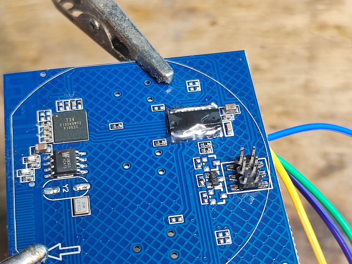

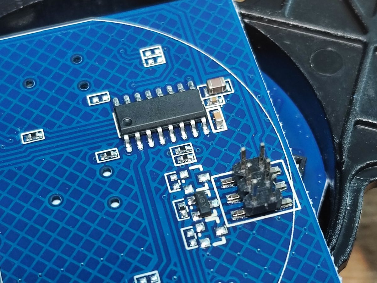

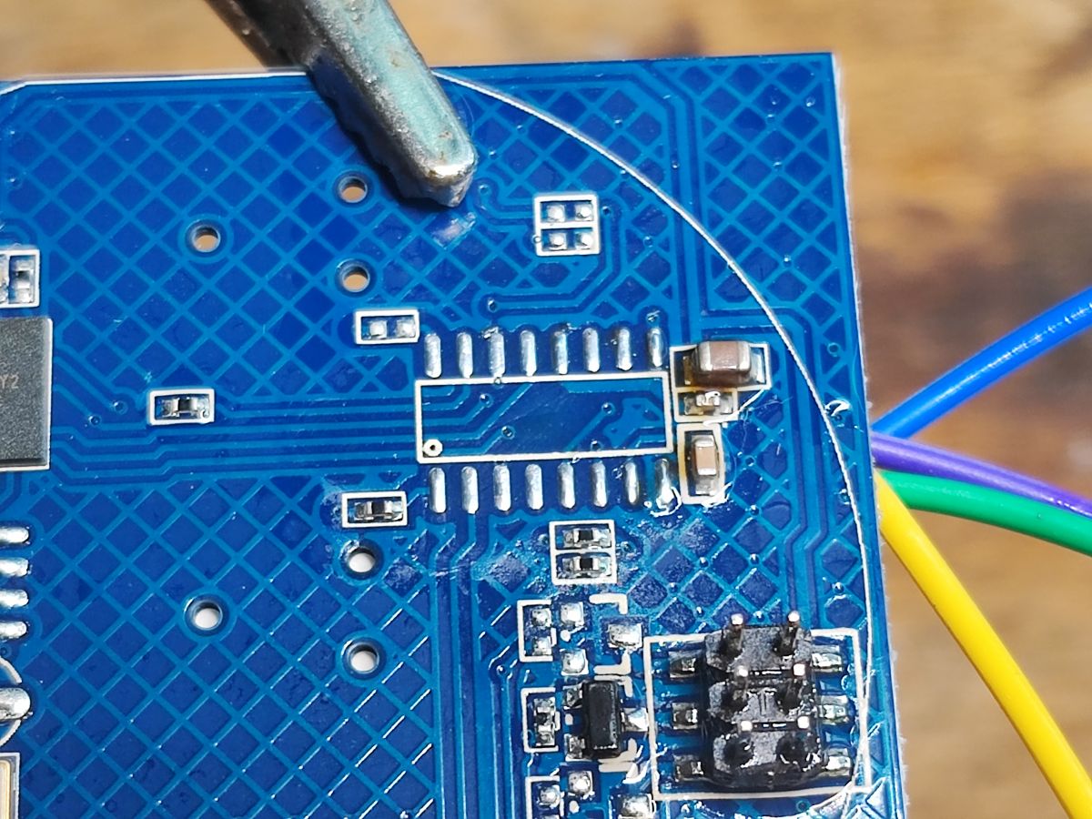

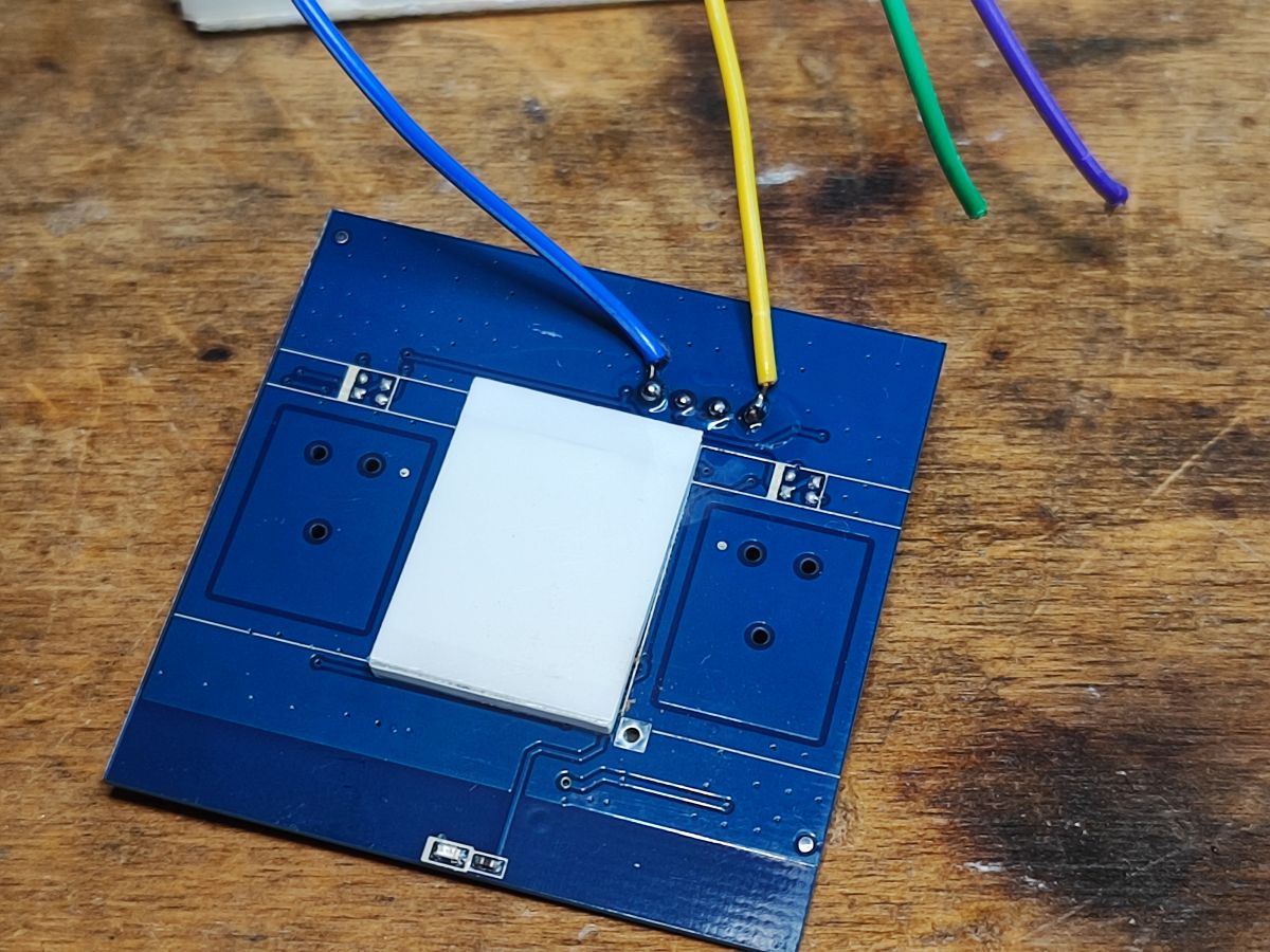

    I've made attempts to change the firmware, at first I was hoping these pads were the UART port from the T34:
    Close-up of a PCB with several attached wires. .

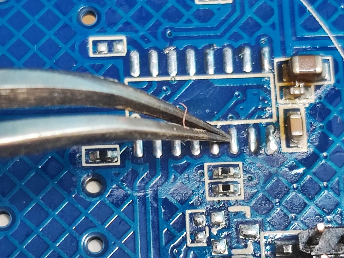

    None of this, no communication. I checked the connections under the button controller:
    Printed circuit board with integrated circuits, visible wires and connectors. Close-up of an electronic circuit board with integrated circuits, including one labeled T34. PCB with electronic components and colored wires .
    Two of the pads lead to its feet (the other two are power and ground):
    Close-up of a blue circuit board with metal components aligned on pins. PCB with a thin wire at solder pads, held by tweezers. .

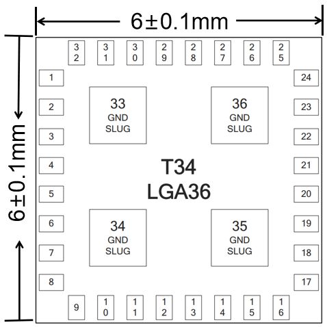

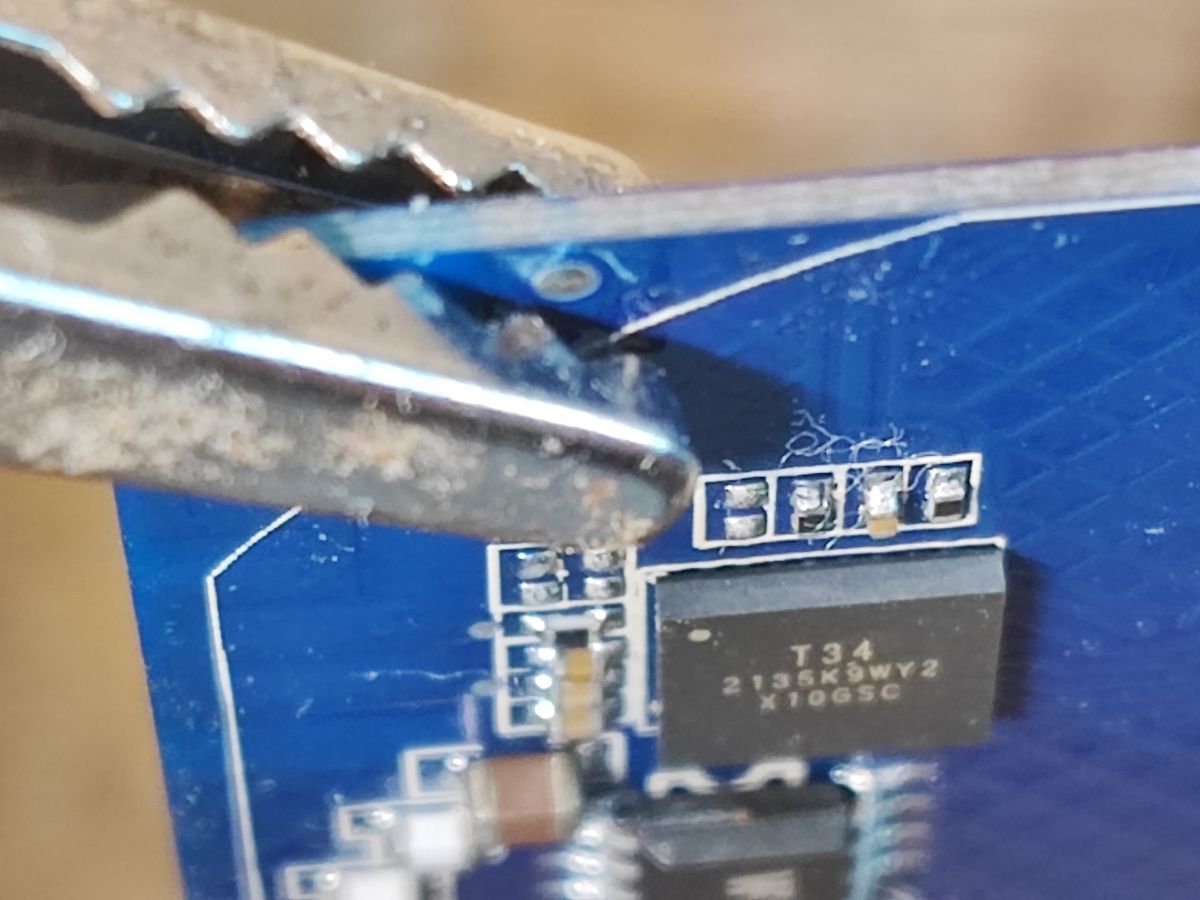

    I finally debugged the T34.
    T34 chip pinout diagram .
    T34 outputs, quote from documentation, untranslated:
    Pin no. Symbol I/O type Description
    1, 3, 32, 33, 34, 35, and 36 GND P Ground pins. 33, 34, 35, and 36 are the ground pads at the back of the chip.
    2 . ANT I/O External antenna with 2.4 GHz RF input and output.
    4 and 5 VCCPA P RF PA power input. Voltage range: 3.0V to 3.6V. And 3.3V power supply is recommended.
    6 . VDDDIG O Digital power output. The voltage is about 1.2V.
    7 . VDDAON O Normally open power output. The voltage is about 1.2V.
    8 VBAT I Chip main-.power input. Voltage range: 3.0V to 3.6V. And 3.3V power supply is recommended.
    9 . CEN I The CEN pin of the chip, without a reset function. This pin is floating inside the chip.
    10 . P28/ADC4/RXEN I/O GPIO or ADC4 or set high during RF reception.
    11 P14/SD_CLK/SCK/ANT0 I/O GPIO, or CLK of SD, or SCK of SPI, or Bluetooth LE antenna control ANT0.
    12 . P16/SD_CMD/MOSI/ANT2 I/O GPIO, or CMD of SD, or MOSI of SPI, or Bluetooth LE antenna control ANT2.
    13 P15/CSN/ANT1 I/O GPIO, or CSN of SPI, or Bluetooth LE antenna control ANT1.
    14 P17/SD_D0/MISO/ANT3 I/O GPIO, or D0 of SD, or MISO of SPI, or Bluetooth LE antenna control ANT3.
    15 P26/ADC1/IRDA/PWM5 I/O GPIO, or ADC1, or IR receiver or PWM5.
    16 . P24/ADC2/LPO_CLK/PWM4 I/O GPIO, or ADC2, or low power clock 32.768K output, or PWM4.
    17 P23/ADC3/TDO/F_SO I/O GPIO, or ADC3, or JTAG TDO, or flash data output when downloading with SPI.
    18 . P22/ADC5/CLK_26M/TDI/TXEN/F_SI I/O <br/GPIO, or ADC5, or crystal frequency output, or JTAG TDI, or set high during RF transmission, or flash data input when downloading with SPI.
    19 P21/ADC6/I2C1_SDA/TMS/F_CSN I/O Mode selection pin for selecting RF test firmware or app firmware. Pulling down this pin will enter the RF test mode.
    20 . P20/I2C1_SCL/TCK/F_SCK I/O GPIO, or SCL of I2C1, or TCK of JTAG, or the clock when flash is downloaded by SPI.
    21 P6/CLK13M/PWM0 I/O GPIO, or 1, 2, 4, and 8 frequency division output of crystal clock, or PWM0.
    22 P7/WIFI_ACTIVE/PWM1 I/O GPIO, or WIFI_ACTIVE control when Wi-Fi and Bluetooth coexist, or PWM1.
    23 P8/BT_ACTIVE/PWM2 I/O GPIO, or BT_ACTIVE control when Wi-Fi and Bluetooth coexist, or PWM2.
    24 P9/BT_PRIORITY/PWM3 I/O GPIO, or BT_PRIORITY control when Wi-Fi and Bluetooth coexist, or PWM3.
    25 P10/DL_RX/UART1_RXD I/O GPIO, or RXD when downloading flash with UART, or RXD of serial port UART1.
    26 P11/DL_TX/UART1_TXD I/O GPIO, or TXD when downloading flash with UART, or TXD of serial port UART1.
    27 P1/UART2_RXD/I2C2_SDA I/O GPIO, or RXD of serial port UART2, or SDA of I2C2. P1 is used for self-calibration and cannot be used for other functions.
    28 . P0/UART2_TXD/I2C2_SCL I/O GPIO, or TXD of serial port UART2, or SCL of I2C2.
    29 XI I T34 has a build-in crystal, and no external crystal is required.
    30 XO O T34 has a build-in crystal, and no external crystal is required.
    31 VSYS O System power output. Voltage range: 2.7V to 3.0V.
    The UART can be seen here, to the right of the photo:
    Close-up of a PCB with a T34 chip. .

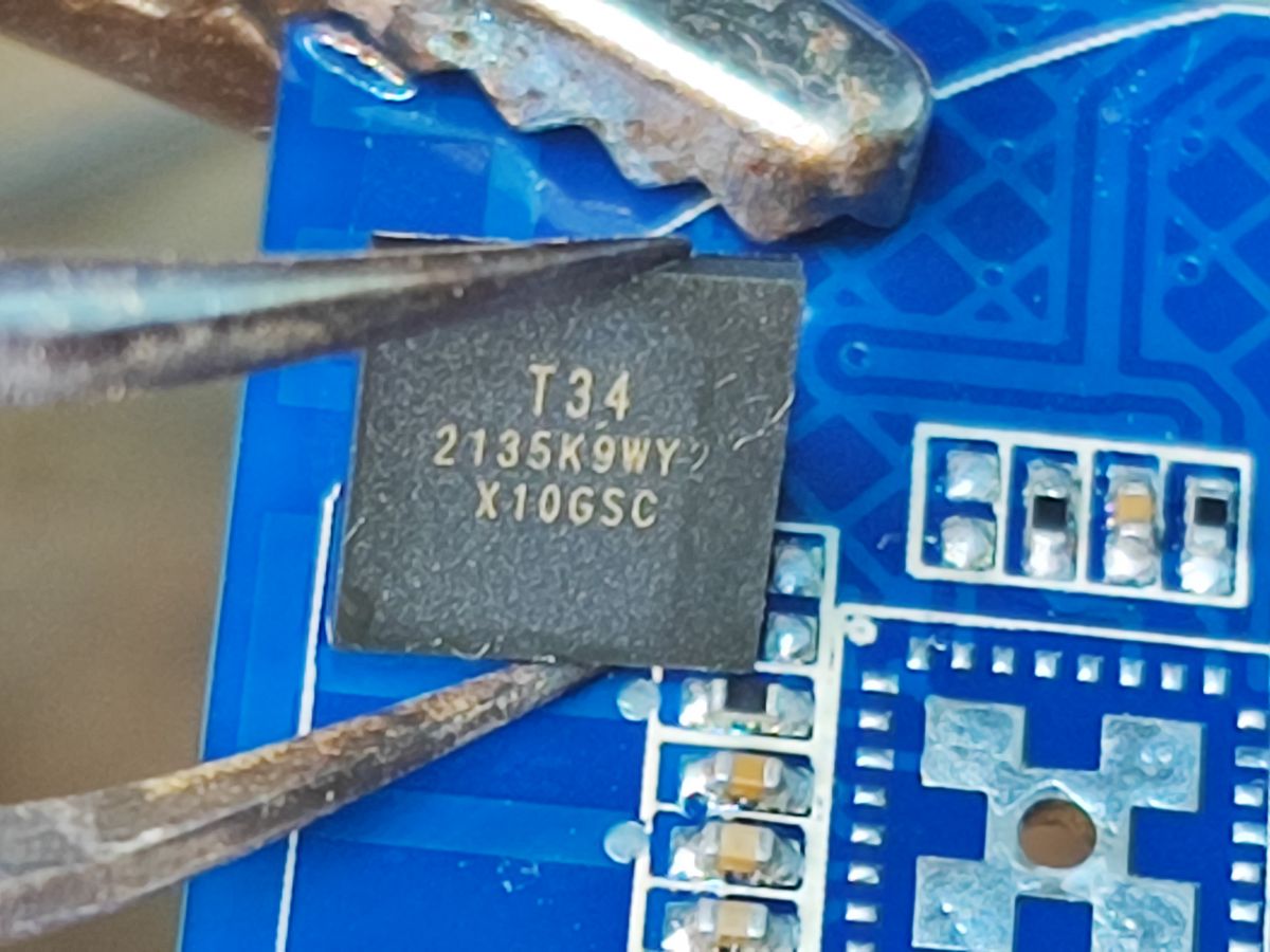

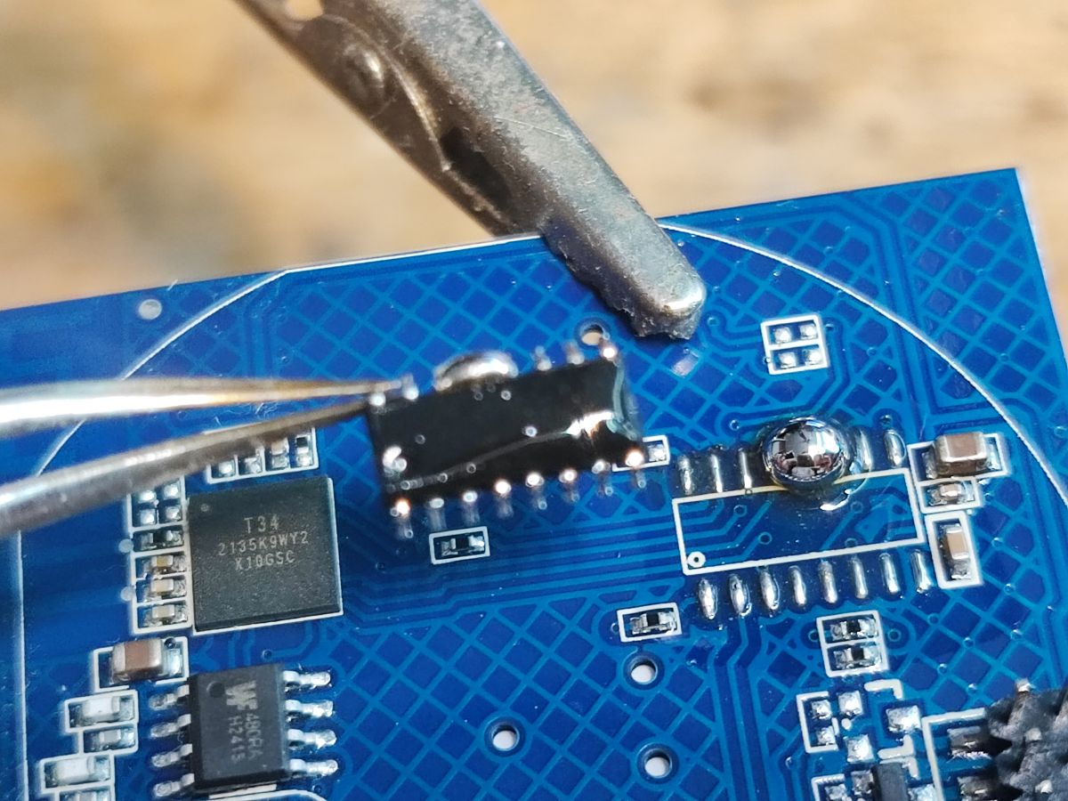

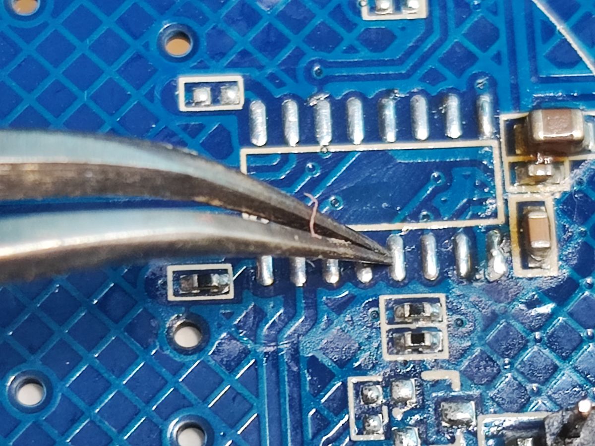

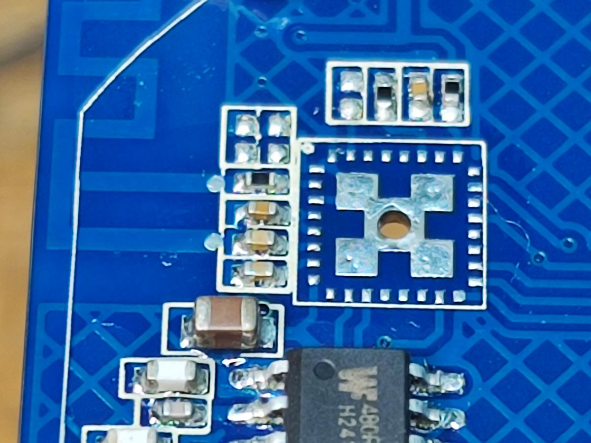

    I finally desoldered the component:
    Close-up of a circuit board with an integrated circuit and solder pads. Close-up of T34 microchip on a blue electronic board .
    Unfortunately, it looks like pin 26 (UART1_TXD) is not brought out anywhere, so changing the firmware is difficult to access .
    You will need to use the method from here:
    [BK7231N / T34] Teardown Tuya Generic Wifi Wall Switch 3-fold .

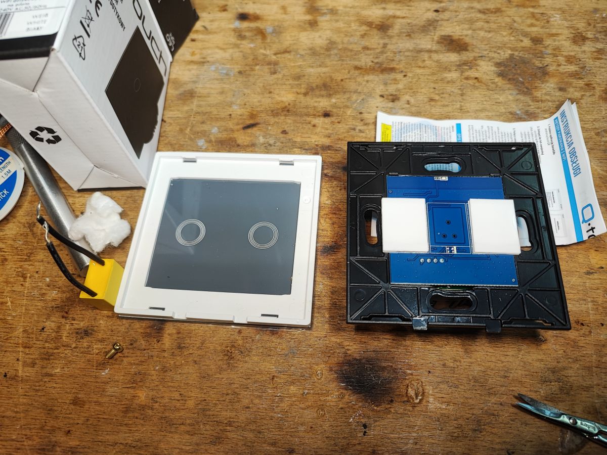

    Version "double" - still just for principle, just a glance:
    Dual WiFi light switch QTouch. .
    Same situation:
    PCB with T34 chip and electronic components. Opened QTouch touch switch with two buttons Close-up of the internal electronic circuits of the QTouch switch. Close-up of a circuit board with T34 microchip .
    The power supply is on the MT2513 ASX034N:

    In summary , the older QTouch used the ESP series, it was relatively simple to upload Tasmota. Now QTouch have a board with T34, that is with BK7231N. OpenBeken can be uploaded, but access to programming is difficult. One of the UART pins is not routed out at all. You either have to add a fine wire to the case pad itself, or solder the chip itself off the board, as shown in the linked topic. Only then can you use our flasher and connect the switch to the Home Assistant 100% locally, without the cloud.
    I'll try to show the whole process separately in a dedicated topic, especially as it's undoubtedly more difficult than what has been presented so far, i.e. soldering with cables to the pads of modules such as CB2S or CB3S....
    Let's hope this is an isolated incident, as changing the firmware in such a situation is more time consuming to say the least and without hot air, not a move.
