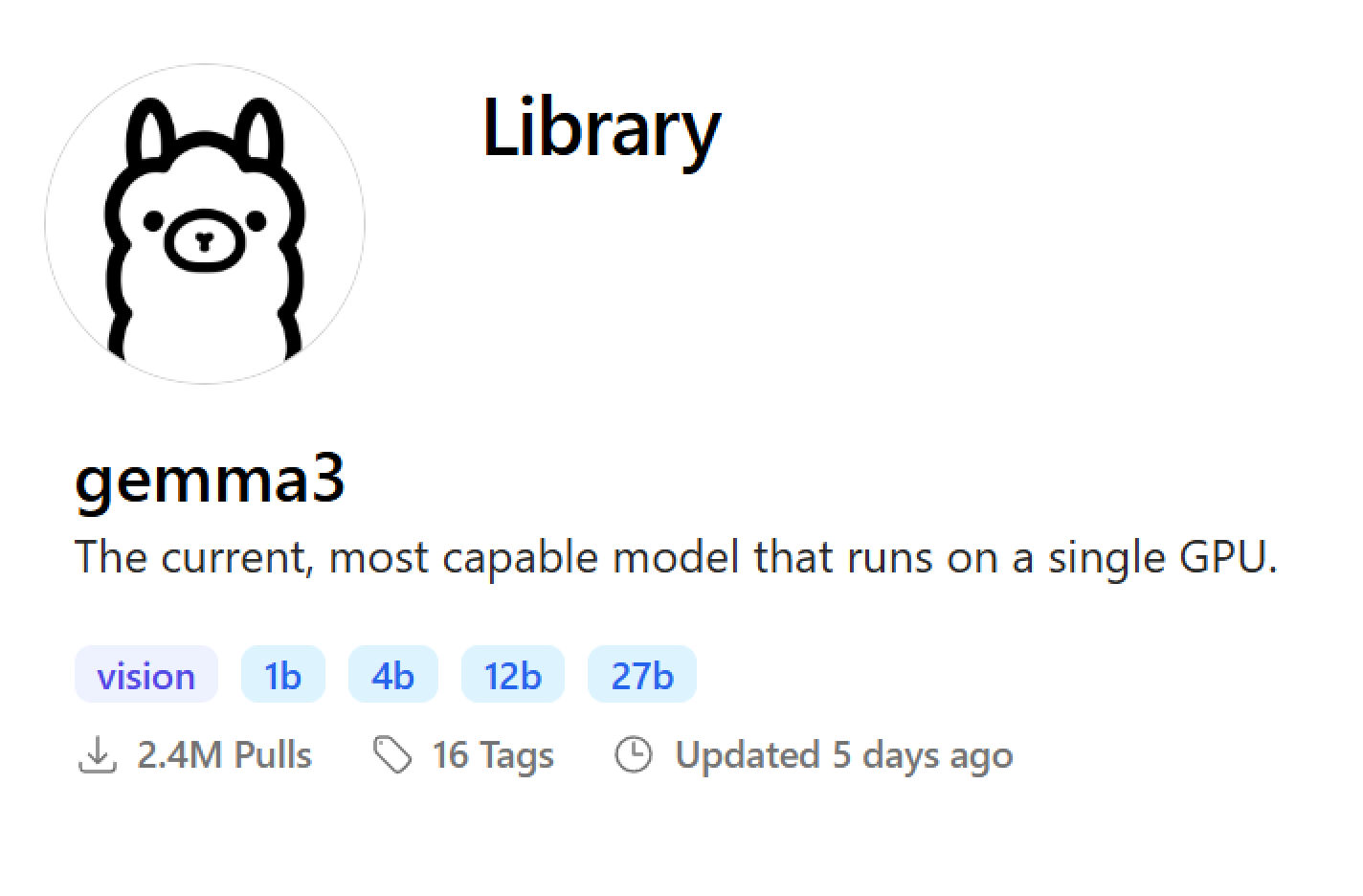

Are you trying to run latest Gemma3 multimodal AI models, but keep getting error 500 in Ollama WebUI?
Here's a solution, but first few words about Gemma 3. Gemma 3 is collection of lightweight, open models built from the same research and technology that powers Gemini 2.0 models. Gemma 3 models are designed to run fast, directly on devices and come in a range of sizes (1B, 4B, 12B and 27B), allowing you to choose the best model for your specific hardware and performance needs.
These models are very easy to download from Ollama Library and run, but Ollama Docker Package comes with obsolete Ollama version 0.6.1, so you can't run new them directly, at least until the Docker package is updated. I'll show a simple work-around here.
