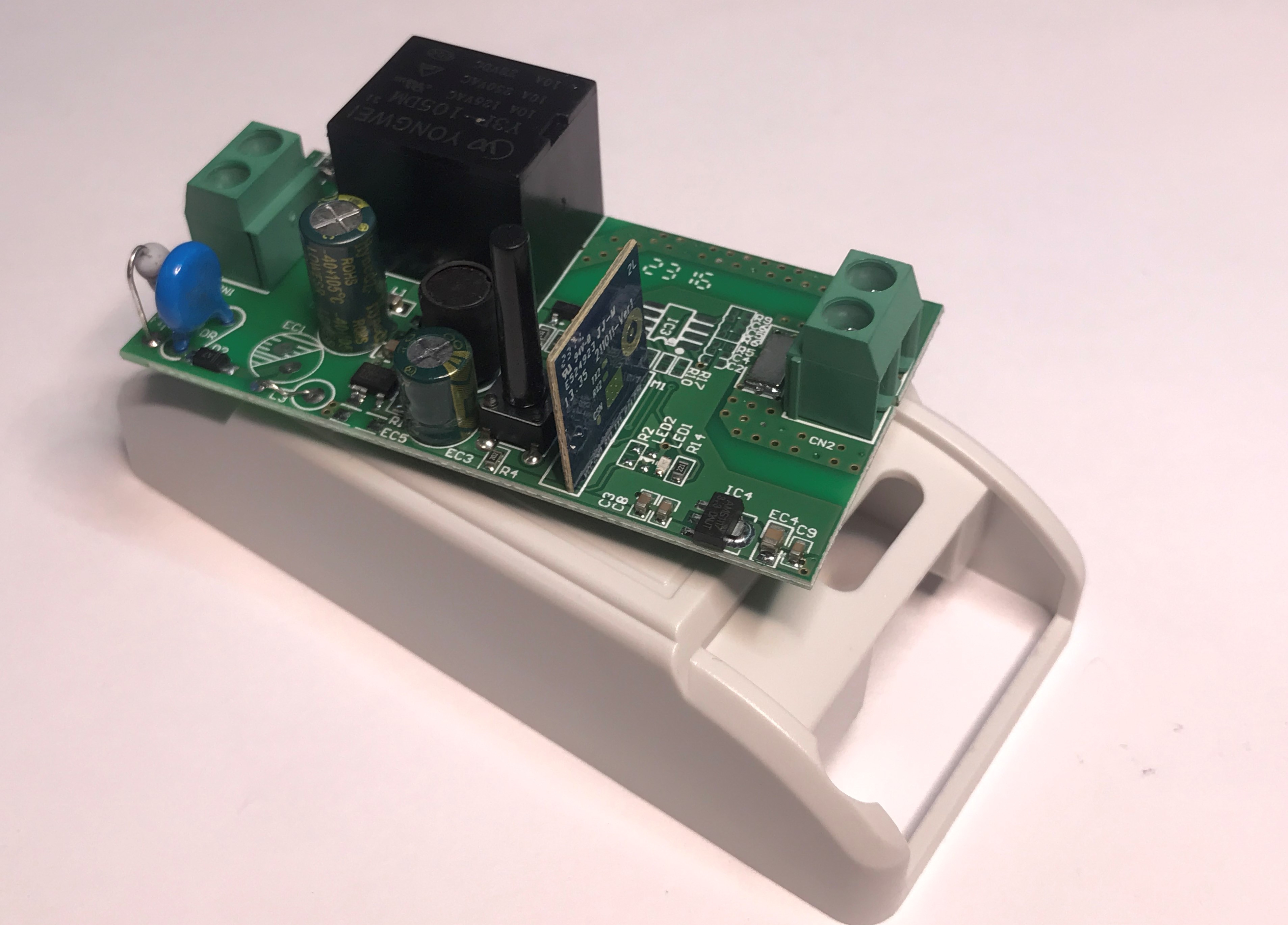

Inside sits a relay that only cuts off one wire - assumed to be a phase, but you know, it depends how you connect. Apart from that, we have a non-isolated power supply (step down) and a 3.3V LDO regulator and WiFi module.
PCB of a relay with electronic components on a white base. .
Printed circuit board with electronic components of a WiFi relay on a white background. .
Electronic circuit of ATLO-B1-Tuya relay on a white casing with visible electronic components. .
The input to the inverter is protected by an F1 fuse, next to this we also have a varistor, and then an incomplete filter (the chokes are omitted - e.g. L3 is missing). In the plans there was also a fuse F2, the one from the phase going to the device, but it was omitted.
Close-up of a relay circuit board with visible electronic components. .
The step-down converter itself (which converts these rectified 230V to 5V for the relay) is based on a BP2525. Separately further down we have the AMS1117-3.3V.
Close-up of a PCB with a WiFi module. .
There is still room on the board for the aforementioned BL0937 along with a resistor/bypass for current measurement.
Close-up of a circuit board with component and port markings. .
You can also see the bold current paths from 230V:
Printed circuit board of a budget WiFi relay .
