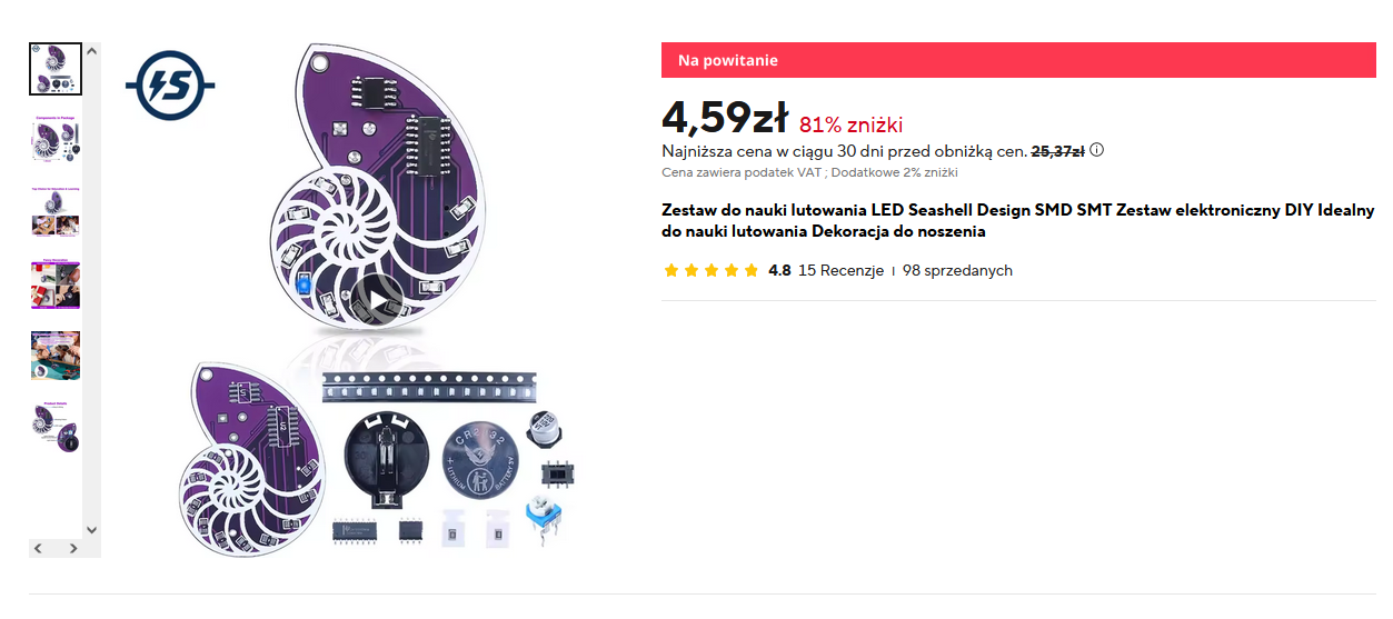

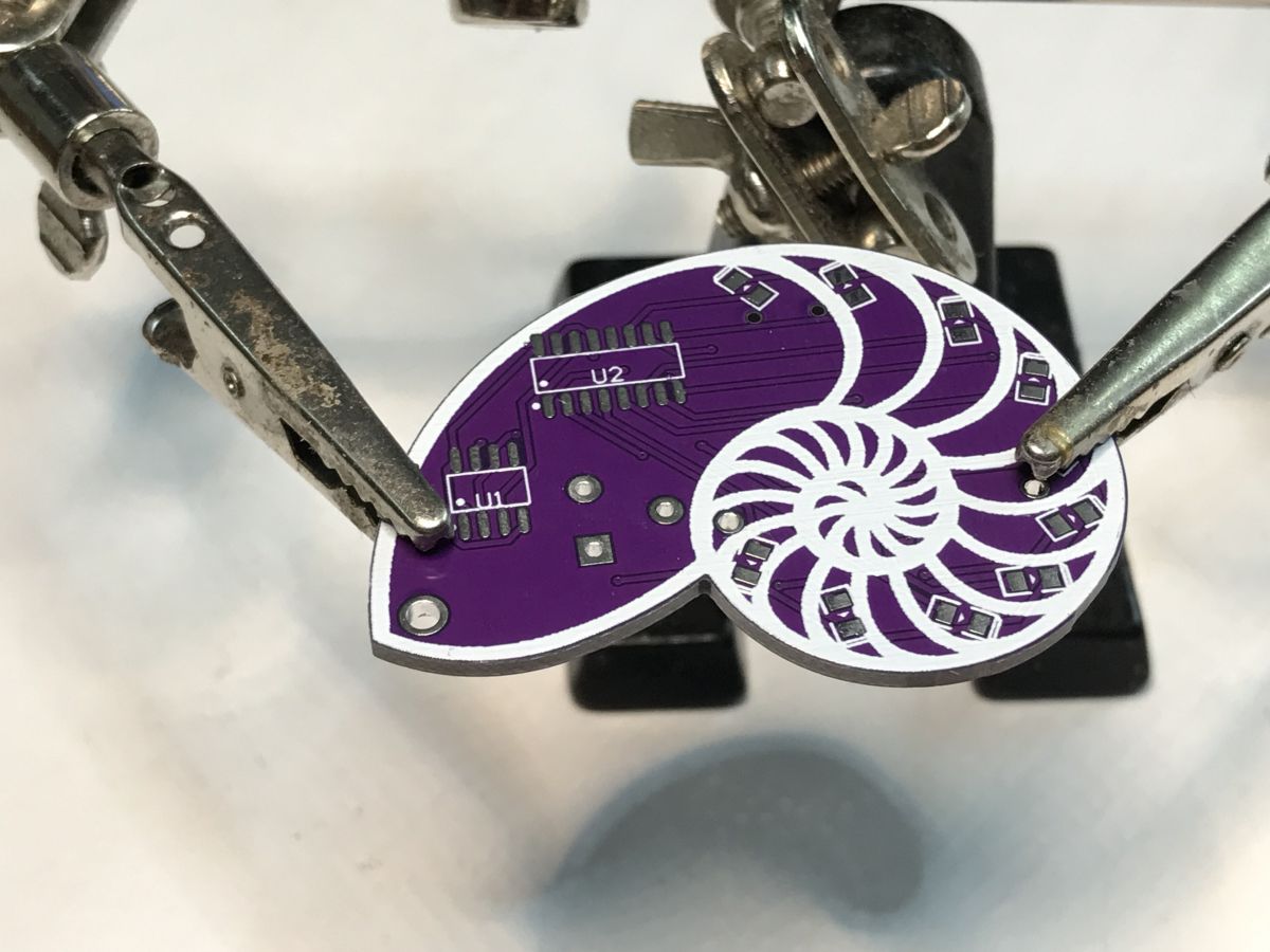

Here I will present a self-assembly kit based on SMD, or surface mount, components. This simple kit allows you to practice soldering circuits in enclosures such as SOP-8, SOP-16 and 0805. Once assembled, you get a simple "flowing light" effect. The whole thing can be bought for around PLN25, although you can get it for up to five times less in a promotion.
DIY LED assembly kit in seashell shape. .
The kit presented here is for anyone who wants to practice soldering surface-mount components. There are various ways to solder it - you can even solder it in a suitable oven, but I solder it "on foot" with the - cheapest soldering iron, flux, binder, tweezers.

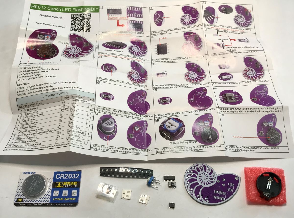

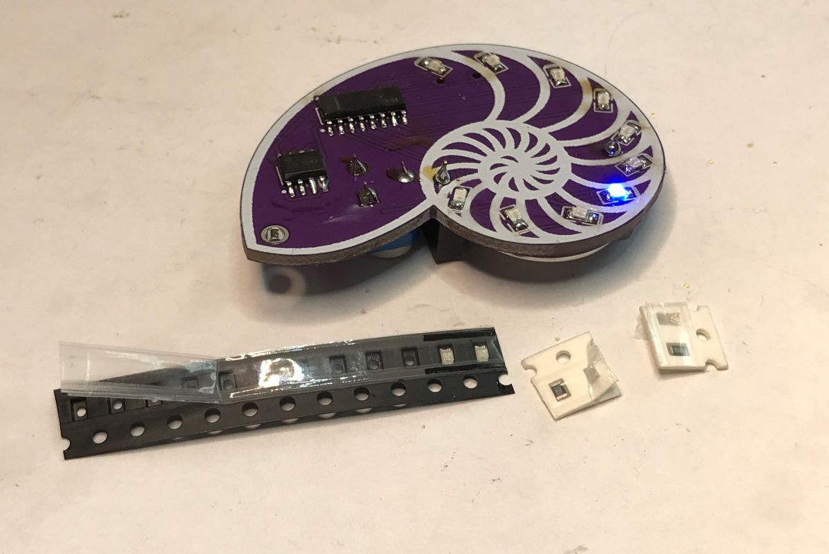

Let's start with the contents of the kit. In addition to the board and the required parts, we also get an easy-to-understand English-language manual with pictures:
SMD soldering kit with components and instructions. .
Already at this stage I can see that we got spare resistors (two each instead of one) and with two spare LEDs. That's good, they're easy to lose.
There's a CR2032 battery too, for power.

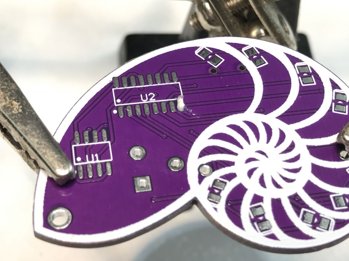

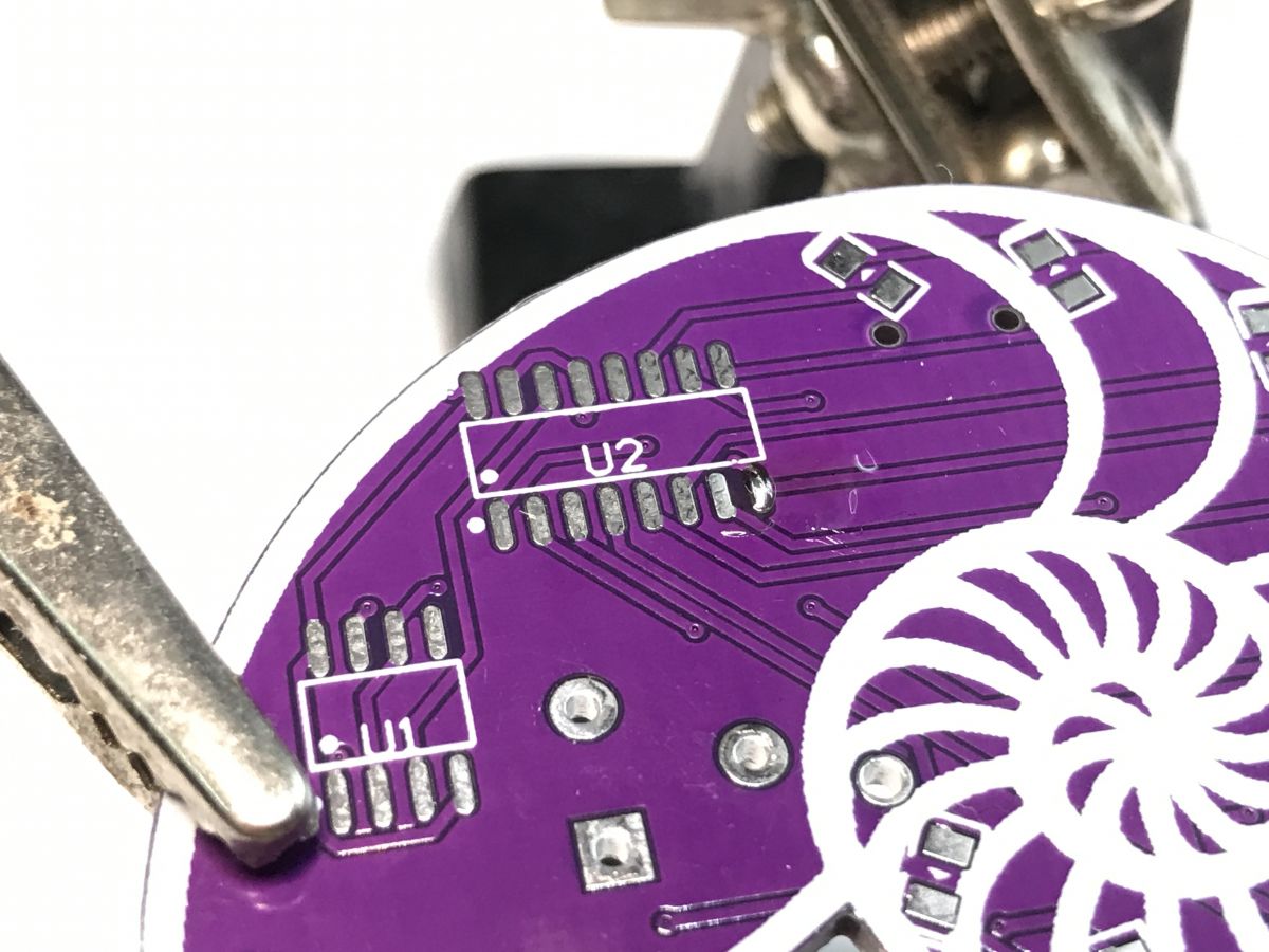

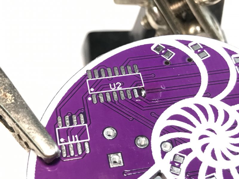

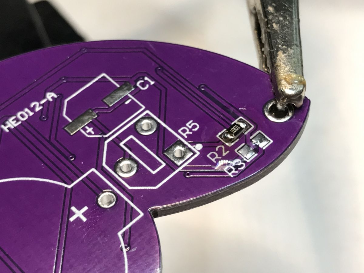

We start soldering - according to the instructions. First I clean the PCB once, then apply flux, then a bit of lead binder.
Close-up of a purple PCB for an SMD soldering kit. .
Shell-shaped PCB with SMD mounting markings. .
Purple PCB with space for SMD component mounting. .

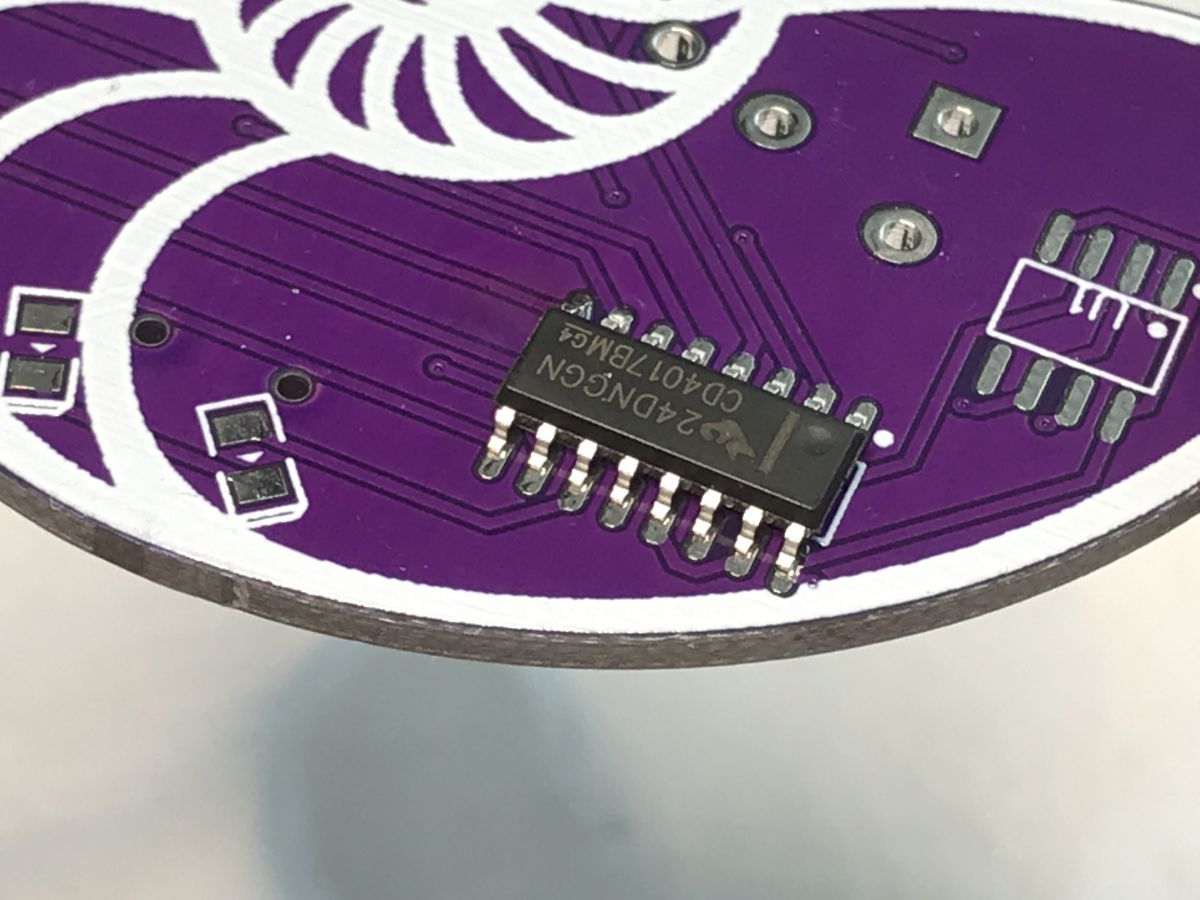

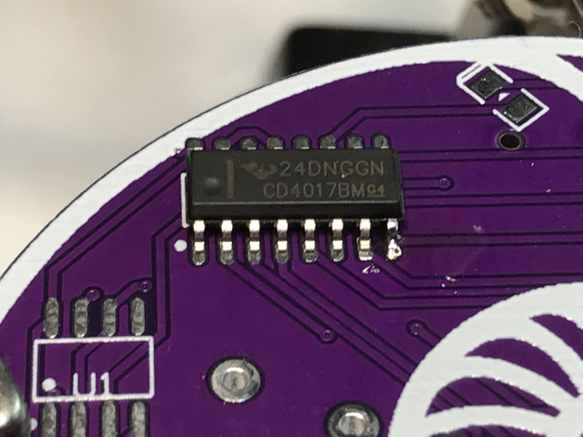

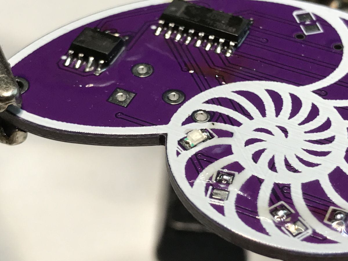

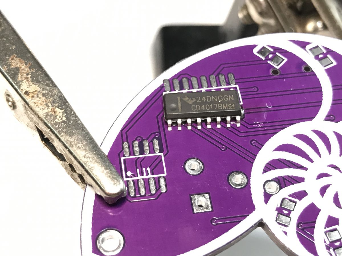

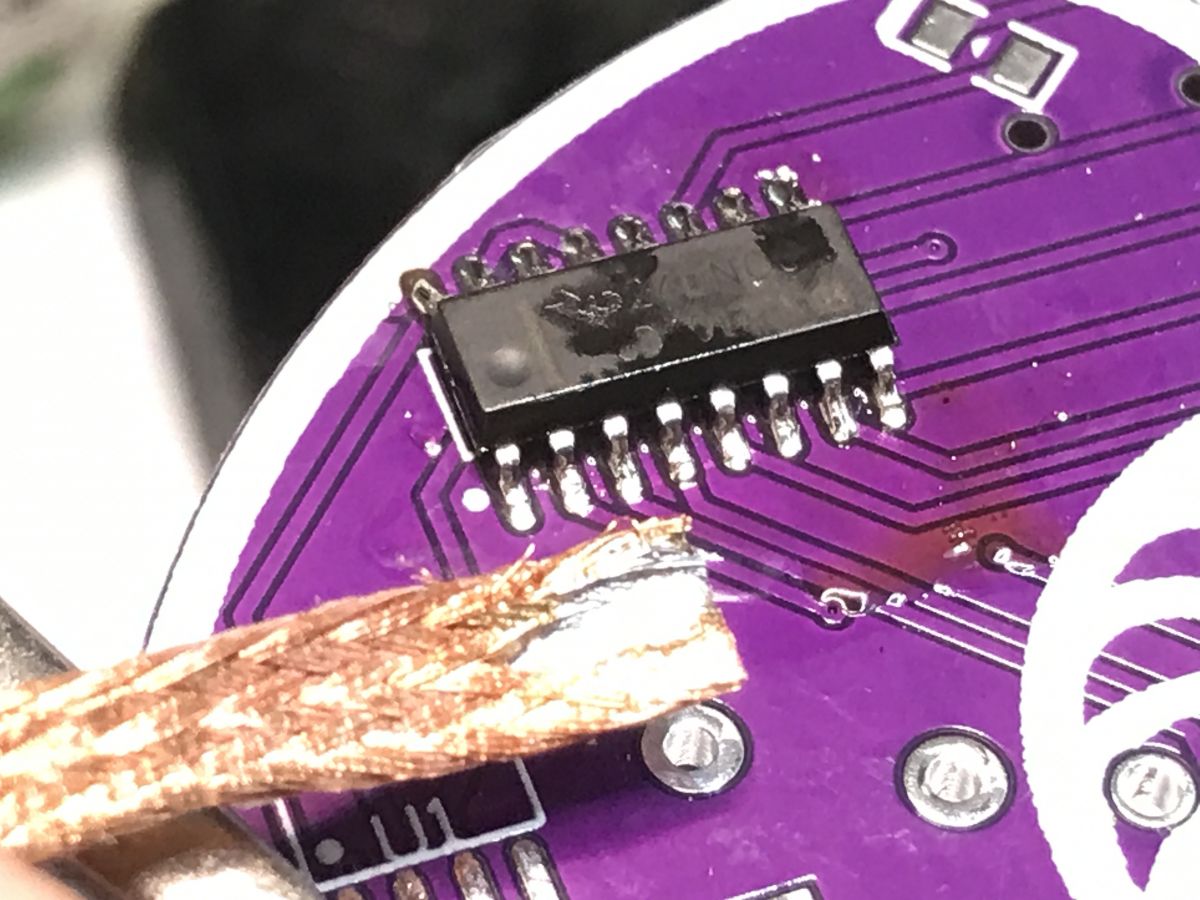

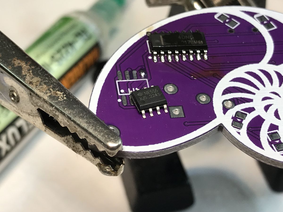

I then position the circuit. The dot on the layout marks the first pin. I match it to the dot on the PCB and grab its first pin.
Close-up of a CD4017BM integrated circuit mounted on a purple PCB. .
PCB board with a CD4017BM integrated circuit on a purple background. .
PCB with a surface-mounted SMD chip on a purple background. .

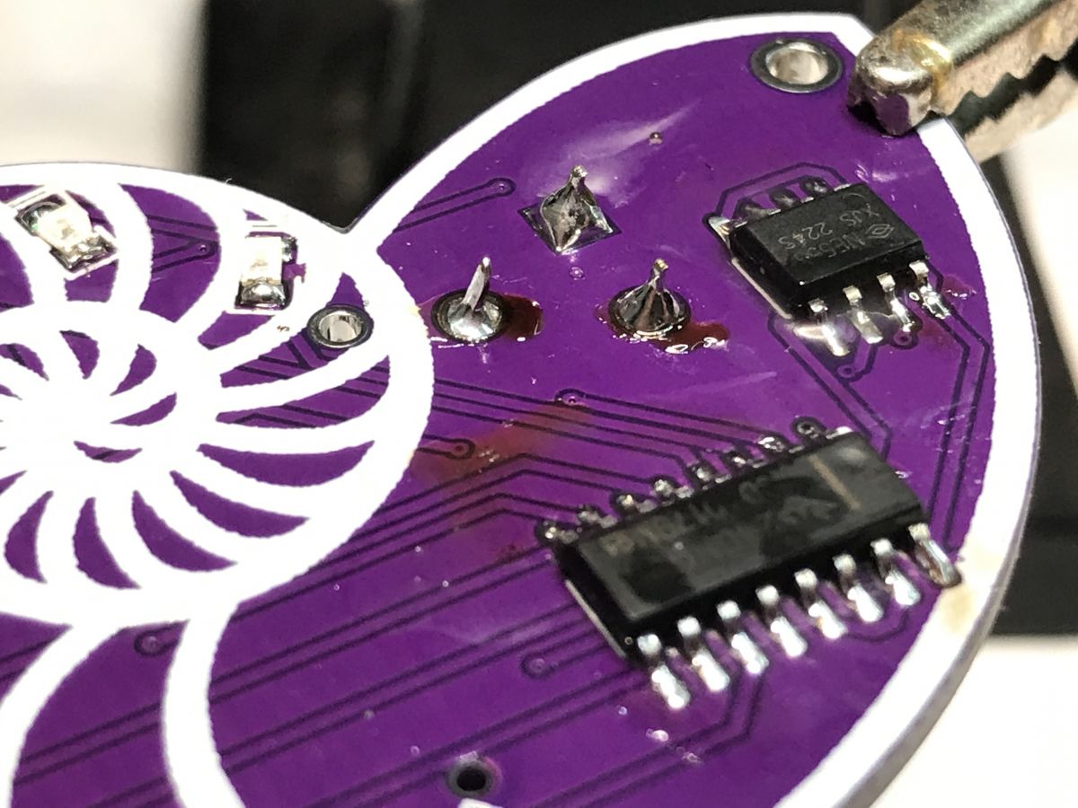

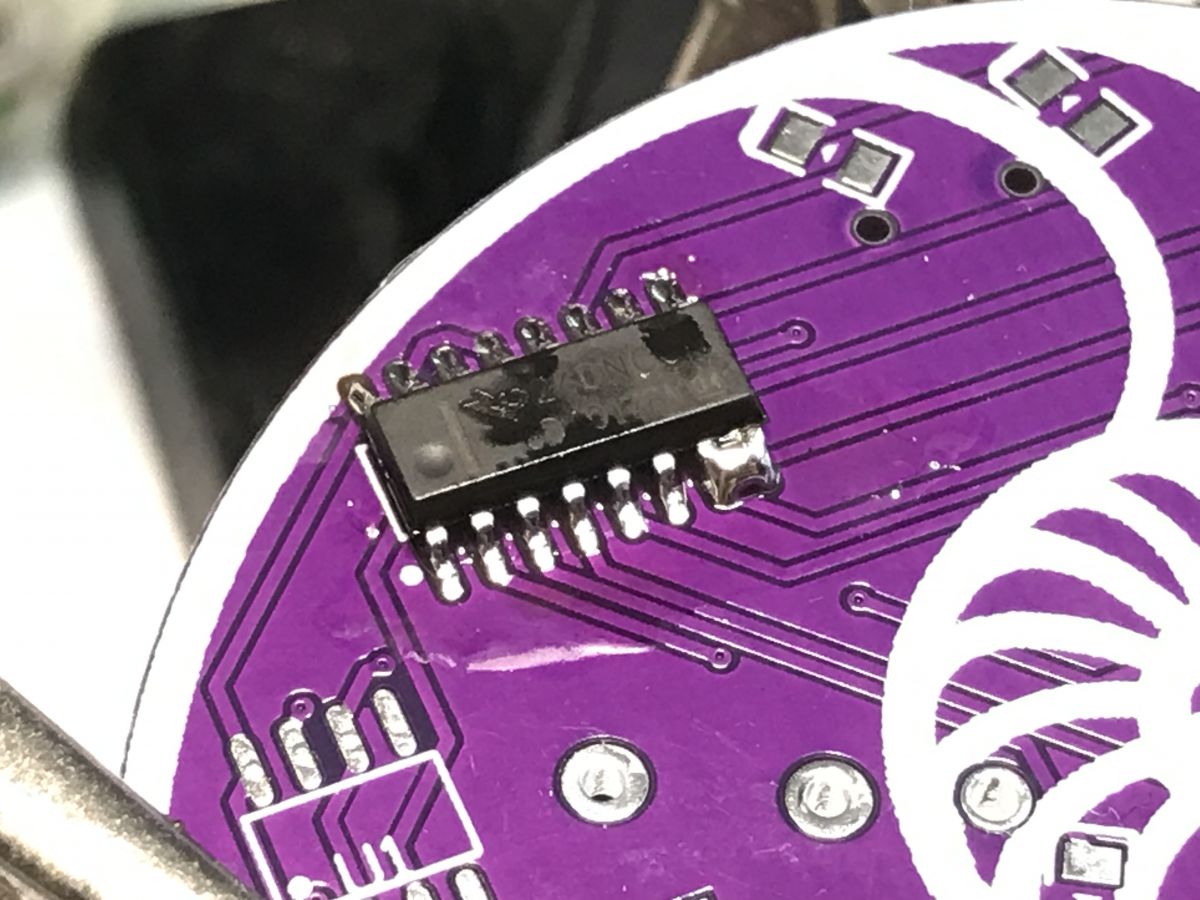

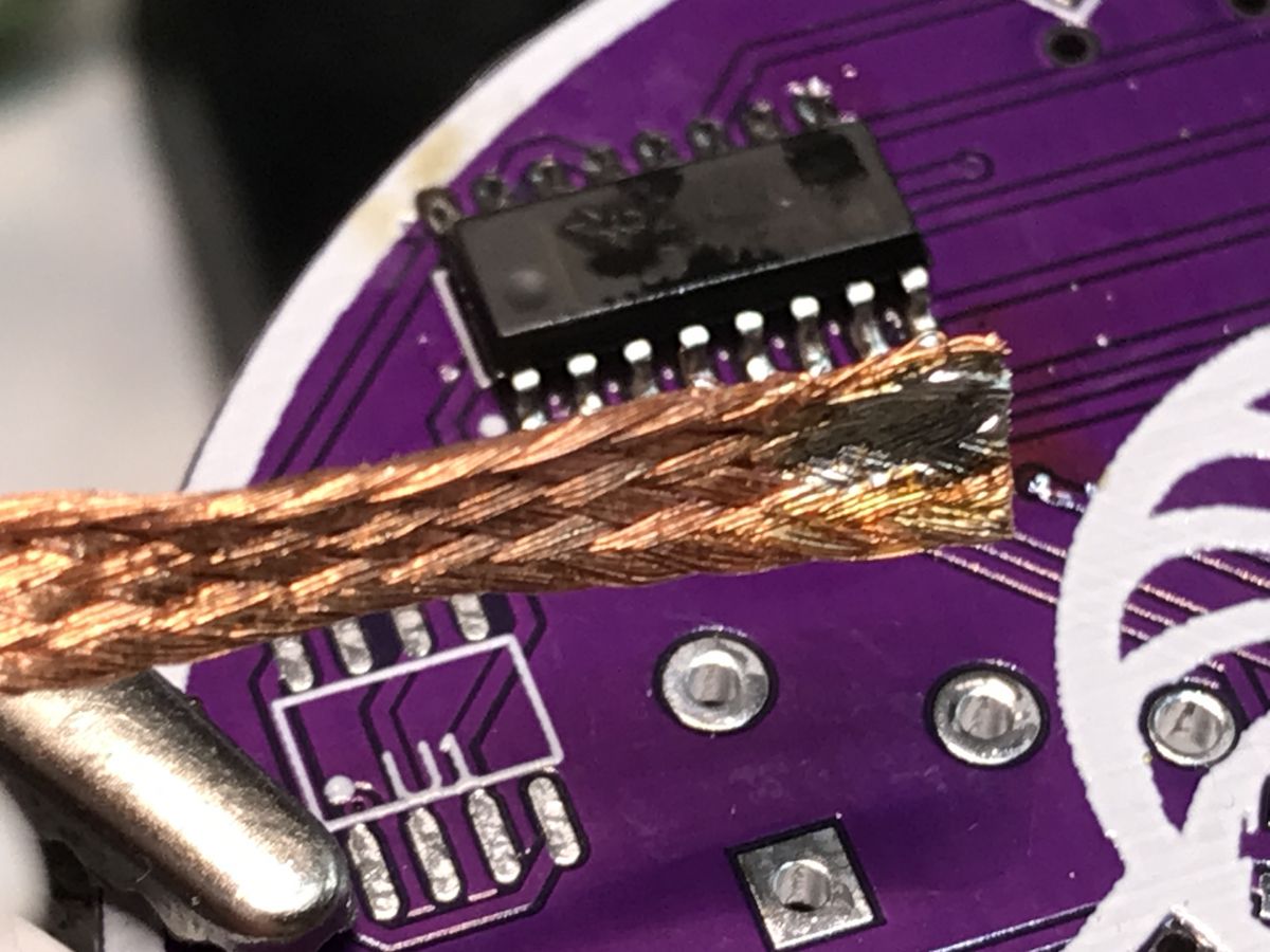

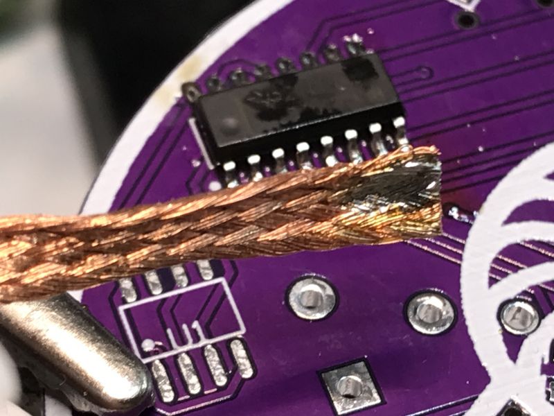

I grab the opposite leg (flux, binder) and then solder the others using the drag soldering method, passing the soldering tip over the legs. The binder melts and catches them, I remove the bridges this way, and if any short circuit remains anyway, I remove it with a braid.
PCB with a soldered IC and braid for removing excess solder. .
Close-up of a surface-mounted (SMD) integrated circuit soldered to a purple PCB. .
Close-up of a PCB with a mounted SOP package chip. .

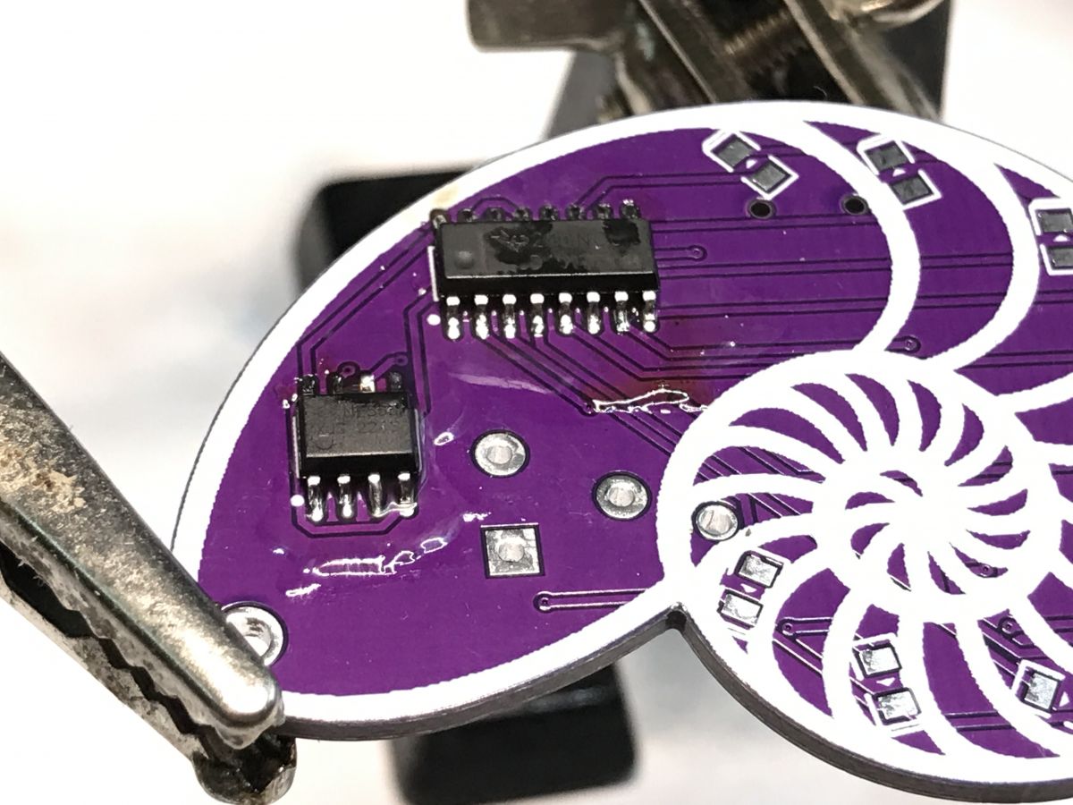

The second circuit (NE555) analogously:
Printed circuit board with SMD components ready for soldering. .
Printed circuit board with SMD components and NE555 chip .

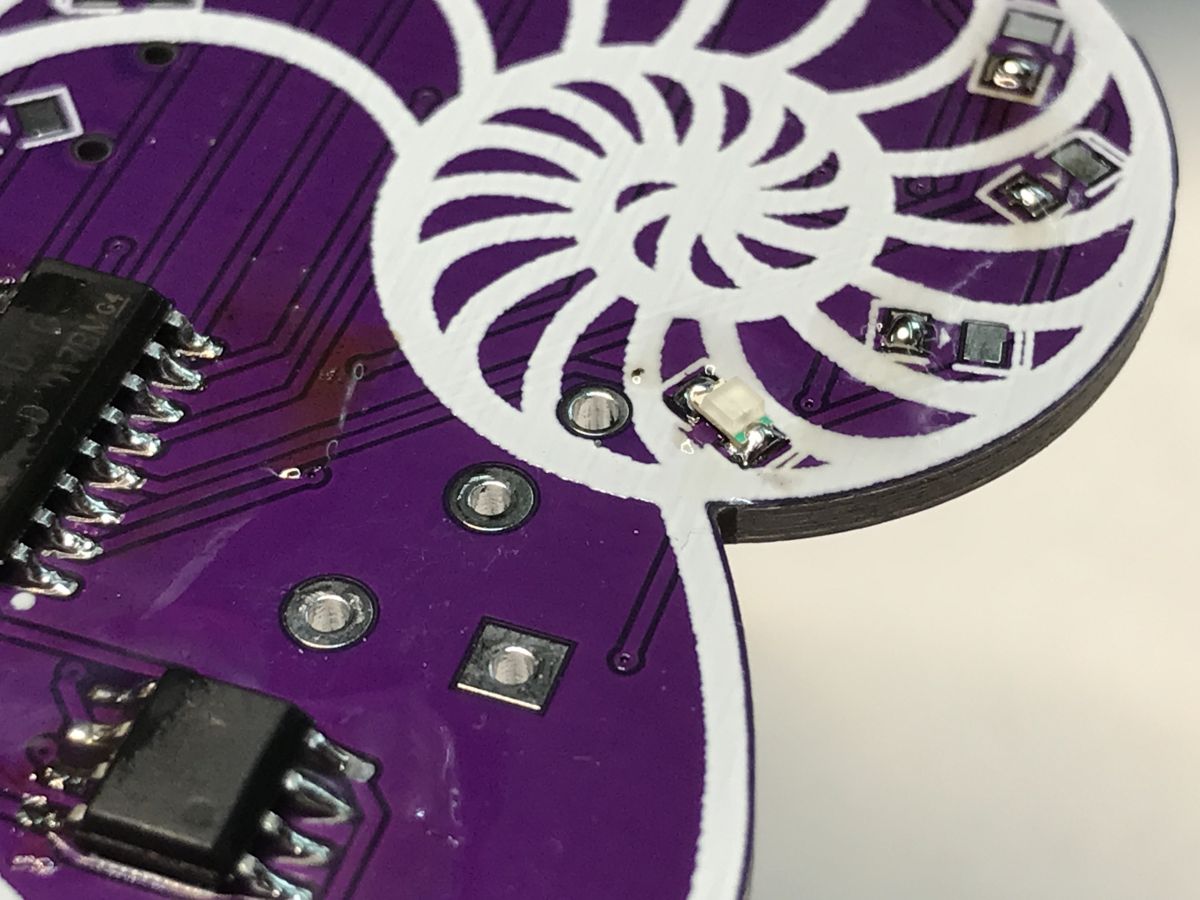

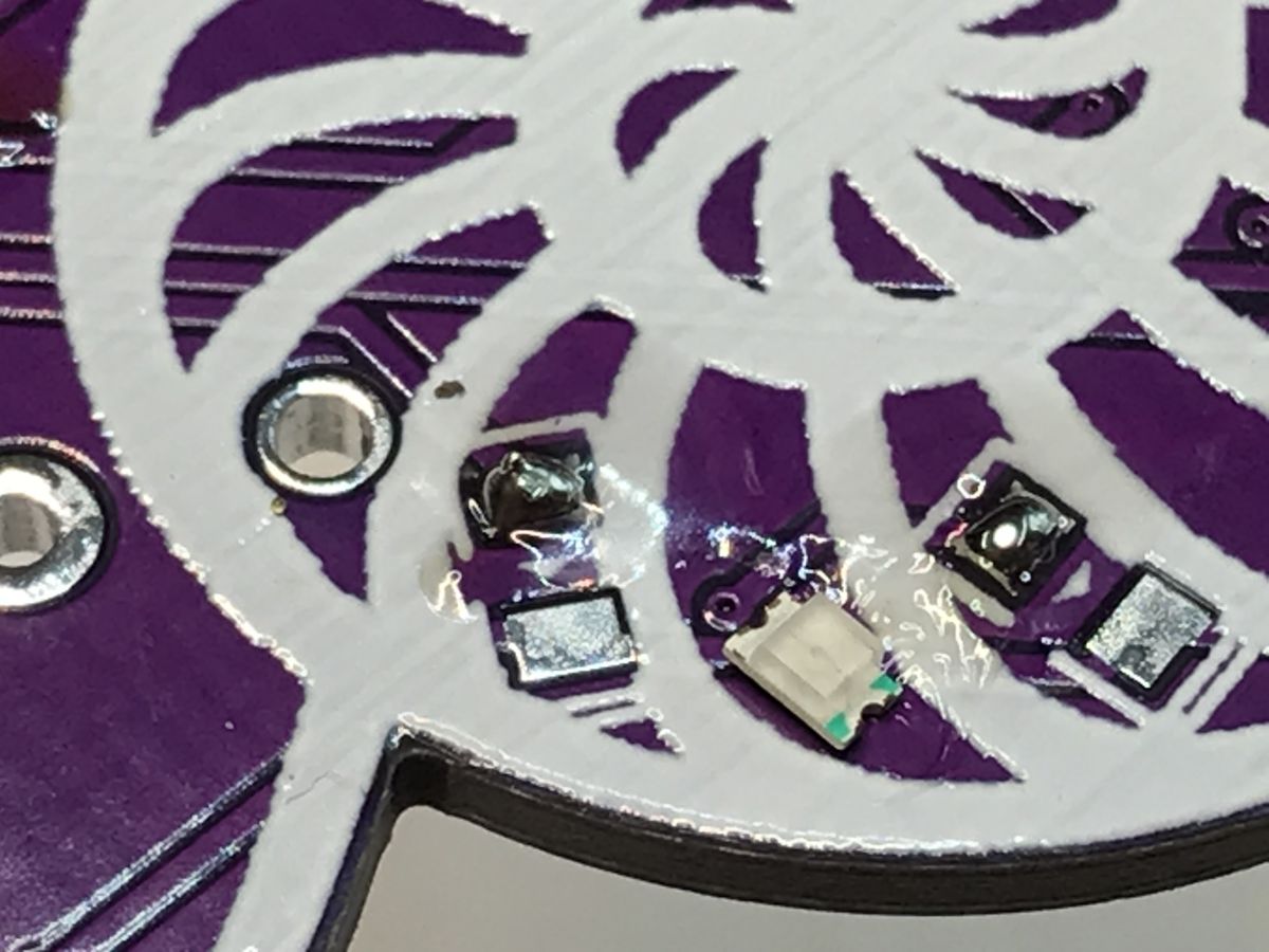

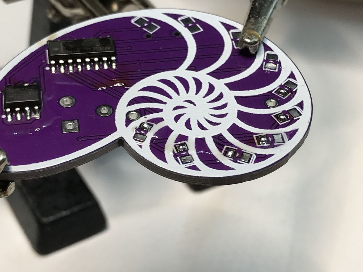

I then soldered the diodes. The double line on the board corresponds to the 'coloured' end of the diode - the cathode. For convenience, I prepared several pads.
Purple PCB with SMD components and spiral design. .
Close-up of a PCB section with mounted SMD components, including an LED, on a purple and white patterned background. .
Printed circuit board with SMD components and spiral pattern. .
Close-up of a PCB with SMD components .
DIY spiral-shaped kit with SMD components mounted in a holder. .

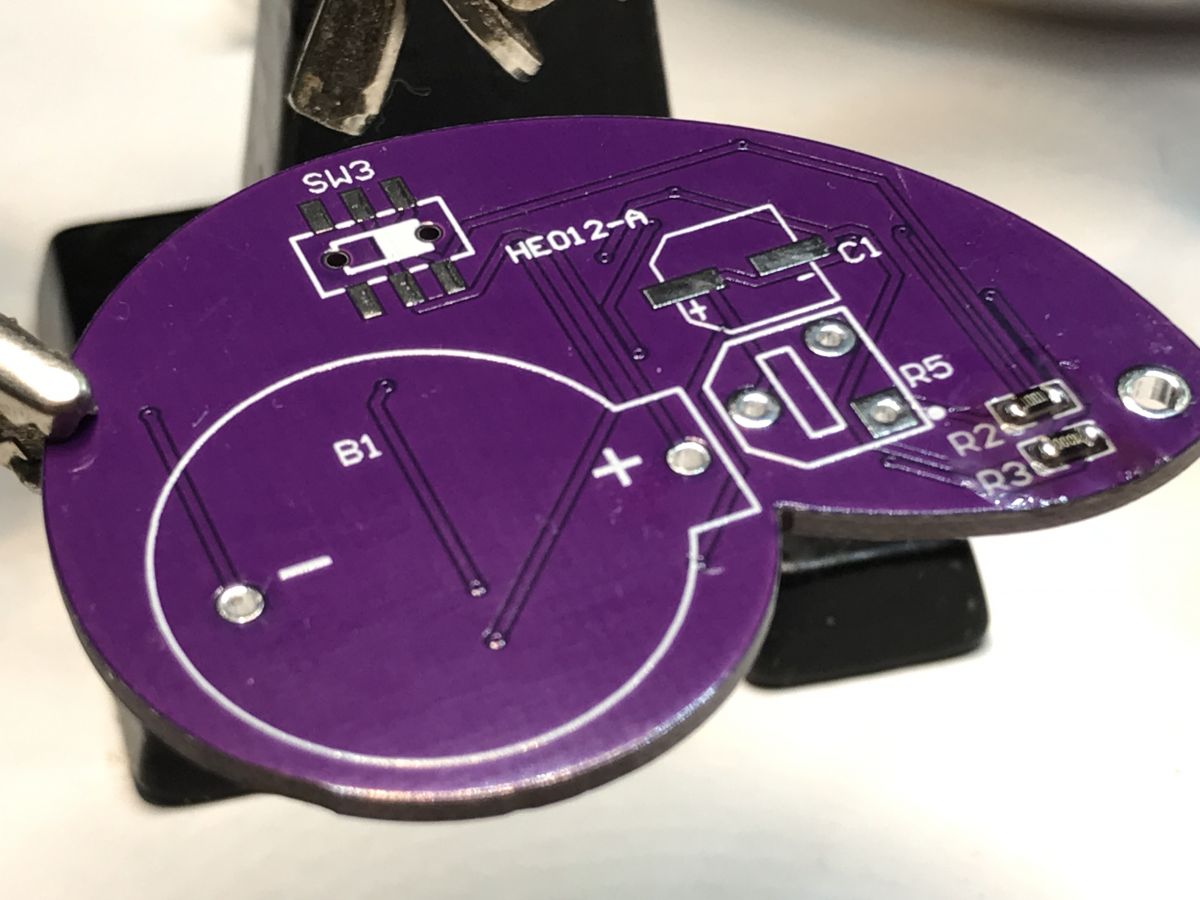

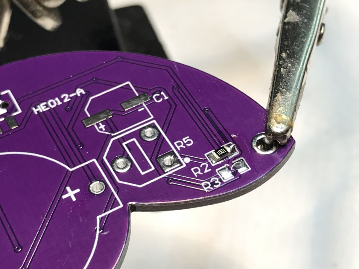

Then the resistors - analogously. Here we have two values, not to be confused. 1kΩ, which is the designation 1001 and 100Ω which is the designation 101 or 1000.
Purple PCB with designated areas for SMD components. .
Close-up of a PCB with SMD components for soldering. .
Close-up of a purple PCB with SMD components. .

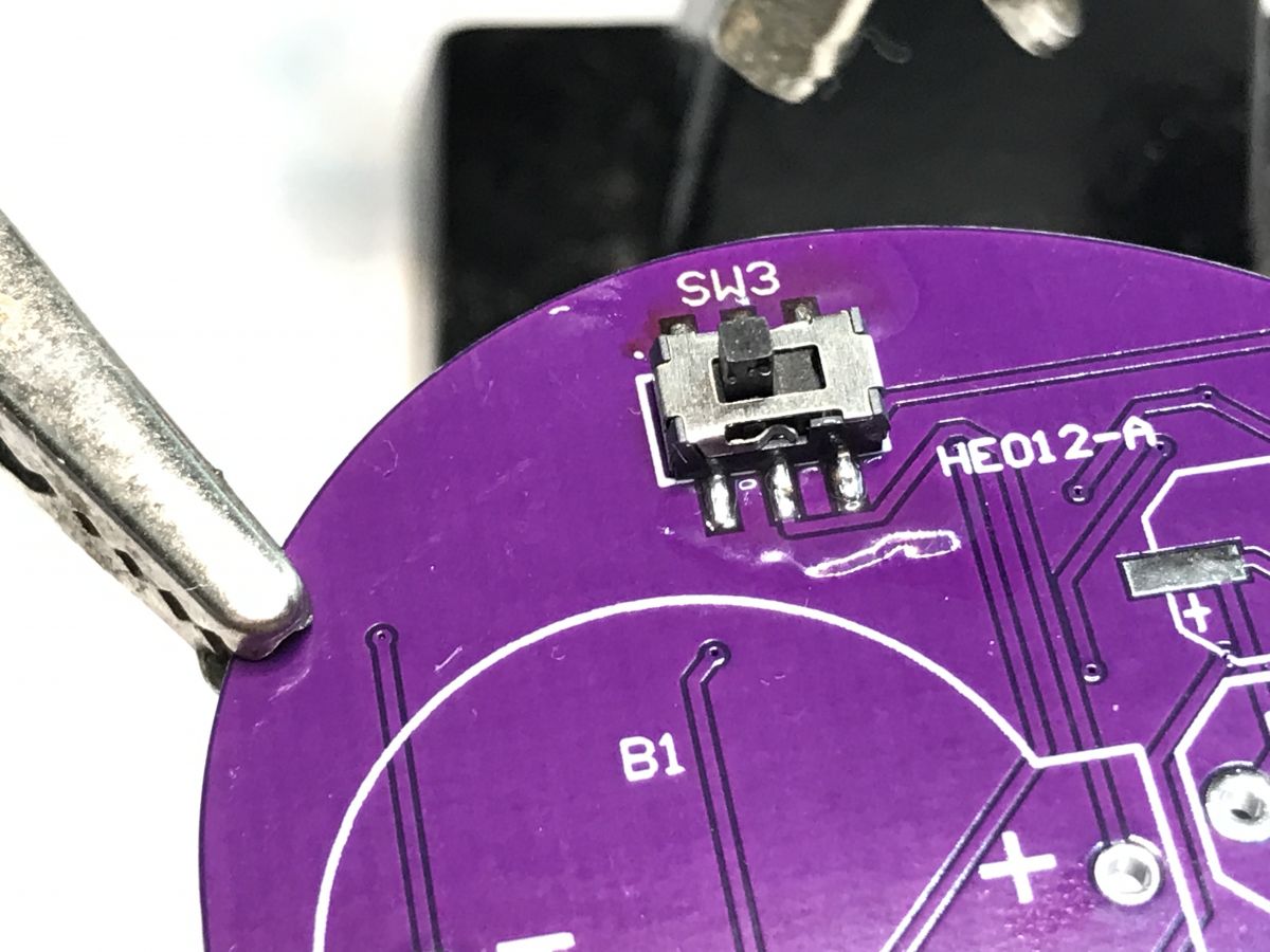

Now the switch. At it, be careful with the flux - so it doesn't get inside....
Close-up of an SMD switch mounted on a purple PCB marked SW3. .

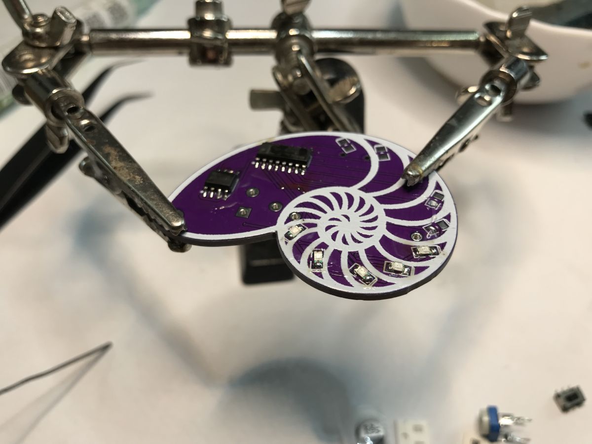

As usual - I grabbed a leg, soldered the others. Potentiometer and battery slot left:
Shell-shaped PCB with LEDs and integrated circuits.

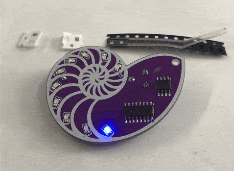

Ready, but before switching on, check for short circuits or cold soldering or bad soldering.
Animation showing a light effect on a snail shell-shaped circuit board with blue LEDs. .
The potentiometer, as you may have guessed, adjusts the speed of the light.

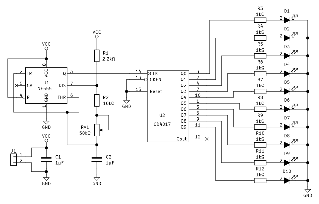

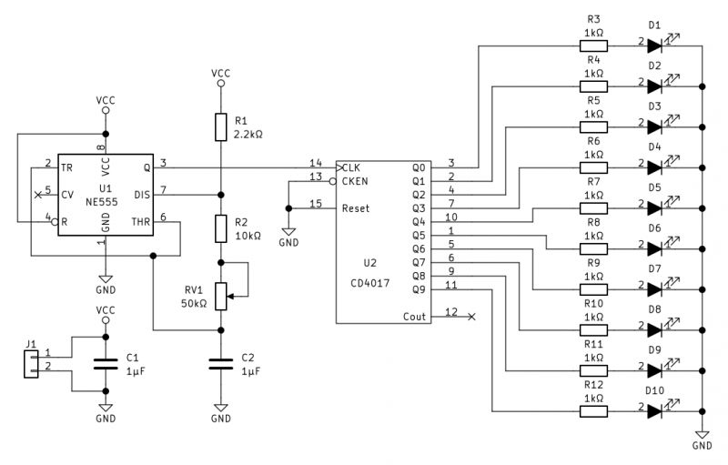

The circuit itself is a classic 'flowing light' on an NE555 and CD4017. The NE555 generates a clock pulse and the CD4017 counts it and lights the corresponding diode.
Electrical schematic of the NE555 and CD4017 circuit with resistors and LEDs
The version in the topic omits the LED current limiting resistors, this works because of the low supply voltage.
