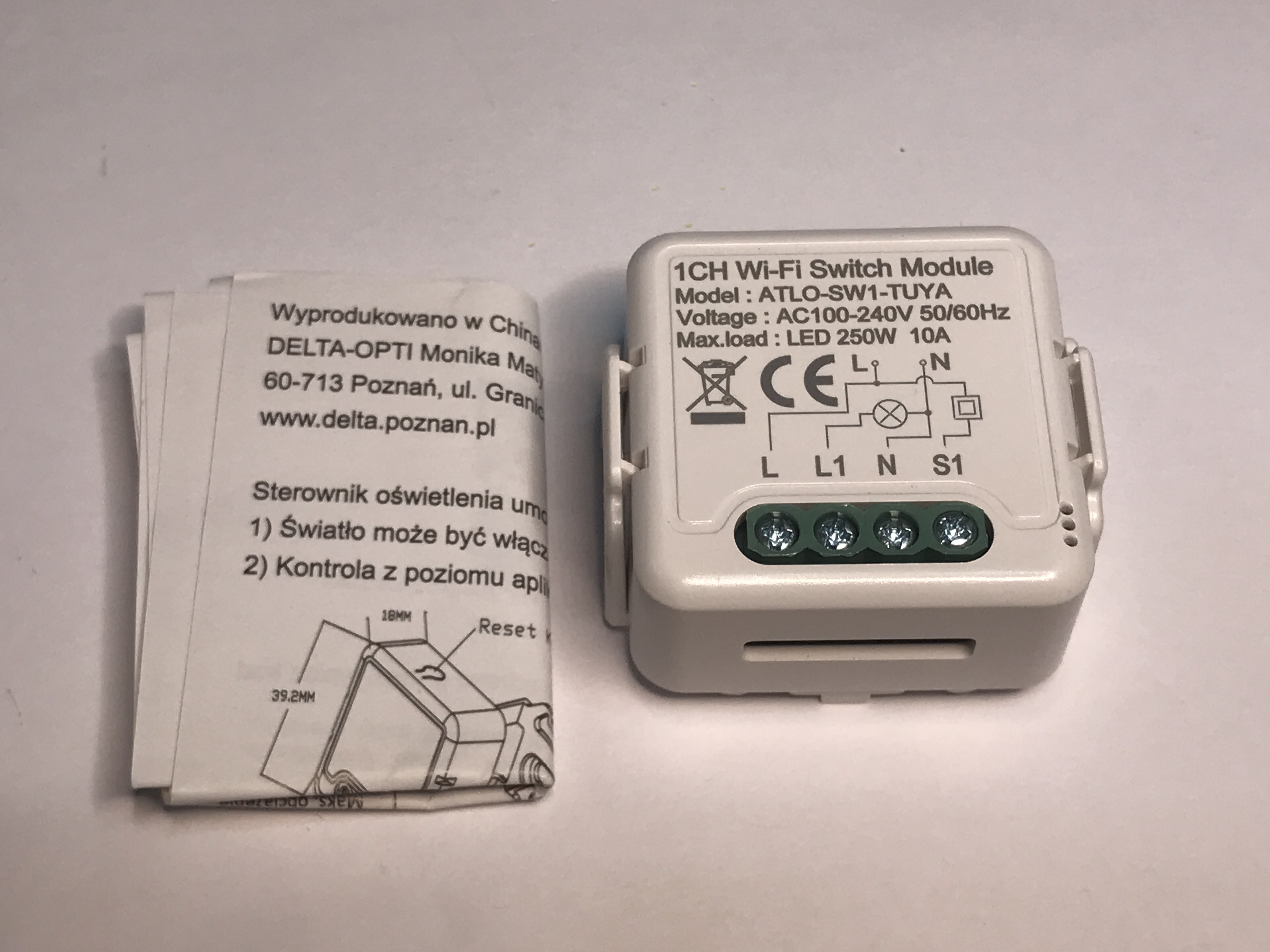

  • ATLO-SW1-TUYA is a tiny WiFi relay module for one receiver, mounted in a box and sold for PLN30, with support for a classic bistable switch.

ATLO-SW1-TUYA WiFi relay module with folded instruction manual in Polish, top view on the device and documents. .
The ATLO-SW1-TUYA is another tiny (43x39x22 mm) relay module offering control of a single receiver via WiFi. It is mounted in a box and, in addition to WiFi, it can work with a classic bistable switch. Here I will show how to change its firmware to connect it to Home Assistant. The whole thing is available to buy for PLN30.
I got this unit from a reader along with a whole set of similar relays for several rooms - I just uploaded the firmware at his request.
We start by unpacking. The product designation is ATLO-SW1-TUYA, and you can also see the name of its importer, although this is less important here as many shops sell similar products.

The product itself has an additional buckle which makes it easy to install:
White ATLO-SW1-TUYA Wi-Fi relay module with screw terminals and technical specification on top of the case. Small white ATLO-SW1-TUYA relay module on a white background, with a light bulb symbol on top of the case. .
