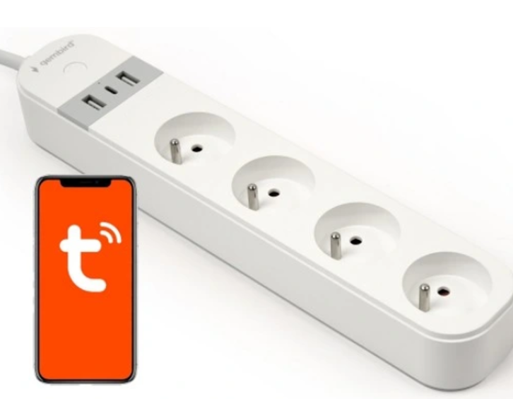

Today we are plugging another product into Home Assistant. This will be the gembird TSL-PS-F4U-01-W power strip offering four separately controlled 230V sockets and two USB sockets with a current capacity of up to 2.4A. I'll show the inside of it here, and then discuss modifying it to work locally with Home Assistant. We will upload OpenBeken onto it.
The whole thing is available to buy in our country for around PLN150. Information from the seller:
Here is the box received:
Instructions:
Programming TSL-PS-F4U-01-W .
This product normally works with Tuya, but you can change the firmware and run it with Home Assistant (without the cloud).
For the strip, first remove the feet/rubbers and then remove the screws with a flathead screwdriver, parted in the middle, that is a spanner type.
This is how we get inside:
The board cannot be removed, but I guessed from the pads that there is a CB2S module inside:

Here it is possible to program in the circuit, no need to solder out the CB2S. Just important that the product is disconnected from the mains:
The aforementioned flasher discovers GPIO roles on its own:
JSON Tuya:
Verbal description:
Device seems to be using CB2S module, which is BK7231N chip.
- Relay (channel 1) on P6
- Relay (channel 2) on P7
- Relay (channel 3) on P8
- Relay (channel 4) on P26
- Relay (channel 5) on P24
- WiFi LED on P10
- Pair/Toggle All Pin on P23
Channel five here is USB, both ports are on one transistor.

USB current capacity test .
It is indeed possible to draw some current, even over 3A (16W):
Unfortunately there is no QC here, just still 5V:
Summary .
Probably a bit pricey for the non-QC version, but apart from that I have no major complaints. There is a problem with further disassembly (after removing the cover), but it's not needed to change the firmware, so I can't complain about that here. Once the firmware has been changed, the product works with Home Assistant and does its job well.
