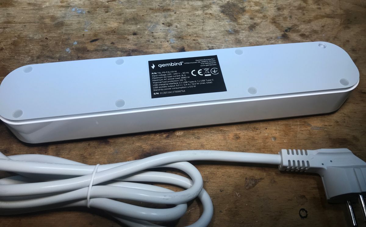

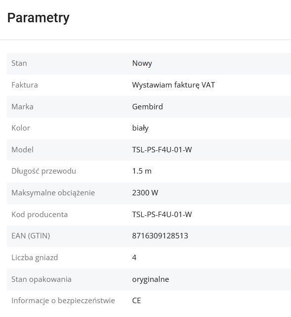

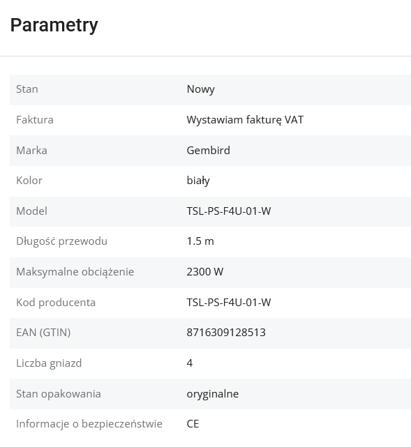

    Today we are plugging another product into Home Assistant. This will be the gembird TSL-PS-F4U-01-W power strip offering four separately controlled 230V sockets and two USB sockets with a current capacity of up to 2.4A. I'll show the inside of it here, and then discuss modifying it to work locally with Home Assistant. We will upload OpenBeken onto it.
    The whole thing is available to buy in our country for around PLN150. Information from the seller:
    Four-slot strip with USB compatible with Home Assistant? TSL-PS-F4U-01-W .

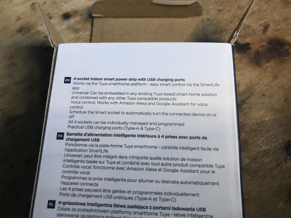

    Here is the box received:
    Four-slot strip with USB compatible with Home Assistant? TSL-PS-F4U-01-W Four-slot strip with USB compatible with Home Assistant? TSL-PS-F4U-01-W .

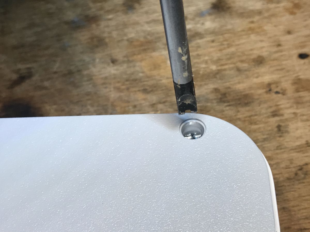

    This product normally works with Tuya, but you can change the firmware and run it with Home Assistant (without the cloud).

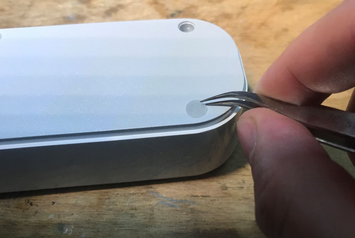

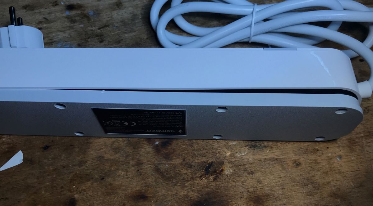

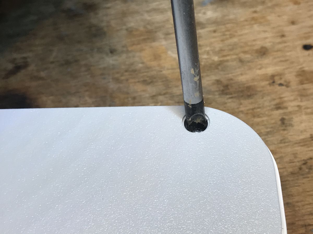

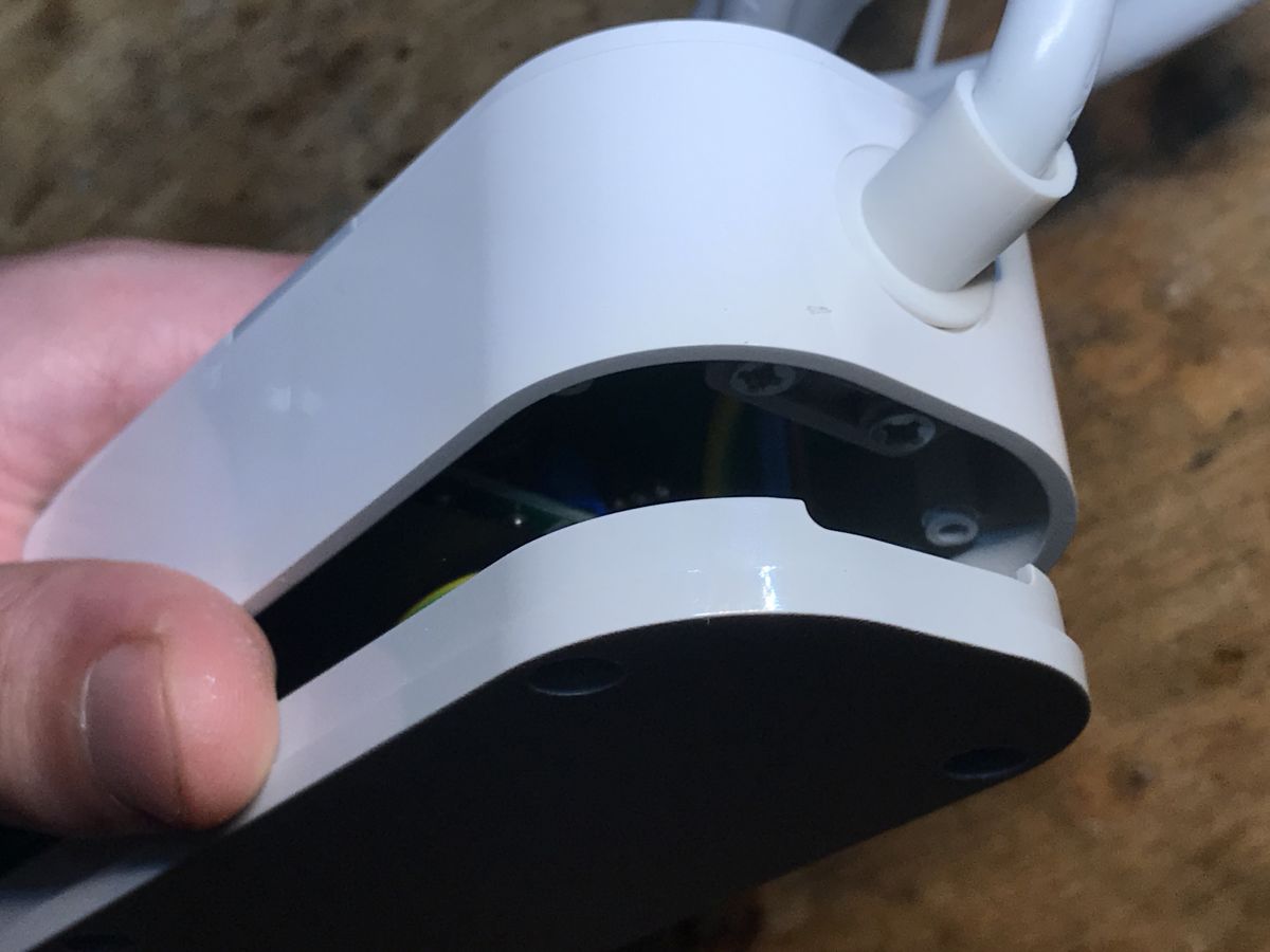

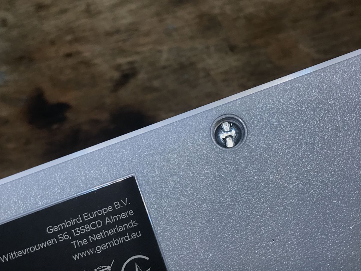

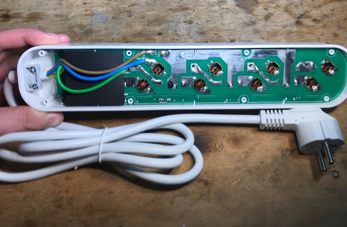

    For the strip, first remove the feet/rubbers and then remove the screws with a flathead screwdriver, parted in the middle, that is a spanner type.
    Four-slot strip with USB compatible with Home Assistant? TSL-PS-F4U-01-W Four-slot strip with USB compatible with Home Assistant? TSL-PS-F4U-01-W Four-slot strip with USB compatible with Home Assistant? TSL-PS-F4U-01-W .
    This is how we get inside:

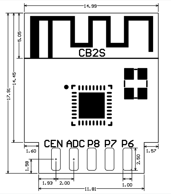

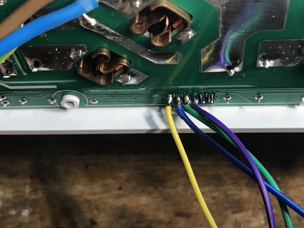

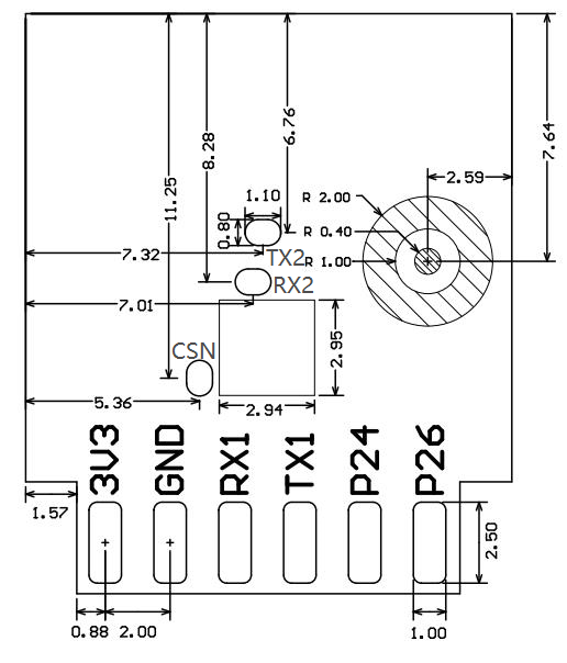

    The board cannot be removed, but I guessed from the pads that there is a CB2S module inside:
    Outputs, quoting documentation:
    . . 7. CSN
    Pin number Symbol I/O type Function
    1 3V3 P P Power supply 3V3
    2
    2 P6 I/O Support hardware PWM and correspond to P6 of the IC
    3 GND P Power supply reference ground
    4 P7 . I/O Support hardware PWM and correspond to P7 of the IC
    5 RX1 I/O UART_RX1, which is used for receiving user data and corresponds to P10 of the IC. Do not pull it up. By default, the MCU serial port should be in low-level or high-impedance state.
    6 P8 I/O Support hardware PWM and correspond to P8 of the IC
    7 TX1 I/O UART_TX1, which is used for transmitting user data and corresponds to P11 of the IC. Do not pull it up. By default, the MCU serial port should be in low-level or high-impedance state.
    8 ADC I/O ADC, which corresponds to P23 of the IC
    9 P24 I/O Support hardware PWM and correspond to P24 of the IC
    10 CEN I/O Reset pin
    11 P26 I/O Support hardware PWM and correspond to P26 of the IC
    Test point Test point RX2 I/O UART_RX2, which corresponds to P1 of the IC. This pin is not allowed to use.
    Test point TX2 I/O UART_TX2, which is used for outputting logs and corresponds to P0 of the IC
    Test point point I/O Mode selection pin. If it is connected to the ground before being powered on, enter the firmware test mode. If it is not connected or connected to VCC before being powered on, enter the firmware application mode. It corresponds to P21 of the IC.
    This module is compatible with OpenBeken .

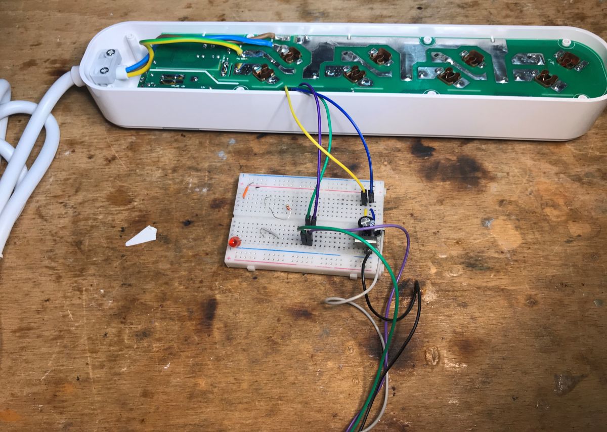

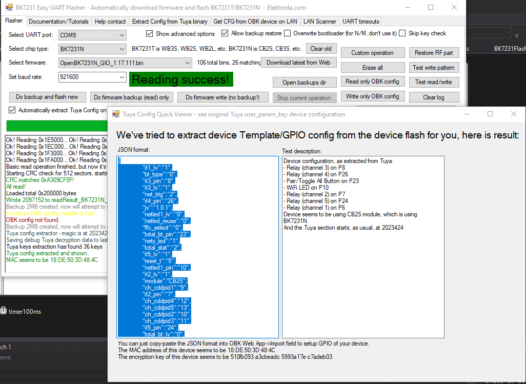

    Firmware can be changed with our flasher:
    You can also take a look at the tutorial from YT:
    Here it is possible to program in the circuit, no need to solder out the CB2S. Just important that the product is disconnected from the mains:

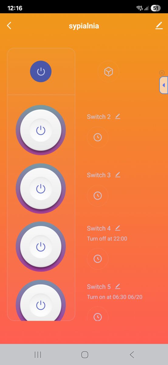

    The aforementioned flasher discovers GPIO roles on its own:
    JSON Tuya:
    Verbal description:
    Device seems to be using CB2S module, which is BK7231N chip.
    - Relay (channel 1) on P6
    - Relay (channel 2) on P7
    - Relay (channel 3) on P8
    - Relay (channel 4) on P26
    - Relay (channel 5) on P24
    - WiFi LED on P10
    - Pair/Toggle All Pin on P23
    Channel five here is USB, both ports are on one transistor.

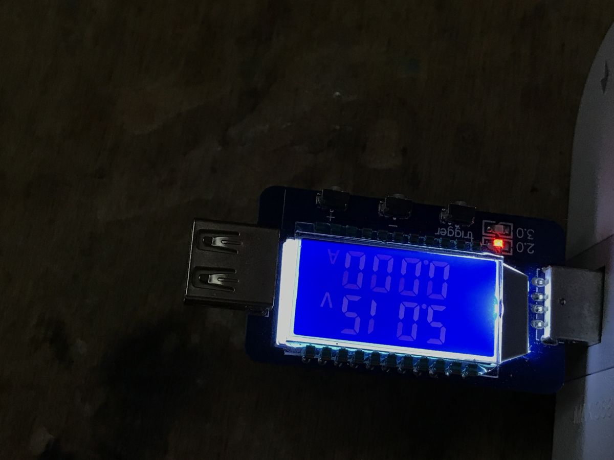

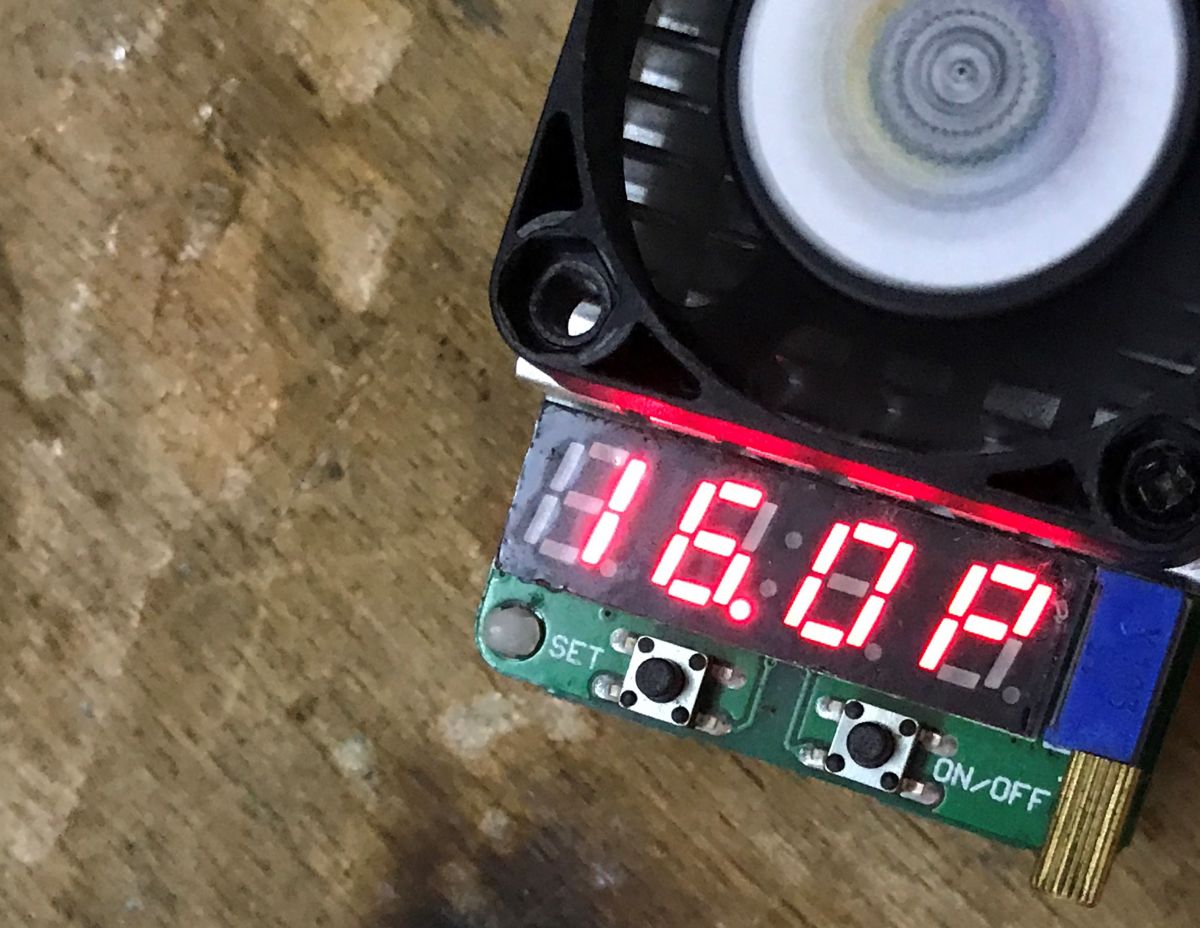

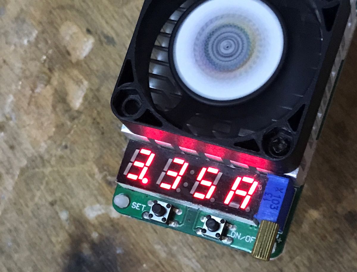

    USB current capacity test .
    It is indeed possible to draw some current, even over 3A (16W):
    Unfortunately there is no QC here, just still 5V:
