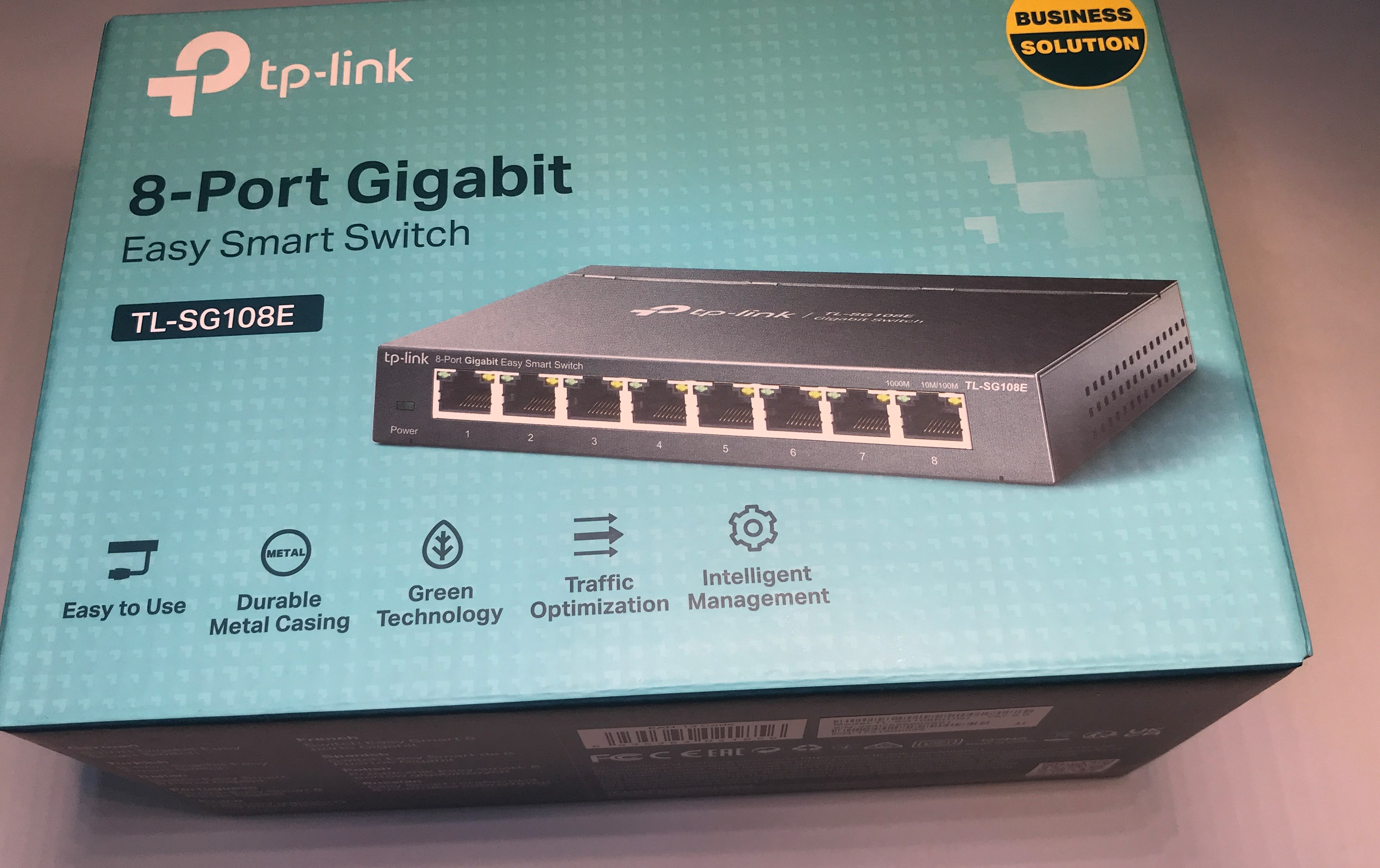

Now it's time to take a look at a brother product - a managed switch.
Extract. Set as before.
The switch looks very similar from the outside. The RESET button on the back is obligatory, the Kensington connector (for the anti-theft cord) is too.
