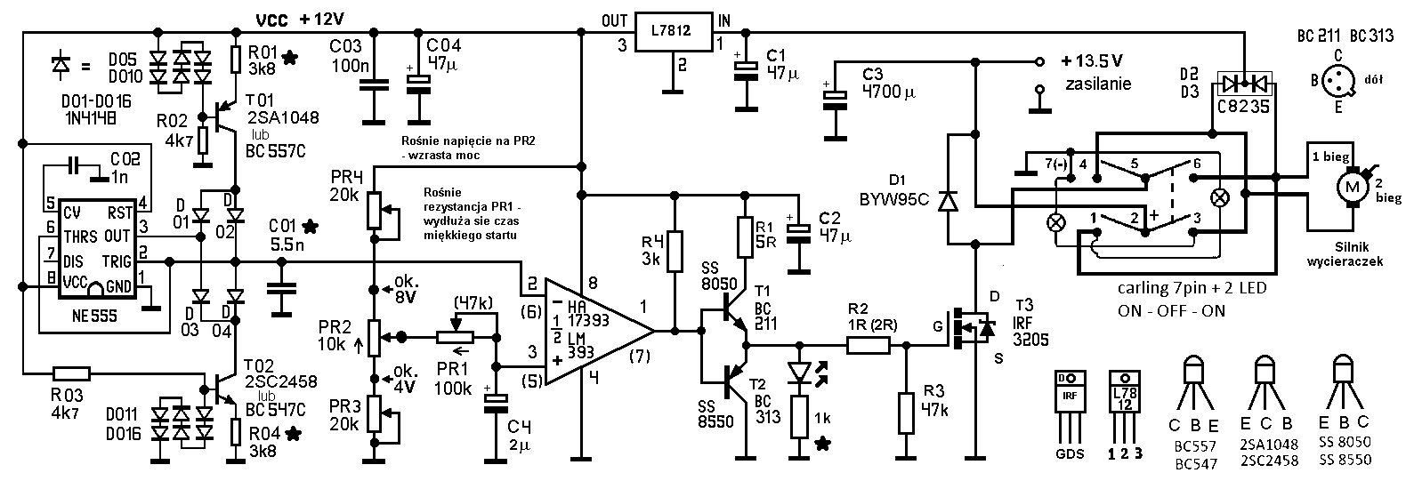

  • Ultrasonic PWM speed controller with soft start was built for a VAG automotive wiper motor driving a knot-toaster shaft through a 2:1 gear ratio.
  • The design uses a 555 triangle-wave generator feeding an LM393 comparator, with transistor current sources and discrete diodes replacing the original op-amp-based oscillator parts.
  • The regulator runs at about 16000 Hz, with PR2 for PWM, PR3 and PR4 for minimum start speed, and PR1 plus C4 for soft-start timing.
  • It removes audible squeaks and jerks, while the ATX supply was raised to 13.5V and the motor brush was isolated from ground to allow rotation in both directions.
Ultrasonic PWM with soft start for speed control of a DC motor.
The circuit was created out of the need to smoothly regulate the speed of a VAG automotive wiper motor. The motor drives the knot toaster shaft via a 2:1 gear ratio. Previous methods using two motor speeds and two voltages from an ATX power supply (somewhat regulated) proved ineffective. The ATX power supply now has the voltage raised to 13.5V permanently. The motor is also reworked - isolated the brush from the ground and an extra wire brought out. This gave the possibility of rotation in both directions.
In the design I was keen for the system to operate beyond the limit of human hearing, so that no squeaks or whistles could be heard, as it takes about two hours to bake a knot. The regulator I made earlier for drilling into PCBs with a motor from a screwdriver on an LM358 works fine, but you can hear the sound. Fortunately, this PCB activity does not last long. The soft start is designed to eliminate jerks and to cause a slow increase in the current drawn from the power supply, as the ATX power supply's short-circuit protection circuit does not like abrupt changes.
The project came about after unsuccessful attempts to generate higher frequencies on operational amplifiers and use them as comparators. Searching the web I finally found a triangle generator solution to adopt. The generator worked immediately. I then struggled a bit with MAA741 and LM358 as comparator - they didn't work. A typical HA17393 comparator worked.
I designed the generator current sources on transistors. I decided that for my application they did not need to be very accurate and replaced the operational amplifiers in the triangle generator (link one) with transistors (any low power pair). I replaced the Zener diode with six ordinary ones because I didn't have one. The generator started and stayed that way. In general, the regulator is made from 'recycled materials', from disassembly and everything that was already there. I only bought a 10k rotary potentiometer and two precision ones of 20k each.
The regulator from the schematic works at about 16000 Hz. There is no noise or squeaks. A bit about the settings. PR2 is the PWM control. Using potentiometers PR3 and PR4, you can set from which speed the motor should start. The minimum I have set myself is that the motor has a low speed and is always rotating. From this speed, you can adjust up to 100 %. To set the soft-start time, potentiometer PR1 and capacitor C4 are used. (Instead of PR1 there is a 47k resistor.) For starting it is good to have an oscilloscope, but it can also succeed without one. Approximate voltages to set are given.

The charging (discharging) current of capacitor C01 flowing through resistor R01 (R04) must be small to get a good signal shape, the current flowing through resistor R01 should not exceed 20 mA.
This current is calculated from the formula
I=(UD5-D10 - UBE)/R01, I=(3.6V-0.6V)/3800Ω=0.00078947A
where UD5-D10 is the voltage drop across the diodes - 3.6V(in this case 3*0.6V), and UBE is the conduction voltage at the base-emitter junction of transistor T01 (0.6V).
If the charging and discharging currents are equal then the charging and discharging times (rise and fall) can be calculated from the formula:
T=VCC*C01/3*I
The period will therefore be 2T and the frequency f=1/2T

ArturAVS 06 Jul 2025 17:18
You have not taken into account that too high a frequency, will generate losses in the (steel) cores. The maximum that is used is 200 - 500 Hz. 16 kHz is the frequency of the FBT in CRT TV. [Read more]
heniek07 06 Jul 2025 17:23
The lack of squeak in the ears is more valuable in this application than the loss of energy. [Read more]

Hello I think it would be simpler to make a regulator using a typical PWM modulator e.g.: UC3843, or TL494. https://320volt.com/en/motorlu-bisiklet-icin-motor-surucu-devresi-tl494-pwm In this... [Read more]
heniek07 06 Jul 2025 18:23
Amateur to professional question: If I use a pulse capacitor of 0.1 to 1µF in parallel to the D1 diode, could it be that the motor will run at some constant voltage without dropping to zero? I saw such... [Read more]
CosteC 06 Jul 2025 19:59
. If you do this you will be putting short circuit pulses through T3 that are limited by this new capacitor. Bad idea. Losses will reach C*U^2*0.5*f. A low-pass filter, preferably LC, falls between the... [Read more]

fred_onizuka 06 Jul 2025 22:13
I'm afraid the squeal is there and reaching your ears, only you can't hear it. I probably wouldn't hear it either. But 16 kHz is within the range heard by humans (it's not ultrasound) and very young people... [Read more]
heniek07 06 Jul 2025 22:25
The 58µs period is about 17 241Hz. I'll have to bring in someone younger and ask for detection. If it bothers the youngsters I will reduce the capacitance of C01 from 5.5nF - it is put together with 3.3nF... [Read more]

reaven22 09 Jul 2025 00:45
It uses adjustable step-down converters to regulate the speed of the DC motors, reducing the voltage. We have a full range from zero with no squeaks. Inverters for a couple/teen PLN each with a soldered... [Read more]
