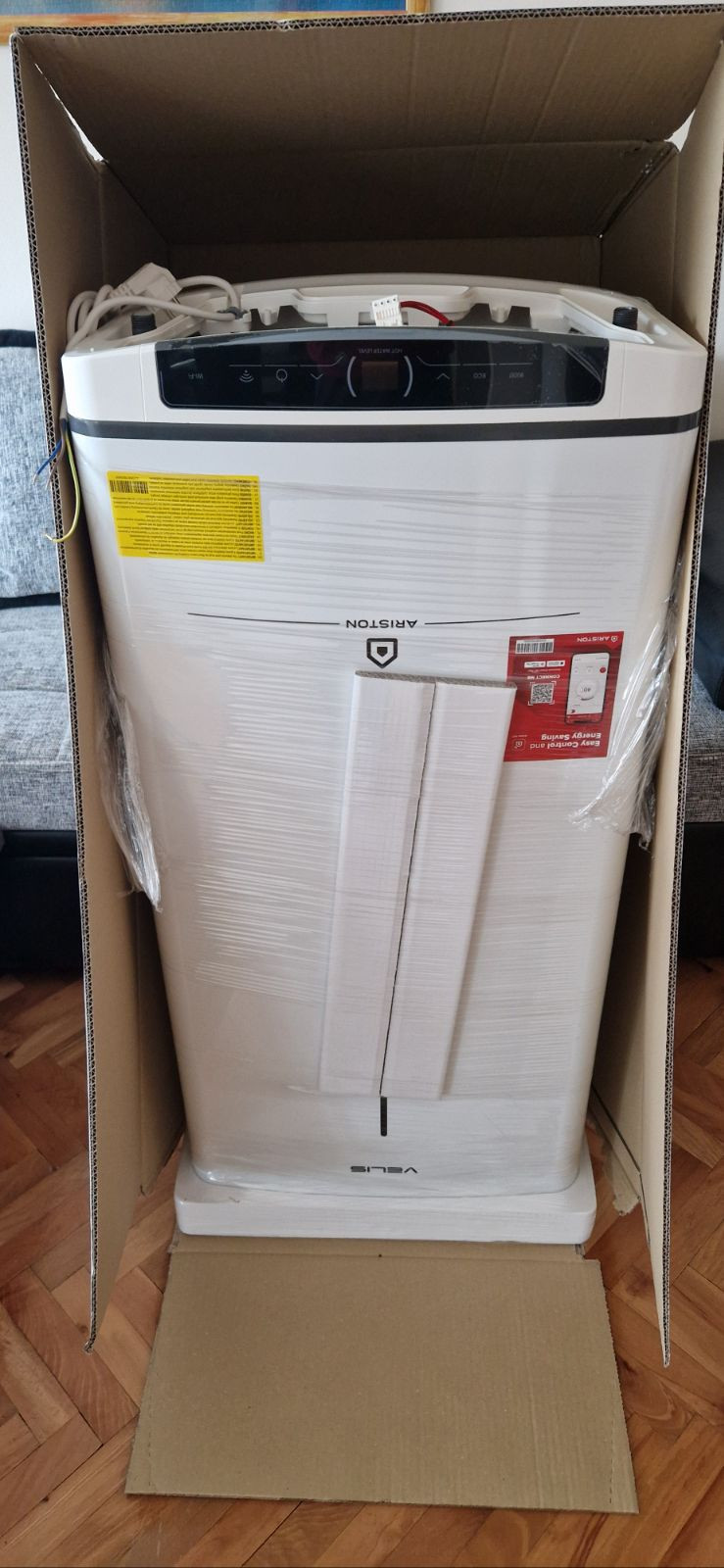

The package arrived quite quickly, the courier brought such a box:
Box of the Ariston Velis Wi-Fi 80 water heater standing vertically by the wall. .
The whole thing is well packed for transport. In the box we have a full pictorial manual and a detailed multilingual manual. There is also a leaflet declaring the energy class B of the product.
