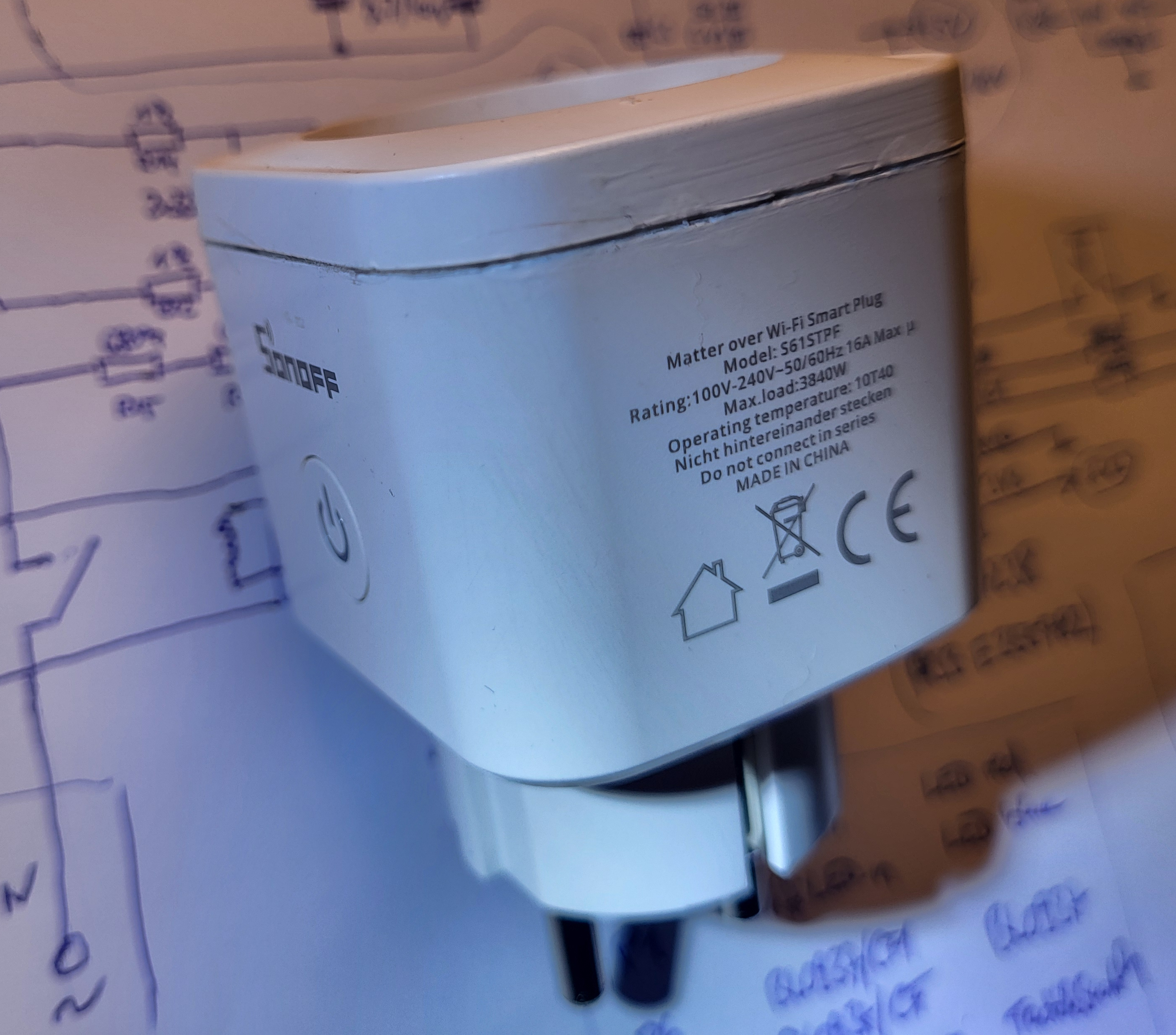

This is a teardown and modding guide to OpenBeken of the Smart Plug Sonoff S61TPF which is available at Amazon for 10,99 € in December 2025.
The device looks as follows
White Sonoff smart plug with tech details, placed on handwritten technical diagram
Before starting the teardown: The procedure requires experience in opening plastic housings, soldering, especially desoldering and knowledge about electrical safety. We are handling a power plug for 230 VAC - that is dangerous voltage. Please only open the device if you know, what you do. You should not do it!
