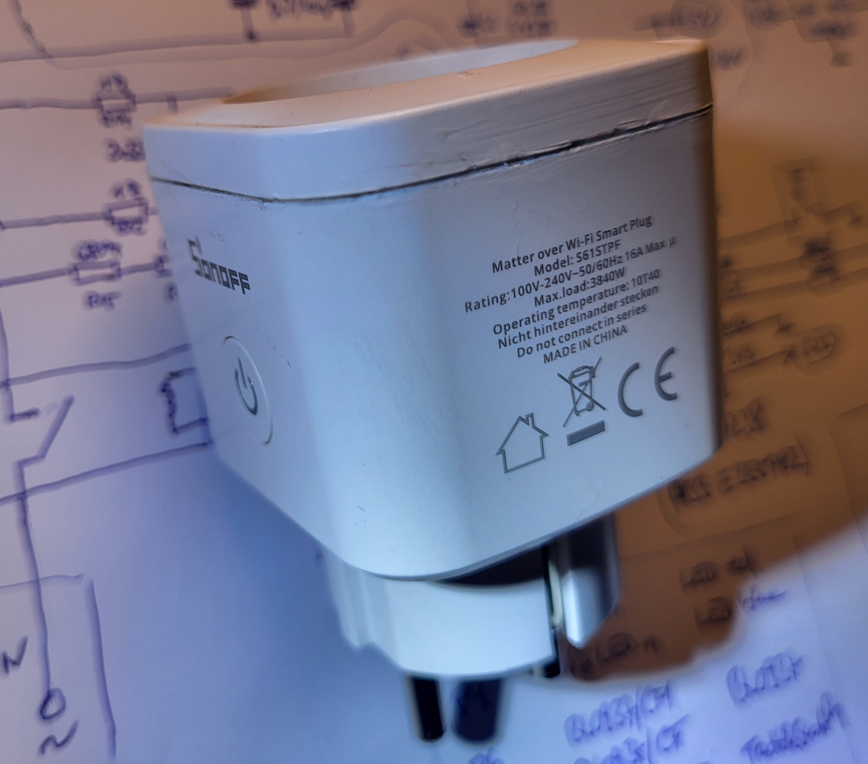

  • This is a teardown and modding guide to OpenBeken of the Smart Plug Sonoff S61TPF which is available at Amazon for 10,99 € in December 2025.
    The device looks as follows
    White Sonoff smart plug with tech details, placed on handwritten technical diagram

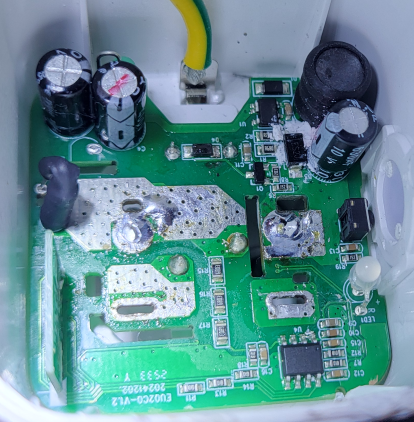

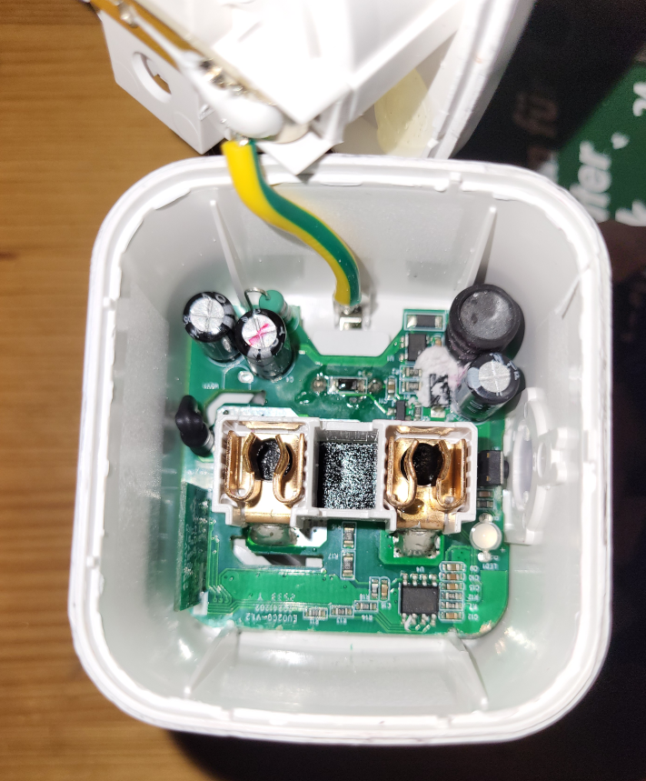

    Ok let's start. For all steps specified you can plan for one hour to complete the conversion of Sonoff's Matter firmware to OpenBeken...
    1. Opening the housing
    Place the end of the chisel into the slot on the side of the power outlet and give it a short hard hit with the hammer. You should here a crack breaking the glue between power outlet and inlet. Do this in steps around the whole slot of the part. If you feel it cracked several times you can try to use the chisel to leverage it out.
    In the open state it looks as following:
    Interior of electrical device with PCB, capacitors, and metallic socket terminals

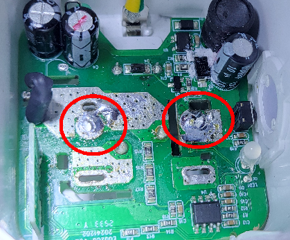

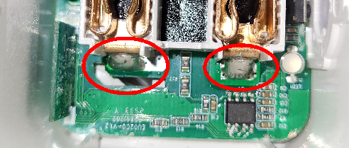

    2. Removing the socket part
    With the help of the soldering iron and a desoldering pump you need to remove the solder from the marked points:
    Damaged PCB with two swollen capacitors marked in red
    Then grab one side of the socket with the pliers, heat one of the two marked points with the soldering iron, and try to pull out the socket. Once one side has come loose, do the same with the other side.

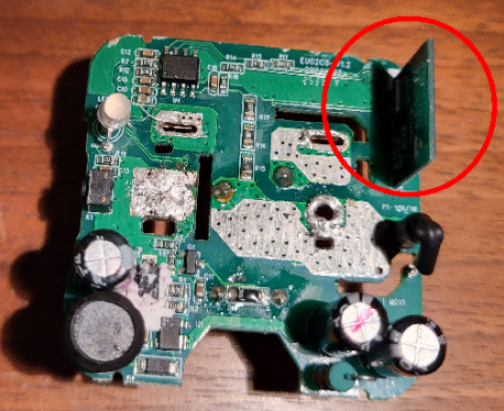

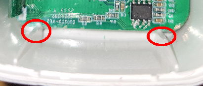

    3. Removing the main PCB from the housing
    This is the most difficult part - at least it was for me.
    You should start with cutting the two keys on the one side marked to let the PCB being pulled out when loosened the soldering from the plugs pins:
    Printed circuit board inside a white casing with red circles marking mounting points
    Now remove the solder from the marked locations where the plug pins are soldered into the PCB with the help of the desoldering pump and braid:
    Damaged circuit board with burnt components marked by red circles
    When the solder is sufficiently removed most likely the PCB will still stick to the pins of the plugs. Therefore use the needle-nose pliers to grab the two slotted holes and at the same time heat up the two pin locations with the soldering iron pulling the PCB out. Be careful not to damage the PCB. It needs patience and some force.

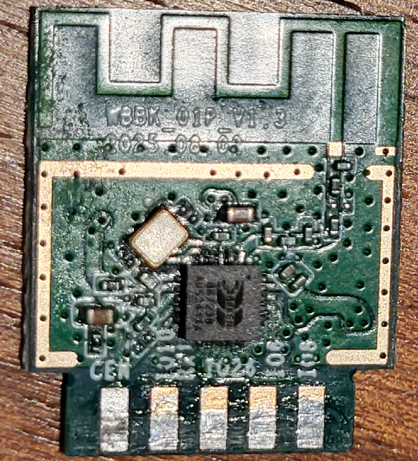

    When done you have the full PCB in your hands with the BK7238 microcontroller board marked in following photo:
    Circuit board with electronic components and a vertical PCB antenna

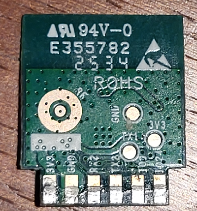

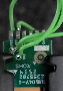

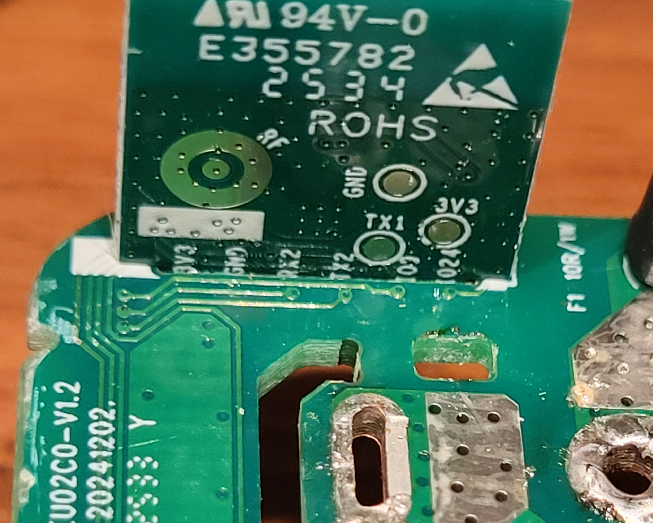

    4. Attaching the programming cables to the microcontroller board
    I have removed the microcontroller board - again with soldering iron and the help of desoldering braid - and have attached four appr. 5 cm long cables to the solder eyes marked as GND, 3V3 and TX1 on the one side of the PCB and to RX1 on one of the copper connections.
    Update after the conversion of the second device: You may leave the microcontroller board soldered to the main board. Just solder the three GND, 3V3 and TX1 cables to the PCB's copper eyes and the one to the RX1 connection on the other side - locate them with the help of the following photos:
    Close-up of PCB module with ROHS, TX1, GND, and 3V3 markings.
    Small PCB module with markings, connectors, and circuit traces
    Electronic module with chip and PCB antenna on green circuit board
    Close-up of green wires soldered to a small printed circuit board

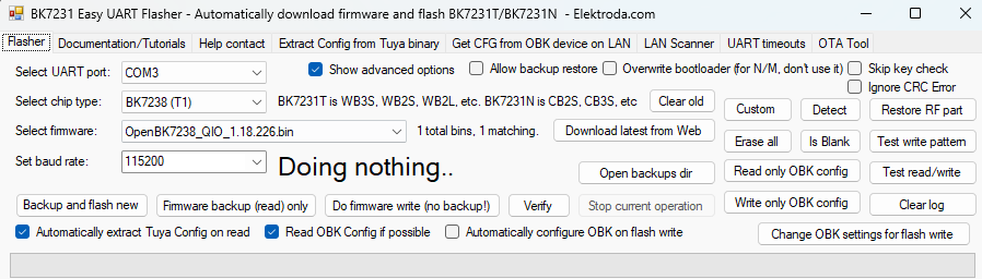

    5. Flashing OpenBeken
    I have used a breadboard with a 3V3 power supply to which I have plugged the microcontroller cables and the FTDI232 and following connections:
    [/table:4468996eaf][table:4468996eaf]
    Power Supply 3V3BK7238 3V3
    Power Supply GNDBK7238 GND and FTDI232 GND
    FTDI232 RXBK7238 TX1
    FTDI232 TXBK7238 RX1
    Be careful to set the FTDI232 to 3.3V by the use of the correct jumper setting before plugging it to the computer!
    - Start the BK7231GUIFlashTool
    BK7231 Easy UART Flasher interface with COM3 and selected OpenBK7238 firmware
    - Select your COM port (normally it auto detects)
    - Select chip type BK7238 (T1) and Download latest firmware from web
    - Select Backup and flash new
    You may need to power cycle the 3.3V power supply before the GUI gets connected with the BK7238.
    After this procedure you should have a backup of the original Sonoff firmware and OpenBeken being installed on the device.

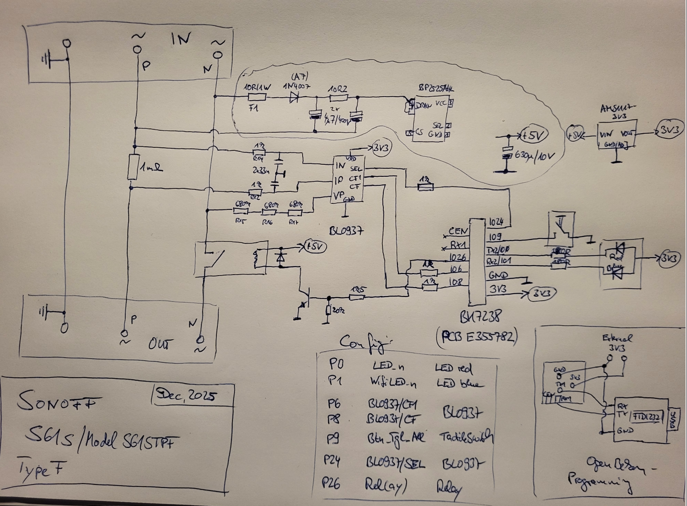

    9. Schematics
    See following schematics which depicts most of the internal wiring - only the 230 VAC to 5 V power supply around the BP2325AHL is not reverse engineered. There is no guarantee for correctness of the other parts! This is just for documenting the status I've got.
    Hand-drawn circuit diagram of Sonoff SG15T device with labeled components
