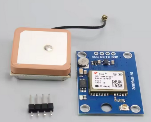

If you don't have (or don't want) your device to get the time via internet and NTP I made two pull requests for additional time sources: GPS and DCF77 (a German longwave time signal radio station).
For the devices with a usable UART, you can use my NEO-6M driver. It will decode the NMEA statements from the device and allow you to set the devices time and even latitude/longitude in case you are using "sunrise/sunset" calculations.
The modules are quite cheap (~2.5 to 3 € on ali) an you need to connect the NEO-6M RX and TX to the devices TX and RX.
Here an example with the module connected to BK7238 module (needs "flag 26" for me, so NEO6M TX is connected to P1 and NEOs RX to P0).
You have the following arguments to
"<baudrate>" will use the integer as baud rate - this requires NEO6M was set to this baudrate permanently before. It will not send any command to NEO6M!
"setclock" will set the obk time to GPS time if NEO6M is "locked"
"setlatlong" will set the obk latitude/longitude to GPS values if NEO6M is "locked" (and "ENABLE_TIME_SUNSET_SUNRISE" is defined)
Usually the GPS module will send a lot of NMEA messages every second - this would need a lot of buffer for the "parser".
So on startup the driver will send the command to disable all messages except RMC (we will only parse "$GPRMC" lines).
If you have the possibility to set the NEOM6 permanently to only this output, you would only need the RX on the obk side.
You might read and set the module via "u-Center" software available at "https://www.u-blox.com" - or use the recenty added "savecfg" argument to "startdriver".
Not tested too much, but works o.k. here ...
As my desk is not directly next to a window, reception sometimes is bad. So I bought a pigtail and an antenna for a vehicle with an 2m cable.
I didn't measure, but I'd say reception is not as good as if I lay the original antenna there - but it's o.k. to get a GPS signal even 1.5 meters away from the window.
