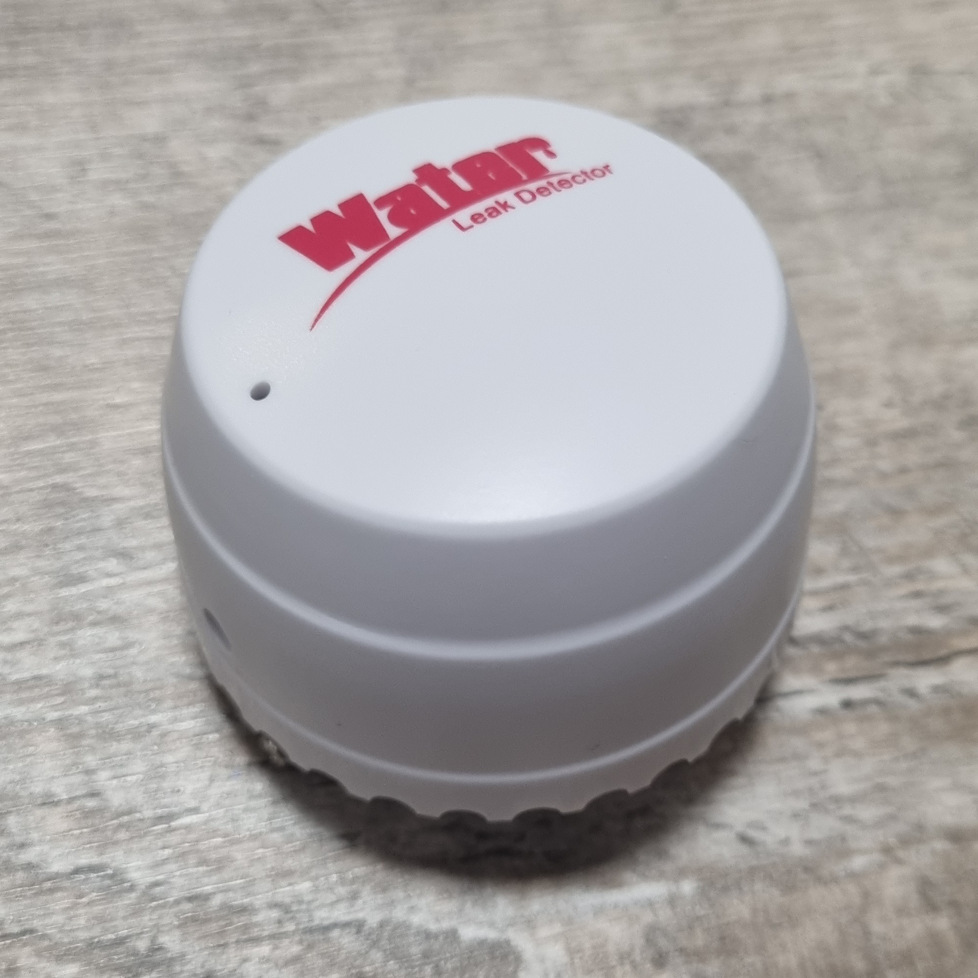

  • Teardown and OpenBeken setup for the DYGSM DY-SQ400B water leak sensor with T1-U-HL module based on BK7238.
  • Reverse engineering found the pin configuration and required a custom autoexec.bat for deep sleep, faster wakeup on MQTT failure, buzzer control, AP mode, and battery-state publishing workaround.
  • The sensor cost $1 and uses a T1-U-HL Module (BK7238), unlike the similar CB3S-based teardown.
  • MQTT integration with Home Assistant plus a heartbeat template tracks connectivity and clearly shows disconnect events.
  • Planned automations include shutting off the main water pipe and alerting when heartbeat loss or leakage occurs.
This is my first teardown article so please for understanding.

I bought water leakage sensor DYGSM DY-SQ400B from Aliexpress for 1$. I wanted to connect it directly to my HA instance (bypass Internet connection requirement, which could be a bottleneck during critical situation). I flashed it with great OpenBeken (great thanks for authors :D)
There is a teardown of very similar device, but with different chip (CB3S)
My device has T1-U-HL Module (BK7238) and I didn't found ready configuration on this forum neither on this website
Teardown
So I performed reverse engineering. Below is my teardown.

Pins configuration:
I created startup script autoexec.bat:
Responsibilities of my autoexec.bat:
- DeepSleep configuration for battery saving,
- configuration of faster wakeup when MQTT connection failed and water leakage is detected,
- turns on buzzer when leakage is detected (label: enableSyrena),
- turns on AP mode on reset button hold event and keeps AP mode for 60 seconds (label: apLabel),
- workaround for problem with publishing battery state when MQTT connection is established with delay (after battery measure) (label: publishBatteryState).
