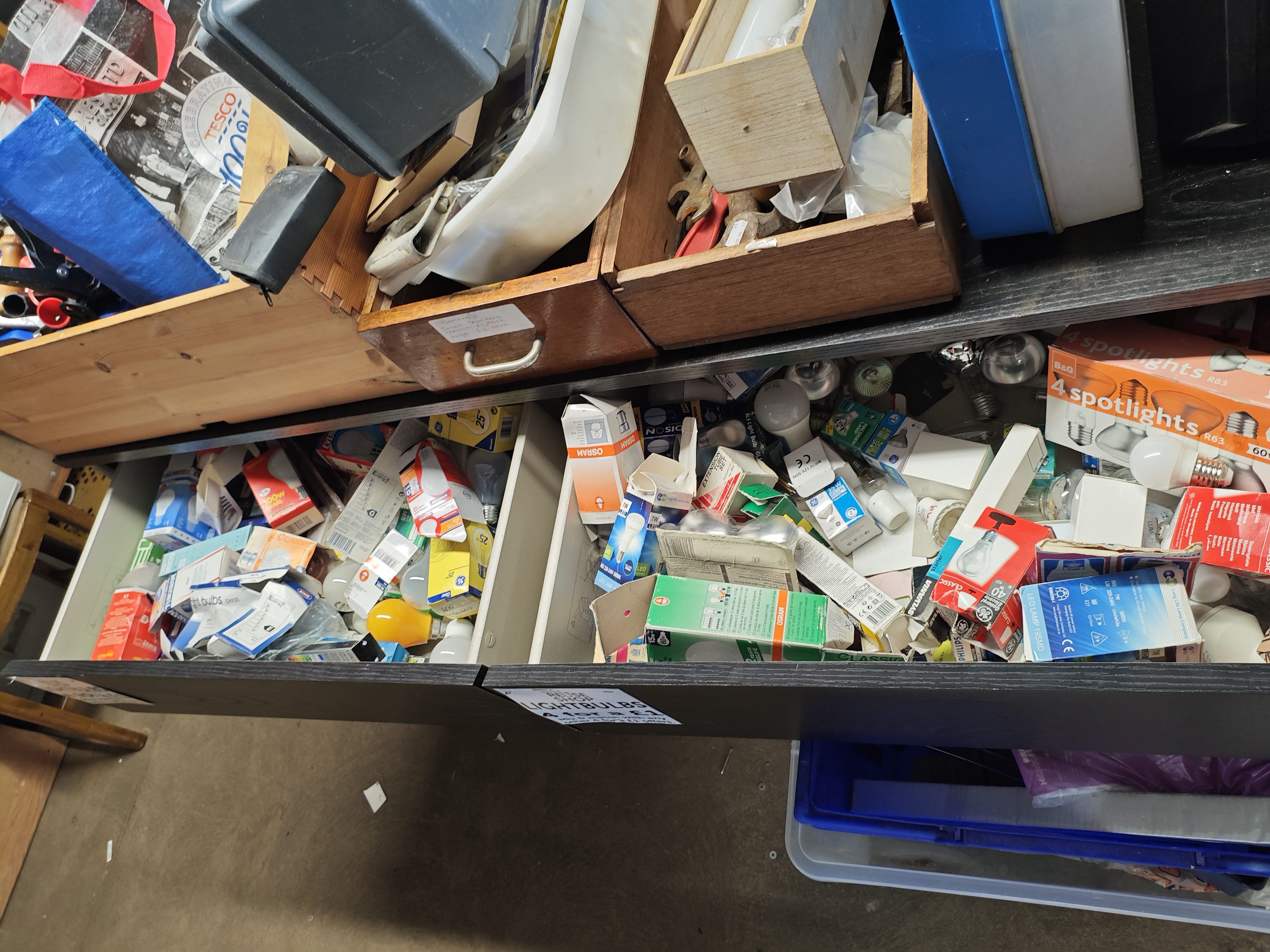

In the city where I live we have "Re-Use" shops alongside standard recycling centres (aka tips, dumps, household waste disposal facilities). These re-use centres are packed with donations and finds that would otherwise have gone into the general waste or recycled. Of course there's some stuff for sale that should probably have been binned, but a lot is fairly decent.
This Re-Use centre in particular has 6 drawers of light bulbs.
and at £1 for 4 bulbs, £0.25p each, there's potential to find some interesting smart bulbs in amongst the boring fluorescent or incandescent mix for a bargain price
I found my 4. There didn't appear to be any more worth having.
