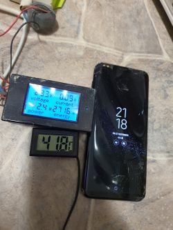

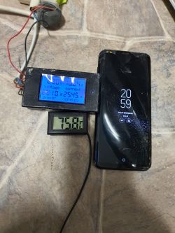

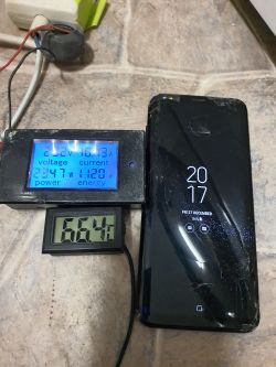

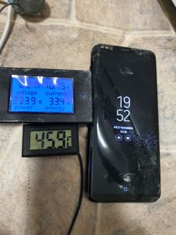

    zab28
    Posts: 17
    Rate: 15

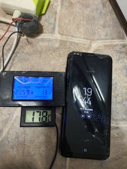

    And the dryer arrived after a month :)
    It looks better than the pictures. The buttons are slightly raised, but here it is a tactile surprise :) the first quick test was carried out on 4 damp T-shirts. course mix program with 15 minutes for measurements only
    and kicked the video, I forgot to hold the phone horizontally
    https://drive.google.com/file/d/10oI7OVJJBMVKhFBGMa77HJ-a8dM7uRlH/view?usp=sharing

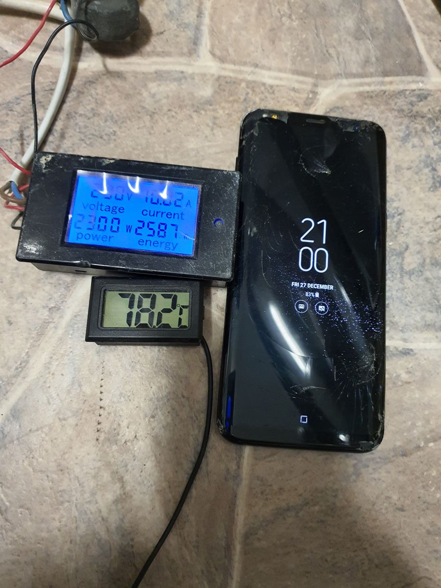

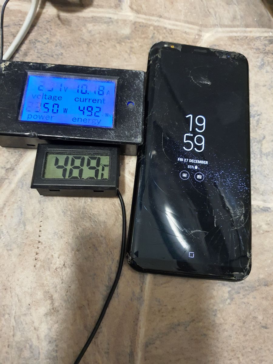

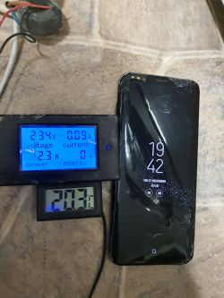

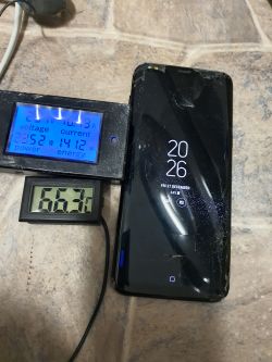

    the washing temperature reached 55 degrees

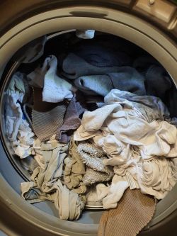

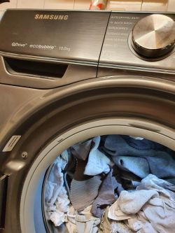

    the first real cotton test for sure with 8 kilos. Almost the entire 10kg washing machine after spinning
    Bosch Condenser Tumble Dryer: Comparing WTW85460PL Heat Pump Model and Conventional Options Bosch Condenser Tumble Dryer: Comparing WTW85460PL Heat Pump Model and Conventional Options
    we take off
    Bosch Condenser Tumble Dryer: Comparing WTW85460PL Heat Pump Model and Conventional Options Bosch Condenser Tumble Dryer: Comparing WTW85460PL Heat Pump Model and Conventional Options Bosch Condenser Tumble Dryer: Comparing WTW85460PL Heat Pump Model and Conventional Options Bosch Condenser Tumble Dryer: Comparing WTW85460PL Heat Pump Model and Conventional Options
    so far the heater consumed less than 2KW

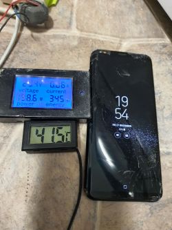

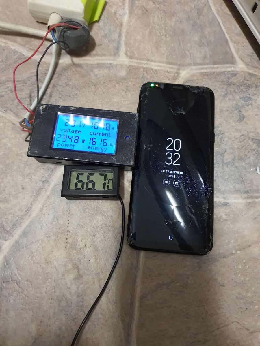

    from 19:55 she jumped to 2.35KW and kept the temp 56 degrees

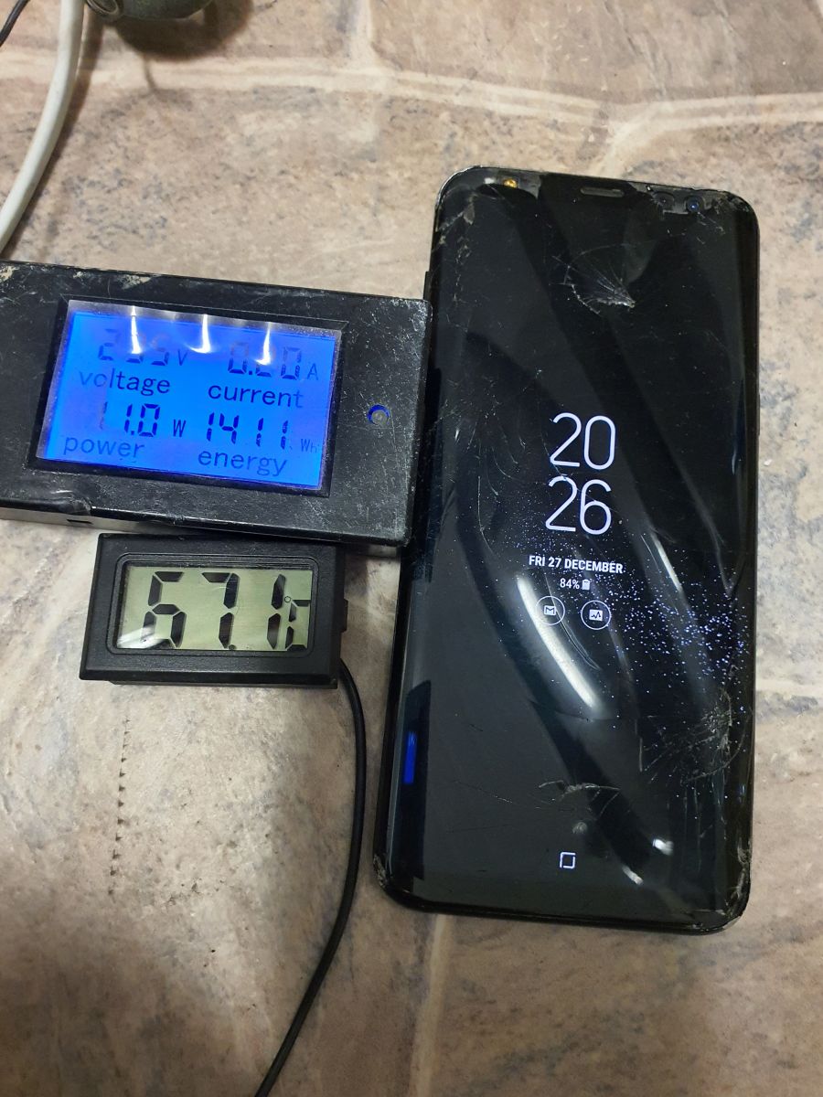

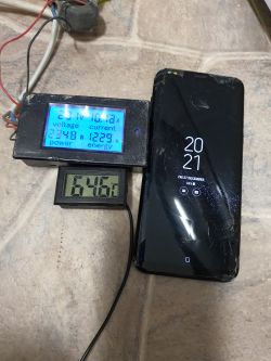

    20.17 went to 65 degrees
    tutal you can see how it cuts off the heaters above 65 degrees

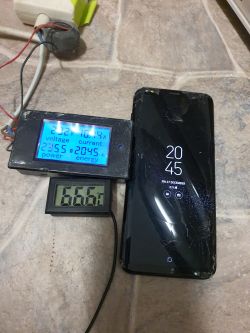

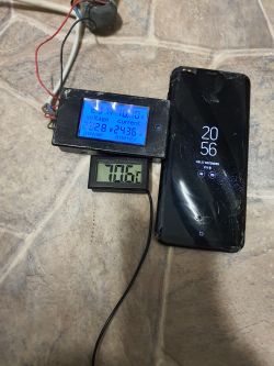

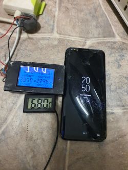

    and from 20:50 it starts to raise to 70 degrees and then cools down quickly and so on several times

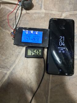

    21:04 end and cooling down the laundry
    185 W was already downloading to the very end
    the end
    laundry smelling well dried and the wife smiling
