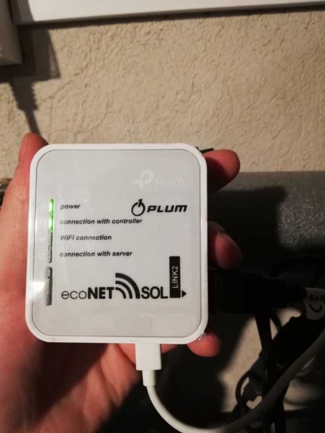

    For my part, I am uploading a flash memory dump from Econet PLUM, or more precisely, a router like the one in the photo.
    Person holding a PLUM ecoNET SOL router with visible LED indicators.
    Maybe it will be useful to someone, and maybe someone will verify that it is well put together.

    For all looking for a solution for ECONET SOL:
    - Follow the steps for ECONET300 (OpenWRT recovery and ECONET300 firmware)
    - Extract the file shared by @seba18 with 7zip
    - Use WinSCP (SCP protocol) to replace "/www/econet/" with the one extracted.
    - If you are going to have it connected to the internet PLEASE change root password
    - SSH and use command: passwd root
    - Reboot

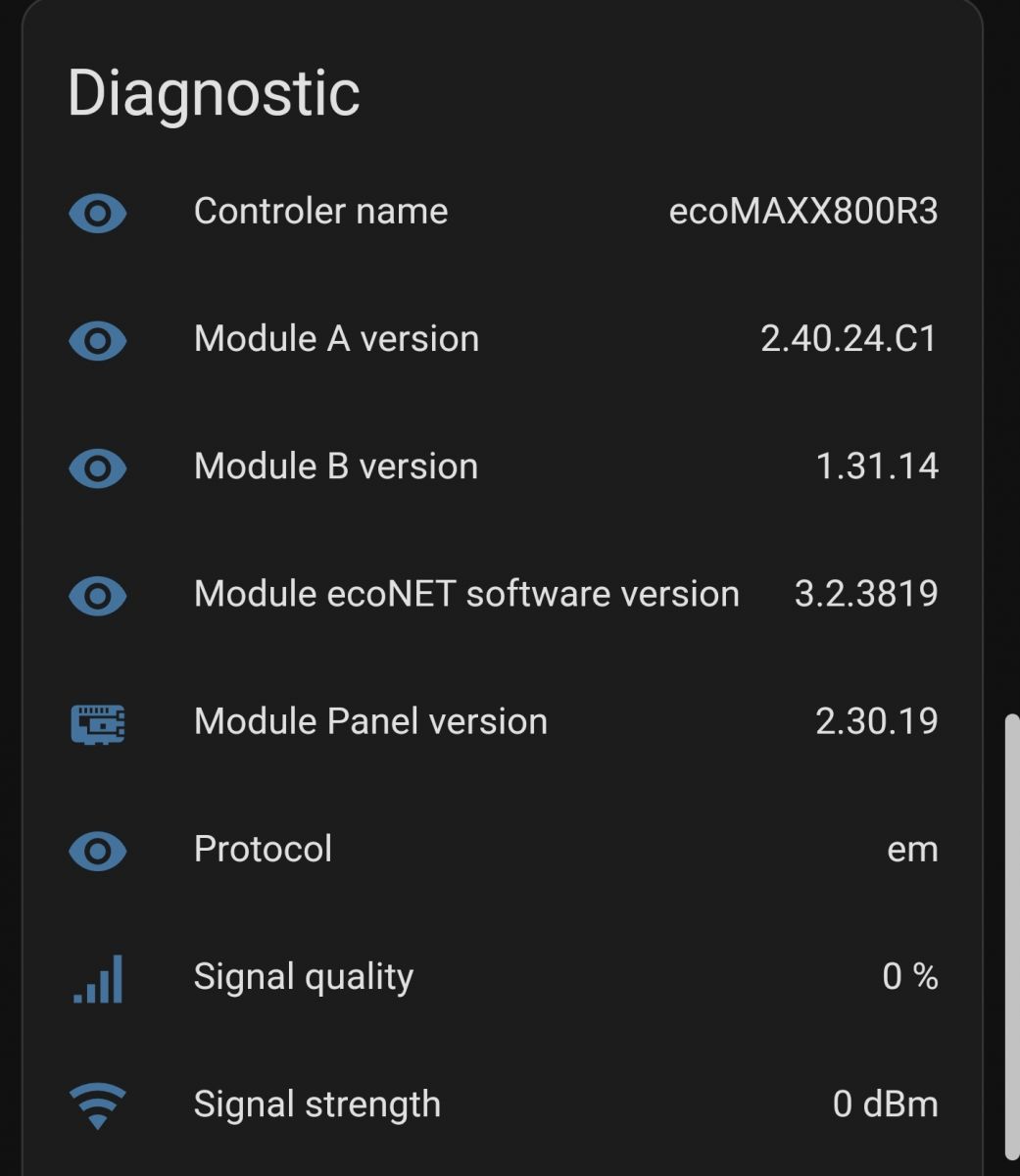

    MaciekPrzybylski

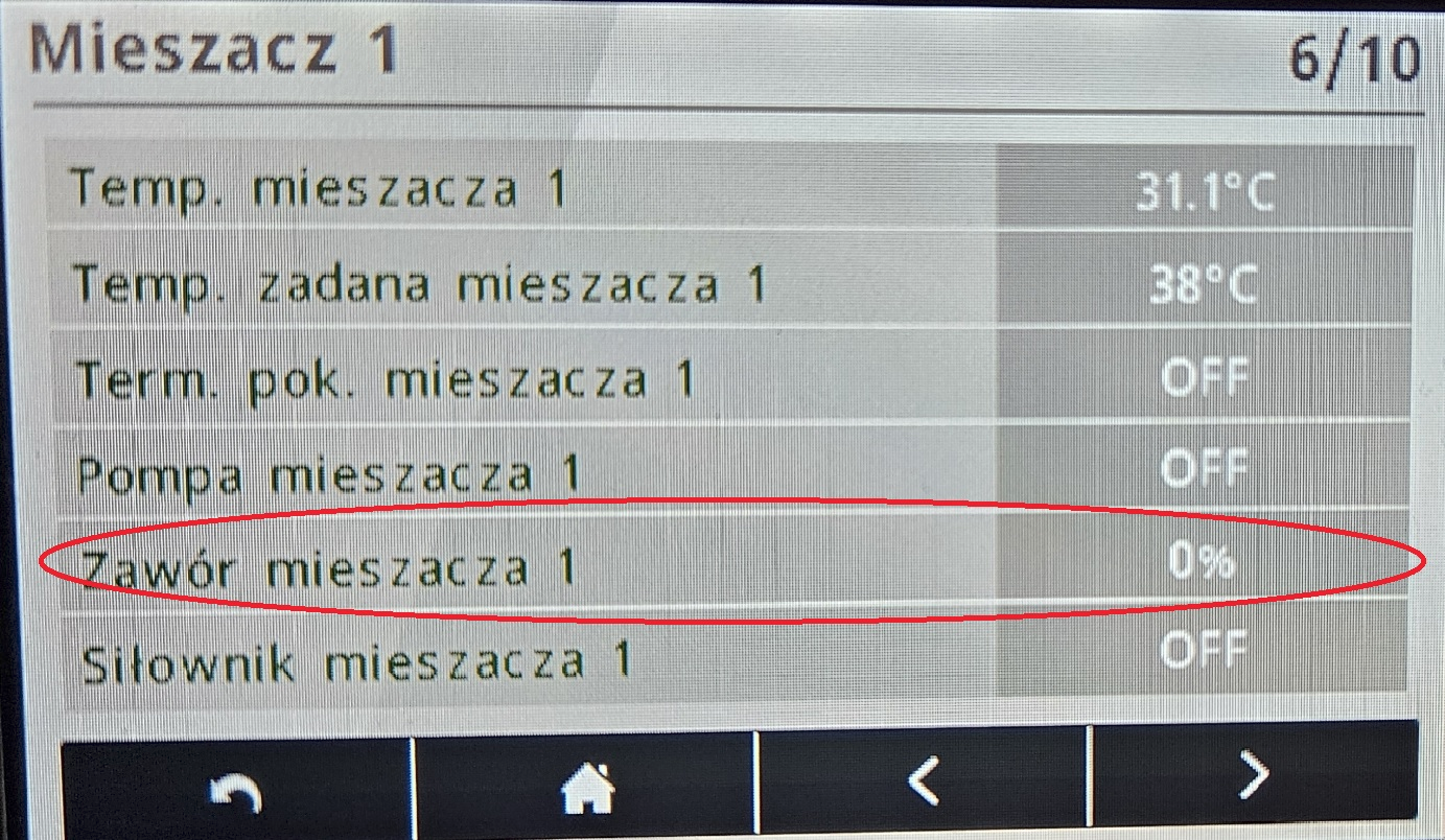

    The controller is ecoMAXX800R3 Screenshot of ecoMAXX800R3 controller diagnostics displaying software versions and signal quality information.
