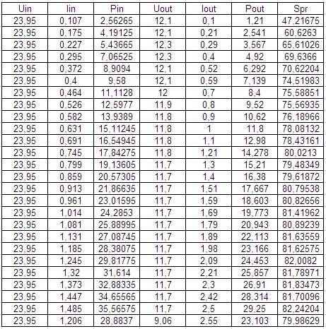

    The converter was tested with an artificial load for the input voltages: 12, 15 and 24V and for the output voltages of 12 and 5V.
    In the conducted tests, voltages and currents on the input and output side of the converter were measured, power and efficiency were calculated.
    Below I present the measurement results.

    Input voltage 24V, output voltage 12V:
    Description of the step down converter based on the LM2596S with voltage measure

    As you can see from the diagram - the efficiency of the converter is not a constant value and it can be seen here that the highest efficiency of the converter is at 15V input voltage and 12V output voltage, and the lowest at 24V input voltage and 5V output voltage.
    It can also be seen that the efficiency also varies with the load on the inverter.
    As you can see - the efficiency of this converter does not exceed 85%, where many sellers give even greater value in their descriptions.
    It can also be seen from the measurements that it is not always possible to load the 3A converter and it will keep the voltage at the output.
    I also tested the converter temperature for the configuration where the efficiency was worst - 24V / 5. With a consumption of 2.5A in this configuration, the converter temperature after 30 minutes was about 55 ° C.
