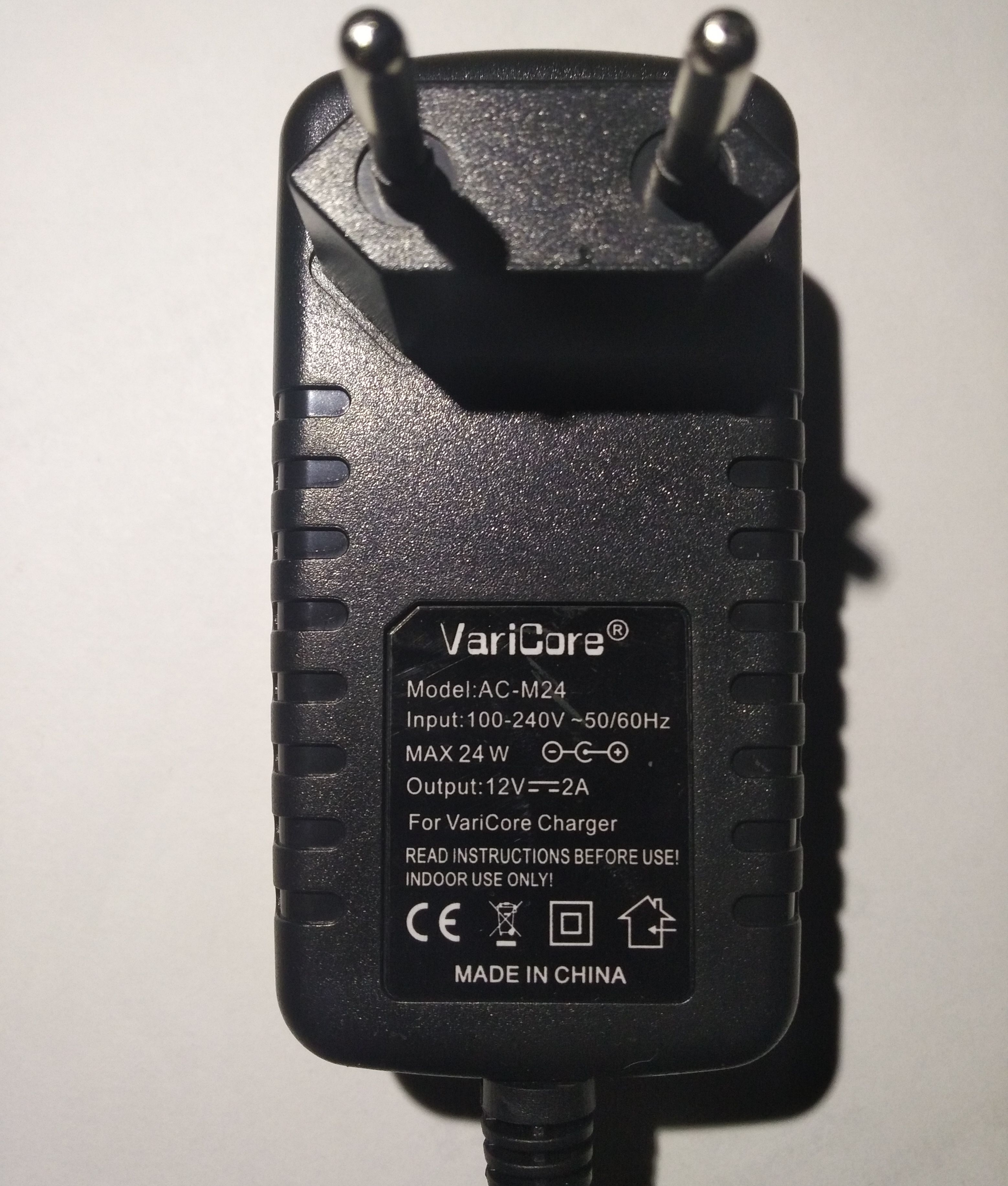

    It is noteworthy that the set includes a 12V, 2A power supply in a very solid plug housing.

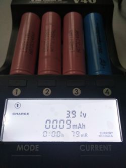

    The charger is really universal and foolproof.
    I will risk saying that it will charge up everything that fits. :)
    As described in the auction, the charger has protection against reverse battery connection, short circuit protection (whatever that means) and protection against overcharging the battery (whatever that means). In the manual (interestingly - it is in the form of a hard booklet in two languages, of course Chinese and English), there is not a word about security features, so I will not check their effectiveness.
    VariCore V40 - universal charger unlike any other - China - review
    In the picture above, you can see some random links that I just had on hand when the photo was taken. And yes, the first from the left is 18650 of an unknown brand, once taken from a laptop battery and now from the flashlight that I carry on my belt. The second is an AA, Ni-MH link taken out of the mouse from the second computer, the brand of the link is also unknown. The third link is also Ni-MH, but this time AAA, which I got together with MaxCom walkie-talkies, and the last one is 14500 from friends from Aliexpress. Unfortunately, I did not have Ni-Cd, but the charger should also work without any problems.
    As you can see in the pictures below - the charger "sees" a different link on each channel.
    VariCore V40 - universal charger unlike any other - China - review VariCore V40 - universal charger unlike any other - China - review

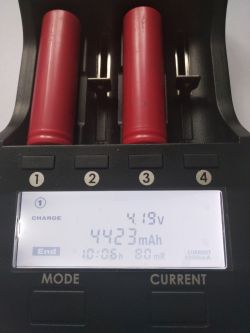

    A few more photos from the tests of 18650 cells:
    It is neither my first nor the only charger, but I feel that it will be my favorite charger, mainly due to the measurement of the internal resistance of the cells, which allows for the rejection of "low" cells almost immediately.
    It's hard to speak after one day of testing. The charger managed to do two full "charge, discharge, charge" cycles for two 18650 battery packs, which is eight in total. It worked well, and the measurement results were very similar to those I performed recently on another device.
    For such money, only take, charge and enjoy the purchase.

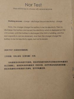

    The same colleague accused me of incorrect information about the Nor Test mode.
    Therefore, I am quoting a quote from the manual.
    "Firstly, the charger charge the battery to be full electricity. Then to discharge the battery and record the elecrticity which is dispolayed on the LCD screen, until the battery is discharged (the end is twinkling, ant the real capacity is can be obtained) And then the charger the battery to be full electriciti again, but no to record. "
    Let me translate this passage into ours.
    First, the charger charges the cells to full capacity. Then it discharges the cells, measuring their capacity at the same time and, after the test is completed, saves it on the display. The charger then recharges the cells to full capacity, but saves nothing.

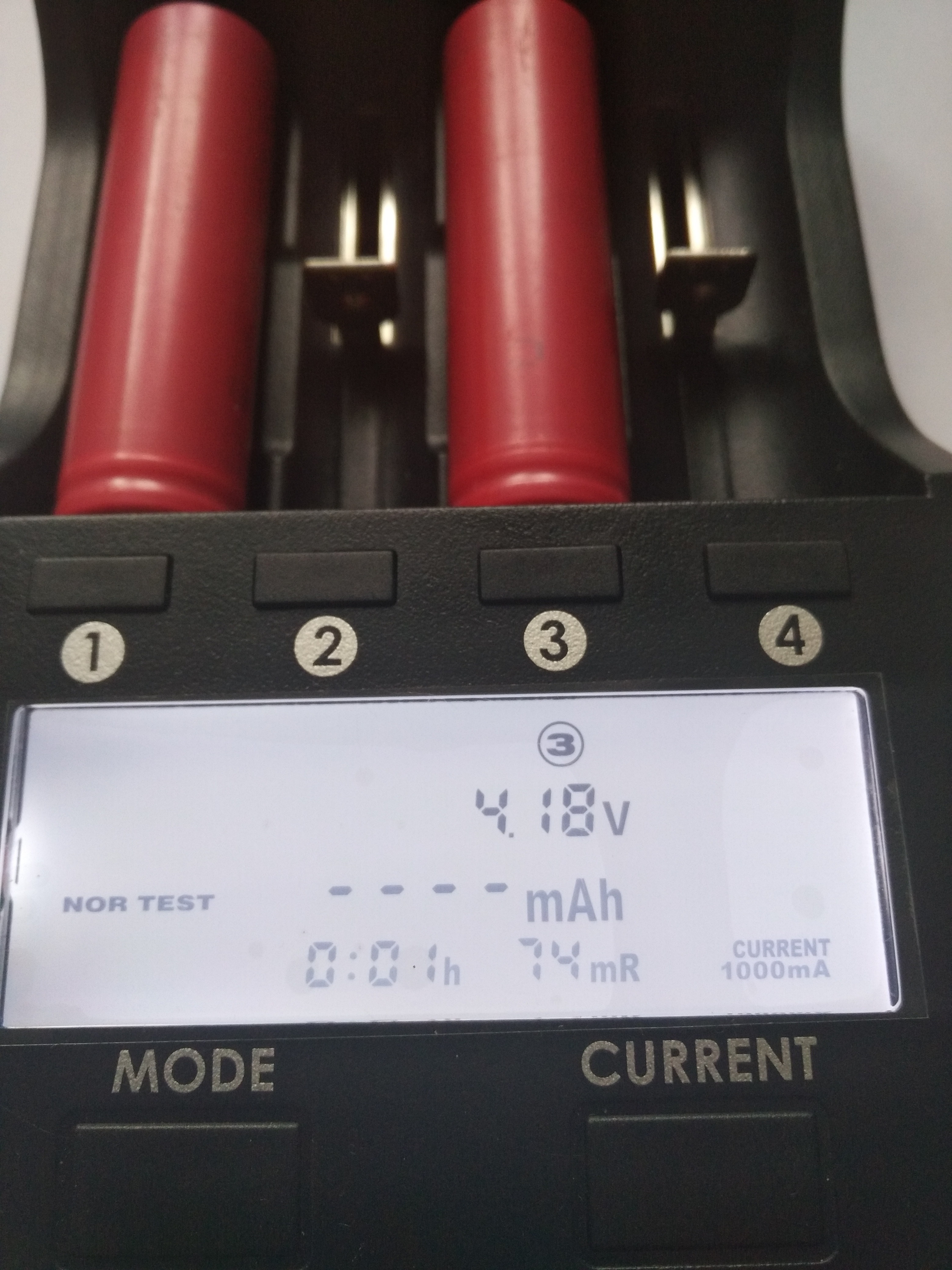

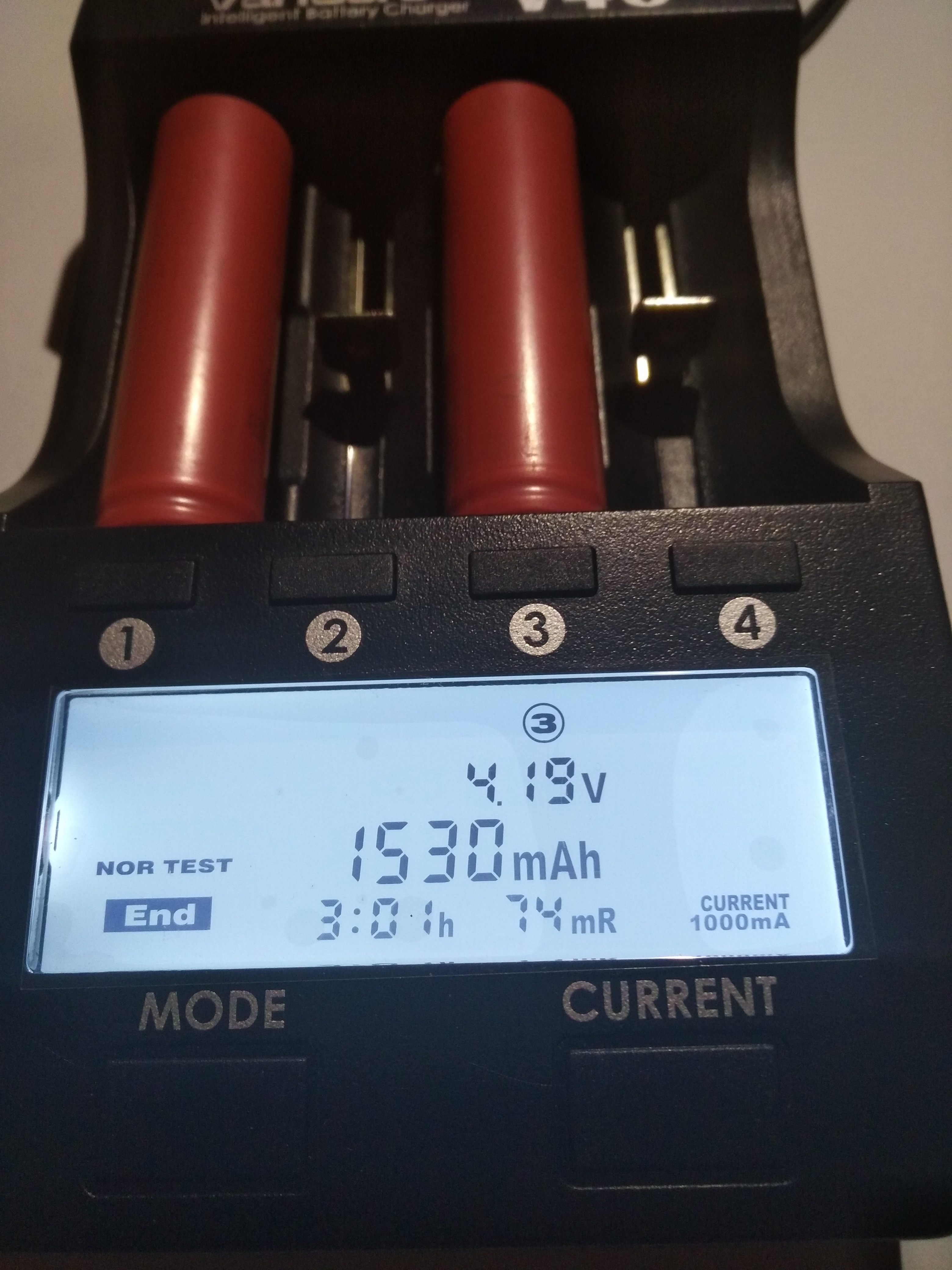

    NOR Test, here we go.

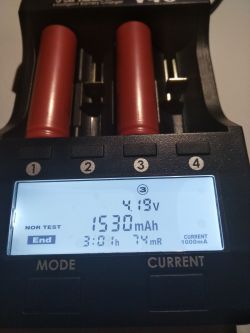

    Test complete. Oh, and where are the rest of my Ampere hours? Could they turn into the heat generated by the cells during charging? The difference between fast test and normal test is due to my mistake. Fast was made at 500mA and normal at 1000mA.
    Hope this will clear up your doubts. At least in terms of how to measure.

    siewcu wrote:
    And where do you get this information?
    And from the instructions:
    Firstly, the charger charge the battery to be full electricity. Then to discharge the battery and record the elecrticity which is dispolayed on the LCD screen, until the battery is discharged (the end is twinkling, ant the real capacity is can be obtained). And then the charger the battery to be full electriciti again, but no to record.

    Gentlemen, don't argue. The topic is about the VariCore charger and that's it.
    Colleague the sower , confirms that they are two different systems.
    His charger measures capacity while charging, and mine measures capacity when discharging. If it's not an obvious difference, then I don't know what could be a more blunt confirmation of the difference.

    CMS wrote:
    The sower's colleague confirms that these are two different systems.
    But how about charging?
    In the case of the NOR TEST function, the Liitokala measures the capacity at discharge This is clearly stated in this test:
    http://lygte-info.dk/review/Review%20Charger%20LiitoKala%20Lii-500%20UK.html
    Nor test (Charge, discharge & charge)
    I am not going to include many curves here, because it is a combination of the above.
    When doing a normal test the discharge capacity is measured. Remember the discharge current is not the selected current, but either 250mA or 500mA.
    So far, there is no indication that these are not clones ...

    Only that in the photos you can see how much was charged to the battery. For my part, EOT, because so far you have not posted anything that would confirm what you write.
    PS. When I was looking for a charger with capacity measurement, I spent a lot of time on it, nobody wrote anything about the V40 anywhere.
    PS2. Look for some V40 review written by a Pole, good luck.
    It is true. The charger counts capacity ALSO during normal charging. However, this does not change the FACT that capacitance is measured during discharge during the test.
    One is on the elektroda.pl portal :)
