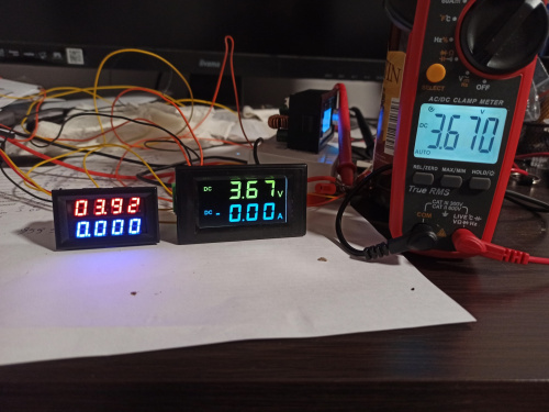

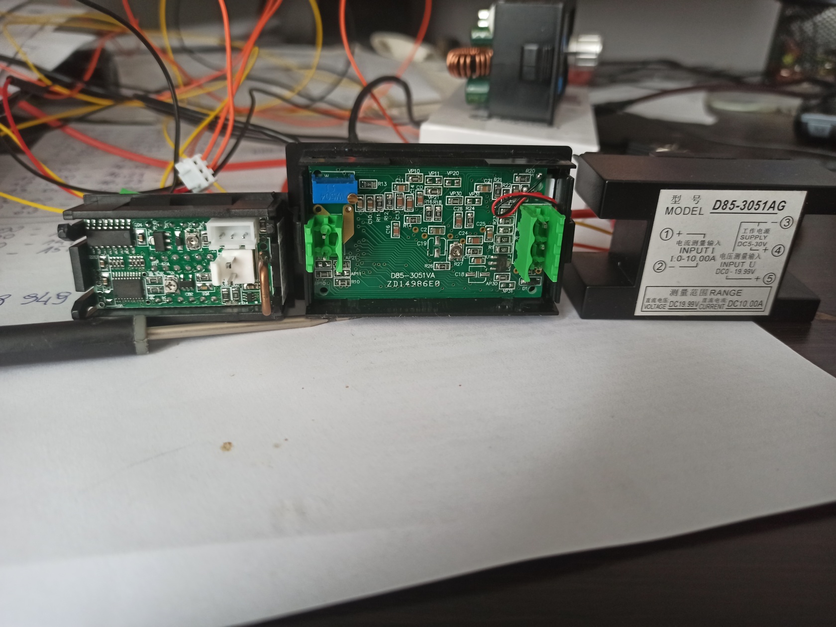

    An alternative to the measure / indicator described above can be the D85-3051AG model. It is bigger (and more expensive), but in my opinion it is more readable. Of course, it also has the ability to calibrate, but "out of the box" it shows what a universal meter, although it is no ;)
    The price is about PLN 30 on the Chinese portal. This is how it looks in the pictures:

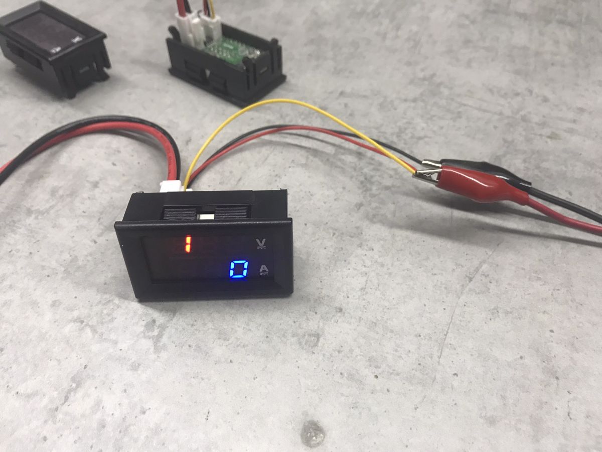

    Hello, I bought 2 meters like in 1 post and both show 125A at once. It turned out that the Chinese did not solder the shunts, the question is what shunt should be soldered there?
  • #73 19935083
    gimak
    Posts: 6230
    Help: 614
    Rate: 1678
    Maybe not so much the Chinese forgot, as you forgot to enter the current range. In this case, the shunt will probably not be soldered, but connected with screws. Shunt suitable for the measured current range with a 75mV output (connected to the module).

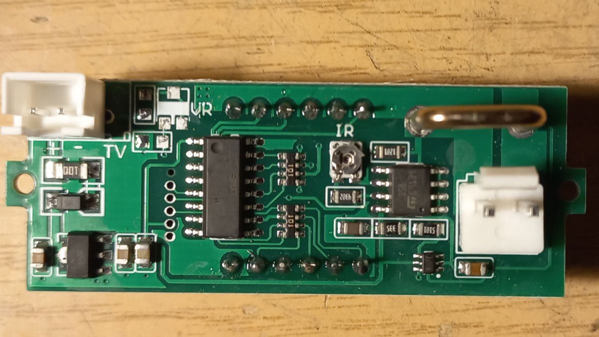

    Thanks for the answers, that's my measure Digital panel meter - Voltmeter / Ammeter - made in China. I trimmed the shunt with it and soldered it on Monday, I will see how the measurements will come out Digital panel meter - Voltmeter / Ammeter - made in China.
  • Calibration pot too small for current underread

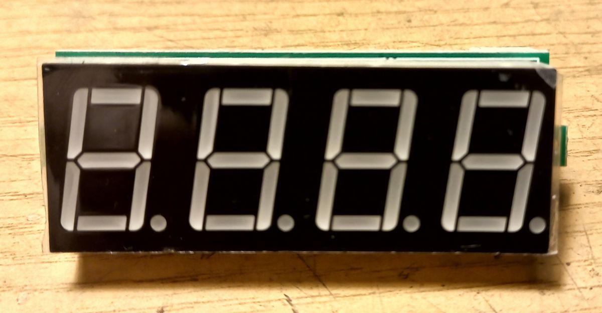

    #80 20408347
    kristof_61
    Posts: 88
    Rate: 15
    I have an ammeter.
    Digital panel meter - Voltmeter / Ammeter - made in China. Digital panel meter - Voltmeter / Ammeter - made in China.
    On the 16-pin system, it says FMD B1dKBMH, I haven't drawn the schematic yet and the problem is that it slightly underestimates the measurement result. With a PR of 5K at max, it still shows too little. For now, I have only made one measurement and with a load of 160mA it shows 130mA. Can the PR be exchanged for another value?
  • False 52 A reading with current wires disconnected

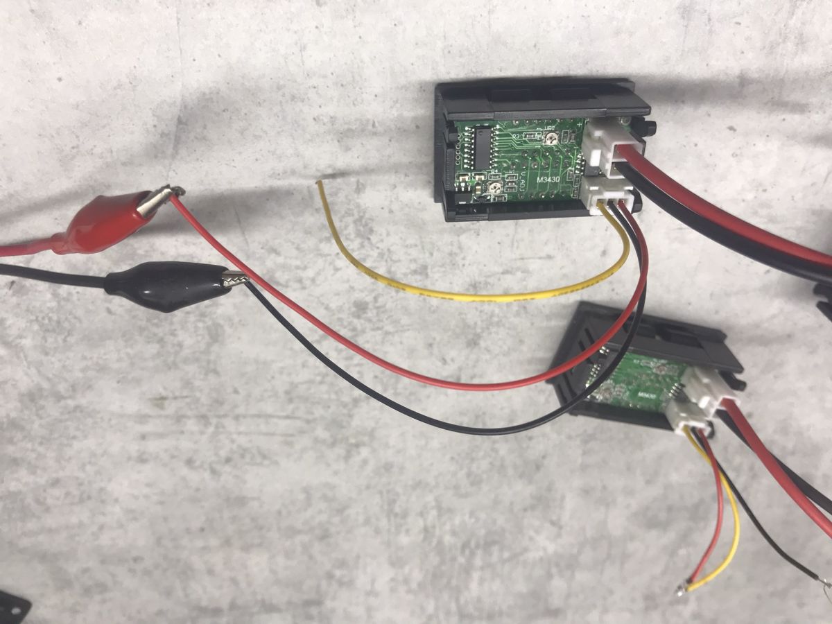

    #81 21358659
    Daro1003
    Posts: 2717
    Help: 295
    Rate: 609

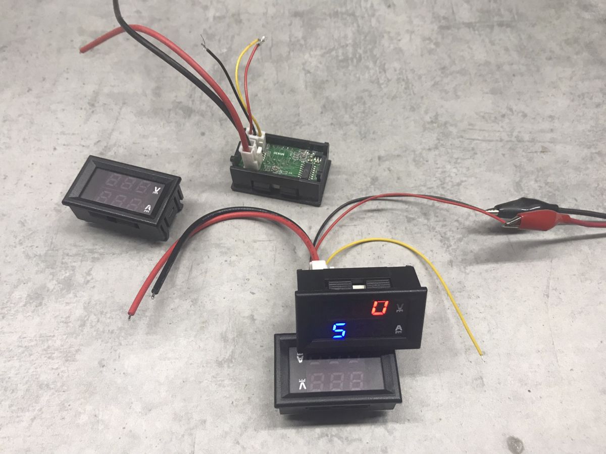

    Hello archived topic but I have a problem with these meters.
    I have bought several of these meters and in each the same problem namely when only the power supply is connected the module shows 52A as in the picture.
    Digital voltage and current meter with display showing incorrect reading of 52A with thick wires disconnected. View of meter modules with connected power wires, showing incorrect current reading of 52A. Three electronic meters with colorful wires on a concrete surface. .
    Apart from the phone didn't catch the digits but the display shows voltage 00.0 by current 52A thick black and red wires not connected for now if I connect the yellow one it shows supply voltage but still current 52A
  • #82 21359777
    Wawrzyniec
    Posts: 4008
    Help: 392
    Rate: 1075
    Daro1003 wrote:
    Apart from the phone did not catch the digits
    Not only that. It didn't catch the shunt either. It's probably not there, but show what board there is without covering it up with plugs. If there is no shunt then plug it in and it will show the current correctly.
  • #83 21359798
    Daro1003
    Posts: 2717
    Help: 295
    Rate: 609
    Yes exactly, unfortunately there is no shunt in each piece and nothing in the packaging either. I bought the voltmeter about a year ago and it was waiting to be used and now it's gone and I have no idea why it was sent and now it's useless unless you can buy such shunts somewhere in the form of a wire for driving.

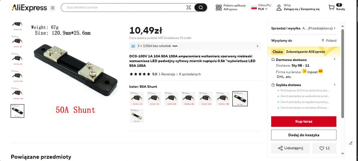

    You can buy shunts, you just need to specify the current and the voltage drop across it - e.g. a 50A 75mV shunt.

  • Likely 50a shunt, not 10a meter
    #86 21367255
    modziul
    Posts: 1758
    Help: 245
    Rate: 455
    >>21367162 Actually they don't look like 10A. You should somewhere in the packaging or order history have information about what it is. Shunts for these meters can be purchased e.g. here https://pl.aliexpress.com/item/10050060539410...pcDetailBottomMoreOtherSeller%7Cquery_from%3A
    There is a diagram of the connection. From the description it appears to be 50A.

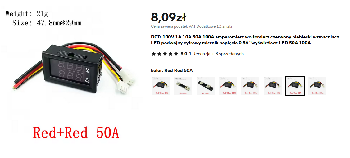

    And this is no longer a profitable topic for 10zł you can buy 1 piece of working on allegro. I thought I could buy the wire missing from mine somewhere.
  • #88 21367368
    modziul
    Posts: 1758
    Help: 245
    Rate: 455
    >>21367310 Item 7 is this wire. I don't see a shunt like this on Allegro under a dozen pounds with delivery and from China. I just got a refund from Allegro because the Chinese sellers there put in whatever they can find and can't deliver.
  • #89 21367419
    Daro1003
    Posts: 2717
    Help: 295
    Rate: 609

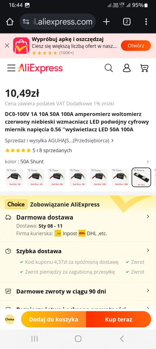

    Item 7 is a gauge I think with this soldered wire. The whole 8 zł. On allegro at 10-11zl only here again shipping or on samrta and we have multi-piece.
    Digital meter with LED display and wires, priced at 8.09 zł. .
  • #90 21367535
    modziul
    Posts: 1758
    Help: 245
    Rate: 455
    >>21367419 Well, here's a tidbit for the IT industry because with me it's correct on my computer and phone (different access)
    Screenshot of a 50A shunt offer on Aliexpress.
    Screenshot of the AliExpress app showing an offer for an ampere-voltmeter.
