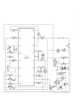

    This radio is based on a chip that has the designation CD9088CD. Sniffing around in the network, you can find information that this system is a copy of the Philips TDA7088T chip. I did not compare the documentation of these circuits, but looking at their outputs, they are the same, so it is possible that it is true. You can also find other chips such as YD9088 or SC1088, so it would seem that each copy has a different name.
    Below is a diagram of this radio.
    HX3208 radio for self-assembly - description and review

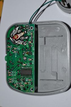

    Let's move on to assembly.
    I don't know why, but they always write online and in tutorials to start with soldering the smallest elements. I always start by soldering integrated circuits.
    HX3208 radio for self-assembly - description and review HX3208 radio for self-assembly - description and review
    All SMD resistors and capacitors in this set are in the 6803 housing, which may be a problem for beginners, but there is a lot of space on the PCB and I think that you could easily solder elements in a larger housing, e.g. 1206.
    After soldering all SMD components, I started soldering through-hole components.
    HX3208 radio for self-assembly - description and review HX3208 radio for self-assembly - description and review HX3208 radio for self-assembly - description and review
    When soldering the L1 coil, I recommend cleaning its ends from insulating varnish to make sure that there will be a good contact after soldering.
    We already have almost everything, now it is enough to solder the power cables to the places marked as "+" and "-" on the PCB, and solder the plates at their ends, which will do it for the battery contacts.

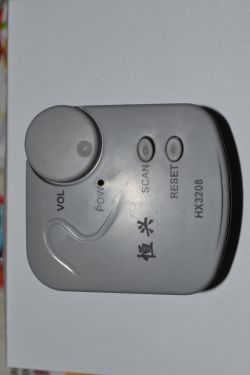

    We put everything into the housing, the plate is screwed with one screw to the top of the housing.
    We put on the back of the housing. We screw the housings with two screws.
    Screw the knob to the potentiometer.
    We put a cap on the knob.
    We put the battery in and we can start the radio. No tuning is required here.
    We start the radio by turning the potentiometer to the right (the potentiometer has a built-in switch), which is announced by the red LED lighting up.
    Turn the volume up by turning it to the right, decrease it by turning it to the left, turning it left to turn off the radio. The switch cuts off the power from the battery, so there is no question of any armed mode, so after turning off the radio does not draw power from the battery. The current drawn with a 3V supply is approx. 29mA. According to the sellers' descriptions, the radio operates in the voltage range from 1.8 to 3.5V. After my tests, I can say that the radio works properly up to a voltage of 2V, but it consumes 13mA at this voltage. I have not noticed,
    so that the voltage level affects the picking quality of the radio station, you will notice that the supply voltage level affects the sound level.
    After turning on its freshly assembled receiver, the radio started from the so-called kick and in the headphones I heard one of the most well received radio stations - Radio Maryja. :)
