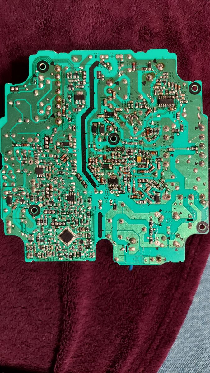

    anmezdysk wrote:
    I have 13V on pin 4 of IC2, but there is no voltage on pin 12 of IC1 - what could be the reason for this?
    After all, you have an answer in the diagram Q5 transistor, I also flew; and in general, start by checking whether you have a short circuit on the 12th pin, it is best to desolder IC1 on the spot; and if you replace q5 and it does not play, you have something damaged from the base side of this transistor ...
  • #62 20256662
    anmezdysk
    Posts: 6
    The voltage is present on the Q5 collector all the time, while the voltage on the Q5 emitter appears only for 10s after it is turned on and it disappears. At this time, the relay and the fan turn on. I think that the problem is in the base-voltage control on the base also disappears after these 10s. The PC4 optocoupler has been checked, it's ok, but what controls it?

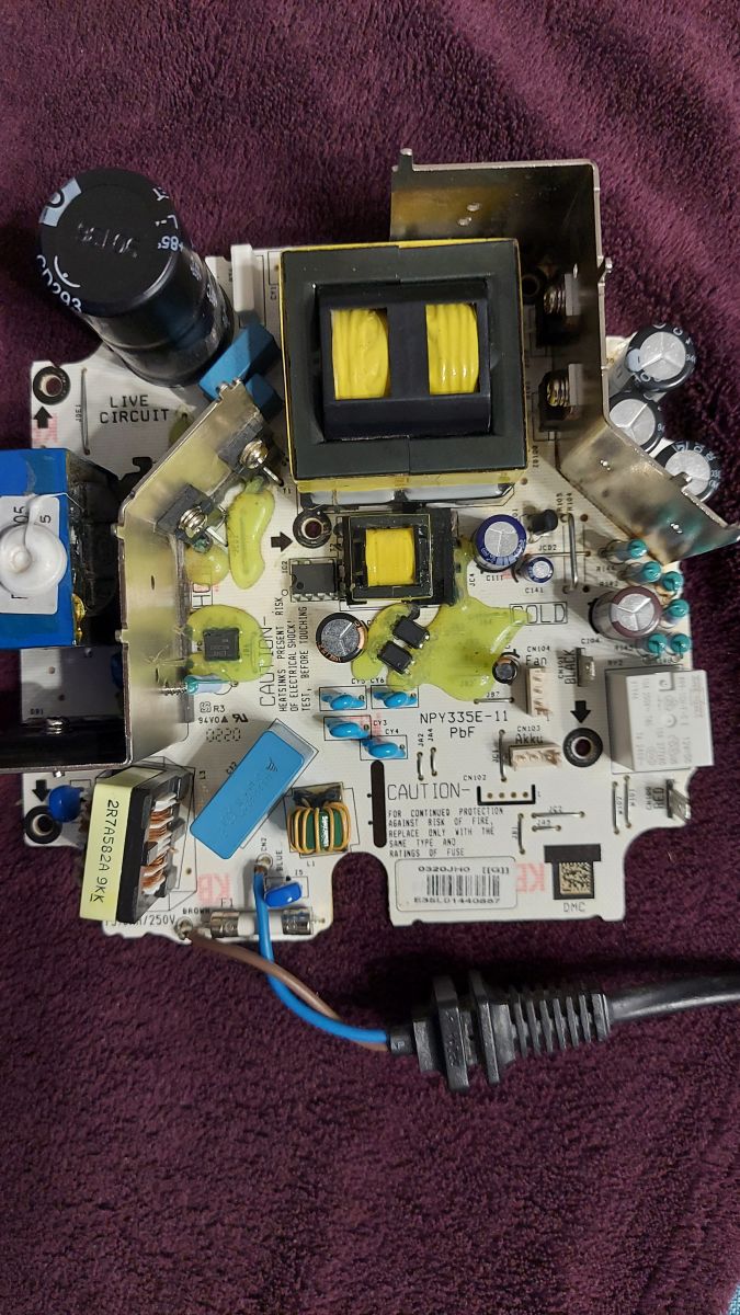

    Hilti C4/36-350 Charger Issue: Green LED Flashing Every 2s, Battery Not Charging Hello everyone.
    I need help with this repair.
    The ice is constantly flashing.
    All diodes, transistors, optocells, capacitors, resistors, IC 1 and IC2 are fine.
    What I found is that at the output of IC 2, after exceeding the voltage of 12 volts, the voltage drops and then it repeats itself. It seems to me as if the circuit is not stabilized.
    Measurement of zeners after soldering.
    ZD 17 20V
    ZD 14 11V
    ZD 15 11V
    ZD 11 15V Hilti C4/36-350 Charger Issue: Green LED Flashing Every 2s, Battery Not Charging

  • #70 20291643
    Matrix8283
    Hi all, firstly special thanks to DRAZEK87 for the schematics, couldn't have figured my issue out without these schematics, so greatly appreciate the work this person put in. I have one of these chargers for less than a year, probably used 5-10 times when it stopped working. I tested a few components and found ZD17 was shorted. I replaced this ZD17 with a new zener 15v and that blew straight away after powering up. I ordered new MIP2M2 IC and L6599AD chips. After they arrived I replaced both chips and found it was still not working. After further tests I found ZD16 blown. I replaced ZD16 with 15v Zener and it repeatedly got destroyed 3 times. After further inspection I realized ZD16 value is actually 5V1, I then replaced both MIP2M2 IC and L6599AD and ZD16 with correct 5V1 and the charger is now working perfectly. I hope this may help someone fix their charger.
  • #71 20297729
    11strelec1
    Posts: 6
    After switching on, the voltage rises to 323V and after a few seconds drops to 307V.
    Measured on MIP2M2 pin 5.
    Is it possible that the system falls due to low supply voltage?

    ..on pin 4 the voltage oscillates from 8.5V to 14.5V. The voltage is not stable. That's why the diode flashes green. Transistor Q5 is fine.

    11strelec1 wrote:
    .. on pin 4 the voltage oscillates from 8.5V to 14.5V. The voltage is not stable. Therefore, the LED flashes green. The Q5 transistor is fine.
    if you remove J13 (the 0R resistor is right next to Q5) there should be a stable 13V; if it doesn't have IC2 it's working incorrectly,,, you need to check it

    teskot wrote:
    I have been struggling with the repair of such a charger for several days and it finally worked yesterday.
    Symptom: steady green light, not charging. After installing the battery, the relay and the fan were turned on for 5 seconds, and then everything returned to the starting point.
    After preliminary measurements, damaged:
    IC1
    Q6
    R28
    J3
    D9
    ZD16
    R31
    R51
    Q3
    Q4
    D16
    D17
    F3
    After replacing these elements and making sure that the power supply of IC1 does not exceed the permissible 17V for it (it has an internal zener diode for this voltage), the main converter started to start but released a voltage at the output significantly exceeding the final charging voltage of the battery. It turned on for a split second with the relay and the fan and everything turned off.
    So I looked at the feedback circuit and the PC3 optocoupler turned out to be damaged. It is soldered under the transformer so the access is best after desoldering the transformer. After replacing, everything started and the charger works properly. Maybe someone will find this description useful.
    Let me just mention that the R28 was "burned" and only after desoldering and measuring with the technical method it showed damage. It was the same with the R31. D16 and D17 diodes can also be measured only after lifting at least one leg from the board.
