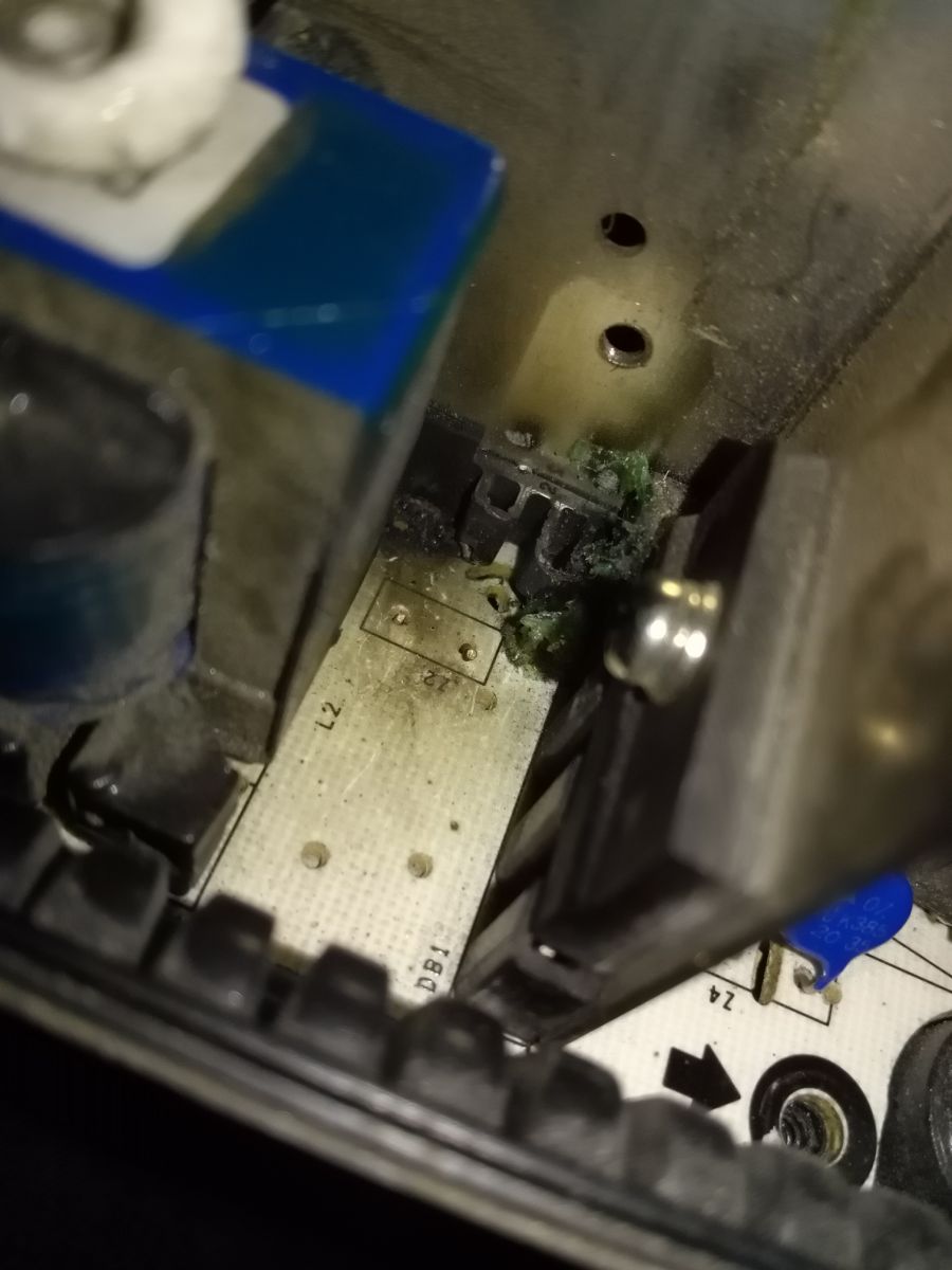

    Hello, does anyone have the value of the Z2 varistor? It got a ricochet when the triac failed and I can't read its value.

    Look in this topic on its several pages: Link (1~7) or there: Link . You should have given a photo along with where this component is!

    >>21228443 >>21228443 Fragment of an electronic circuit with visible capacitor and connectors. .
    It is located next to the rectifier bridge. A search of the topic did not yield fruitful results.

    Forgive me, but in my mind right from the first photo in that topic you can see that probably the Z5 is the same as the Z2 :)
    Close-up of electronic components with pink arrows pointing to specific elements.

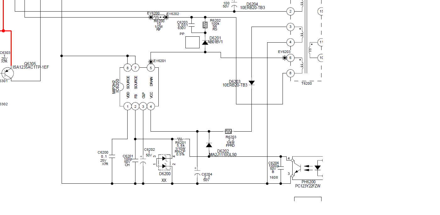

    I think there should be a jumper there at 7,8. I am posting pieces of application from some schematics, admittedly not mip2m2 but mip2H2 and mip2F2 but I think it is the same :
    • Hilti C4/36-350 Charger Issue: Green LED Flashing Every 2s, Battery Not Charging aplikacja mip2h2.png (85.32 KB) You must be logged in to download this attachment.
    • Hilti C4/36-350 Charger Issue: Green LED Flashing Every 2s, Battery Not Charging aplikacja2 mip2h2.png (77.47 KB) You must be logged in to download this attachment.

    I managed to get a working charger a few days ago, there on the diode test on the 7th and 8th pin the result was around 600 (I'm away so have no way to check)

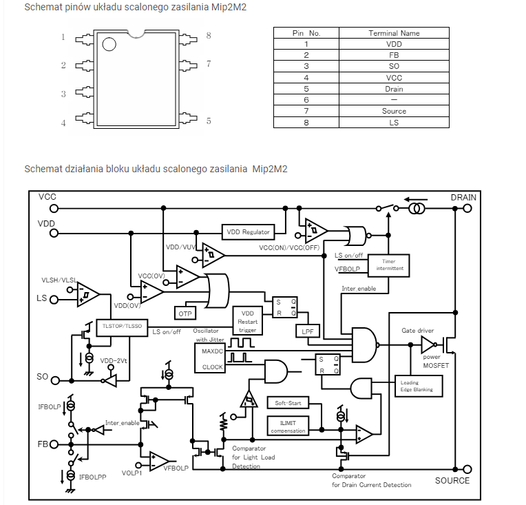

    I found some description for this MIP, there should not be a short circuit between them, so the Chinese sent instead of MIP2M2 some H2 :D Diagrams of the Mip2M2 power integrated circuit. .

    Where did you find this , I have glazed over so much and haven't found the exact MIP2m2 but from what you have attached it seems that this circuit would be like Panasonic's MiP2m20 where pdfs are available .
    • MIP2M20MS-Panasonic.pdf (680.28 KB) You must be logged in to download this attachment.
    • MIP2M20MTSCF-Panasonic.pdf (318.34 KB) You must be logged in to download this attachment.

    It was some Thai or Vietnamese site, I got to probably the 5th page on Google :D

    The MIP2M2 circuit is slightly different from the given circuits: MIP2H2 and MIP2F2 in spite of the same external appearance; it must not be interchanged because pin 7 in the MIP2M2 is the "SOURCE" ground and pin 8 is the "LS" signal and there must not be a short between these pins, as I have already written! In the MIP2H2 and MIP2F2 there can be a short circuit because pins 7 and 8 are ground, but I haven't measured the new circuit because I don't have one and I haven't encountered one yet.
    There was a question about the next components and they are varistors of size 07 probably this is the spacing of the legs and they are for voltages:
    Z2 = K275
    Z5 = K385
    Z4 = K420

    T2 has two secondaries. One is providing the 13V for the high voltage electronics and another one of 8.4V that is powering the low voltage side.
    If you search closely on this forum, there is a handmade schematic that presents PC4 being commanded by pin7 of the micro-controller.
    PC4 will only be activated if the battery is inserted and is ready to charge.
    There are two power supplies.
    One is a standby/logic power supply driven by MIP2M2
    Another is a high power 8A ~25V power supply driven by the IC L6599AD.
    L6599AD VCC is commanded by the PC4, when PC4 is on, L6599AD starts and hopefully the entire high power supply starts.
