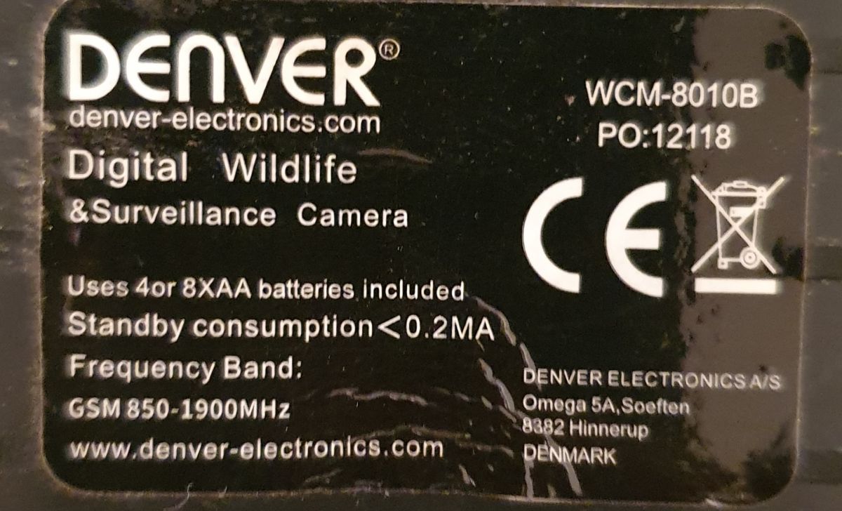

    I have 2 Denver trail cams.
    WCM-8010B
    PO: 12118
    WCM-8010
    PO: 13057
    Can anyone provide the newest firmware please. I have sometimes issues with SMS commands, like *500* to take a picture.
    Thanks in advance,
    Best regards

    meteo0815 wrote:
    I sometimes have problems with SMS commands
    If everything worked OK before, I would rather start by checking the internal 3V battery to see what voltage it has and whether it has corroded from moisture.
