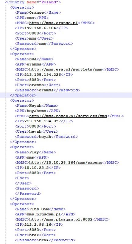

    Database for networks: Automatically completed with automatic selection.
    Spoiler:
    Operator
    Orange
    mms
    http://mms.orange.pl
    192.168.6.104
    8080
    mms
    mms
    Operator
    ERA
    eramms
    http://mms.era.pl/servlets/mms
    213,158,194,226
    8080
    eramms
    eramms
    Operator
    Heyah
    heyahmms
    http://mms.heyah.pl/servlets/mms
    213,158,194,057
    8080
    heyah
    heyah
    Operator
    Play
    mms
    http://10.10.28.164/mms/wapenc
    10.10.25.5
    8080
    Operator
    Plus GSM
    mms.plusgsm.pl
    http://mms.plusgsm.pl:8002
    212.2.96.16
    8080
    no
    no

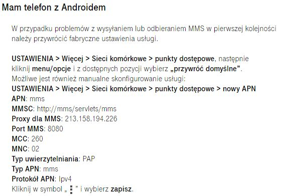

    Denver WCM-8010 Camera Trap: Troubleshooting MMS & Email Issues, Activation Codes & Setup
    MMS data can be edited by editing the MMSDB.DB file or simply by manually entering.
    NP ERA network is no longer T-Mobile
    and if I'm not mistaken it will be:
    Spoiler:
    Operator
    T-Mobile
    mms
    http: // mms / servlets / mms
    213,158,194,226
    8080

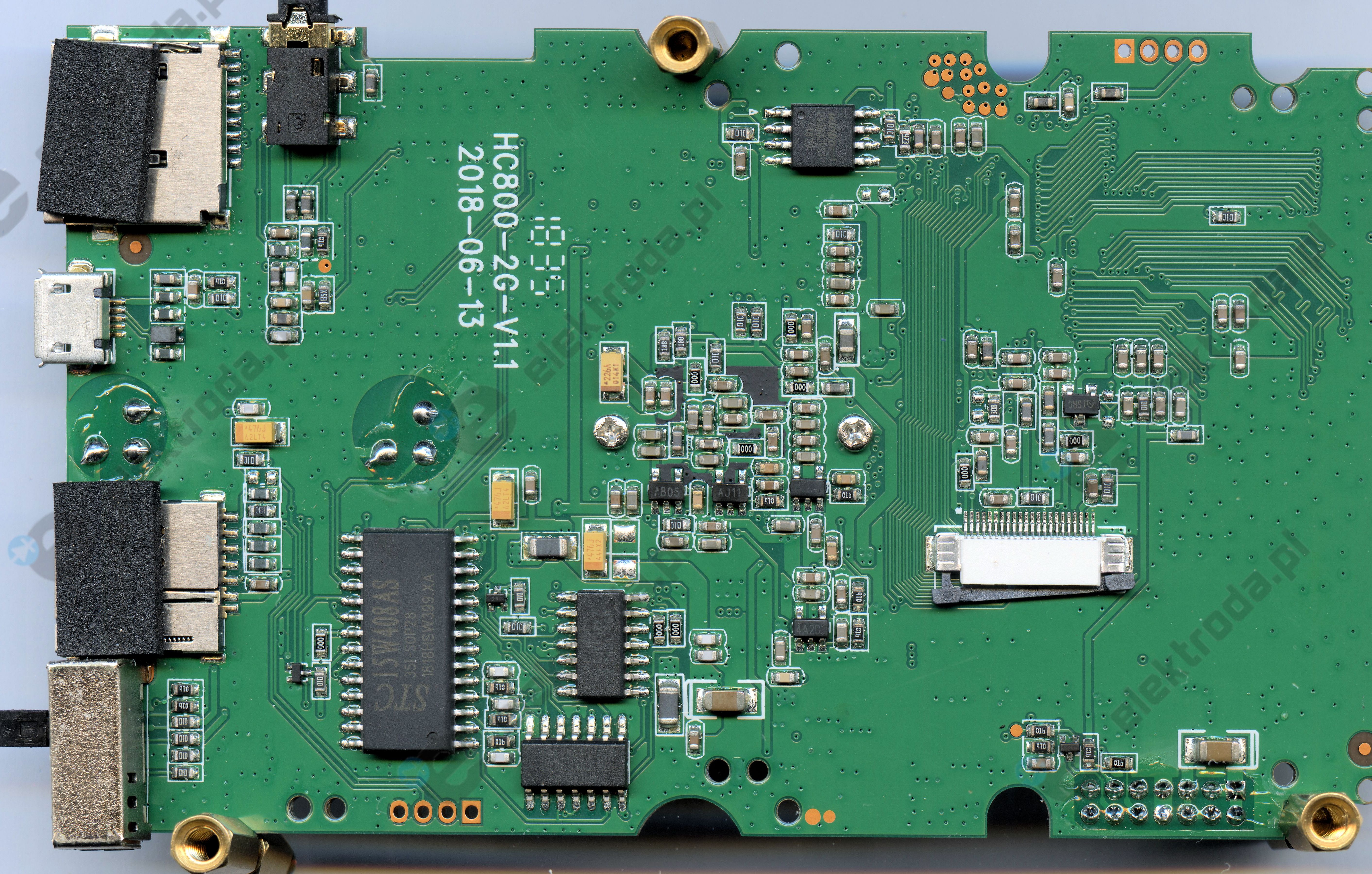

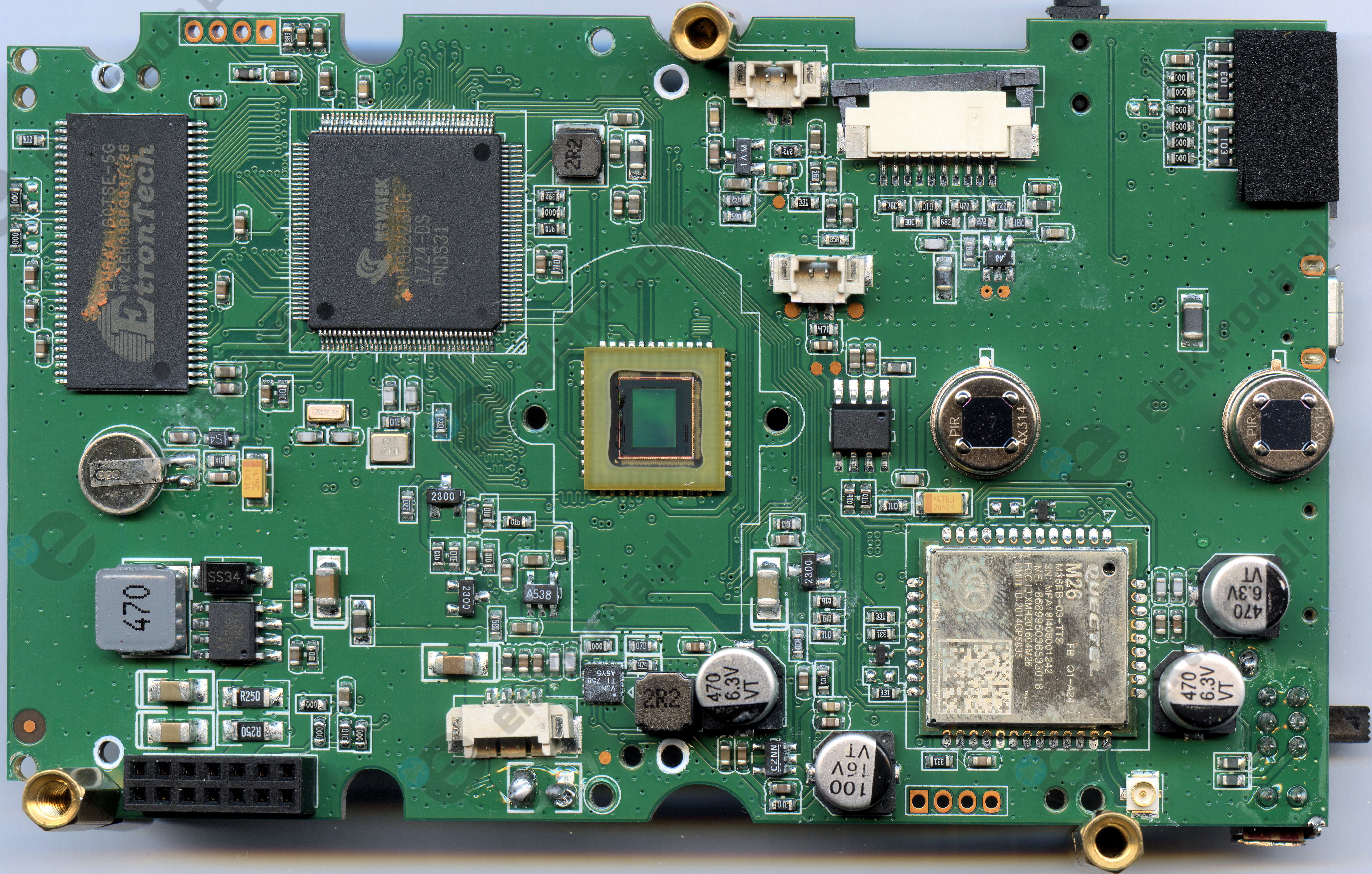

    I recommend the program to format the card SDCard Formatter v5
    By the way, it adds PCB photos and a 25Q64JVSIO memory slot if someone chooses SPI FLASH memory.
    Denver WCM-8010 Camera Trap: Troubleshooting MMS & Email Issues, Activation Codes & Setup Denver WCM-8010 Camera Trap: Troubleshooting MMS & Email Issues, Activation Codes & Setup
    • 25Q64JVSIO.zip (686.48 KB) You must be logged in to download this attachment.

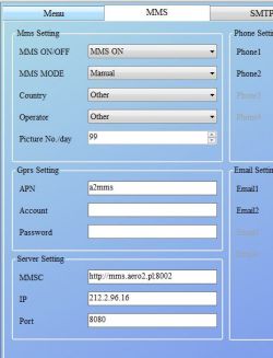

    Thanks for the detailed information. I finally started with A2Mobile and it works just like before with Orange - i.e. no SMS reply but the pictures are sent. Unfortunately, not every time I enter a photocell ... after returning I will test smtp and I can give a screen with A2Mobile configuration. Meanwhile, if anyone managed to get smtp to act, I would be grateful for suggestions.
    There is also my configuration on a2mobile.
    It took me a bit ... I bought a cam because they were robbing me a house on the plot. During the holidays, the plot was set on fire "for fun" by a local jacket - all on camera, in addition to the neighbors and fire brigade ;) All reported to the Police. Now I report to the insurer. Meanwhile, the camera with improved settings (longer films) again hit the plot, where during the action my fence was destroyed and ... every now and then I have a lot of recordings of wild animals !!!! :) roe deer, cats, foxes, bird clusters. When I sit down and do something, I will throw it here. Meanwhile, I noticed that the camera, mainly at night (lower temperature ???) records some strange sounds, someone will explain to me?
    By the way, a movie with these sounds and a mass of glowing "alien" eyes :)
    [url=]https://drive.google.com/open?id=1u8gns8xepwZlBRvwHbnrjcdePW7OYJ_d[/url]
    Overall a great purchase !!!
