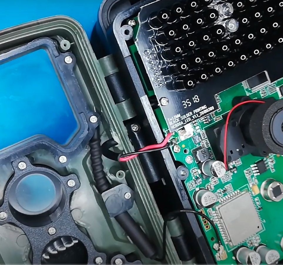

    This FP does not have an external antenna
  • #362 20997218
    gradek83
    Posts: 9107
    Help: 930
    Rate: 2103
    You`re right, the antenna is inside. Check whether it has not become disconnected, and also check the condition of the internal 3V battery.

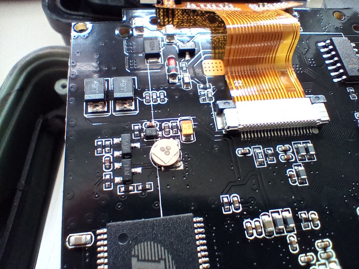

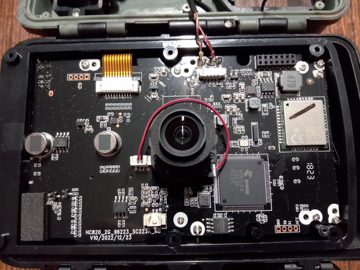

  • #363 20997502
    borys24so
    Posts: 209
    Image of the interior of an electronic device with a visible main board and a disconnected antenna.
    I don`t see such a battery here. The antenna was well connected. In the photo it is unfastened by me
  • #364 20997606
    gradek83
    Posts: 9107
    Help: 930
    Rate: 2103
    The battery is probably on the other side of the PCB.
    You have a different version of the motherboard, the manufacturer usually has several versions under the same product name.

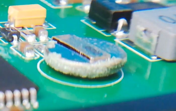

  • Hidden battery measured at 2.66 V and dropping
    #365 20997717
    borys24so
    Posts: 209
    Yesterday I checked from the other side and I didn`t see it either... But it`s there. They hid it under the display. This battery has a voltage of 2.66v. Should it be around 2.8-3V? Could this be the reason?
    After five minutes 2.62v then after some time 2.55v.
    Can you remove it and check what battery model it is?
    Close-up of a circuit board with an attached round battery.
    This battery is about 4 mm in diameter and is probably welded somehow to the plate at the top. Can it be replaced at all?
  • Backup battery may be moisture-damaged and need replacement
    Yes, yes, but it is a bit difficult due to its small size and you must not overheat it during soldering because it will explode (it will tear it apart from the inside)
    If you have a magnifying glass or a good zoom device on your phone, take a closer look at it, especially from the bottom, to see if there are any small deposits on its lining. These batteries are not protected against moisture and even when stored in the manufacturer`s warehouse, they may get wet despite the Supposedly tight seal. All you need is a bit of varnish to block the access of humid air.
    You probably won`t replace it if your FP is under warranty. And if you decide, you have to remember where the plus and minus are and the replacement would have to be with a battery that may not be the same, but one that would fit. E.g. Ms621fe 3V.
    Check this option: put the battery in the basket, leave the FP in test mode for about 10 minutes. Then turn off FP and remove the batteries. i Check the battery voltage and after another 5 minutes and thereafter. Theoretically, the voltage should not drop too quickly. This battery is responsible for maintaining the internal clock and FP settings. Additionally, it is used by the GSM module.
    If you have the motherboard number, you can try to contact the DENVER manufacturer and provide the information from the motherboard and the sticker on the back of the FP, if you have it, plus the current firmware number and ask for newer firmware.
    Theoretically, if this FP is close to the GSM transmitter of the network that the FP is currently using, the range in TEST mode should be Full and information about the network operator should appear next to it.
    Send your configuration file via PM and I`ll check how you set FP there.
    Additionally, if this FP generates some LOG ERROR on the memory card because I don`t remember, please send it too.

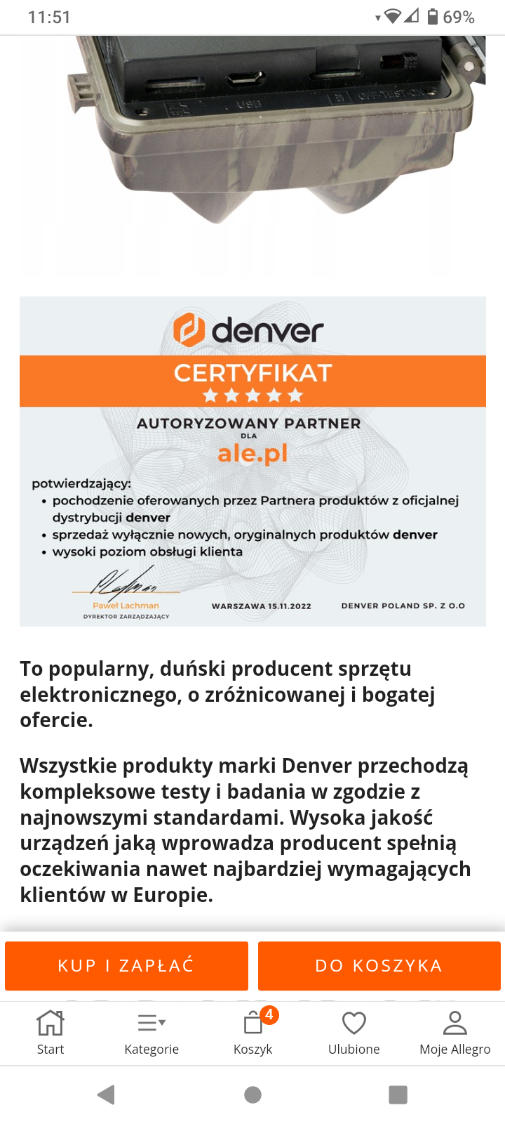

    At the beginning of the conversation, the manufacturer asks where the FP was purchased. Unfortunately, the seller I bought from does not have a distributor as theirs and does not want to talk. They send it back to the seller.
    Hmm .. someone`s probably lying here Certificate of authorized partner for ale.pl issued by Denver.
    Marketing ploy - they write what people want to hear...
    The manufacturer is a company from China that creates these FPs with their logo for them...
