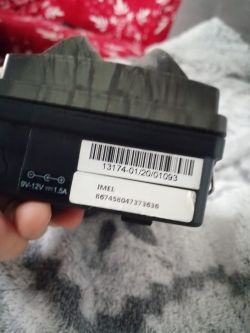

    I uploaded the soft to the card, now the photo trap does not want to start, the batteries are charged

    Send a photo of the information sticker from the FP housing.

    Denver WCM-8010 Camera Trap: Troubleshooting MMS & Email Issues, Activation Codes & Setup
    Added after 49 [seconds]:
    PO was definitely good, it's on an additional casing, I don't have it hanging in the forest
    What version of the firmware did you originally download?
    When uploading the update, did you wait until the red LED stops flashing and FP will automatically turn on?

    I don't know what the previous version was. I uploaded the Bin file, turned on the test and nothing was done, turned it off and it didn't turn on anymore. You are able to help me
    Added after 1 [minute]:
    Now it does not respond to buttons, the computer does not detect it either

    Copy the bin file directly to the memory card then insert the card into the FP. Switch to test and wait for FP to turn on by itself. If you interrupted the update while uploading it's a bit of a bummer.

    Unfortunately, I interrupted unknowingly. I have a bin file on the card, switched to TEST and nothing happens

    Check this file:
    If you manage to upload it, then upload the previous .bin

    The camera turned on by itself after 30 minutes as it was left in Test mode, now I'll see if it works and start messing around again
    Added after 13 [minutes]:
    The new software uploaded already looks different, it looks like pictures come in and reacts to SMS commands. Thank you for your support.
