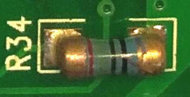

  • #50 18452997
    Uli939
    Posts: 11
    UNI-T UT33B - "Cheap / Dear" - multimeter with backlight and HOLD func
    Scouring the network for good pictures / schematic for the above-mentioned multimeter, I came across this topic. I need to read the bar code of the r34 resistor, unfortunately I have a problem with it even after enlarging and brightening the photos from the first post. Could someone who has this multimeter check the colors of this resistor?
  • #51 18453090
    CMS
    Posts: 8468
    Help: 258
    Rate: 2603
    It is red, orange or yellow and two black. 235 ? comes out of the measurement :) that is, in the middle between yellow and orange :) .
  • #52 18453132
    Uli939
    Posts: 11
    It seems to me that there is still green in front of black and gold at the end?
  • #53 18453185
    CMS
    Posts: 8468
    Help: 258
    Rate: 2603
    I say what I see after undressing, seeing and measuring. It is golden, but it is tolerance.
