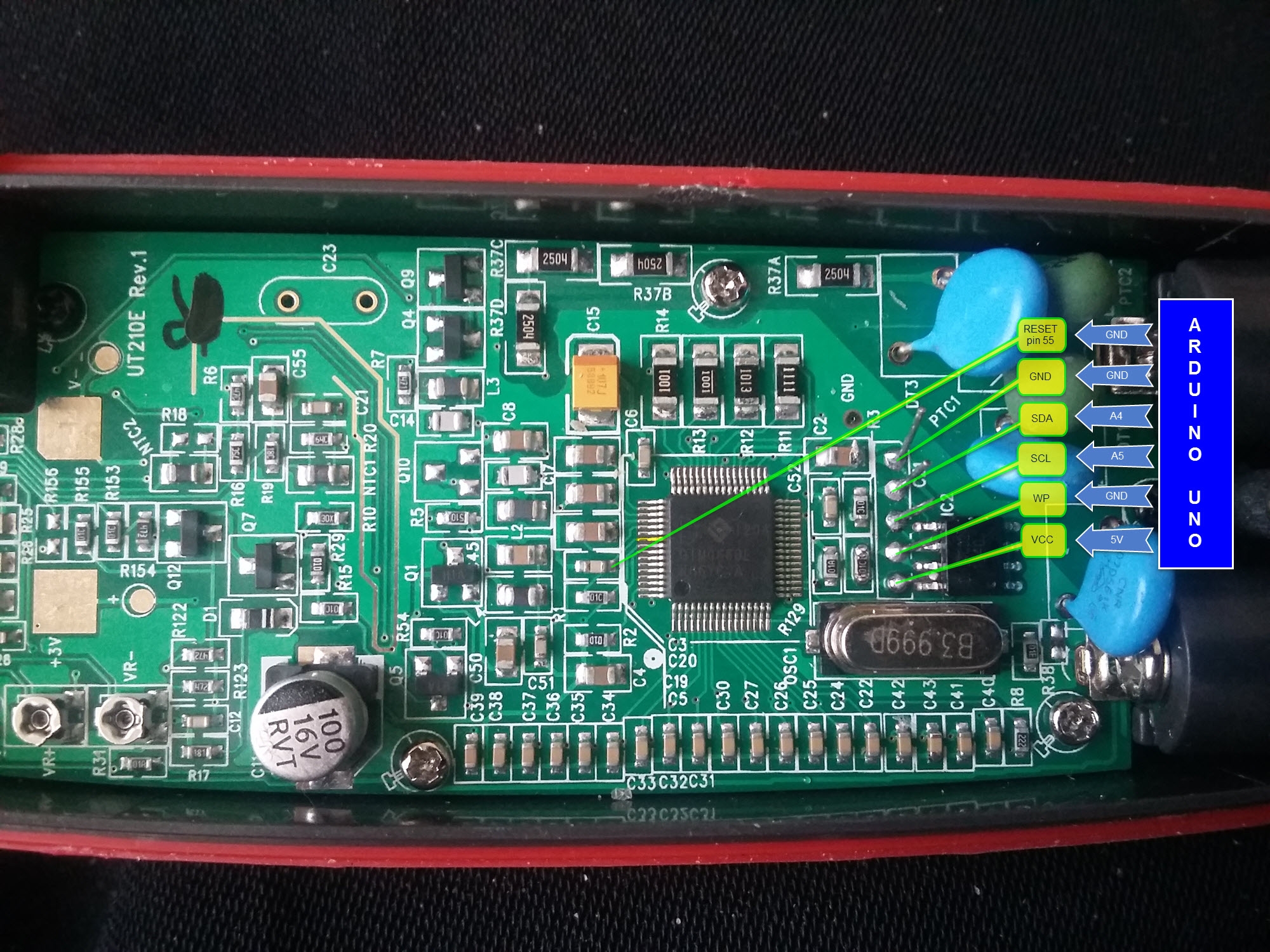

    Today I made a mod for my ut210e. Well, the meter is dead. Does not turn on. Once every few clicks, it will be able to turn on, and when it turns on, you can see that the eeprom is changed, because it will be set to volts dc, continuity test and measurement of dc with clamps. But the detection of live wires stopped working, and on the continuity test without any wires connected at all, it beeps all the time and shows 0. The clamp measures nothing either.
    What could go wrong? I was uploading via arduino. Of course, I changed two values to my calibration values.
  • #33 17773625
    CMS
    Posts: 8468
    Help: 258
    Rate: 2601
    Hope you made a copy of the original batch before you started messing around ....
  • #34 17773688
    noel200
    Posts: 1892
    Help: 36
    Rate: 815
    Of course. But I checked the charge and it looks like it's ok. The tip of the soldering iron is grounded, and yet I beat the chip somehow. I mean dm1106.
    After uploading the batch, the multimeter worked. I checked all the functions and it was ok. Including changes for the better. And after unsoldering the wires from the board, such a knock was done.
  • #35 17773974
    CMS
    Posts: 8468
    Help: 258
    Rate: 2601
    I do have a clip, but your message filled me with concerns.
    Did you do according to the video I posted? By some other method?
  • #36 17774213
    noel200
    Posts: 1892
    Help: 36
    Rate: 815
    I was doing using the program from the eev forum.
    I used this picture for connection:
    UNI-T UT210E True RMS clamp meter - Test / Review / Description
    And I uploaded the program from the attachment. Of course, I just changed it to my calibration data and turned on the record.
    And it went well. After a few switching on and unsoldering the wires from the pcb of the multimeter, something broke.
    I read the eeprom again and it's the same. Looks like the DM chip is down. Because there is nothing else there. Only an operational amplifier with a hall sensor and clamps.
    Edit:
    Oh, I remembered that I turned it on again after unsoldering the wires from the holes from the board and it was ok, only after unsoldering the reset wire from the capacitor on the left side of the DM system, the meter went crazy.
    And at the beginning, when I tried to read the eeprom for the first time, the reset did not go without this cable, so it is necessary.
    • JAY_i2cArduino210E.ino.zip (1.32 KB) You must be logged in to download this attachment.

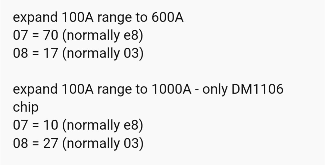

  • UT210E 100A range can be extended by byte changes
    #52 21255112
    rafels
    Level 26  
    Posts: 721
    Help: 69
    Rate: 166
    Wlodek22 wrote:
    I have also not found anywhere an option to increase the range beyond 100A, one even wrote that this is impossible due to hardware limitations
    It is also possible to extend the 100A range. In addition to changing the "Range switch upper/lower limit" settings, the following bytes still need to be modified.
    Instructions for extending the measurement range from 100A to 600A and 1000A, with byte settings modifications.
    This comes from https://www.eevblog.com/forum/testgear/a-look-at-the-uni-t-ut210e/msg1302533/#msg1302533
