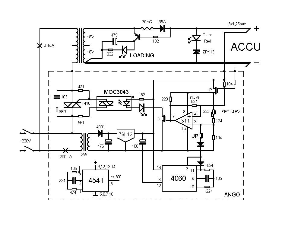

  • The design uses a 15-16VAC transformer, an H4 bulb for current limiting, and MOS protection against short circuits and bad clamp contact.
  • A 45Ah battery rose above 15V and started bubbling after about 3h of charging.
  • The manual setup was unsafe for overnight use because the relay rattled and sparked, and loose clamps could burn out quickly.

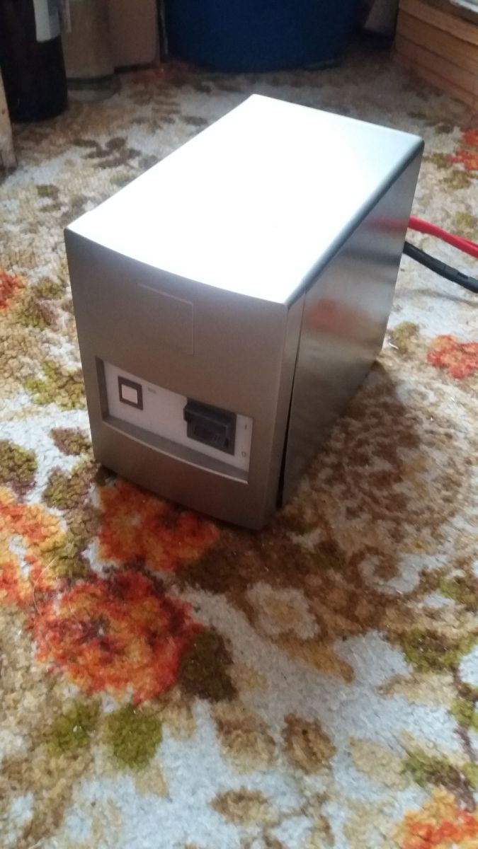

    The UPS was sent to the workshop for scrapping. It's a pity for a big case, use the opposite way and it will be a powerful charger.
    When once the "joy in the morning" met me for the first time, I thought: let it run for 15 minutes with 20-30A and the car would definitely start and I would make up for being late for work right away.

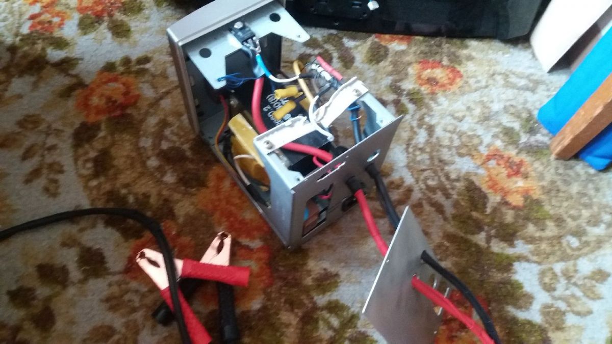

    To work by bus, in the storeroom I found a large transformer with Uo 15-16VAC. Accu plates are not cast, but pressed from Pb powder, a surface charge is formed on them, which penetrates into the volumetric one and is best charged in one-half. Full is 14.44V. A large diode in series with the H4 bulb as a limiting R and short-circuit protection with a clamp, due to the lack of thick 3x1.25mm wires. I connected the makeshift at home, the light bulb turned orange, I checked it from time to time, after m/w 3h the 45Ah accu exceeded 15V and started bubbling.
    The bulb indicates but loses power that should go to the accu. In order to leave them safely, e.g. throughout the night, you need an automatic device 13V ON was dropping and the relay was "rattling" and sparking. If the clamps lost contact during charging, they would burn out quickly. This was prevented by the MOS, it also protects the clamps from short circuiting. Charging starts with the accu connection with U < 5V (at least that's what each has) and supports it, doubled with a half + sine wave. In the negative, it supports only U from the accu, so how to disconnect them or make a bad contact charger OFF. The main transformer has a separate fuse, after removing it, you can apply external U to the clamps without fear and set 14.5V, information about the thresholds gives the LED in series with the Optotriac. Jumper would not have to wait for 2 hours until the timer "counts it down" or figure out how to skip it.
    Free transformer was great (probably also with microwave but, before I checked it, someone "used" it on Cu) classic and, I suppose, "to save yourself in 15-20 minutes". I shortened the housing with Flex, moved the back panel, etc., and presented the charger to my friend. After a good year (you know, "shoemaker without shoes") I put in such a layoutto yours but with a different timer (out of laziness, simpler printing and 2 times less monsters to drill) and for a triac relay with Ig 10mA, they issued R 1206 in terms of power, but they have a risky small distance between the ends, voltage is better 2010, the most reliable are THT 0.25- 0.6W
    The charger came in handy recently when I inadvertently left the car at the parking light. For something else, I needed a pulsating 12V RED diode, it worked from 3V and with Zener "13" from 14.5V. Pulsating informs you that you need to think about a new accu.

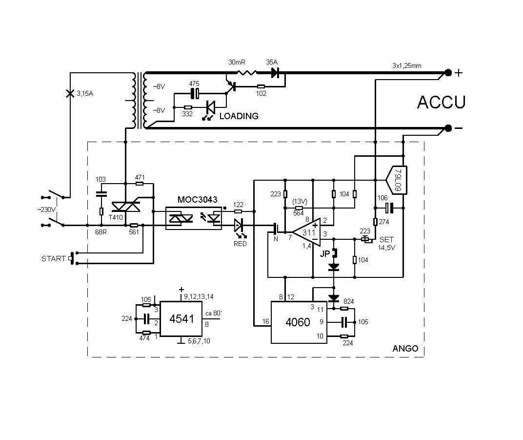

    And you read on? That I replaced it with a triac?
    Whoever has the time and inclination, let him measure himself as I used to do with the first makeshift. That's why I made an automaton.

    General assumptions for the charger are simple: ON from 0 to 14.5V, OFF 13V etc.
    At work, a few damaged drivers, etc. with very solid 2W transformers lay fallow. I've never come across a burnt or damaged one. If I didn't have them, I'd make a semi-automatic loader. Which, if it does not start the connected accu, would have to be started manually.
    Fast accu charger with UPS VFD
    In the example applications, the 311 collector resistor is 10kΩ. But, Ic up to 50mA i.e. you can use a relay with a 390Ω coil. It worked, but one threshold was clearly more stable than the other. Because one is practically only "resistory", regardless of whether or not there is a 311. In the second R, the hysteresis switches to ground 311, heated by 30mA of the relay current, and the semiconductors float in temperature. I set 14.5V, checked in 10 minutes and had to correct several dozen mV. She turned it the other way. And the threshold of 14.5V should be max stable.
    It was improved by replacing the R 22kΩ relay, etc. and controlling it inversely than before, so that the now important "upper" 14.5V threshold was "resistor" and the less important lower "semiconductor".

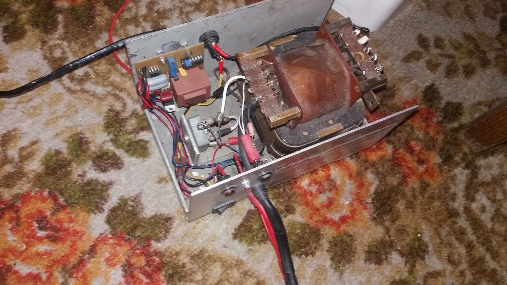

    My charger has 1cm legs and dozens of monsters on the bottom and top of the housing, so it is quite well ventilated. I visited a friend who was gifted a few years ago with the one from the shortened UPS.
    Inside you can see that it was used (2 adult sons, from 3 cars), the milliohm R almost melted the plastic bracket 2 cm from it, ventilation needs to be improved.
    In my free time, I made and inserted the "thyristor for the relay" plate and my friend in his spare time will drill as many monsters as possible in the lid.

    I wonder what whines more after connecting a discharged battery - a transformer loaded with a DC component (one-wave rectification) or a battery.
    Fortunately, this one is used to charging from the alternator, where initially the currents "fly" in tens of amperes.

    What current control? What for? The first word of the subject is "fast" (implicitly max fast) and at the beginning of the description it is clear why I wanted "from 20-30A". Without control I, the limiter in the event of a short circuit of the clamps and this one after improving the system is probably redundant.
    You've confused passing a one-way U with picking up. The differences can be found very quickly - let some 230VC through the diode and after a while ... you get the result in the form of a burnt transformer.

    I am looking at the comparator on the LM311. You write about difficulties with the proper setting of the thresholds that determine the hysteresis.
    It is indeed difficult in such a simple arrangement, although not impossible. Wouldn't it be easier to use 2 operational amplifiers (LM358) or even comparators (LM393) assigning each their own threshold. The popular and thermally stabilized LM431 could be used as a voltage standard.
    Each threshold could be precisely adjusted without affecting the other.

    Almost every layout can be done in different ways, I bet on 311. If I did it on 358, would you write "it can be done on 311"?
