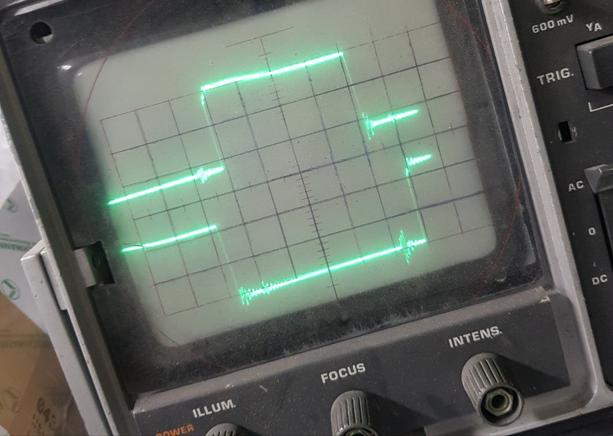

    One more question. Does this converter have voltage stabilization? If so, which element is responsible for the feedback from the secondary side?
  • #199 18676550
    aaanteka
    Level 42  
    Posts: 7727
    Help: 729
    Rate: 1193
    It has already been written quite comprehensively on this topic. I recommend reading all posts.
  • #200 18694822
    Szymek11211
    Posts: 93
    Maybe such miracles were happening to someone at the SG3525 outputs? I put in new and SG and UC2525 and the effect is the same. When changing the state on the 1st output, it has a reflection on the other output. T.amp TSA 4-1300 Power Amplifier Issue: Not Turning On, Red Diode Flashing, No Visible Damage

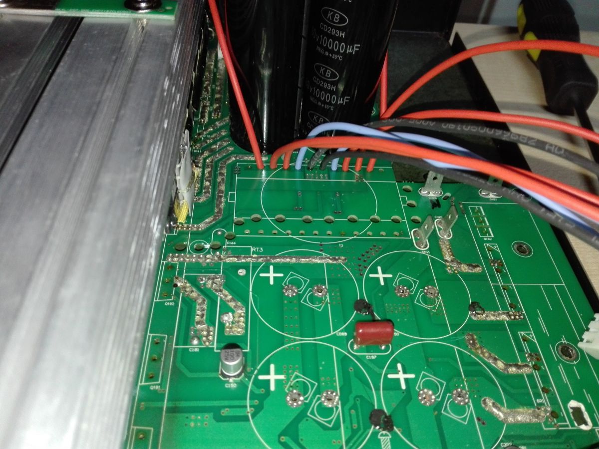

    Pany will give someone the exact voltage of this traf? 'Cause it's already boiled again :D I want to make a power supply in a separate block and when it was still working, I did not measure it :D T.amp TSA 4-1300 Power Amplifier Issue: Not Turning On, Red Diode Flashing, No Visible Damage T.amp TSA 4-1300 Power Amplifier Issue: Not Turning On, Red Diode Flashing, No Visible Damage
  • #202 18700395
    ziro_9
    Posts: 27
    Rate: 17
    popej wrote:
    Pany will anyone give the exact voltage of this traf?
    Oh buddy, I see that I don't want to look at a few posts back. Oh well...
    # 143
    ziro_9 wrote:
    The voltages on individual stages (measured at 230VAC ZAS) are:
    P + - 30V
    1H + - 62V
    2H + - 125V
    3H + - 188V
    Apparently there had to be a reason.

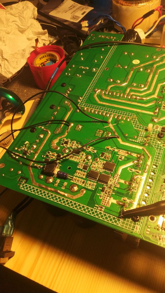

    AT first, big thanks for posts about this amplifier, theres something from me, switching Frequency is 70kHz, dead time 800ns, theres a little ringing on the edges, it looks Like bad pcb design, after replacement igbt's looks better.
    My amplifier has broken igbt's,both IR2110 and all smd sand around, LM555, Lm339,
    I recommend replace all, especially gate discharging diodes, bootstrap capacitors, when everyrhing looks ok, I solder igbt's and start test, but with small mod, I discontinued trace form igbt and primary coil of transformer, and put classic 100W lamp here, and controls voltages on the secondary side, when everyrhing looks good, we can put bulb out and start amp correctly, but dont forget all on the secondary side must be fine, for sure i desoldered jumpers on rails and put here some power resistors, now it looks Like amplifier working but theres problem with one chanel, dc offset is about 100mV, probably something with H-step, beacause i measure 90V (must be 60V)on output power transistors without input signal T.amp TSA 4-1300 Power Amplifier Issue: Not Turning On, Red Diode Flashing, No Visible Damage T.amp TSA 4-1300 Power Amplifier Issue: Not Turning On, Red Diode Flashing, No Visible Damage

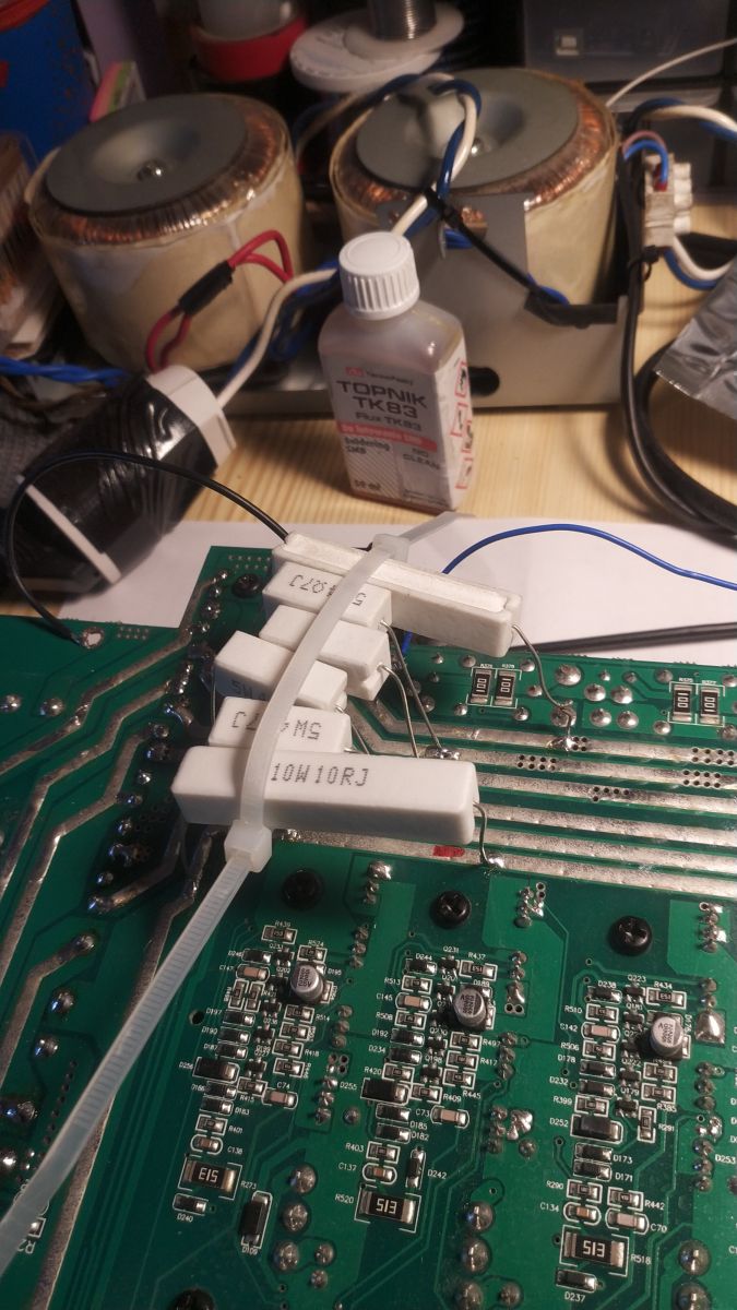

What’s the safest way to first-start after repair?
Use three 100 W bulbs in parallel as a series limiter[Elektroda, zbyszekdymny, post #21049561] Verify 15 V on SG3525 pin 15, no DC on outputs, then replace bulbs with fuses.

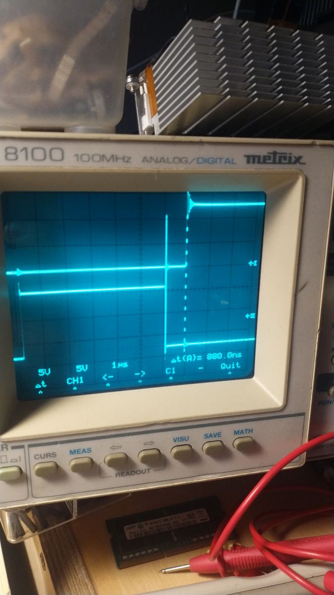

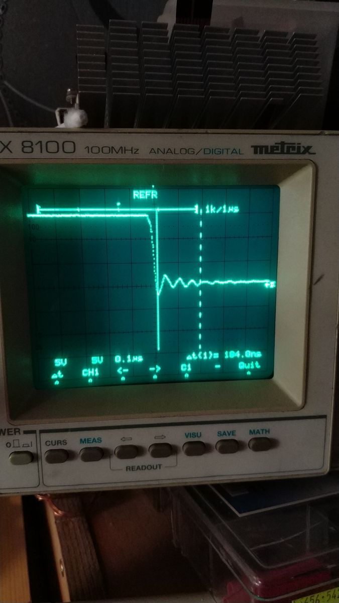

Quick 3-step check when PSU stays silent
  1. Confirm 5 V at SG3525 pin 16 and < 0.2 V at pin 10. 2. Scope pins 11/14 for 80 kHz square. 3. If missing, swap LM339 & NE555; they latch SG shutdown[Elektroda, Robercikxxx, post #21050982]
