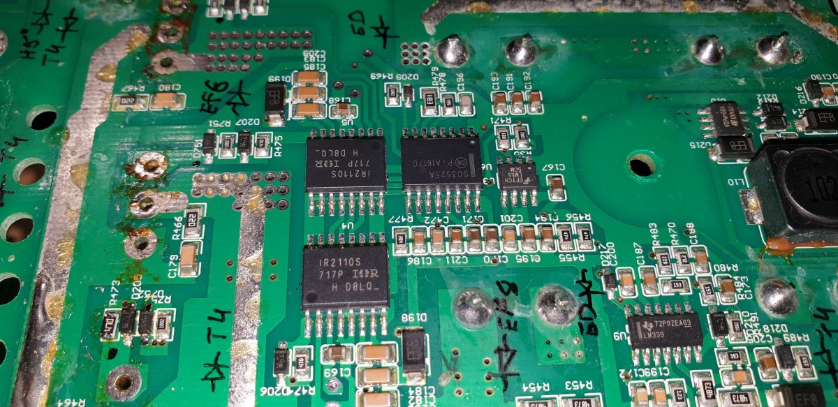

    Q-mac
    Posts: 985
    Help: 63
    Rate: 215

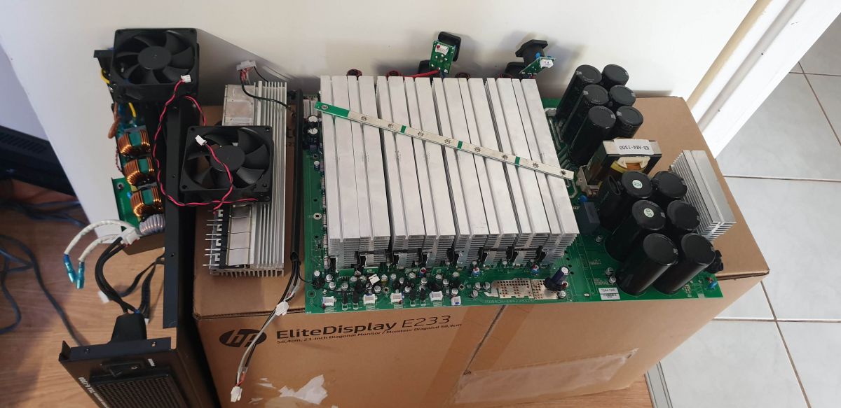

    I have it too, that is, I also managed to pick up this amplifier. My measurements show that the voltages at 230 V mains:
    Auxiliary ? 35V,
    1H ? 60V,
    2H ? 110V,
    3H ? 177V.
    The frequency of the converter operation is approx. 75 kHz. Idle power consumption is about 70W. The power amplifier starts very softly, it moves smoothly on T1.5A / 250V fuses.

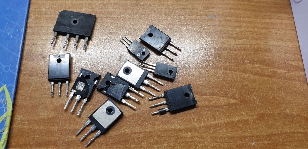

    And as for the repair itself. Well, I was not as lucky as some people. Overall, a lot of burnt paths (all current in the power supply, power supply and control signals SG3525 and IRS2110). One channel is damaged (the whole minus branch, including switching transistors + relay and surrounding elements which were burned by the relay burning with live fire). In addition, 7815 in the preamplifier power supply and additionally 7824 in the protection system + resistors in front of the auxiliary power supply bridge (they probably served as fuses), and transistors controlling the relays (all of them are connected from one place). In the power supply, practically everything except capacitors and bridges. To be honest, I bought the amplifier only for the challenge and if it hadn't been for that, I would have missed the repair.
    I started the amplifier with a separate power supply consisting of a 2x18 V 10VA transformer and a 4x24V toroid, powered by an autotransformer and an isolating transformer (occasionally in series with a 100W bulb). The isolating transformer had two functions: it was galvanically isolated from the mains, enabling measurements with an oscilloscope, and it was a "soft" power supply. In the event of a mistake, the possible effects will be much smaller. I first started the amplifier. After replacing the burned transistors (NPN and PNP branches right away, I put NJW3281G and NJW1302G-are stronger) of the relay and what it took with it, the amplifier did not work - the reason was the mentioned stabilizers, after the repair it was possible to start. Ie. the relays did not turn on the loudspeakers, although the faulty on the PCB went out (active on the front panel). After a few hours of PCB analysis, I found damaged transistors (Darlington sot-23). After the replacement, the relays started working, all the fouls went out. DC voltage

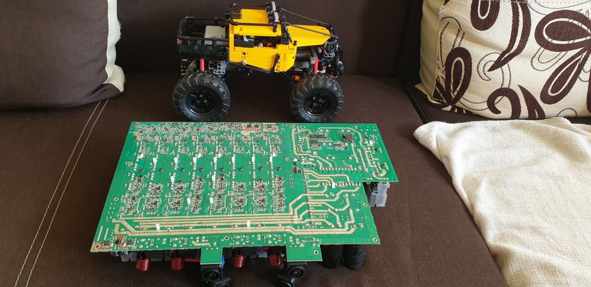

    Lizak86
    Posts: 326
    Rate: 21

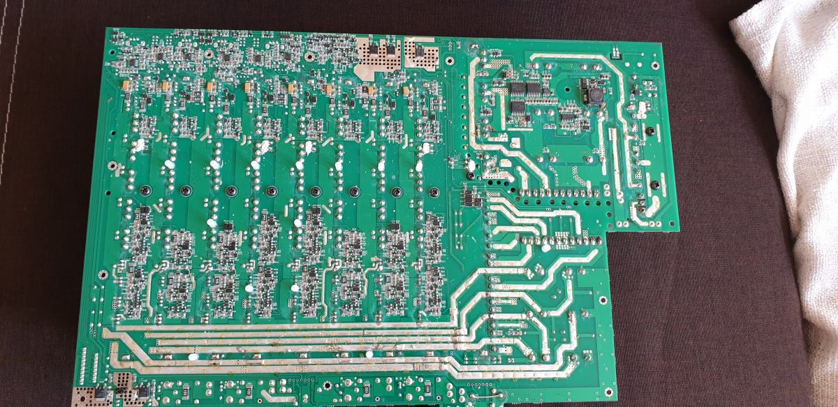

    I am sending a few photos from the repair, the drivers and other issues went new.

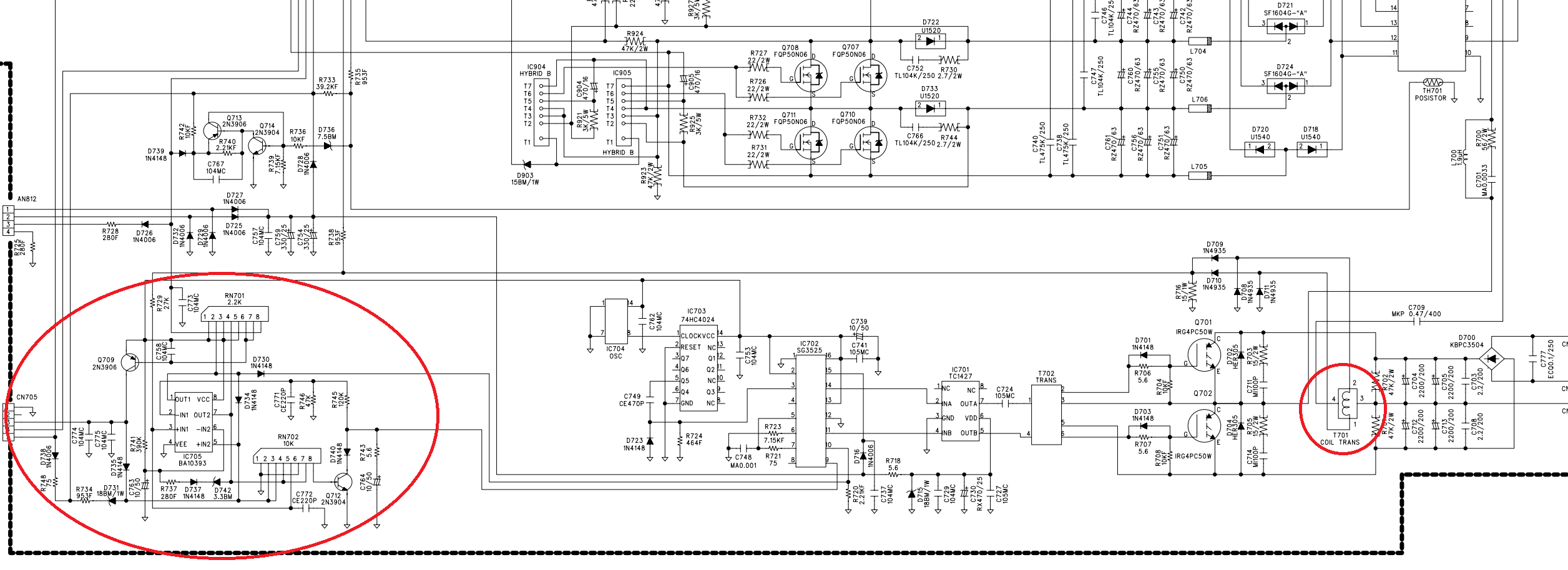

    It is not possible for you to receive a diagram of this and other products from this manufacturer. This has not been the practice for a long time in the commercial world.

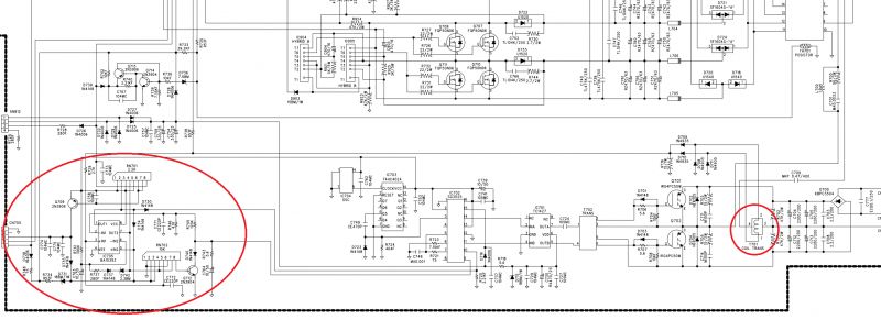

  • RAM S series schematic useful for audio stage repair

    Krzychu1843
    Posts: 52
    Many have tried to establish contact with the manufacturer - as you can see without much results. To repair the power amplifier itself (audio part), a schematic for the power amplifier from another manufacturer should be enough - RAM S series (many solutions are similar, it was useful for me when repairing it). The converter is so simple in design that if, when trying to repair, there was no general massacre there, you can easily do it without a diagram, based on what was written in the thread.

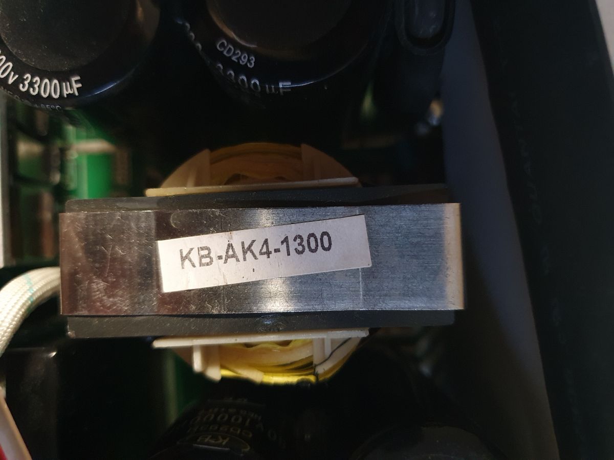

    No wonder T.AMP did not provide the schematic. He is not the owner of this project. All electronics are OEM purchased from Kobble Audio. The T.AMP has only its own housing, which is also probably made by some other external company, that's it ...
    The real name of this amplifier is KB-AK4-1300

  • Converter transformer designation matches earlier amplifier models

    It's not exactly how you write. Usually, the project is developed by the manufacturer and commissioned by it. It is more advantageous for him if, after some time, the production company has the option of licensing the same product to another market, often on its own internal market - the agreements are different in this respect. But those who outsource and order in Chinese production plants know it well.
    And the designation you provide, unfortunately, applies to the converter transformer and is analogous to other previous amplifier models.
    and the schemes of this type of equipment have long been no longer available due to the marketing policy.

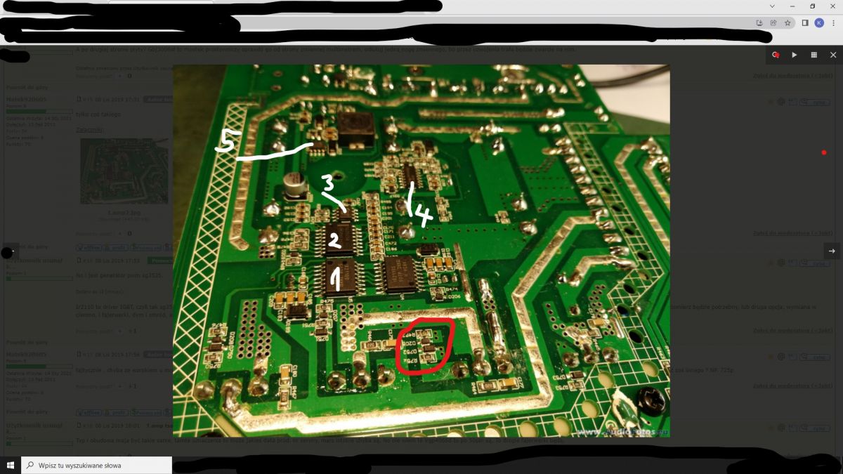

  • #228 19855768
    kudlatyy1
    Posts: 104
    Rate: 45

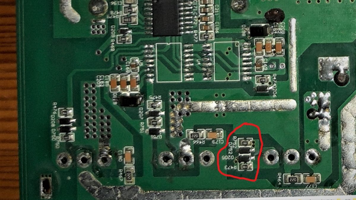

    Gentlemen, I noticed that different boards came out and there you have to watch out for the polarity of the diodes ... T.amp TSA 4-1300 Power Amplifier Issue: Not Turning On, Red Diode Flashing, No Visible Damage T.amp TSA 4-1300 Power Amplifier Issue: Not Turning On, Red Diode Flashing, No Visible Damage
  • Different diode types used on the boards

    aaanteka
    Level 42  
    Posts: 7727
    Help: 729
    Rate: 1193
    Let me summarize: - it is not worth to "pursue" the topic of repairing the equipment, which was considered by the manufacturer to be incorrectly constructed and withdrawn from production and offer. Even the last series under the guarantee was accepted for returns / returned from business entities (it was enough to have a VAT invoice). This construction is a real crap in every respect, which was already mentioned above in the topic. It has nothing to do with the construction of professional sound equipment. Why does someone need an amplifier (supposedly compact 4 channels) for which you always need to have a reserve?
    kudlatyy1 wrote:
    different boards and there you have to watch out for diode polarity ...
    Not different boards, but the use of different elements: - these diodes probably have a protective function and in one case ordinary diodes were used, in the other - Zener ones. A common practice of "modernization" of equipment of this size, not very well proving its quality and refinement.
  • Different diode variants across amplifier revisions
