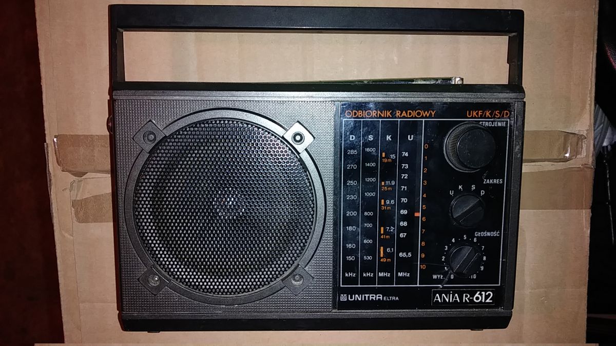

  • Opens and documents the interior of two Unitra Ania R612 portable radios, rescued from e-waste and shown with boards, wiring, speaker, antenna, and service manual excerpts.
  • The teardown highlights a ferrite antenna, Tonsil GD8/1/2 1W 8Ω speaker, UL1219 and UL1497 ICs, plus a separate bridge-rectifier and fuse board.
  • The receiver uses the OIRT UKF band, 65.5–74 MHz, and runs from 5 R6 batteries at 7.5V or mains through a transformer marked UNITRA ZATRA TS2/22.
  • After re-soldering a loose electrolytic capacitor and repairing a cracked ferrite-antenna PCB trace, both radios produced their first sound, though reception remains rough and untuned.

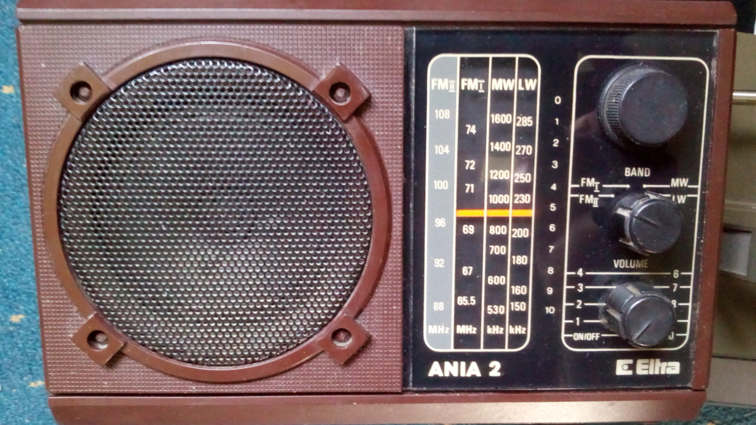

    Anne 2 and Anne 3 in a different housing with Anne R612/613 have nothing in common.
    These are modern receiver modules on CXA1119 inserted into the housing after Ania R612/613
    Same thing:
    Lena 1/2 a Lena 3
    Tola a Tola 3

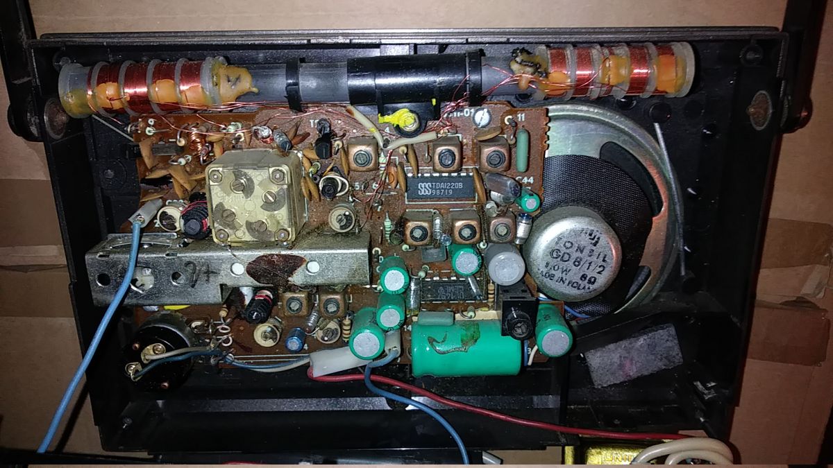

    I am adding photos of the third, but perhaps not the last, version of this radio.
    The IC working in the radio circuit is a TDA1220B, the speaker housing has a surround known from the radio appearing under the name Zosia.

    Mateusz_konstruktor wrote:
    I am uploading photos of the third, though perhaps not the last, version of this radio.
    The IC working in the radio circuit is a TDA1220B, the speaker housing has the surround known from the radio appearing under the name Zosia.
    I tuned a long time ago, without equipment, by ear, 3 months of rummaging (mainly p.h.), but the effect was amazing - standing under the mast of the RTCN I received a signal from other RTCs about 100km away.
    The field from the transmitter was "going hot" and did not "cover" weak signals from distant transmitters.
    The radio is lost to me somewhere, but I remember that it sounded nice.

    @sq3evp
    A colleague says that the version built on the TDA chip has some design advantage?
  • #51 21004813
    sq3evp
    Posts: 6714
    Help: 226
    Rate: 901
    I can't remember what it was, but it worked nicely.

How does the later Ania 2 / Ania 3 differ?
Those sets drop SW, add full 87.5-108 MHz FM, and replace the discrete front-end with single-chip CXA1119 or TDA1220B modules, cutting component count by ~40 % [Elektroda, ojciec, post #18787735]
