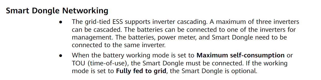

    sla13
    How do I correctly add the dongle to an existing installation?
    I have an installation with an S2000-L1 inverter. The system is installed by a company that refuses to grant me installer privileges.
    For now, I do not want to unplug the inverter from the original installer.
    So, after resetting the local installer password, I log in locally, connected the dongle. Commissioning..... etc.
    Everything seemingly looks fine as I am connected as a local installer and directly from the inverter wifi. However, when I switch to the normal network the inverter shows offline status, it does not connect to the fusionapp system. Same when trying to connect via laptop. The inverter is offline.
    After disconnecting the dongle, everything returns to normal. The inverter connects to the server.
    I am adding the dongle because I am planning to install a Luna2000 battery and the manual says that the dongle is required for TOU (time-of-use).
    A section of instructions about Smart Dongle networking management.

    #1234 21067392
    sla13
    Problem solved.
    As it turned out, the normal user does not have permission to add devices to the installation. Therefore the dongle did not report. The only device that can be added on its own is the car charger.
    So I was forced to completely divorce my installer and move the inverter to an installation created by myself.
    The rest is now a formality. Now everything is visible in the new installation: inverter, meter, dongle and new battery.

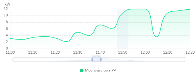

    #1259 21209669
    strucel
    Level 36  
    Posts: 3086
    Help: 271
    Rate: 622
    webonek wrote:
    Well, I changed the inverter (to a used one year old from a friend) to a Sun2000 8 kW, added on a 2nd string of 11 375 W panels. The voltage currently never goes below the minimum 315V during operation. According to Huawei, everything is OK.
    But yet it is not. For me it isn't. Why? Because the installation is about 10 kWp, but the peak max. is 7.8 kW. And that's it. And it doesn't want more. That is to say, there are times when "for a while" it wants to - when the sun is covered by clouds and suddenly those clouds pass and the maximum sun comes out, then literally for a moment(!) a peak of 8.2, 8.6, sometimes 8.79 kWp appears. But immediately afterwards the graph drops down to those "enchanted" 7.8 kW. :( .
    awienie after the previous owner (he I don't know, some other team fitted it for him).
    For me, the conclusion is one - and it coincides with the position (at the start of the adventures) of Huawei: that the peak will be 8.8 kW. But it isn't.
    All firmware updated to the latest version and no alarms on the inverter.
    But I guess that's how huawei inverters work - they don't have a power bonus , do you have somewhere in the inverter documentation that it should output more than 8kW?
    I have a 12kW inverter and it looks like that on the rare occasions when the panels give more - it's just flat out at 12kW
    Also, to find this example I had to go back to 26 March - even though the installation is almost 12kWp, in summer the panels are too warm and at the moment about 10kW max can be drawn.

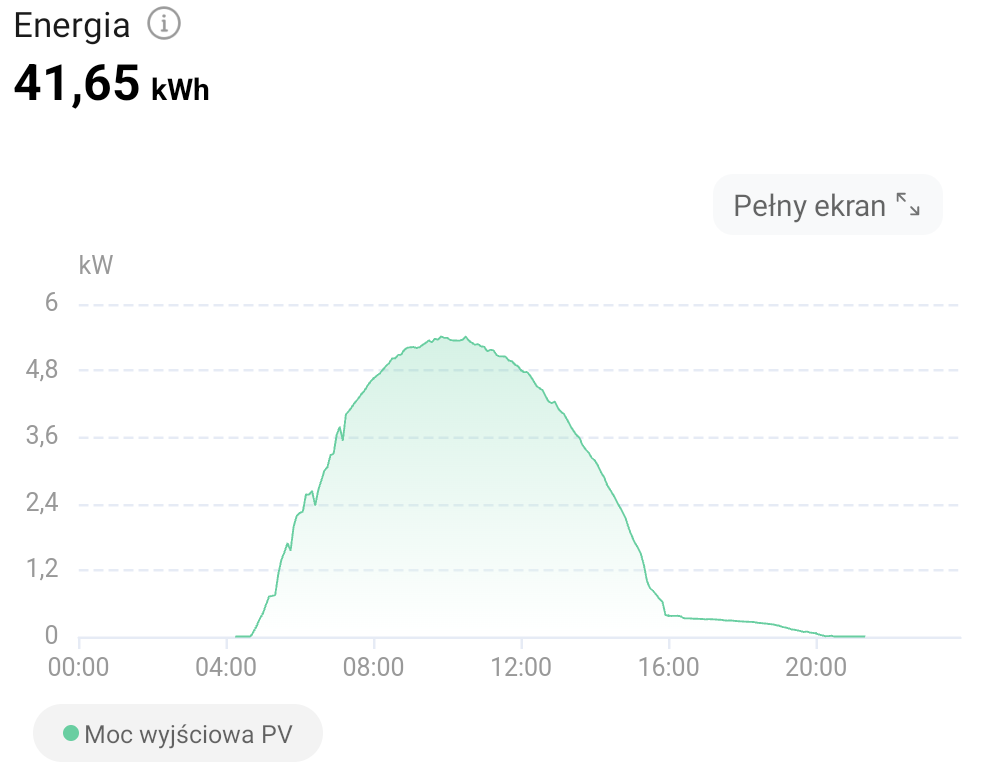

    webonek
    Posts: 66
    >>21209669 .
    But this is how the 5 kW - the same Huawei model - worked: with a 6.1 kWp installation, it gave a fairly long peak of 5.5 kW. After rewiring the inverter itself to 8 kW, 6 kW production appeared. And now exactly the same string (because it remained unchanged) on a different inverter doesn't even make 5 kW, but some 4.7 kW. And the output of the panels is more than 30% higher.
    On top of that, support Huawei itself claimed at the expansion that, and I quote: "with a 10 kWp installation, the 8 kW inverter will have a peak of 8.8 kW".
    As you can see from the graph under ideal conditions a 5 kW inverter with panels over 6 kW was doing just under 42 kWh. And now as everything 70% more, the amount of current only maxes out at around 51 kWh. Something is clearly not right. It can't be like that - I just have no idea why. :( .
    Chart showing photovoltaic output power peaking at just under 5.5 kW, with daily production of 41.65 kWh.
