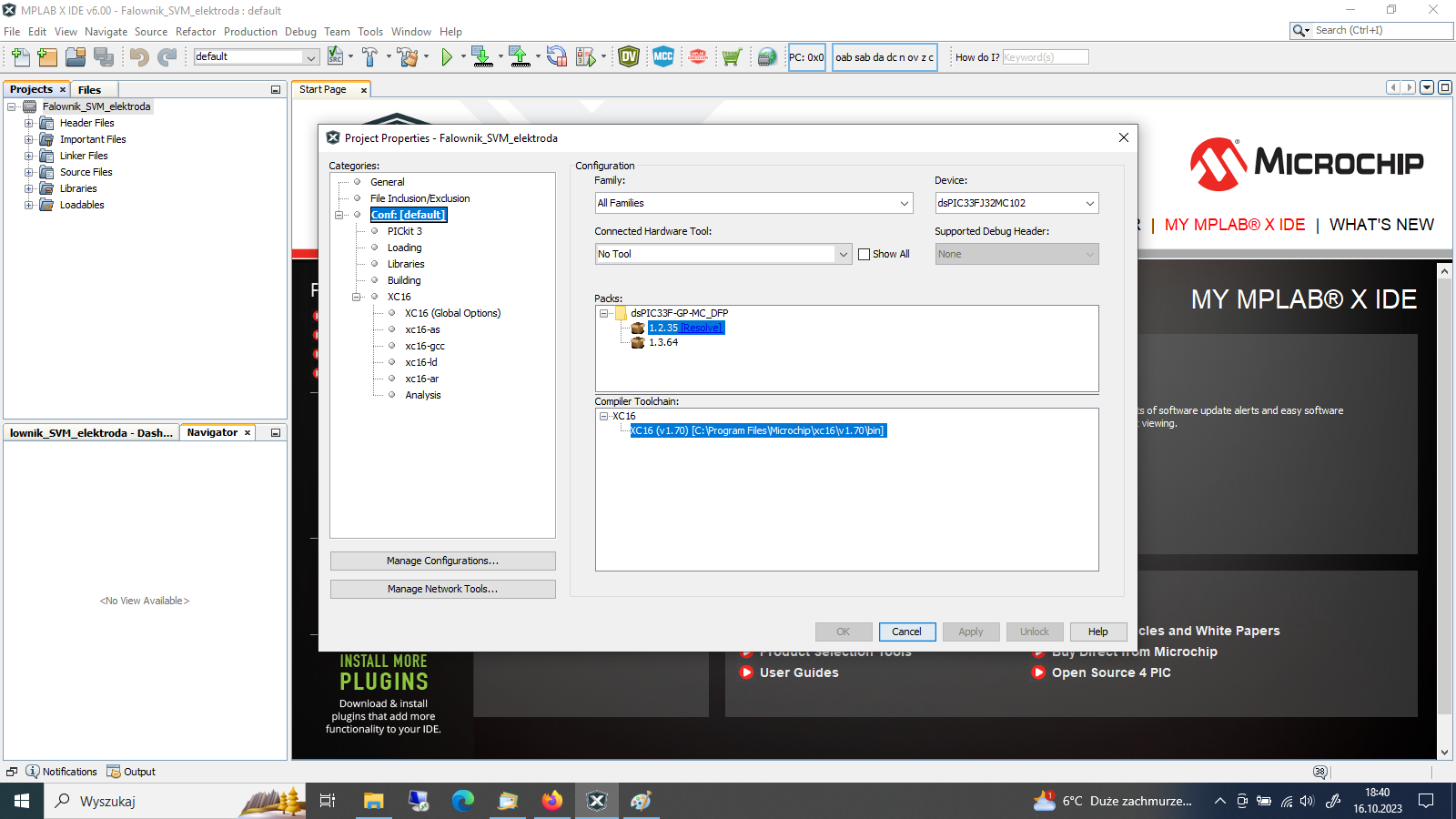

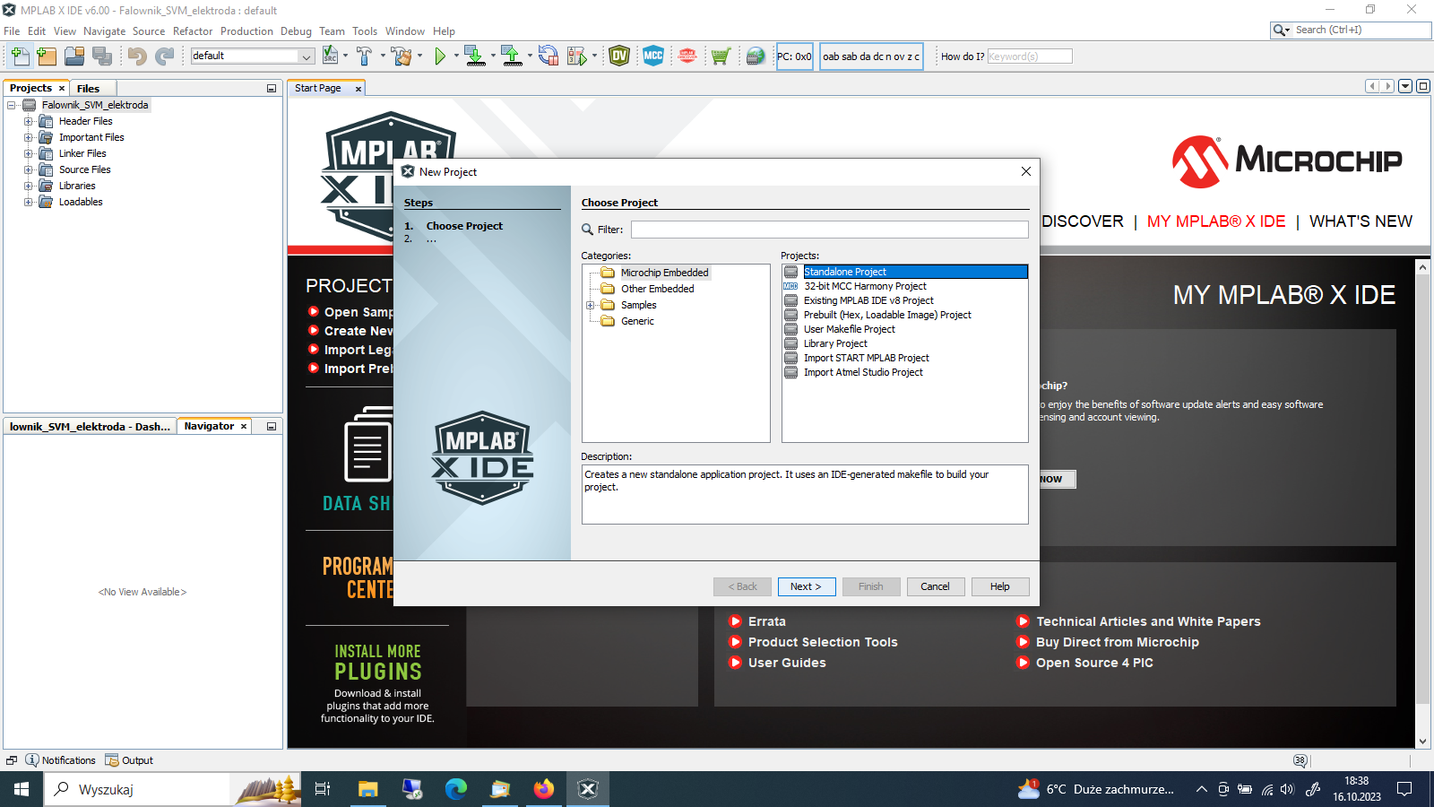

    #34 20772785
    Tatalek
    Posts: 41
    Rate: 343
    You can use PICKIT3 or SNAP to program the dspic33FJ32MC102. The first proposal cheaper the second more expensive.
    Micro controller is selected when setting up the project , or you can change in an existing project by selecting properties
    New project
    Screenshot of the MPLAB X IDE software with a new project creation dialog open.
    In existing project
    Screenshot of MPLAB X IDE software with project properties window open.
    Was that what you wanted ?

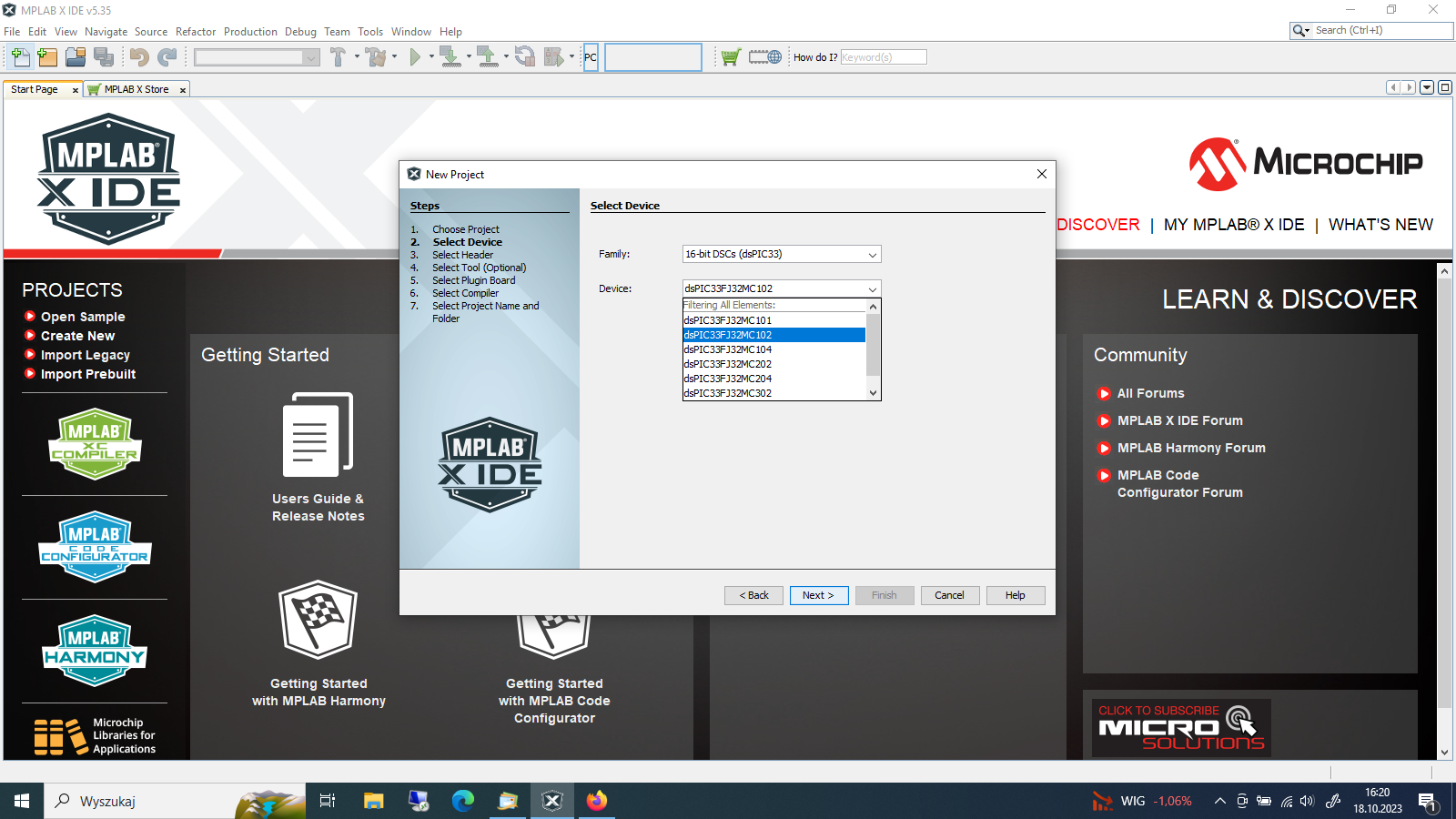

    Tatalek
    Posts: 41
    Rate: 343
    I installed on my computer MPLAB X IDE v 5.35 to check . In this version of the program you can choose such a microcontroller. Screenshot of MPLAB X IDE version 5.35 with the device selection window displayed.
    In such a situation it is difficult for me to help.

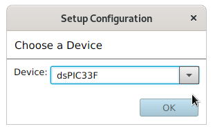

    #37 20775517
    111lisu
    Posts: 404
    Rate: 52
    I already have MPLAB X IDE v6.15, but it ate up a chunk of my disk ;) . I need to add a little more here, maybe because it's Linux:
