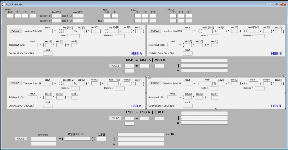

    Rate: 645
    Still looking for a solution for keyseed CONTINENTAL - eeprom reading
    start here: https://www.elektroda.pl/rtvforum/topic3743099-120.html#19680488
    I decided to commit a little program to decompose the PSA algorithm.
    Maybe thanks to this - by looking at the components and what and where when it occurs - it can be mathematically reversed.
    maybe not.......
    If someone wants to play, I put a applet.

    Maybe someone has an idea or knows what algorithm connects these SEED and SEEDKEY pairs

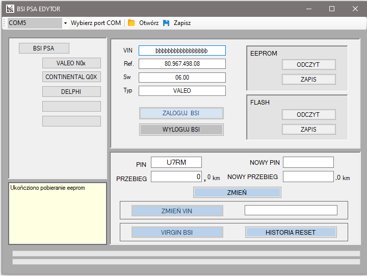

    Below is the BSI configuration program (coding - basically finished ... testing, I'm looking for errors such as unnecessary active switch ... something does not go out, etc.
    program in the PL and EN version (EN is a translator .... may require corrections.)
    The program was able to download the full configuration on the basis of all coding zones known to me (about 400).
    So I have a BSI and it asks about all zones in my database.
    If bsi does not respond to a given zone (because it is not in the software) then it is not included in the backup file.
    As a result, only the zones that are in the backup file are uploaded to the new bsi.
    Due to many questions about the availability of the program - ask by email because I will need some information to run.
    [movie: 850dd0a5cc] https://filmy.elektroda.pl/63_1636982781.mp4 [/ movie: 850dd0a5cc]
    Tonight or tomorrow I will throw in a free BSI VALEO eeprom and flash reading program for testing (this is a test version - you use it at your own risk).
    of course, I will attach the Arduino batch because I had to make changes to be able to send logins to the BSI.
    Files available for points - but you can always ask me for points if you don't have any.
    Below are two attachments - not an encoder just mentioned for eeprom and flash reading
    VALEO is currently operational, and continental and delphi logging is partially running.
    If anyone has an idea for the SEED algorithm for continental
    pairs in the previous post, I will finish the continental and share.
    The rest of logging into Conti. I have composure.
    VIN recognition is already in valeo .. for now open.
    • BSI EDYTOR.zip (423.14 KB) You must be logged in to download this attachment.
    • arduino-psa-diag_eeprom1.zip (2.79 KB) You must be logged in to download this attachment.

    Testniete and something does not go, spitting log2.txt in datalog / valeo /
  • #158 19712617
    glapsson
    Electronics specialist
    Posts: 557
    Help: 11
    Rate: 645
    sorry .. so I cleaned my test files that I also cleaned the log files ..
    Already added no points
  • #159 19712655
    bbmax
    Posts: 132
    Rate: 62
    it reads probably ok
    but not saving

    only eeprom is not written to flash
    a few words of explanation
    read files are saved as .bin - in the program in the Datatemp directory
    Uploading traditionally from the indication of the file.
    The program is still in the process of being developed and has many operating flaws
    I don't know what it will look like in the end, that's why some things are suspended.
    There is no flash programming entered because I have the impression that after uploading I found two errors and I do not know what they result from.
    So that someone on my dogs does not know that he has damaged himself - there is no this option ... with eeprom, it always somehow goes to get out.
    After reading and uploading, it is worth turning off and on the bsi power supply, because it does not always want to start cold.
    the progress bar is not fully established because some operations require several loops and I left it for tweaking at the end - when uploading - it starts quite late.
    There is much room for improvement but I am facing the second SEED algorithm to continental
    because I can't generate a reply.
    I have further log operations worked out.
    And now I focused more on research on this topic.

    Rate: 645

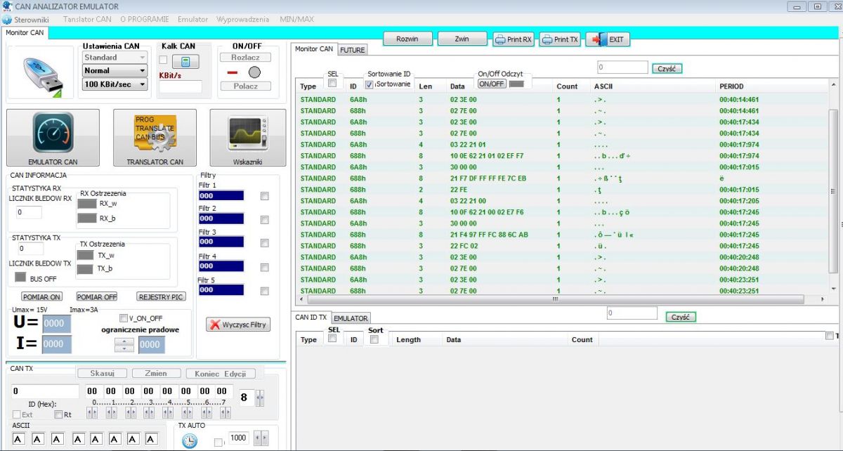

    I checked - a moment ago - I took what I put in from the electrode and read it and programmed it without any problems.
    So I don't know where your problem is ... this project is just under construction so .... it works as it works .. it may be due to differences in bsi ... I don't know
    as for the naming of the file - it should be standardized in this way ...
    as for the name itself, whether it will be it or something else, it is being overwritten at the moment - I have to rule it out too ... but it's not for now.
    but at the moment the main issue is read-write stable.
    I am more interested in whether everyone who has downloaded and tested on valeo works like me.
    If there are problems - it would be worth using the analyzer to see where the problems are. so that I can eliminate them.
    Well, because when it works fine for me, it's hard for me to change something blindly.

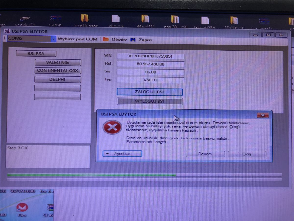

  • Unhandled .NET JIT debugging exception during telecoding

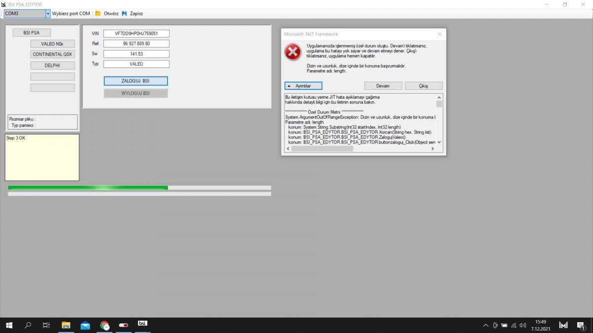

    #165 19714329
    PeugeotTeknik
    Posts: 14
    Rate: 7
    BSI DELPHI series EL HW D6 - TELECODING READING BSI peugeot 208 II corsa F
    otrzymuję ten błąd, a kiedy kontynuuję, znowu pojawia się błąd
    Win32 Version: 4.8.4110.0 built by: NET48REL1LAST_B
    CodeBase: file:///C:/Windows/Microsoft.Net/assembly/GAC_MSIL/System.Core/v4.0_4.0.0.0__b77a5c561934e089/System.Core.dll
    System.Xml
    Assembled Version: 4.0.0.0
    Win32 Version: 4.8.3761.0 built by: NET48REL1
    CodeBase: file:///C:/Windows/Microsoft.Net/assembly/GAC_MSIL/System.Xml/v4.0_4.0.0.0__b77a5c561934e089/System.Xml.dll
    System.DirectoryServices
    CodeBase: file:///C:/Windows/Microsoft.Net/assembly/GAC_MSIL/System.DirectoryServices/v4.0_4.0.0.0__b03f5f7f11d50a3a/System.DirectoryServices.dll
    mscorlib.resources
    CodeBase: file:///C:/Windows/Microsoft.Net/assembly/GAC_MSIL/mscorlib.resources/v4.0_4.0.0.0_en_b77a5c561934e089/mscorlib.resources.dll
    System.Windows.Forms.resources
    CodeBase: file:///C:/Windows/Microsoft.Net/assembly/GAC_MSIL/System.Windows.Forms.resources/v4.0_4.0.0.0_en_b77a5c561934e089/System.Windows.Forms.resources.dll
    ************** JIT Debugging **************
    To enable JIT debugging, this application or
    in the computer's (machine.config) .config file
    The jitDebugging value must be set in the system.windows.forms section.
    Also compiled with app debugging enabled
    should be.
    For example:
    Unhandled exceptions with JIT debugging enabled
    saved on the computer instead of being processed in this dialog
    The JIT is sent to the debugger.
  • #166 19714477
    glapsson
    Posts: 557
    Help: 11
    Rate: 645
    Did you upload the arduino?
    If not, you will not log in because the French batch does not provide for sending full login frames.
    or you downloaded versions without log files ... I corrected it
    download again - I will give you electrode points.

    I have mastered the VIN topic - regardless of the LOCK or open batch version or any other batch - changing the VIN in the .bin file with the checksum calculation.
    The VIN lookup is an incremental area calculation with a cyclical shift until a matching checksum is found.
    So - only in a working file.
    maybe Virgin will come tomorrow .. then either flash or history .....
    we'll see.
    you can work with bin files only.
    Only VALEO for the time being.
    • BSI PSA EDYTOR.zip (421.57 KB) You must be logged in to download this attachment.

    added virgin.
    and changed the reference display.
    Of course, it now only adds the executive file that needs to be replaced.
    Correction = by doing virgin I fired the PIN change ... so it happens ..
    For people with a small number of points - the program is developing and there will be a lot of changes.
    And there will be errors that will be picked up over time.
    The program will never be pointless ... so your decision whether you download corrections every now and then ... or wait for the end of the stage, e.g. VALEO.
    Points are not a problem for people who share what they have ... because then they collect points.

    hello there is a problem
  • Valeo datalog files and login stage 3
    #177 19750058
    glapsson
    Posts: 557
    Help: 11
    Rate: 645
    You stay on the 3rd login.
    Got the entire program downloaded with the files?
    And don't quote entire posts - it's getting trash.
    in the Datalog directory
    is to be a Valeo directory
    and in it two files log2 and log3
    that was a lot earlier - I'm not throwing the whole program right now, only .exe modifications
    And if there is still a problem, I will work on it.
    I will add that the program is generally a curiosity - it works with Arduino.
    I am not able to test all of the Valeos.
    And it will cease to be a curiosity when Continental and DELPHI talk.

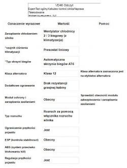

    #178 19750060
    kalisz1
    Respect for the work you put in
    Any of your colleagues tried to code the engine controller?
    I need such an operation

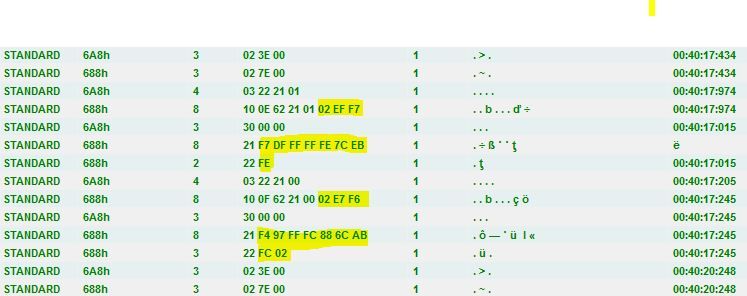

    308 T9 driver VD46.1
    I have read DIAGBOX encoding frames BSI DELPHI series EL HW D6 - TELECODING READING BSI peugeot 208 II corsa F
    and coding description
    The problem is I don't know how to do it
    you can see that here are multi frames
    someone will suggest

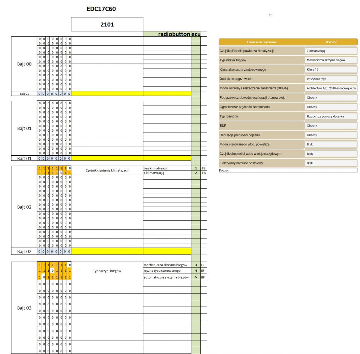

    you've got two encoding containers here
    2100
    2101
    For example, 2101
    HEX ---------------- BIN
    02 -------------- 0000 0010
    EF -------------- 1110 1111
    F7 -------------- 1111 0111
    DF -------------- 1101 1111
    E.T.C.......
    EVERY BIT CAN BE CODING.
    so either you have a tool to change the encoding and check which bit is responsible for it - quick and simple solution
    Either you change single bits and see what has changed - or it hasn't changed
    A very time-consuming solution - it is best to write a quick program for such editing.
    Here I also notice that the encoding is - as if Xored
    It is similar in other ECUs (PSA engine controllers).
    So 1 is an empty bit and 0 is the encoding, for example "YES"
    I assume that this is also the case here - it results from the appearance of the coding.
    it is also worth adding that it is often the case that there can only be one assigned bit per line.
    e.g. we have F7 encoding
    1111 0111
    It may turn out that it is impossible to code such a line 1111 0011
    only at most 1111 1011 (HEX FB)
    So 0 changes its position
    if I wrote it XOR it would look like this
    0000 1000
    change on
    0000 0100
    But it may or may not be so.
    here a piece of EDC17c60 encoding, I assume it will be similar
    I hope I made the topic clearer?
