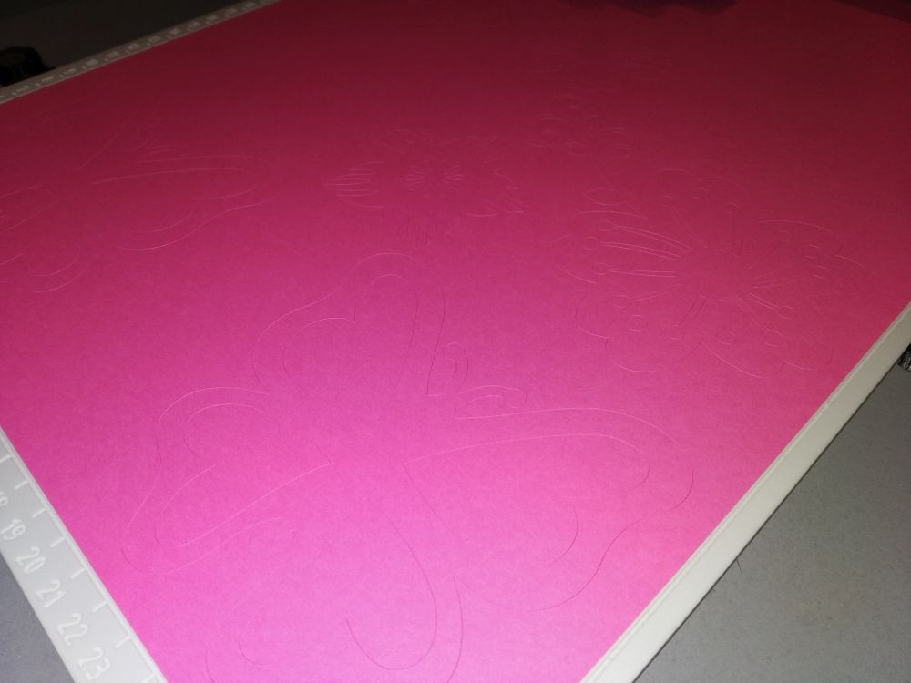

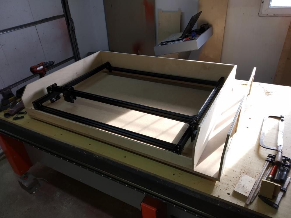

    Today I present a CNC machine - a plotter with a drag knife which I made for my own use (for my spouse).
    The spouse designs and cuts out decorations from paper. So far, he uses the Brother Scanncut plotter. The machine works quite well, although after cutting, I think that already thousands of decorations show some wear. In addition, it works quite loudly, which is a bit disturbing because the studio is at home (the engines probably work at full speed, the housing vibrates a lot) is slow and the working area sufficient for an A3 sheet has started to be insufficient.
    A decision was made to build a new machine with a larger working area.
    Initially, the idea was for a laser. Despite my concerns about inserting the laser into the house (need for extraction, flammable material, etc.), I took the first steps. I bought a 30W laser and to speed up my work a bit, I also bought a 165 x 85 cm frame according to the openbuilds project. In the meantime, however, it was decided that a drag knife would be the best solution for this application. The already purchased frame, a bit too flexible for a drag knife, but for the one without the Z axis, I decided to use it. I made the Z axis myself, a trolley with a head holder printed on a 3D printer. I strengthened the frame and mounted it in the reverse position. Initially, I wanted the axle to be light and I wanted to use a modeling servo as a drive (see the photo), but I quickly found out that it was a bad idea. Finally, the Z axis drives the stepper motor, the pressure of the knife by a push back spring.
    The housing is mainly plywood and MDF (used scraps and waste that I had) and 0.5mm steel sheets as covers. There is also a table with shelves for mats and paper.
    The paper mats are 6mm foamed PVC with scales engraved on the milling machine to make it easy to arrange the paper.
    Controls are GRBL and CNC Shield, on Universal gcode sender computer.
    Since it was hard for me to find a tool that would be simple, easy and quick to generate the toolpath, I did my job. This is the program I called CuterCam and it was this stage that took the longest (about 1.5 months).
    The program loads a dxf or svg drawing, detects the shapes itself, determines the order based on the algorithm. Shapes can be moved, rotated, duplicated, deleted, hidden, grouped etc. and arranged freely on the selected mat. In fact, it takes just a few clicks and the g-code is ready for a very complicated drawing. The program has a wizard of post-processors, you can create and save many of them. Shapes are cut out according to one of 3 algorithms:
    - internal first
    -external first
    -nearest shape
    In addition, the program allows you to control the angle of the knife entry. After completing the previous shape, the program saves the knife setting angle (angle of the last vector of motion) and starts the next shape from the place where the angle of the first vector of motion is as close to it as possible. This allows the knife to be lowered immediately to the cutting direction, it does not have to turn back in place, so there is no risk of breaking it or tearing the material out when turning.
    Below are some photos that have survived from the construction and a video of cutting out and the work of the CuterCam program.

    I don't know anything about it, but wouldn't an ordinary servo (control 0, 1) be enough for the Z axis? The advantage would be to reduce the weight of the ambulance.

    How did you solve the knife contact pressure adjustment and cutting depth for different materials?
    Typically these applications use a coil and you have a stepper motor.
  • Spring-loaded knife pressure with motorized lift
    #4 19307243
    drzasiek
    CNC specialists
    Posts: 2212
    Help: 106
    Rate: 3233
    Gentlemen, I don't think you've read it :)
    Originally there was an idea to use a servo (you can see it in the photo) but it was too slow and too weak (you killed yourself by lifting the head pressed by the coupling up). In addition, the servo has a potentiometer that has a long service life, I started to fear whether the servo would have to be replaced too often.
    The head pressure is realized by means of a spring. The spring pressure is adjustable. The motor serves only for lifting, when it lowers it, the belt is loose and the spring presses the head.
    The cutting depth is regulated by the head itself by adjusting the knife protrusion from the head (adjustment on the screw). With us, the cut is made in the same material all the time (cardstock 170g), so the adjustment is one-time.
    The best application here would be an electromagnet, but a few that I tested turned out to be too weak in this range of motion and were too hot. The engine works reliably, quietly and is unimaginable in this application.

    Write something more about underlays, how the underlay sticks to your table and how the undercoat sticks to your table.
  • 6 mm foamed PVC cutting mat with butterfly locks
    #6 19307528
    drzasiek
    CNC specialists
    Posts: 2212
    Help: 106
    Rate: 3233
    The mat is made of 6mm thick foamed PVC. I have mats in sizes A3, A2 and A1. The mat is simply placed on the table against the base stops (Left and Bottom). On the right and top there are locks with butterflies. The lock is pushed against the mat and locked by tightening it with a butterfly screw. The entire block is 6mm high and made on a 3D printer. A light temporary adhesive is applied to the mats, the paper is stuck to the mat and cut. It detaches from the mat after it is cut.
