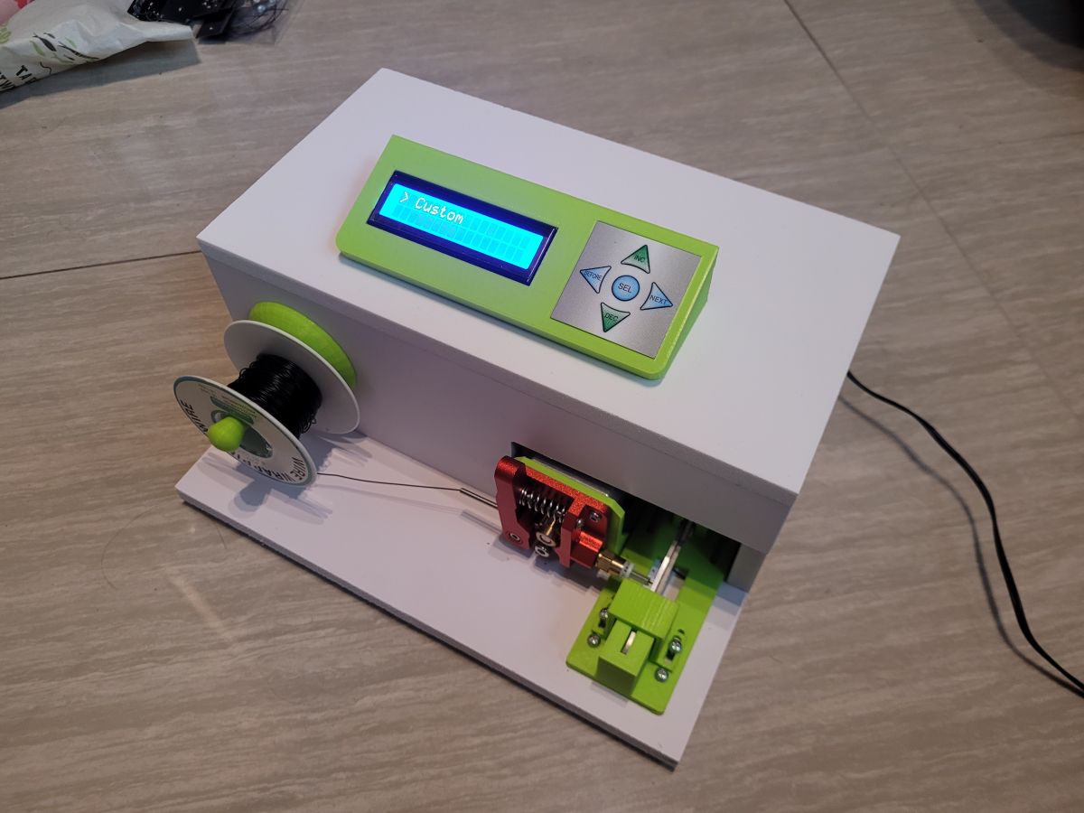

  • For my own purposes, I made a wire cutting machine to complement the electronic boards I offer for model railways. The premise was to cut the wires to a set length and quantity.
    Electronics .
    To speed up the build, instead of making a PCB I used off-the-shelf solutions: a CNC shield for an Arduino nano with two stepper motor controllers. To this attached after I2 a 16x2 display and a membrane keyboard (ready-made from Alliexpress).

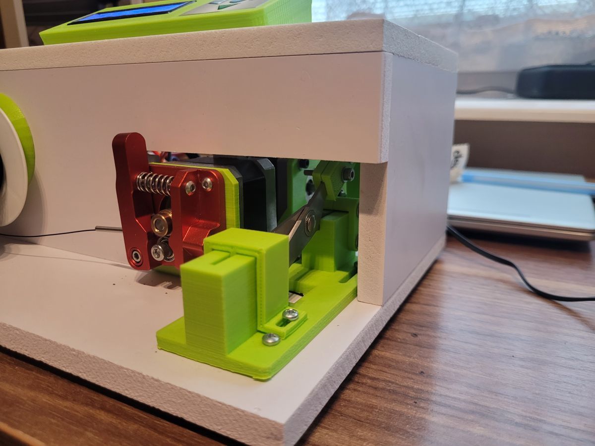

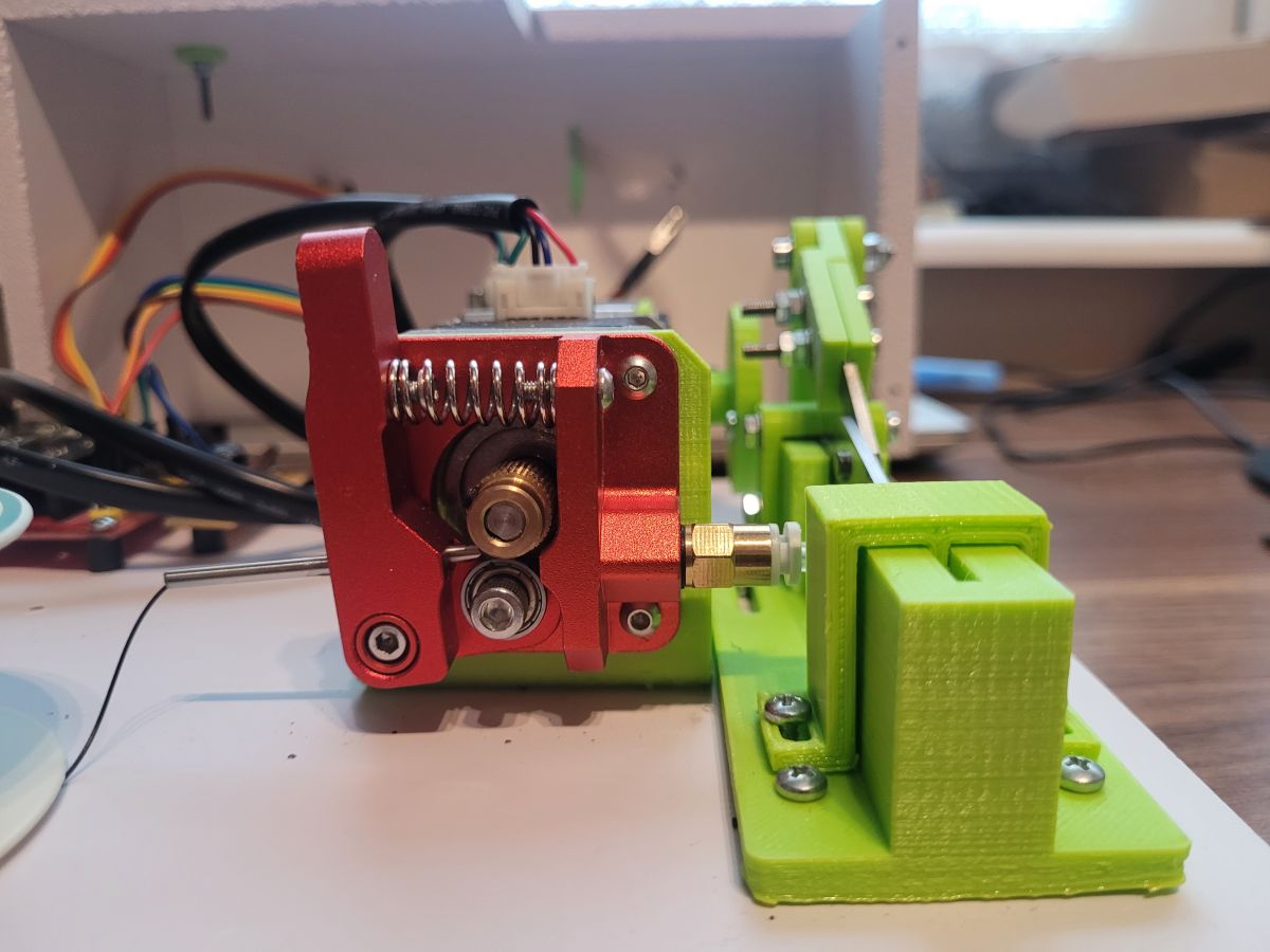

    After reviewing similar solutions, I decided to feed the wire with the mechanics of an extruder from a 3D printer. As the kynar is thin and quite delicate, the drive had to be modified: the toothed roller has grinded teeth, and instead of a concave roller I put a bearing. To prevent the kynar from slipping off the rollers, I glued a truncated meat injection needle onto the input. On the exit, instead of a piece of bowden - a piece of pen nib. The last two modifications ensured stable guidance of the flexible cable.

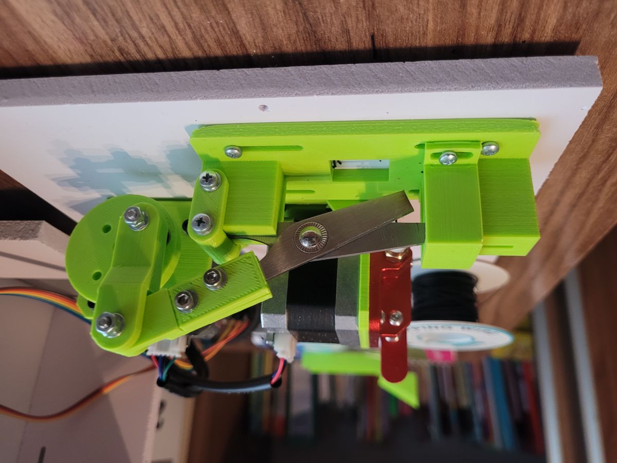

    I carried out the cutting with scissors - a very important advantage of this solution is that after cutting you can continue with the closing movement of the pliers, unlike with typical clippers. There are Stanley clippers available, or replacement clippers that work with scissors, but I don't need to cut thicker wires, plus the scissors were easy to attach. Scissors without handles mounted in a 3D printed mount, the movable arm has a handle instead of a handle, which is articulated to a wheel attached to a stepper motor. The motor is arranged so that it can perform a full rotation freely. The whole, unlike the solution based on clippers, is not sensitive to the wear of the mechanism, its play, etc. (the scissors do not close at zero, they make a further movement, which will always eliminate tolerances, the influence of wear, etc.).
    Motor mounts from 3D print, Roller on kynar - 3D print reinforced with M3 pin. Display and keyboard in canopy 3D print, all encased in foamed PVC.

    I would reverse the cutting motion - so that the movable arm cuts downwards rather than upwards - here I needed to eliminate the scattering of cut fragments by the canopy tray catching the tossed fragments.

    Assembled device:
    Automated wire cutting machine with display and keypad. .
    Kynar feed drive:
    Wire cutting drive with visible extruder mechanism. .
    Cutting drive:
    View of the wire cutting mechanism with 3D printed components. Cutting drive.

    Doesn't this feeder imprint teeth on the cable?
  • Bevelled sprocket teeth avoid cable marking

    slaw0 wrote:
    Doesn't this feeder imprint the serrations on the cable?
    As I wrote, the sprocket has bevelled teeth, so they are not sharp and nothing is imprinted. On typical wires in "normal" insulation, even without blunting, nothing imprints.

    KamBys wrote:
    I accomplished the cutting with scissors
    And this is where I see the first (quite serious) wear and tear in this razor - the cutting surfaces will quickly dull/chip in this one spot.
    I suggest using a guillotine-style cutting mechanism (up-and-down or right-left movement; the latter will be easier to use with the current blade drive solution) with blades adapted to the diameter of the wire, such as in the rod-cutting process in the metal industry or as in electricians' cutters.
    Regards
  • Scissors chosen over knives and cutters for thin wire
    #10 21360835
    KamBys
    Posts: 809
    Help: 32
    Rate: 54
    clubber84 wrote:
    and here I see the first (quite serious) wear in this razor - the cutting surfaces quickly become dull/chipped in this one spot.
    Nothing like this is occurring at the moment, and I used the scissors deliberately:
    - The kynar is thin, I don't cut anything thicker than that.
    - Typical knives for cutting in this type of machine: availability, cost, need to build your own drive - I rejected.
    - Typical cutters fall out, because they crimp and do not pass (description at the beginning), they remain this type: https://pl.aliexpress.com/item/10050061592670...ain.5.2c601c249JNaur&gatewayAdapt=glo2pol - I have, I bought, but I stayed with scissors - easy replacement, availability, etc., if there is a need to use them for thicker wires - I will use them, the drive is the same, to modify the attachment and transmission of the drive.

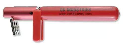

    Here https://www.elektroda.pl/rtvforum/topic4077229.html I have had the opportunity to test and pass on for testing wire cutting scissors, they have a serrated surface and I suspect are suitably hardened. Similar ones are used for cutting optical cables. Perhaps such equipment would have even greater durability?

    Here https://www.elektroda.pl/rtvforum/topic4077229.html I had the opportunity to test and pass on for testing wire cutting scissors, they have a serrated surface and I suspect they are properly hardened.
    Certainly - I have similar for cutting PCBs. This was decided by the easy availability of scissors at the Swedish market on J next door. ;) .
    A dilemma of sorts give something better, more expensive, less readily available, or accept the option of possible service. For myself I chose the second option, but if I had to give someone to service it - the first.

    In the manual wire preparation machine for mini-winding by O.K. Industries
    scissors were just used to cut the kynar.
