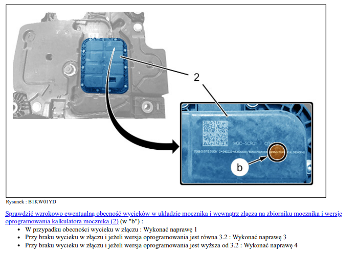

    Diagram of the urea tank connector and repair instructions. Diagram of the urea tank connector and repair instructions.

  • AdBlue tank repair is model-specific but board is shared
    #124 20791011
    mako122
    Posts: 136
    Rate: 59
    The shape of the tank is different because it must be adapted to the shape of the chassis, but the most important thing is the same. Of course, it is impossible to replace, for example, the electronic board between the Boxer and the 308 because they have different software. The capacity of the tank is different because it has a different shape, the software has different capacities, etc. You can easily try to repair the tank based on what is in this thread.

  • AdBlue tank board has model-specific firmware
    #126 20792317

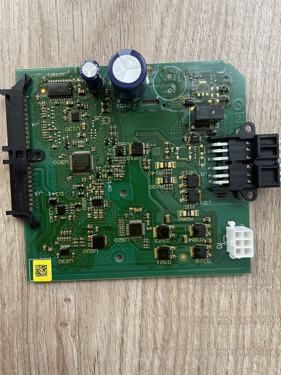

    mako122
    Posts: 136
    Rate: 59
    _Hose_ wrote:
    Thanks for the info. I'll take out the tank at some point and have some fun. Is the program located in the engine controller? Is the tank plate the same as in other Peugeots? What a contraption.
    The program sits on an electronic board in the tank. The board has its own processor marked as U300 and this processor controls all the tank systems. The processor only sends information to the engine controller whether everything is OK, or sends errors. The description of the board and its circuits is located in this thread. There is also a block diagram of the board, please see post no. 5. The boards are the same in all tanks, but depending on the car, the U300 processor runs its program with different parameters, so the board cannot be swapped between different types of car. Cars have different engines, different power, etc. They each need a different dose of urea, etc. To sum up, the boards are physically the same, but have different software depending on the type of car. The board is described quite thoroughly in this thread, there are also photos of individual circuits with a description of what each circuit does. Please read this entire thread carefully before starting the repair, it will help you be better prepared for the repair. If you encounter any problem during repair, please write here on the forum, there will always be someone who will help. It is worth making a thorough visual inspection and looking for any moisture or a white coating of crystallized urea on the tile. Problems are often caused by leaks in the hydraulic system and leakage of even a small amount of urea into the part of the tank that contains the electronics.

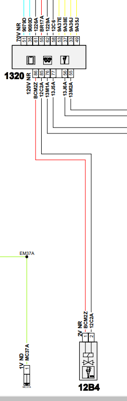

    marekarmata1975
    Level 4  
    Does anyone of you know what controls the AdBlue injector in Citroen C5, where to look for the other end of the circuit? I have error P2047 open circuit. The injector was functional for a short time, the injector cube was measured with an ohmmeter, it was about 20 ohms.

    mako122
    Posts: 136
    Rate: 59
    The injector is controlled directly from the engine's central computer. I don't have a diagram of your car, but I'm 99% sure it's the same in your case. Around 7 p.m. I will send you a diagram of my car, maybe it will help you locate the damage.
    Added after 8 [minutes]:
    Please look for the other end of the cable directly on one of the pins from the engine ECU (main engine controller)

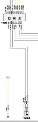

    mako122
    Posts: 136
    Rate: 59
    Electrical schematic of ECU with PIN 85 and PIN 86 and the urea injector.
    1320 - ECU (engine main computer) PIN 85 and PIN 86
    12B4 - urea injector
    ECU - Electronic Control Unit ✓ Electronic control module; The task of the control unit is to supervise the proper operation of the car engine
    I don't know if this is the case in your car, but 99% of the time the urea injector is controlled directly from the ECU.
    There may be control on other pins, but you can start by checking pins 85 and 86. Please pay attention to the colors of the wires, they should be the same at both ends, because there is no connection cube on the way (it is not in the diagram, so it should this pair of wires at both ends have the same color).

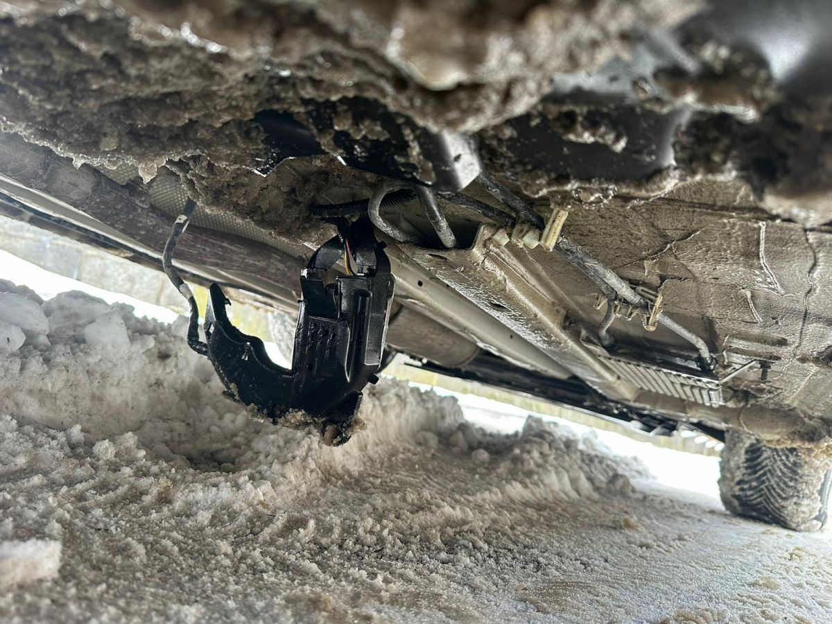

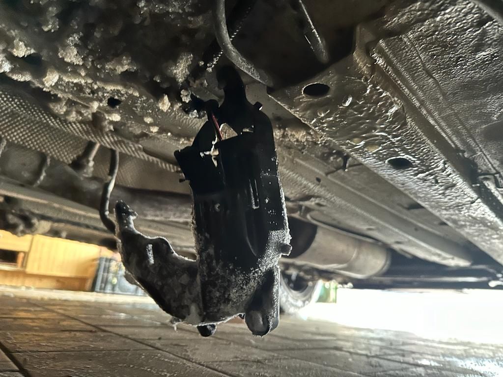

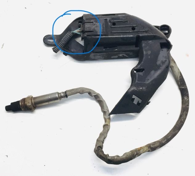

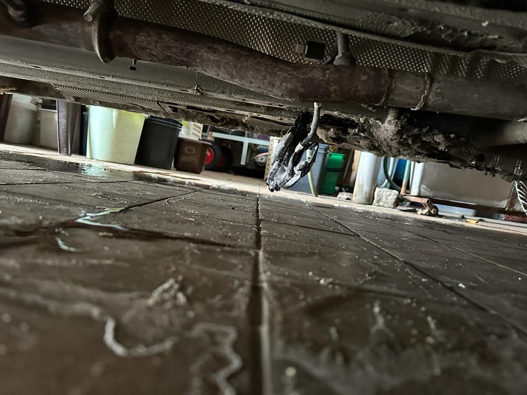

    Can anyone tell what is in the picture (the black part that hangs on the wires).
    A white Citroën Berlingo parked in a snowy parking lot. View from under a car with a black component hanging on wires.
    A black component hanging on wires under a car chassis, surrounded by snow. A black component hanging on wires under a car chassis, surrounded by snow. Black part hanging on wires beneath a car. A vehicle's undercarriage with a component hanging on wires.
    It appears, That it is NGK NOX SENSOR SONDA ?

    And isn't that a plug cover?
  • #138 20905952
    harry1250
    Posts: 38
    Rate: 62
    I bet on the nox probe .
  • #139 20906617
    mako122
    Posts: 136
    Rate: 59
    Yes this is the NOX probe
    Damaged NOX sensor with casing and wire.
    It was not secured with a bolt and the entire cover with the NOX probe popped out of the latches and hung under the car. There was an error on the dashboard " no communication with the NOX probe" The reason for this was flooding the connector with salt water and dirt from the road (slush).

    Andrezej1976

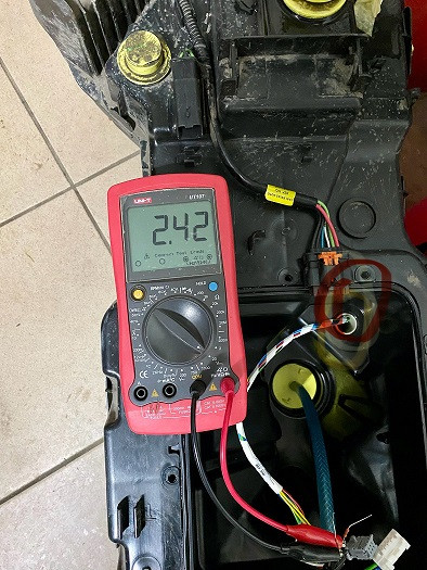

    Hello everyone, I have a 2018 Peugeot 3008 - 2 l diesel - like most users, I have a problem with the AdBlue tank. I dismantled the tank, disassembled all the electronics and measured the parameters. In the non-removable part, I inserted a 10kohm resistor on the yellow wires from the heating plate. After measuring the parameters, the rest seems to be good, the only difference in my case is in the non-removable part, it is on the black plug from the fuel level, because this plug has four cables and not three, but after the measurements it seems to be good. After assembling the tank to the car and starting it, I noticed a communication error and, of course, a problem with the pressure. The only strange thing is that the computer shows zero bars, not four as before. My problem is that after unplugging the plug from the J3 board on the heating elements such as Pump - valve - battery, the heating sensors show me different parameters than those shown by the colleague from the post above, namely my indications are as follows:
    A- heating plate Urea - 1.3 ohm
    B- Short urea cable - 27 ohm
    C- Green circuit - 51 ohms
    D- yellow circuit - 49 ohms
    E- circuit Blue - 12 ohms
    F- white circuit - 13 ohms
    G- Cable from the tank to the injection 0.0 ohm
    And the indications - Mako 122
    - Before a detailed description, I put the correct resistance values of all circuits here:
    A) plate heating the urea in the tank (there is no direct access to it) - 1.3 Ω
    B) cable connecting the urea filter with the pump assembly (approximately 30 cm long) - 27.0 Ω
    C) "green" circuit, pump heating - 55.0 Ω
    D) "yellow" circuit, solenoid valve heating - 55.0 Ω
    E) "blue" circuit, urea battery heating - 212.0 Ω
    F) "white" circuit, heating the elbow at the point where the urea exits the tank - 22.0 Ω
    G) heating circuit of the tube between the tank and the injector (about 1.5 m) - 2.5 Ω
    And now I don`t know if these parameters can differ, because I had four cables on the fuel level plug, and in most of you there are three, and after disassembling the entire pump plate and all the elements, it seems to me that it is the same plate, only with the difference in the fuel plug, is it possible that two or all of the heating sensors are broken at once? I checked the pump according to the instructions in the video and everything seems to be fine, it draws water and the pressure also seems to be good.
    Please help. Thank you.

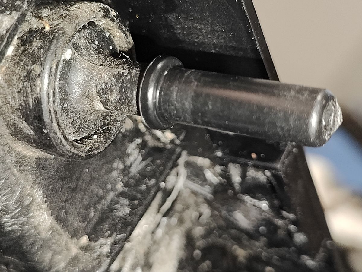

    Has anyone had a problem with sealing the connection between the tank and the pipe leading to the injector? In my case, 90% of the fluid escapes from here, which is why I think the pressure in the system is too low. The tank is dirty and there are crystals under the car. How to seal it? Add some O-ring? Is it possible to replace the cable? And this one is not cheap, probably around PLN 700.... Close-up of the connection between a tank and a tube leading to an injector, showing fluid residue.

    Andrezej1976
    the heater has a short circuit in the 1.5 m cable, you need to find where the wires are short-circuiting or install a resistor with a heat sink in the plug to cheat the controller and check if the system will start.
